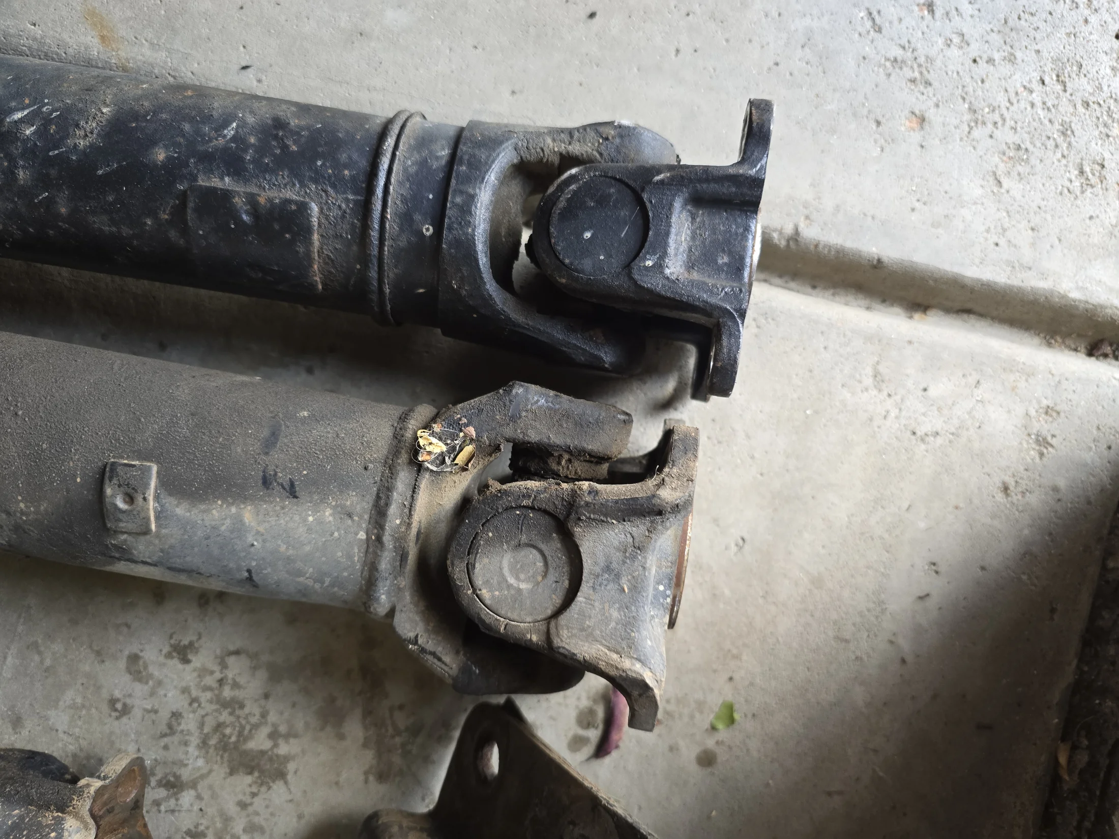

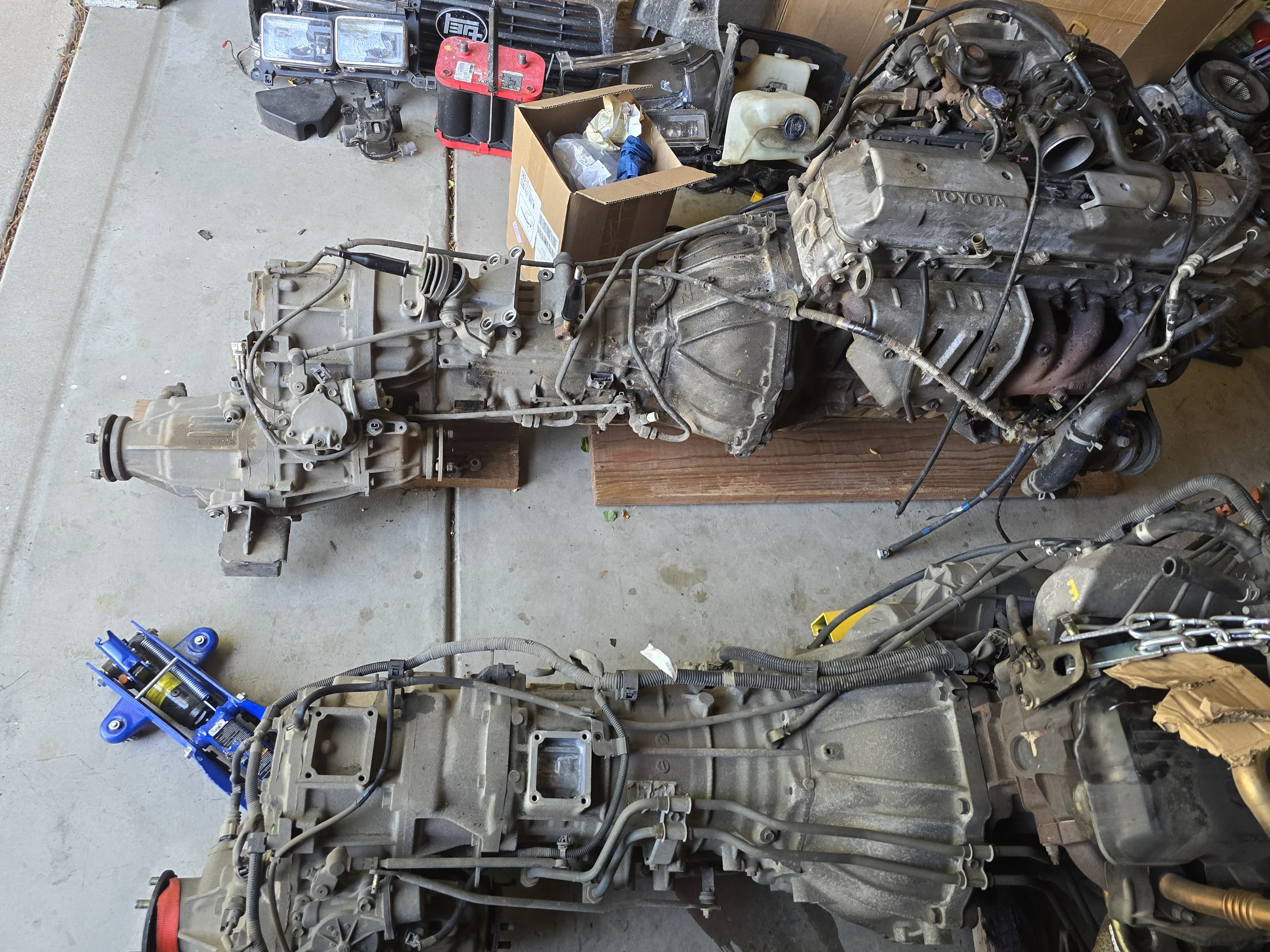

Lookinf at the length differences, 100 series on the outside, 80 on the inside, speculated about trying to use them. Rear 100 is longer, front 100 is shorter, which is what id need for the manual swap.
then I looked at the u-joint size difference on the rear shaft. 80 shaft is noticeably larger.
Tom Woods is probably my route, but I wanted to share just because.

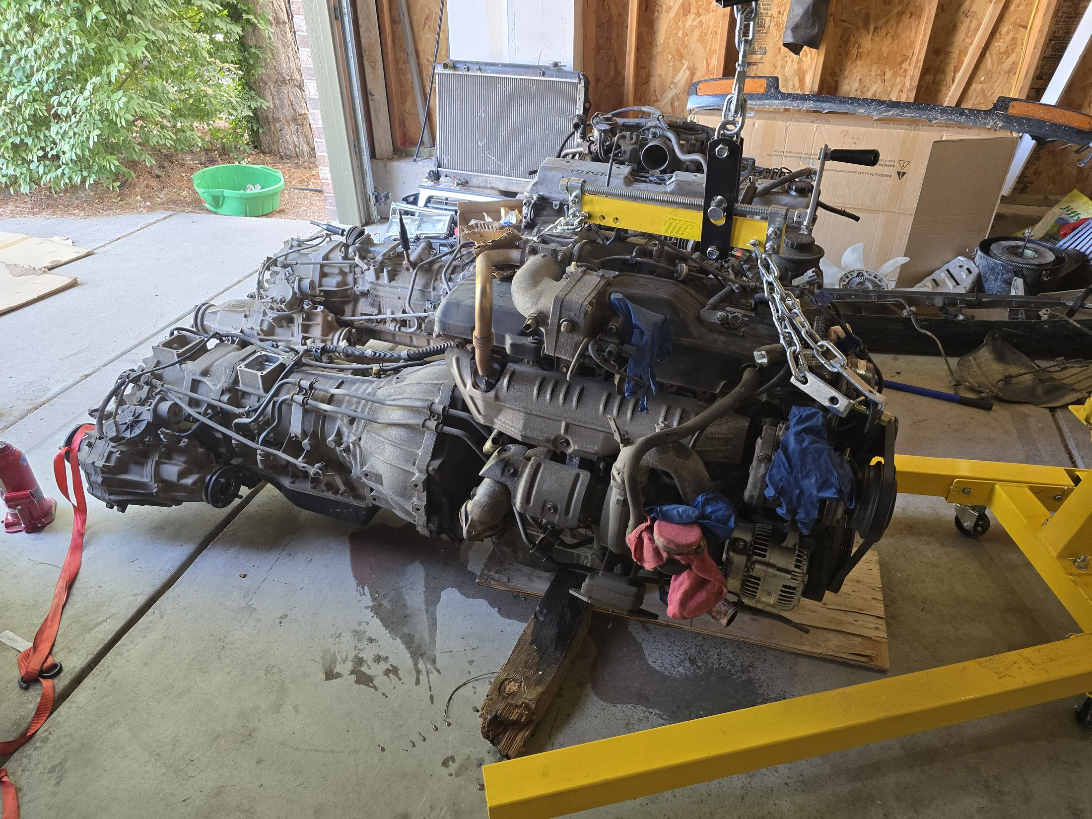

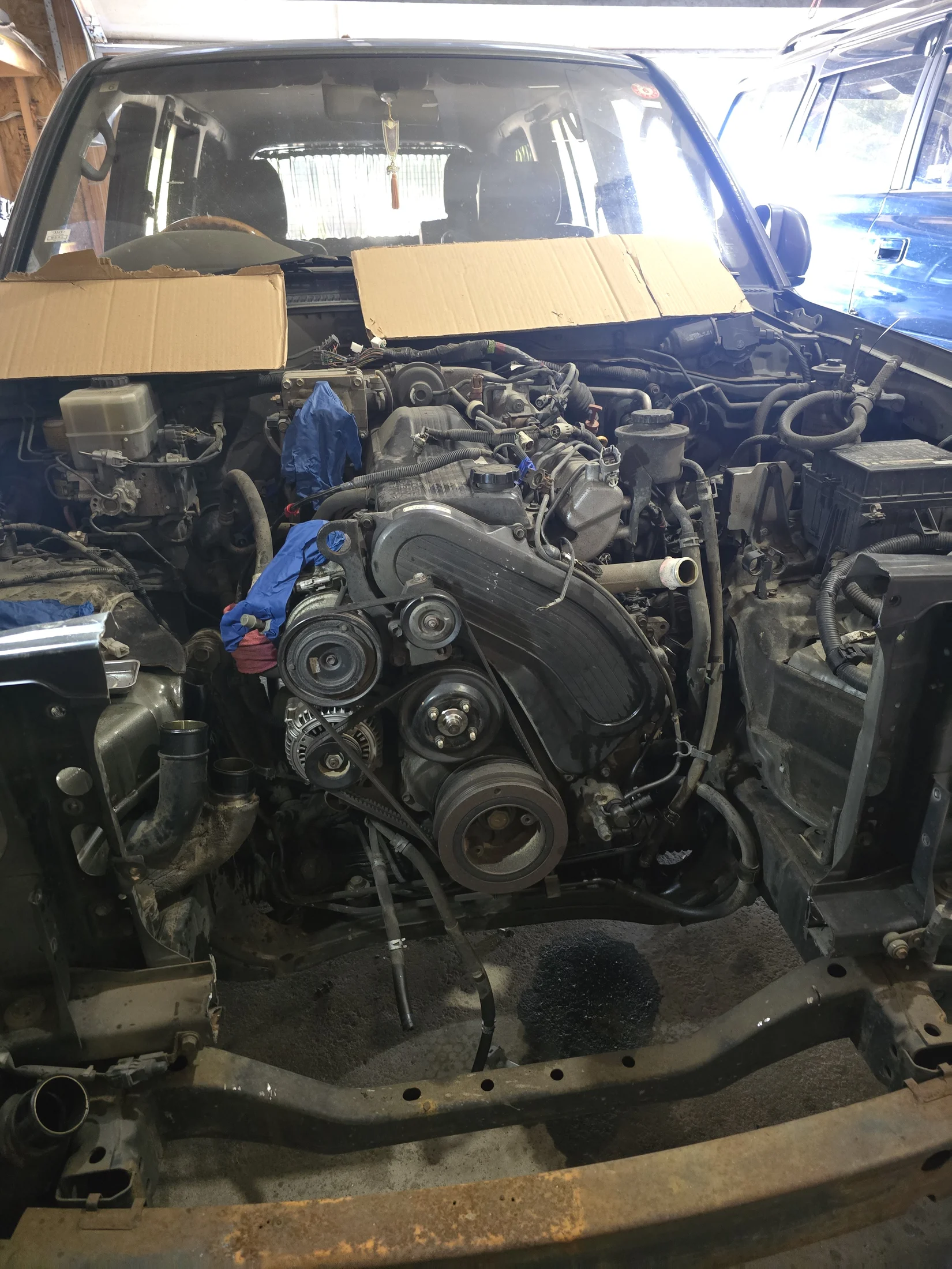

All fluids are drained
Engine is ready to pull, only thing holding it up are four bolts holding the transmission/transfercase crossmember.
Ill take those out when I have a jack under it and we're actively pulling it out.
Maybe tonight.
Let’s go!!!! Can’t wait to see this thing going in
View attachment 3972948View attachment 3972947
the 80 shafts can be either shortened or retubed longer pretty easy and cheaply by a driveshaft shop. the 100 shafts can't without a bunch of extra machine work because they're fused, not welded. nothing against tom woods but reworked OEM would be my pick.
Ill call around to some local shops, there's a few in Denver.
