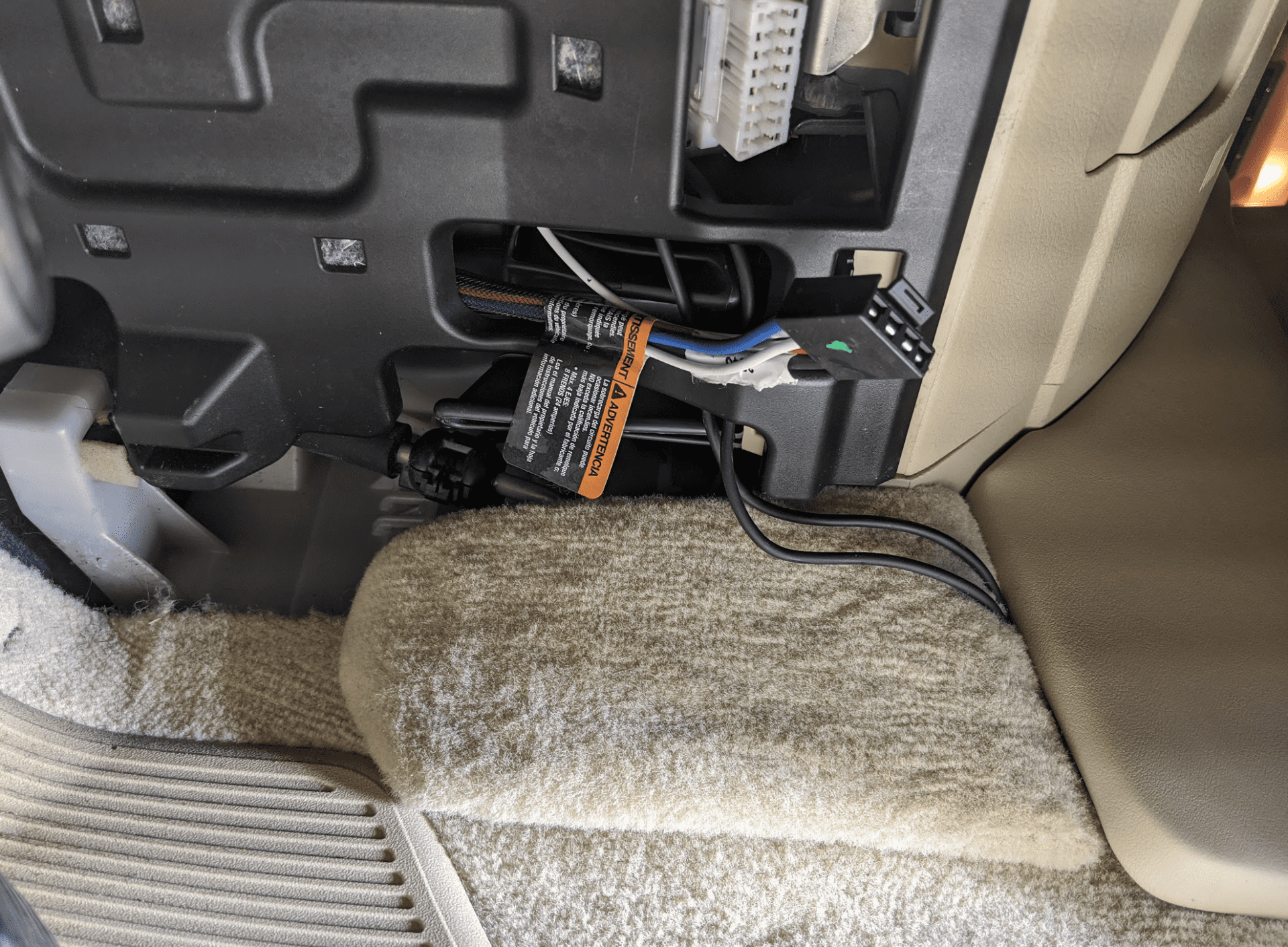

Converted our boat trailer from surge brakes to electric brakes. Went with the Tekonsha P3 brake controller, along with the Toyota/Lexus plug'n'play harness. Got it in 2 days from Amazon. Comes with the bracket, controller, and Toyota/Lexus harness:
Amazon product ASIN B007O5GXOG
On my 2009 LX570 the plug is located right behind the mirror controls. It is plugged into a white plastic "dummy" block, so you have to unplug it from that and plug it into your plug'n'play harness. Don't forget to connect the loose white wire on the plug'n'play harness to a grounded screw.
Then I ran the harness through an opening in the black plastic under-dash panel, which lined it up perfect with where I wanted to mount the brake controller:
