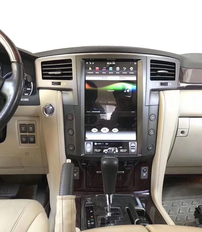

Just ordered one of these units a few days ago. I talked to their tech chat for a couple of day, and they seem confident that all factory functions will work. Including rear AC controls, factory DVD screen, all of the steering wheel functions, etc... They said they have only sold less than 5 units to so far since it is brand new, and that they just made a couple of updates to the design so mine is going to take about 3-4 weeks to arrive. I'll keep you guys updated when it arrives and I get time to tinker with it. Came out to $1150 shipped. So hopefully it's worth it.
My biggest concern with all of these replacement "Tesla-style" headunits is that they take some 30+ seconds to boot up after you start the car, so not only do you not have audio during that time, but you also can't use the backup camera. If this one happens to not have that issue, please update us, because I'll be getting it in a heartbeat!
That may have been the case in old units from many many years ago. But the new ones are all pretty solid. I had an android 2din unit in my LX470 and it was up within about 2-3 seconds. If installed correctly they don't actually power completely off when you turn off the car, they go into a power saving sleep mode. And then when you start the car they pop on very quickly. Much faster than most OEM systems from my experience with a few them that owned over the last few years.
The video on that product page mentions a 20-sec startup. If the power saving feature works as you describe it, that would be fantastic!
It did on my old one. We shall see on this one. Fingers crossed.
Very curious how this pans out. I've been following several threads on GX and LX "tesla" displays. None of them seem to be there yet. My biggest concern in the display quality. As far as I can tell, none of these can cope with high and low temperatures well. You might want to put yours in a freezer for a while and power it up before going through the trouble of hooking it all up. It would suck having a black screen for the first 20 minutes every time you have a cold morning.
Good points. I'll run it through some testing once it comes in and I get it installed.
It's in. Didn't take long to install. I'll post more photos and thoughts on the system in a couple days.

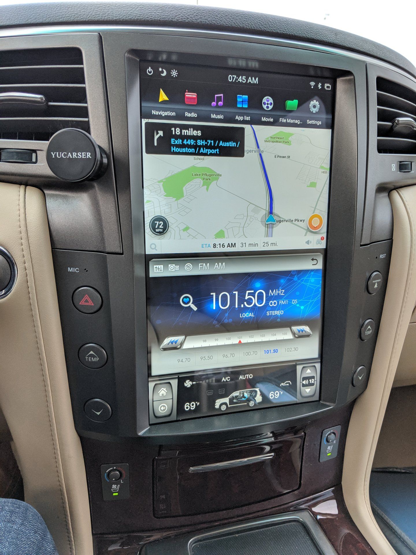

Split screen works really well once you get the hang of it. Both Waze and Google Maps work great. I have my Pandora & Youtube Music apps on there and they are working well too. I'm still poking around and getting used to the interface. I'll post my thoughts in depth once I get some more seat time with the unit.
Looks great. Definitely brings the LX into the 21st century aesthetically.
Agreed, gives the interior an entirely new feel.
