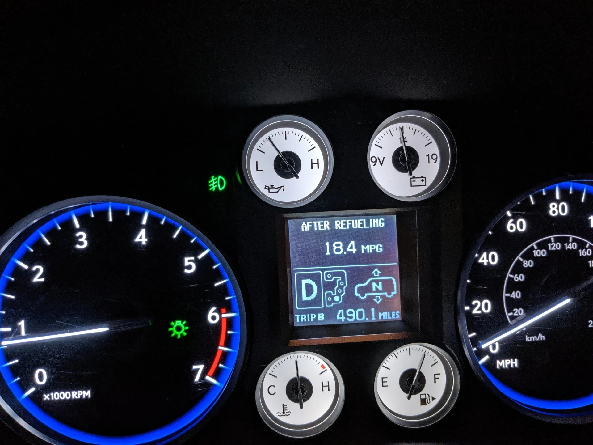

A quick road trip from Austin to Dallas last night. I was very surprised by the MPG. I got around 17.5 the first 50 miles or so. And 18.4 after filling up and going another 140 miles in lighter traffic.
My last trip I was getting about 14.8 MPG. The only difference from my last trip is the oil in the truck. I was using Mobil1 0w40 European formula in the last few oil changes. This time I switched to Castrol 0w30 European formula. Truck still runs the same. No noticable difference in performance or anything. But that difference in MPG is crazy. Going to keep an eye on it the next week or so to see how it does.

How's the MPG looking? If all it takes is different oil to get 3+ MPG I think you'll have a lot of people running to get an oil change!

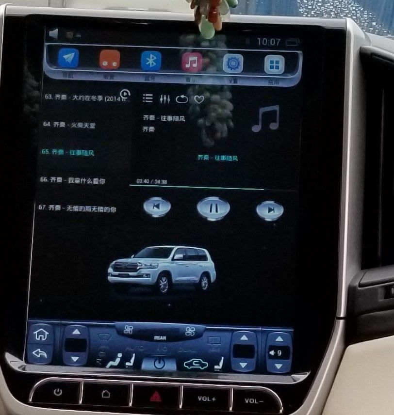

Looks much better than the install I saw in China.
The "Chinese" version cameras did work. While driving when other cars, people, stuff got close to the bumper sensors, the camera(s) came on. As they drive very "offensively" over there, the camera was working overtime.
