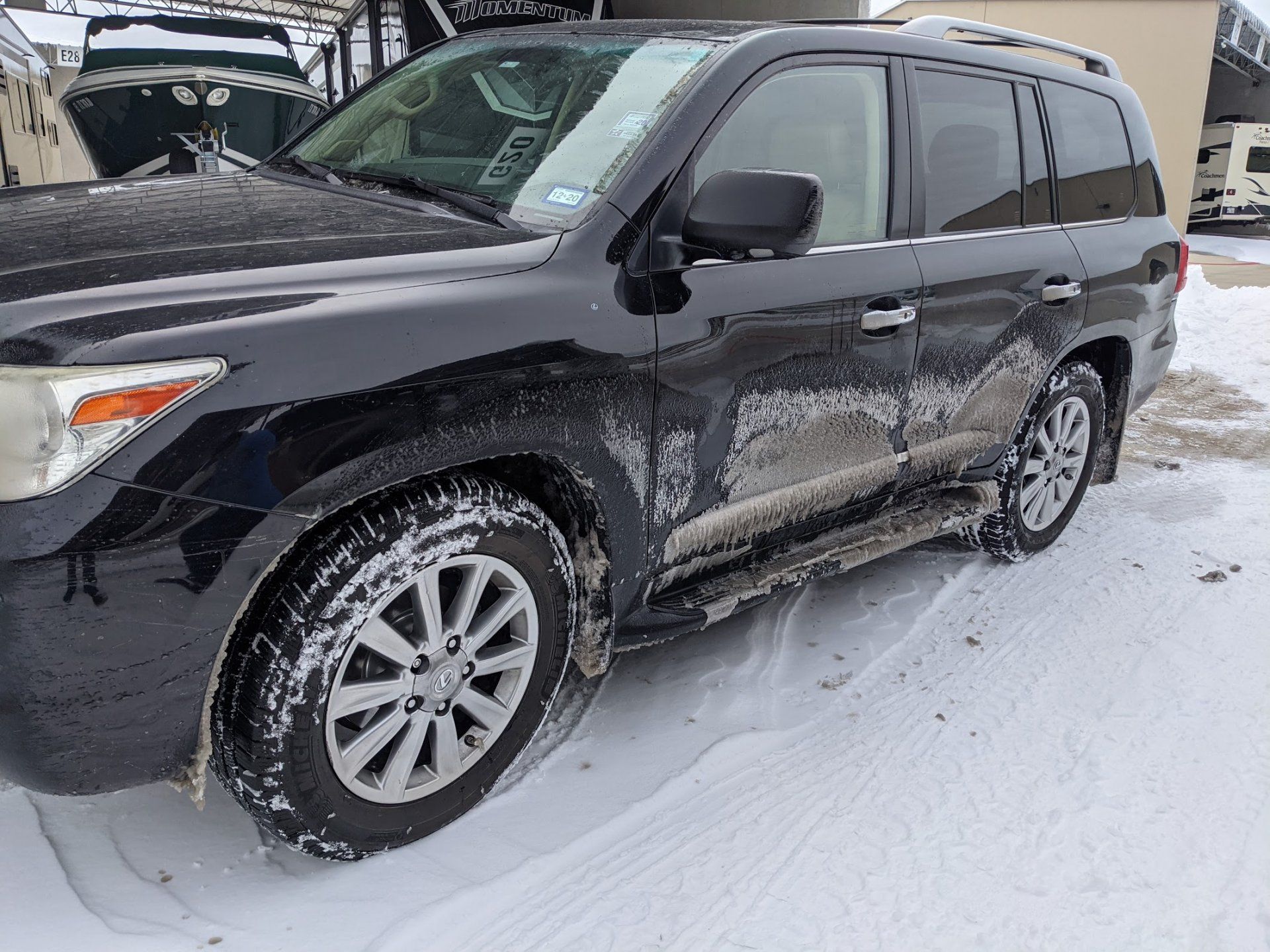

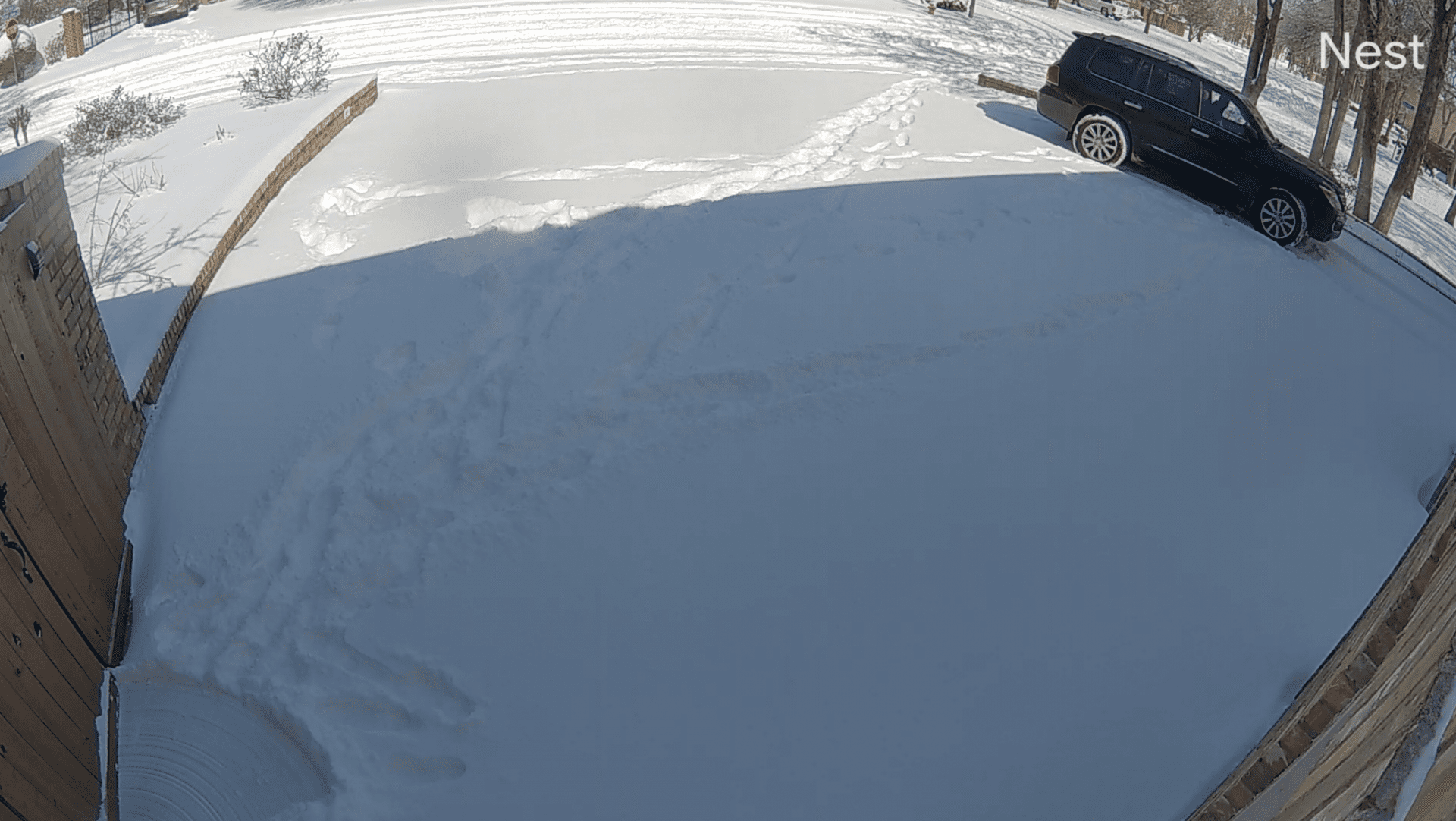

It's been a fun week of snow and cold that Austin is not accustomed to. The LX along with the Michelin Defenders have done great. We've been out running errands and dropping supplies for friends & family everyday this week and the LX has performed flawlessly. Meanwhile a lifted Titan with BFG mud terrains was stuck and couldn't get rolling again after it stopped. A Wrangler with KO2's was stranded once it drove off the powdery snow and onto the packed snow. Keep in mind, this is Austin, TX. We don't have plows, we don't really salt or sand the roads.
After having the Michelin defenders on for a while now I can say they handle heavy trails and rocks very well (not hard core rock climbing, but more action than 99% of LX/LC owners would ever see), they tow very well for such a light tire (no marshmallow tire feel), and now I know they are pretty darn awesome on snow and ice. I love the look of a knobby offroad tire, but I will never put one on a vehicle that gets normal road usage again as long as Michelin keeps making these tires.
Yep. Same experience here in Tulsa. We have defenders on the Wife's GX/100 and KO2 on the 200.
Ko2 are crap on packed snow but okay in power. Can't stop on any of it and have a tendency to slide laterally.
Defenders are a great all-around tire if you can swallow your vanity (they are ugly). Under power traction is great and stopping is "okay".
