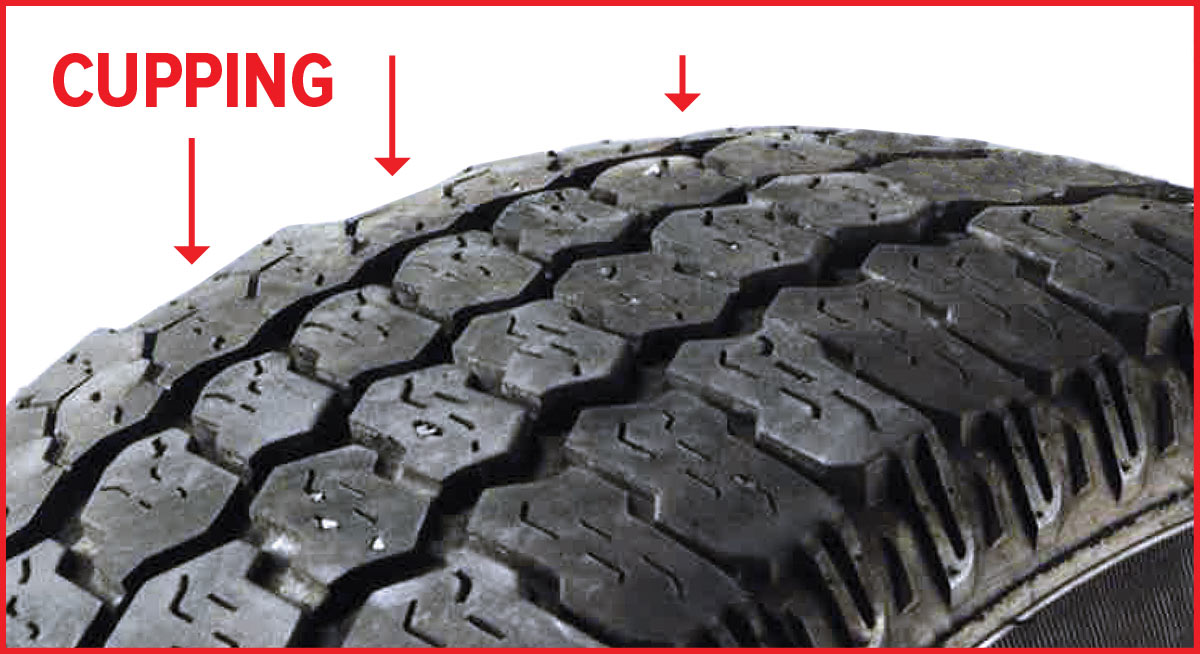

Can you take pics of your tires or describe more what you mean by cupping. Or find a pic online that has similar wear?
It can be alignment or air pressure creating the cupping so it helps to clarify exactly what wear you're seeing.

By cupping I mean the outside of the tire is wearing more than the inside causing it to 'cup' similar to this image. It's pretty noticeable when it starts because at lower speeds the tires make an unusual noise.
I've had it aligned by two separate shops and had issues cupping with both. I need to see if I still have a print out from the last one.
I typically keep my tires at 30-35 psi.

What tires are you running and size? Are they e rated?
Kenda Klever R/T Load D
35*10.50R17LTD121R
Seems like a very low tire pressure for that tire. Your max PSI should be somewhere around 80 at Max load. I would think 40 to 42 would be a more optimal everyday pressure. I run 33 inch LT wild peaks in keep 40 to 42 in mine on both my GX 460 and LX 570 and have never had an issue out of either of those sets hand have over 50,000 miles on the set on the gx.

That helps. What wheel offset are you running?
I tend to agree with @bigevol that tire pressure does seem a bit low for that fitment. The sidewall is possibly rolling over in turns enough that its scrubbing the shoulder lugs. I would aim for closer to 38-42PSI for that tire.
UCAs won't like fix this as they are used to adjust caster which doesn't really play into cupping type wear. It's usually toe out of alignment that creates cupping issues.
Could also be suspension or bearing issues, but being that this is a 200-series, they are robust as they come and not likely.

I'm running 1" spacer and rock warriors.
That's interesting on the pressure, I got the recommendation here that the RCTIP should be 33psi.

I run that exact tire between 36 and 39. Was thinking it felt a bit vague yesterday and pressures were 35, 35, 36 , 36. Will be putting in a couple pounds to 38 all around this weekend.

Take @grinchy s lead for pressures as he's successfully running those tires.
Offset may play into this. With a 1" spacer, you're at a net offset of ~25mm which is not too bad for 35s but can create some scrubbing in turns, and maybe its this combined with the lower pressures.
