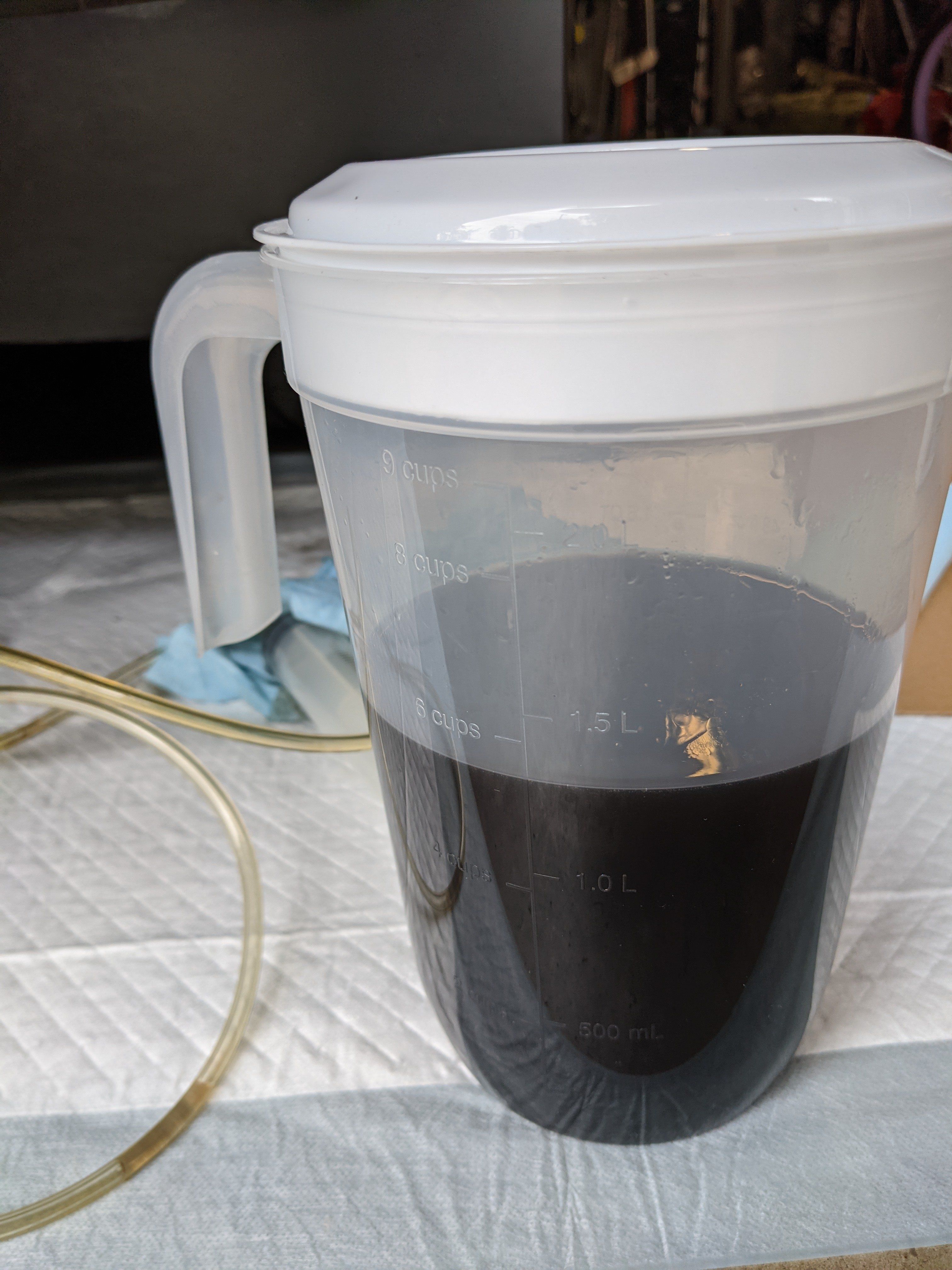

I did mine today.
I followed process using H mode (not factory N mode). I think factory tells you to use N to avoid running tank dry.
I didn't bother emptying tank either. Fluid in it actually looked pink. It was flushed 50k miles ago, when one of the lines raptured due to corrosion.
I put the car in High mode and bled it down. I returned to N then added fluid then brought to H and bled again. I think 4 quarts is a good flush. I did 4.5 so will do a bit to use up all 5 that I bought.
Other notes:
This is a solid 2-3 hour job. Easy but takes time. I have decent mechanical experience and good tool selection, but I did this in a driveway. Good funnel with a long neck is very helpful here. I bought one at autozone that you can fill with fluid, connect to the filler and then twist to let fluid down. Pretty nifty but I still made a mess.
Make sure to set level at or below max in N when done. Otherwise tank will get too full and might spray fluid through breathers.
I'm glad I did the flush after 50k. While fluid in the tank looked pink. It was pretty dark in all 4 corners and had a LOT of air in one corner. That's the same that had issue 4 years ago so the shop may have not flushed it properly or they didn't bleed after they fixed their mess up. I wish I replaced the lines myself.
One tip: if you bleeder is hard to turn, especially on the rear shocks with tight access, use 10mm 1/4 socket to break it lose. I used flared wrench with tilting end and stubby wrench. Front bleeder are easy, rear bleeders suck getting to. I didn't have by brake bottles handy so I bought 1/4 OD clear tubing (which was very tight) at HD and used a used DD iced coffee cup.
If you bleed slow, the car goes down slow, I thought it was going to drop down, but it goes down nice and smooth and I could regulate it with the bleeder valve.
for Filling the reservoir I had a similar contraption of a tube with a twist valve. I cant remember now if it came with a funnel, as I didn’t know what was going to work best and bought 3 or 4 options. What I did was unscrew the tube from the funnel and attach it directly to the bottle of AHC fluid. then I used the twist valve to regulate flow. The filler tube of the tank will not allow full flow, it will end up gushing out if you go full speed. There is just barely enough room in the wheel well to let all the fluid out of the AHC bottle.
