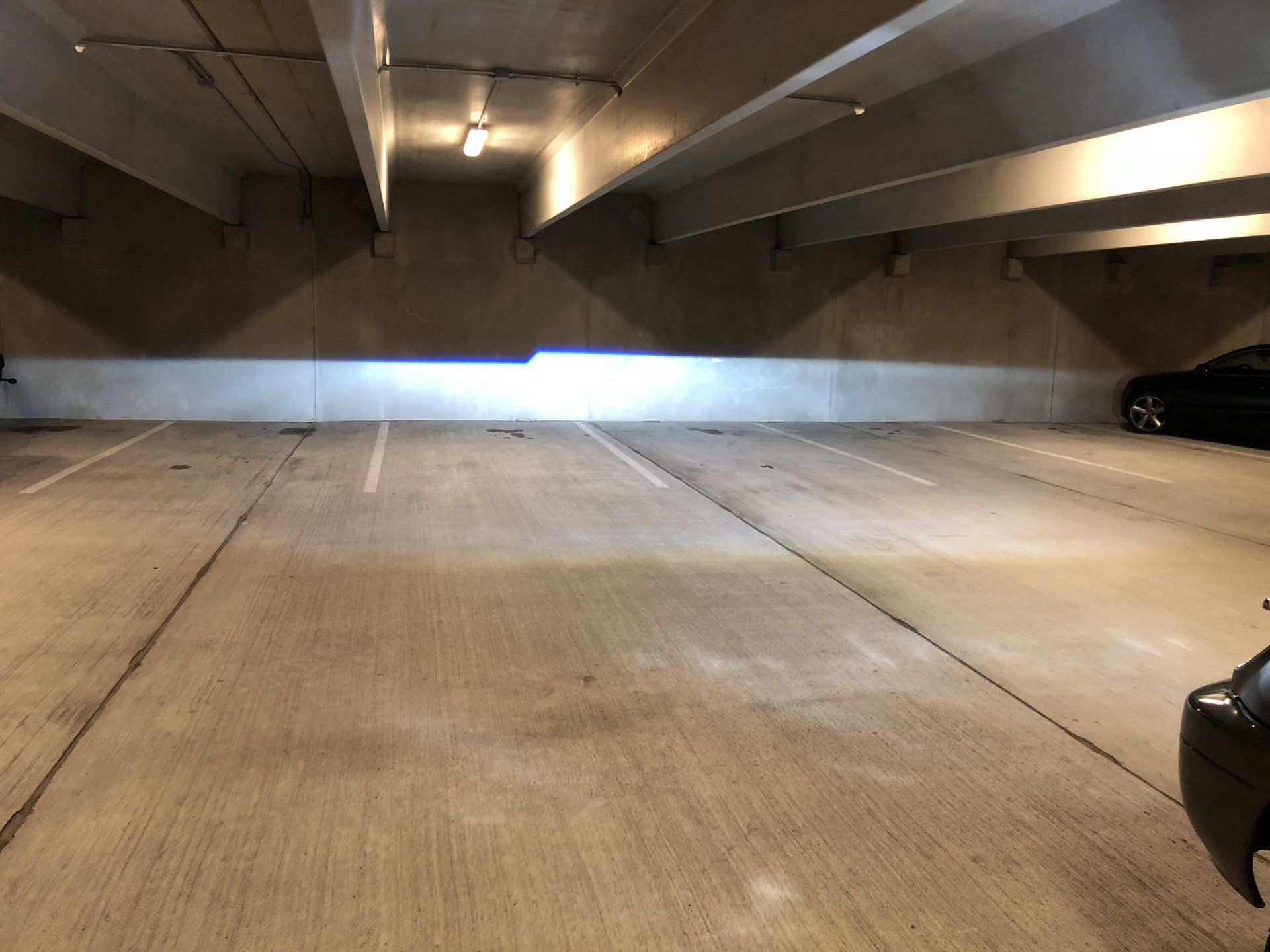

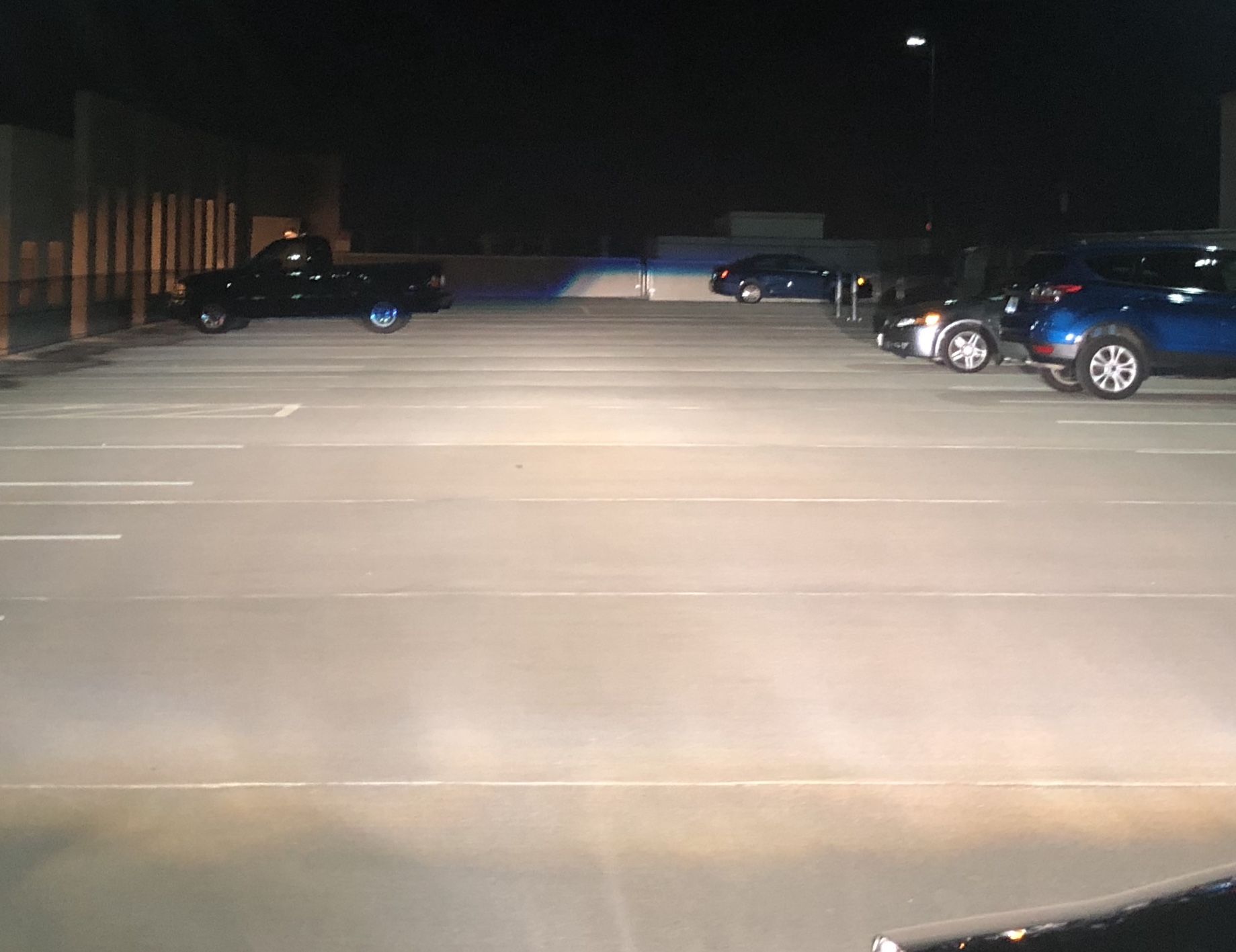

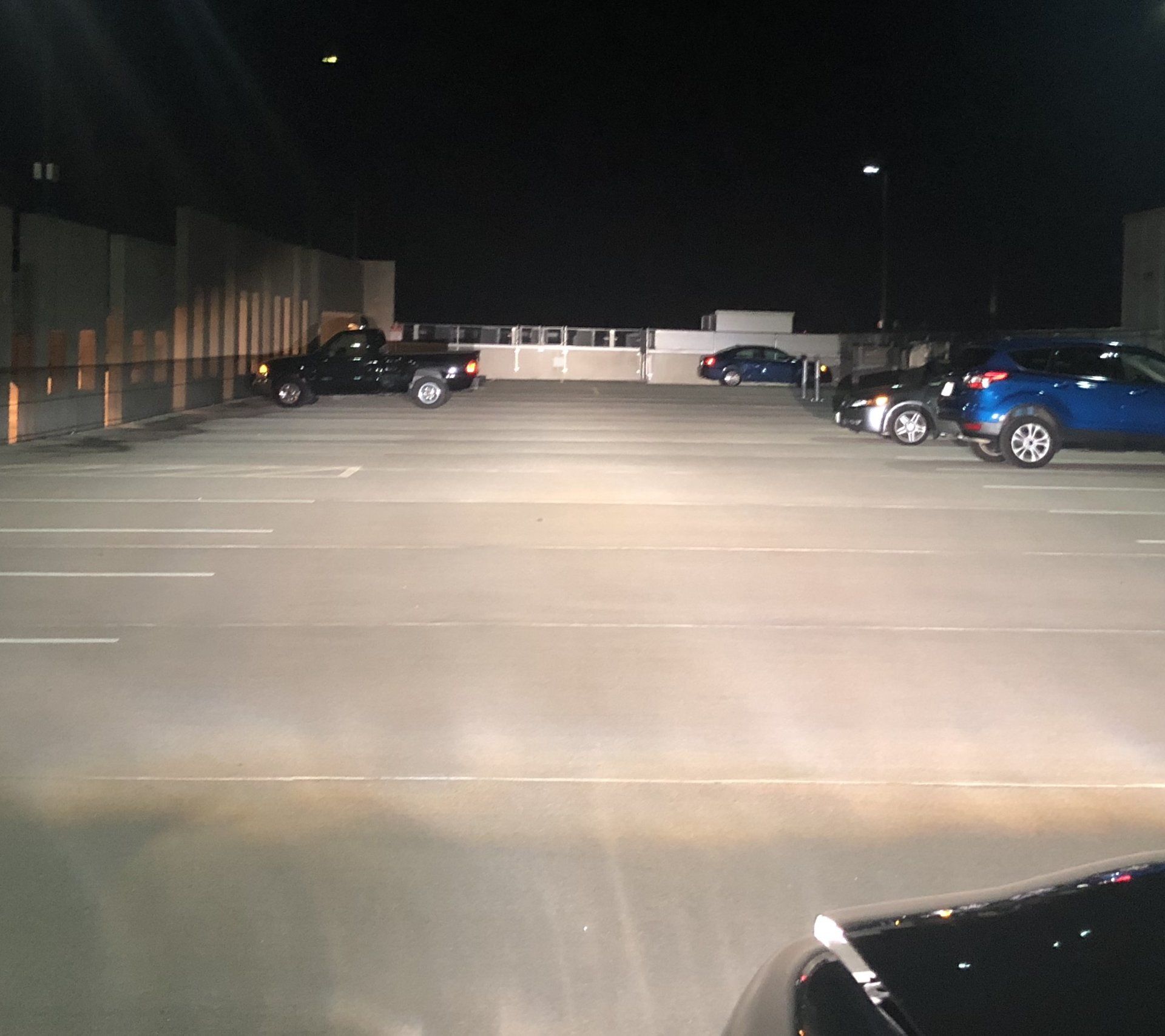

There’s nothing plug and play that will give you great results ....we have already been down that road. That’s why I designed the bracket or if you really want plug and play I’ll retrofit brand new OEM housings with the Morimoto D2S projector and send them to your door, harness and ballast....ready to Plug and Play $1650.00...
There are quite a few members that have done the DIY route and I’ve built 21 sets of headlights for guys and gals on MUD
Let me know if I can help you
Lou
D2S low, high beam and cutoff output
