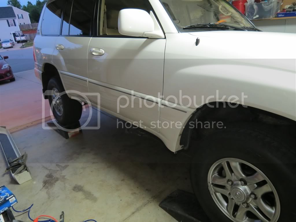

Running boards

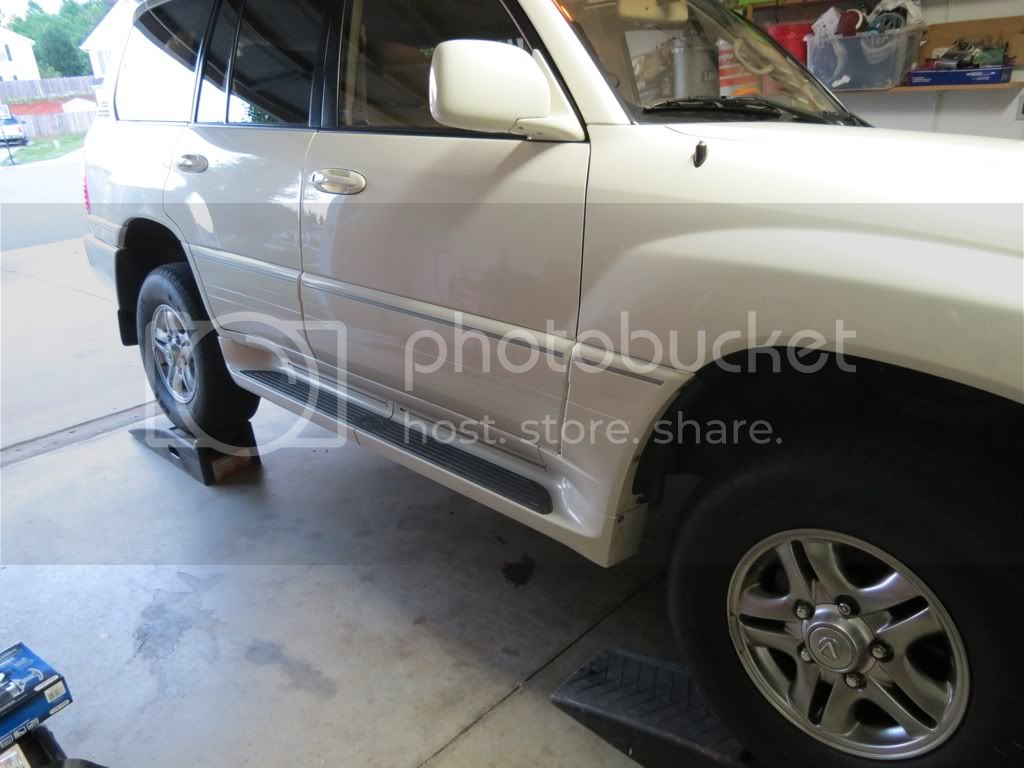

So the running boards are off. Took about a half hour. My wife actually agrees that it looks much better without them. Hopefully she gets sick of stepping up without them and I can convince her that we need some sliders soon.
Before
After
I'll get some better pictures on the trail this weekend.

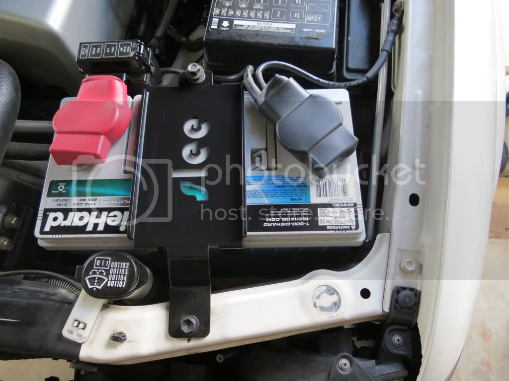

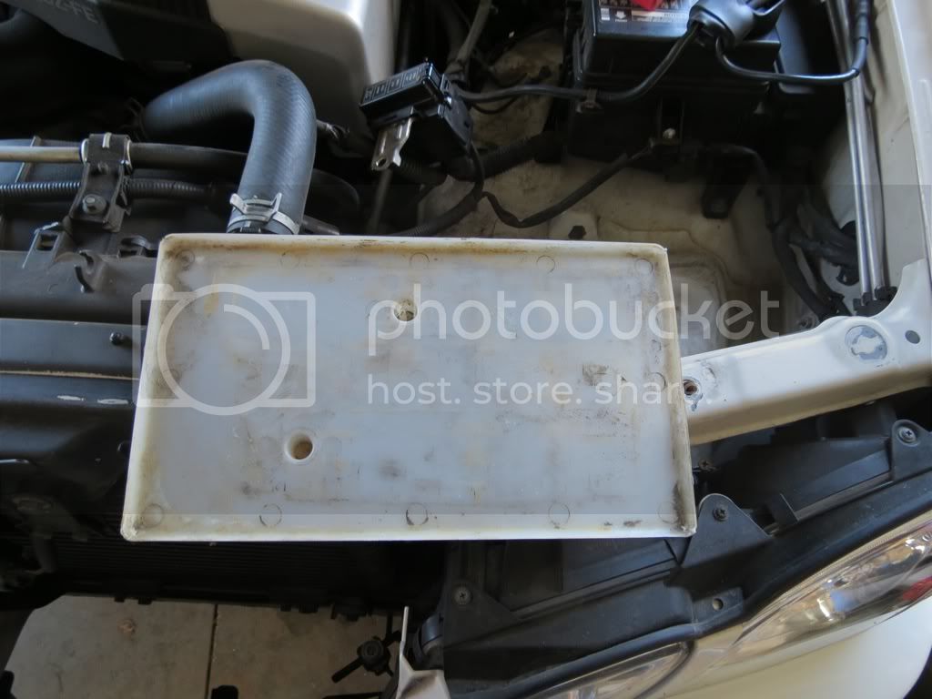

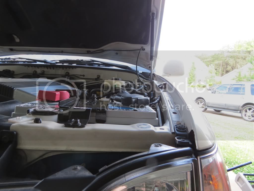

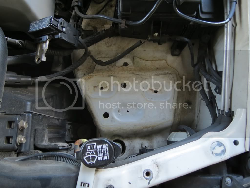

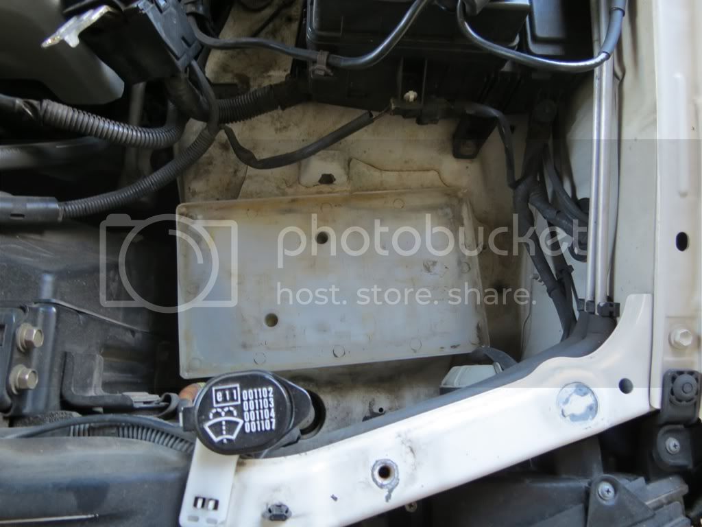

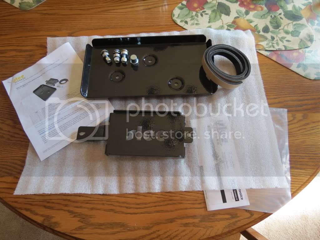

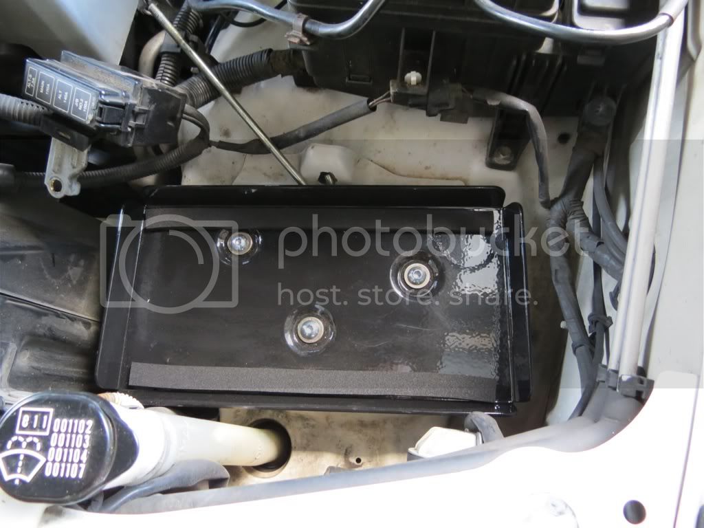

So the second battery tray that I made is holding up great, with zero movement. The group 31 that weighs about 80 pounds in the factory location has not moved any either but I was still not comfortable with the fit of factory hold down and the fact that it was meant for a battery of half that weight. I ordered a Slee Battery Upgrade Tray designed specifically for the 100 series Land Cruiser and LX470. It is made to fit a Die Hard Platinum group 31m. I must say that Slee Offroad has some great customer service. I sent an email asking several questions before placing my order and got a nice long response within a couple of days from a person that I believe is the owner. I placed my order by phone and got the same level of service. It arrived packaged well with a complete book of installation instructions which include pictures. They also sent a sticker :wings:
The old plastic tray.
Plastic tray removed.
Slee tray installed. I had to drill one hole.
Completely installed.
The fit and finish on this thing are great. It is a substantial chunk of metal and it holds the battery in place, so I am happy.

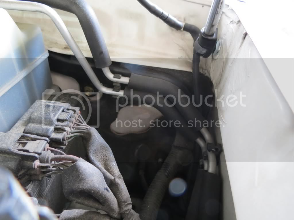

Wires through firewall

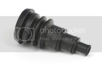

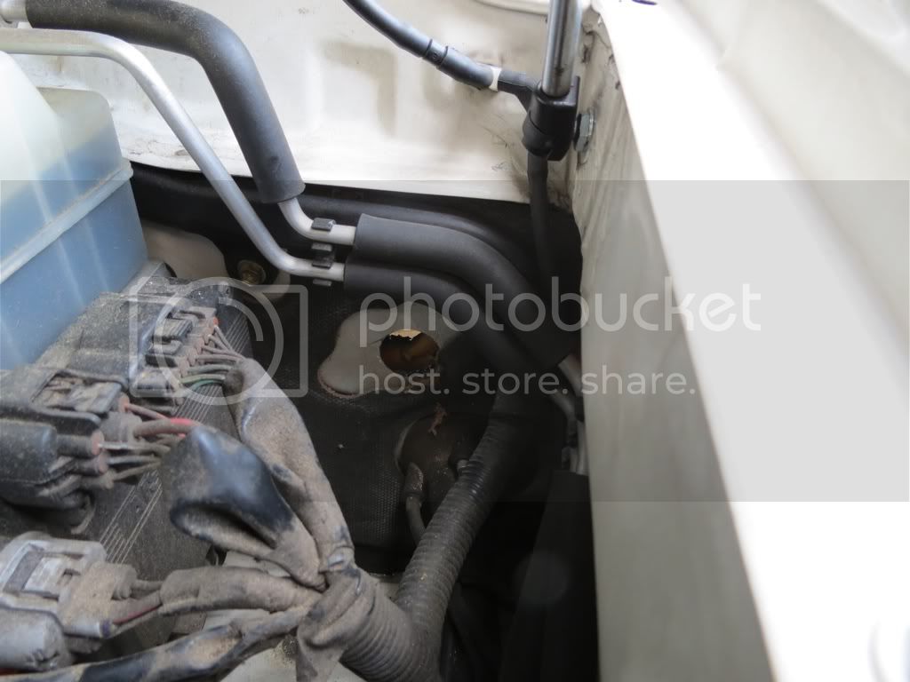

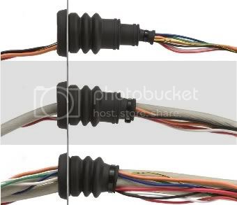

With all the new gadgets on their way I have been trying to figure out how best to route all the new wiring through the firewall while still keeping things factory looking and water tight. I came across this awesome bit of rubber in my searching.

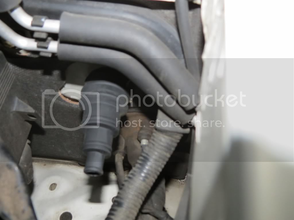

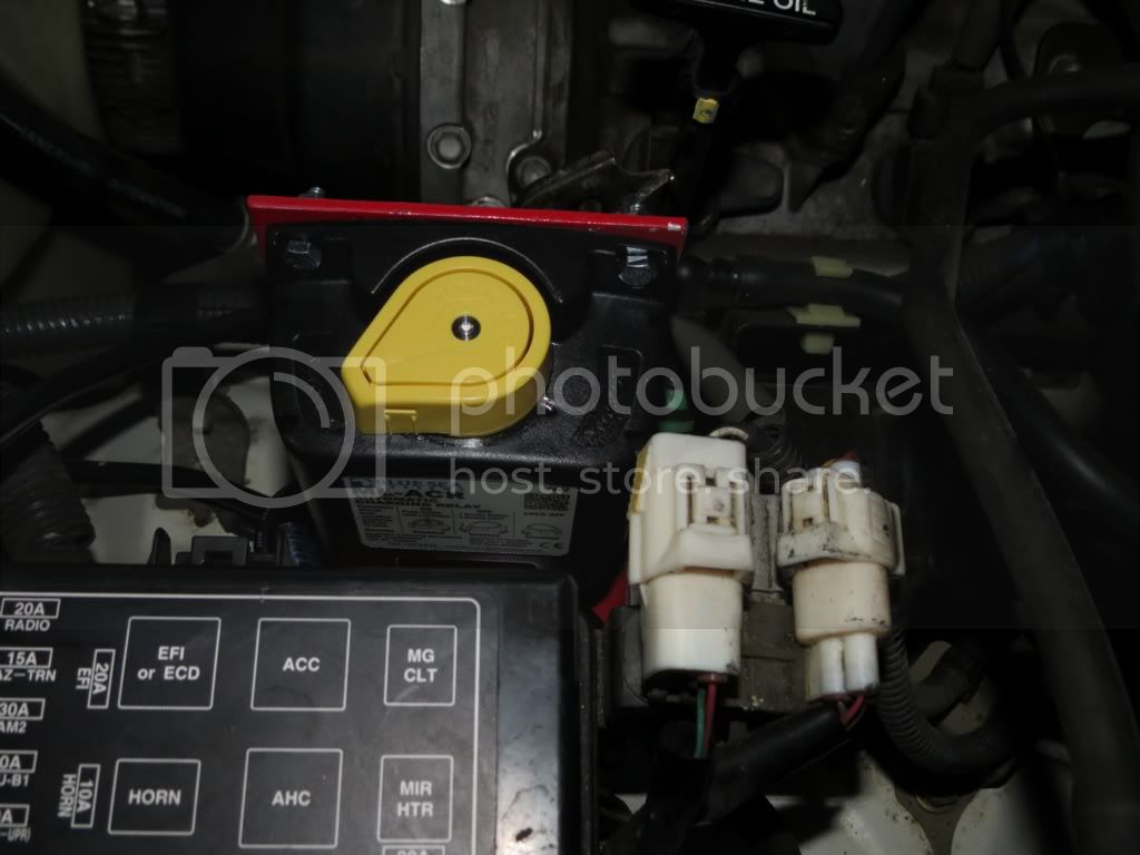

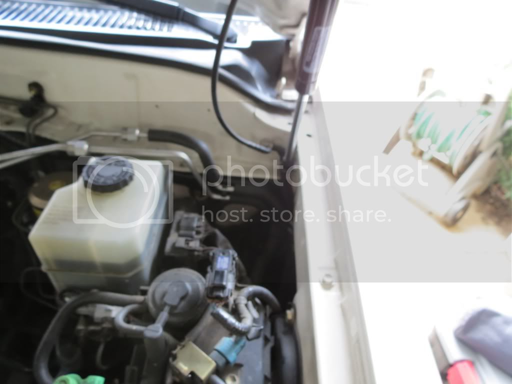

So I ordered one... next I had to find a good spot to install it. I found this area on the drivers side between the brake fluid reservoir and the fender.
From the engine bay. The ovalish area without any insulation.
From the interior side under the drivers side of the dash. There is the same ovalish shape missing from the insulation and a bolt spot welded in the center. this must be here for an option that I do not have or for the right hand drive vehicles over seas.

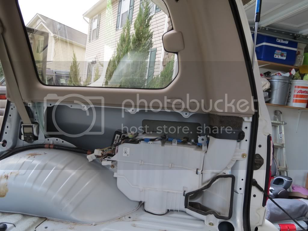

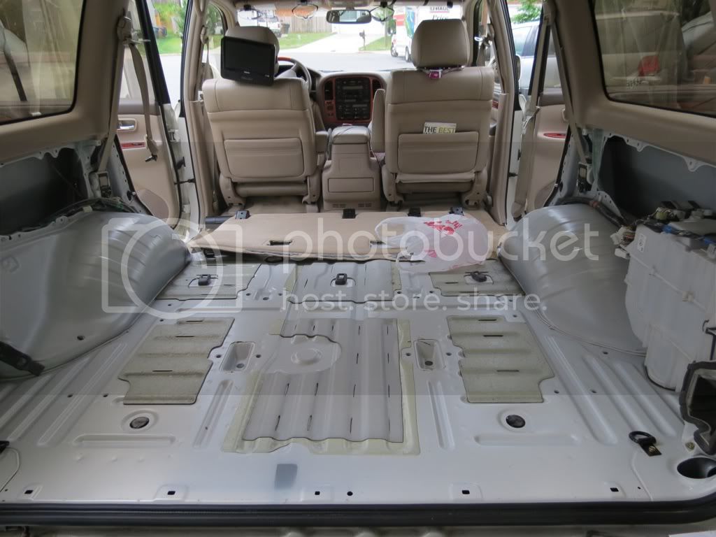

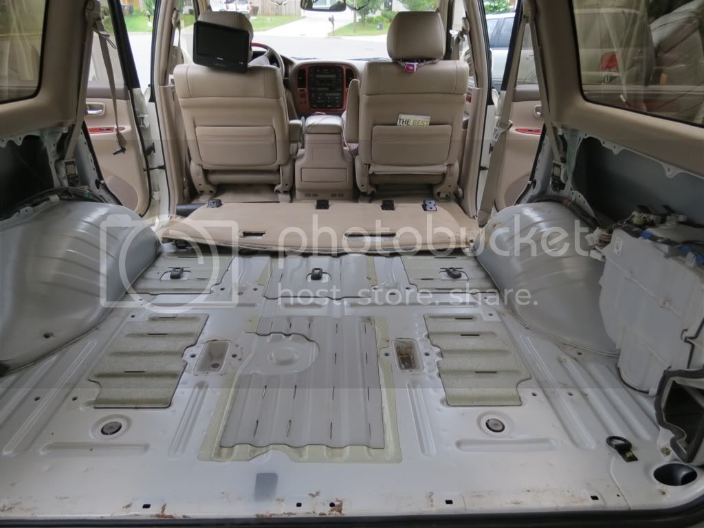

Current status of the LX is... after a lot of cleaning.
I am getting things ready for installing some new gear and found quite the mess when I started pulling things apart.
I have been soaking and scrubbing all of the plastic bits and carpet with this. Woolite and hot water does an amazing job of cleaning things up.

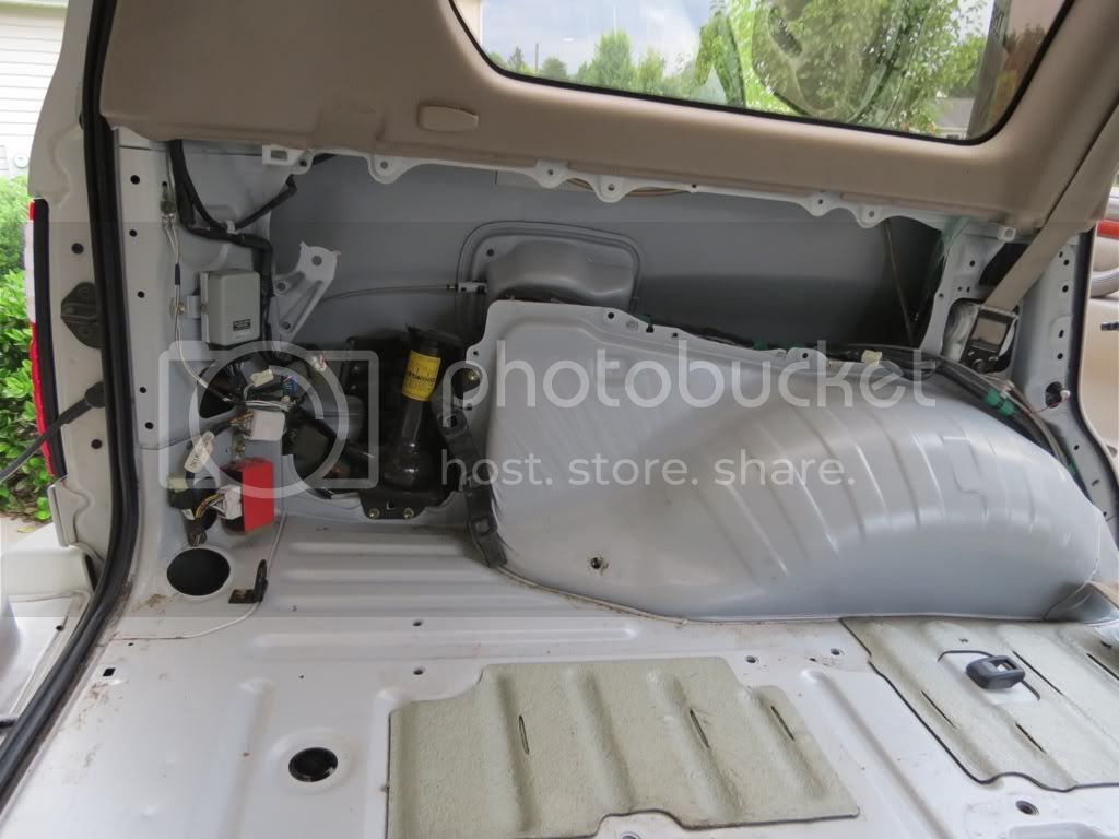

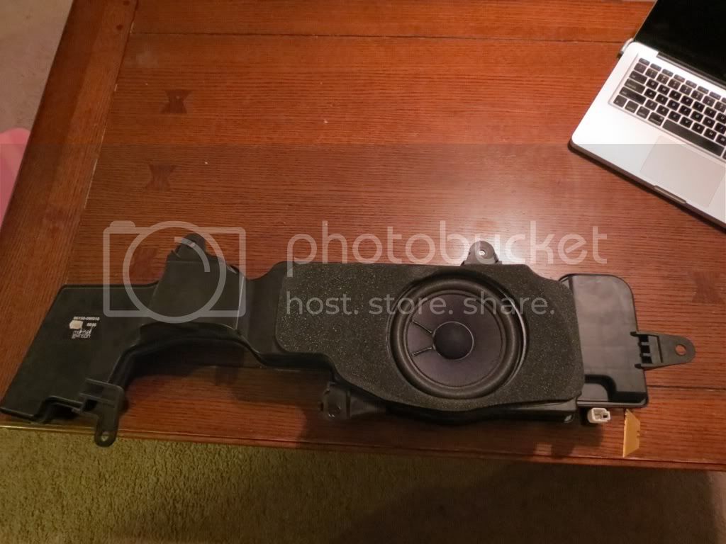

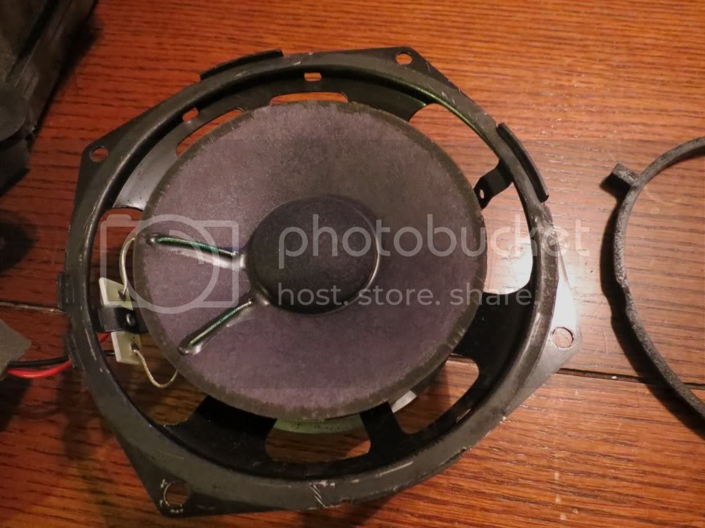

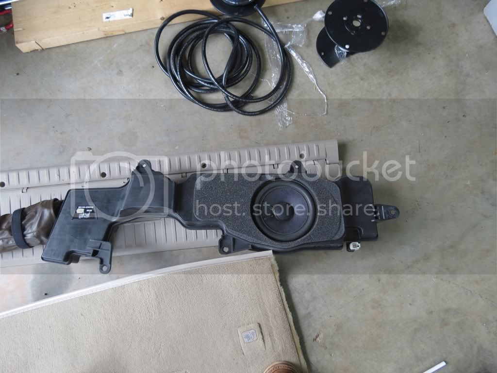

While I have things apart I figured it was a good time to repair my rattling Mark Levinson factory subwoofer.It has been blown since I bought the vehicle and has forced me to turn the bass all the way down to be able to listen to any music. I ordered a new foam surround kit from Amazon. I am still waiting on it to arrive but have already prepped the speaker for installation. It is as simple as removing the old surround with a razor blade while being careful not to puncture the paper cone. When the new one arrives all I have to do is glue it in place and reinstall the speaker.
Here you can see that the foam was blown out all the way around.
This is all ready for the new one to be glued on. I will post the final results once it arrives and I get it installed.

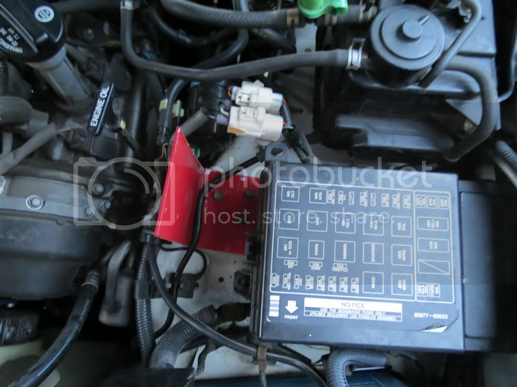

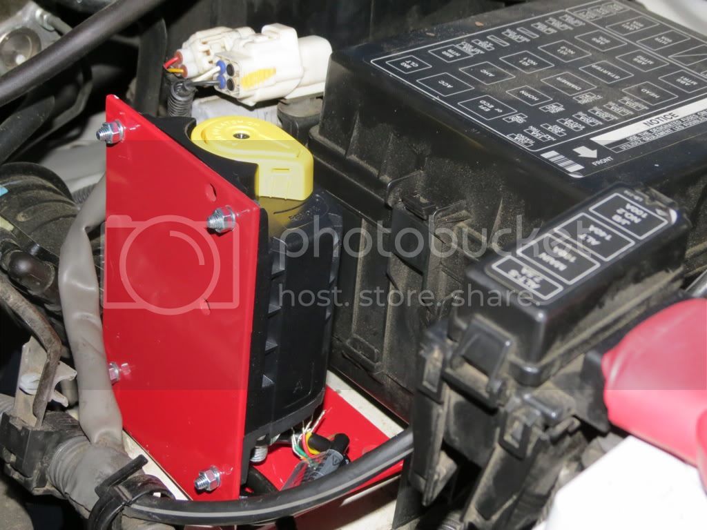

So after finishing that up much quicker than I thought it would be, I decided to make the bracket for mounting the Blue Sea ACR. I had a few pieces of scrap aluminum that already had good bends in them so the bracket was pretty easy. The hard part was deciding where it should go. In the end I put it close to the starting battery where I only had to move a few wires. It still needs some work and a coat of black paint.
