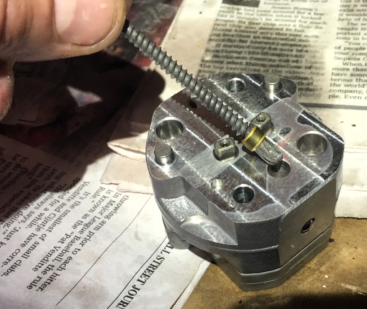

Internal layout of AHC Pump sub-assembly:
"Notch" position on gear case relative to By-pass Strainer:
Withdrawing Inlet Strainer for inspection and cleaning (same method for By-pass Strainer):
MORE PICTURES -- SEE PREVIOUS POST FIRST:
Withdrawing Inlet Strainer for inspection and cleaning (same method for By-pass Strainer) -- Pic 2:
Pump sub-assembly internals:
Detail of Pump Body, Gears, Gear Carriers:
Note the following at the picture below:
  • See position of O-rings on the Gear Carriers,
  • Check condition of O-rings, replace as necessary as recommended by @BullElk,
  • Composite back-up rings which fit between the O-rings and the end-cap of the AHC Pump sub-assembly with the "triangular" O-ring,
  • Check condition of the back-up rings,
  • Check condition of the "triangular" O-ring,
  • Check condition of gears -- look for uneven wear on teeth,
  • Check condition of Pump body -- look for signs of wear, looseness of fit,
  • When assembling the Pump, push composite back-up rings into the end-cap, not on top of the O-rings, AND, double-check the position of the "notch" in the one of the Gear Carriers, then reassemble taking care not to over-tighten (to torque the short bolts, use FSM guidance for the longer bolts which attach the Pump sub-assembly to the overall assembly),
  • When reassembled, the gears should turn easily with the fingers -- if not, something is wrong, either the end-cap is too tight, OR, the O-rings and back-up rings are not correctly seated -- FIX,
The above details are really important -- especially the correct position, seating and condition of all o-rings, back-up rings and seals -- if not addressed correctly, the Pump will perform poorly or may not work at all. As gear pumps go, this is a micro-pump and all tolerances are very fine.
ENLARGE THIS NEXT PICTURE TO SEE O-RINGS AND BACK-UP RINGS ON THE GEAR CARRIERS:
If the Pump Body is degraded as shown below, replace the Pump sub-assembly. If considering a second-hand Pump but cannot dismantle and check, best to forget it and buy new from IMPEX or PARTSOUQ or MEGAZIP or AMAYAMA.

It's been suggested more than once, you post pictures. They are worth a thousand words. Personally, I take a ton of pictures. The pre and during disassembly pictures are so helpful, during assembly.
So I have captured a part below of your UPDATE 4 >>> 5/21/24 -ADDITIONAL INFO IN RED ABOVE to make it easier for others such as @2001LC , @suprarx7nut , @BullElk , @Moridinbg or anybodyelse familiar with the internal details of the AHC Pump (or any gear pump) to help with the diagnosis and offer comments on the symptoms described and also critique my interpretation below:
@suprasvobodea >> UPDATE 5/21>>>> " HOUSTON ... WE HAVE A PROBLEM!! " - When i removed the flare nut from outlet of pump assy , and had 12V applied running, i was able to STOP THE FLOW OF OIL WITH MY THUMB!! There is NO WAY to prevent even a garden house with 30 psi pressure to prevent water from exiting with your thumb!!!!! WHen i removed my thumb, there was a weak stream of oil . SO .... THERE MUST BE SOMETHING GOING ON WITH THE NEW PUMP I INSTALLED FROM IMPEX! The question is , WHAT DO I DO NOW? I know i need to remove the pump assy and but what do i look for with a new pump gear set from the factory? How can a brand new pump NOT WORK PROPERLY?? Is this the source of my problem? it sure is suspicious!!
@IndroCruise: If poor AHC Fluid pressure and flow delivery from the recently installed new OEM AHC Pump from IMPEX is as you describe, then the following possibilities come to mind:
  1. There is a problem with the motor driving the AHC Pump -- this seems most unlikely and I think that you would sense any motor problems when you were running the Pump directly from a 12 volt battery, OR,
  2. The seal at the small drive connector between the Electric Motor and the Pump is damaged or not seated properly and allowing the AHC Pump to suck air, OR,
  3. The small drive connector between the Electric Motor and the Pump somehow has become un-seated and is not engaging properly with the Motor or the Pump, causing the Pump not be driven properly, OR,
  4. When you took the cover off the new AHC Pump sub-assembly to inspect the gears, the composite back-up rings which sit on top of the o-rings on each of the two gear carriers, or these two o-rings themselves, may have become slightly dislodged. If so, this would cause these two o-rings not to seal properly and this would allow fluid to by-pass internally within the AHC Pump, passing through the by-pass strainer back to the Inlet side of the Pump -- meaning some fluid would be re-circulating, causing low delivery flow and pressure at the Pump discharge, OR,
  5. The triangular-looking seal (like an o-ring) on the underside of the cap-plate of the AHC Pump sub-assembly is damaged or not seated properly -- a failure of this seal would have the same affect as item (3) above,
  6. The two gears and the gear carriers are not seated properly -- this would have the same affect as item (3) and item (4) above, OR,
  7. The set of two gear carriers have been wrongly installed with "notch" on the Discharge side of the Pump. This should be on the Inlet side below the by-pass strainer. If not correct, the Pump cannot deliver correct flow and pressure and may barely work at all, OR,
  8. The Inlet Strainer (and possibly but less likely the By-pass Strainer) may be fully or partially blocked with debris from within the system, OR, by sludge which inevitably builds up within the sysyem and may have been disturbed as a result of component change-outs OR may arise from incorrect non-AHC Fluid used at some time in the history of the vehicle, OR, gel which seems to have arisen in defective AHC Fluid in the USA market (associated with the one-litre plastic bottles). Any of these causes would inhibit fluid being drawn from the AHC Tank into the AHC Pump.
All of the above are possible, especially in an AHC Pump which has been disturbed internally.
Of these alternatives, item (8) -- Inlet Strainer partial or complete blockage -- seems more likely than the other alternatives.

U{DATE 7 -6/5/24 _ The saga continues...
I disassembled the NEW pump again, to check the location of the notch. I have a picture below of its position. Per INDOCRUISE, the notch is toward the inlet which he said is the low-pressure side. ! When I applied 12V to the pump, the horrible thing was ..... IT DID NOT PUMP A STREAM FROM THE OUTLET. It DID, when I checked in on the LX and again when it was removed and just propped on the radiator !! But when i carefully reassembled it, AND the notch is per the picture below after I disassembled it , it FAILED TO PUMP!
Remember, this is a BRAND NEW pump, never been used! and now it does not pump! PLEASE, can someone, tell me what is wrong with a brand new pump that does NOT WORK? I inserted the backup seal for the gear into the other half of the mating part and the O-ring onto the gear shaft - per INDOCRUISE details above in post #85. My parts look like his in the same post.
ANOTHER NOTE; and this could be important to more experienced hands than mine................ When I applied 12V directly in the correct polarity, it spun and hummed nicely- NO aeration or noise. HOWEVER.... when I reversed the polarity, the pump did NOT MOVE. The leads got very hot in 5- 8 seconds, which tells me something is wrong. ! I can move the gears in both directions when i remove the motor to get access to the direct drive notch. The motor ran in BOTH directions when it was removed from the pump housing... so I know the motor is good. But why is my new pump, LOCKED, and not working in the reverse direction ..? INDOCRUISE, SUPRARX, 2001LC,.... anybody ever have this happen to them ..? Could this be why it is NOT pumping oil in normal polarity .?
Remember, I used a screwdriver in the notch when the motor was removed, and could freely turn in both directions. But connected .... it almost melted the leads because the pump was locked up. But runs great in the correct polarity .
I MUST leave to go up to Wisconsin in 8 days .. and need to get this car working It's been 4 months since I have been able to use it. WHAT the heck to I try or do next ? I don't think disassembling the pump 5,6,7, or... times will do anything. Do I need to buy another NEW pump assy now ?? or what.
These are the positions of the two gears and halves.
Now, I have a new pump, that does NOT work when 12V is applied, I can hear, and feel it spin, but Oil only drips out of the outlet.!!!! UGH!!!!!!!!!!!! I need this LX working and driveable in the next 8 days !
HELP ME OBIE WON KENOBIE... your my only hope ..!

Your gear orientation appears correct according to my reference photos when I dismantled a pump.
My attempt at helping here:
1. Assume the pumps were always perfectly fine. They weren't broken before and they're not broken now.
2. Assume the reason you weren't/aren't seeing flow is a priming issue and/or air in the lines downstream.
3. Assume the fix is simply getting that pump full of fluid and purging gas from the system.
Those assumptions aside:
Install the new pump.
Get the reservoir full of fluid.
Connect via Techstream or your OBD2 app of choice that can see AHC data - do this to watch temp on the pump to avoid any crazy over-temp situations.
Unplug the pump connector from the car.
Make your own circuit with 10ga or larger wires and crimped on quick disconnect spade terminals and a switch of some sorts.
I have no idea how an AHC pump usually performs with no line attached to the outlet so I have no advice there.
Plumb the lines to the pump normally.
Remove the reservoir from the pump.
I assume there's a small column of fluid you can now see which leads into the pump.
Click the pump on with your makeshift switch.
Does fluid move? Quickly?
Tell us, preferably with pics. :)
Now, if it moves quickly, refill it. Move quickly still?
If so, check that reservoir for blockage. Any chance it's just not allowing fluid to flow in? Perhaps a blockage from debris disturbed during your overhaul. If you can't see anything in the reservoir causing issues, install it again. Now do the same little test. give it a little click on and listen to the pump. Same sound? same presumed fluid movement? If so, you're moving fluid and the goal is to get creative to purge gas from the system.
If the above method doesn't move fluid, I'm not sure what to do. The pump is a very simple mechanism. If it spins, it should pump. @BullElk messed around with an o-ring and had some resolution to his situation. @Moridinbg had a crazy experience in South America with multiple pumps that ran into the same code. Outside of those instances, we've seen countless other people fighting purging issues. Once purged, all is well.... normally.

The description below is with the replacement pump that has never been used, but I DID OPEN IT UP ( STUPID !) I have another new pump (AHC Pump sub-assembly 48901-60010) on order from IMPEX and i hope it will arrive by Friday. Until then, I want to see if this new pump that i have can work again.
I did as you described, and just filled the pump assy with oil, BEFORE attaching the reservoir so I could "burp" the pump housing by holding it at an angle where you can see that opening in the top of the AL pump housing that the tank grommet fits into. ( BTW- I bought a NEW grommet for that interface between the reservoir and AL pump housing. ) I watched the bubbles rise as I filled the pump through the 1" wide opening. When the fluid was no longer going into the pump gear area and was filled to the top of that opening, I applied 12 V directly to the pump and no fluid stream emerged when I removed the rubber stopper from the outlet ( I ll attache pictures when I go back to the garage to take them in about an hour) THIS..... IS A PROBLEM .. all i can figure out is it means ... there is still air INSIDE the gear pump housing as it is NOT sealing inside it. There is no pressure resistance to since the outlet is open to the atmosphere, but it should still send out a stream of oil like it did before I removed it from the LX and disassembled it to check the inlet and outlet tiny screens!!! NOW,..... I wish i would have NEVER done that .....
Well , I topped off the opening where the reservoir attaches and applied 12 V to the motor and got NOTHING! No fluid movement from the little pool in that opening . S I wish we could attach a video, but the forum says I have to have a . PNG or. GIF file, not a . MOV file so I cannot! I do appreciate all Ya'll help with this, YOU, INDOCRUSIE, 2001LC, MORIDINLG, and everyone who has contributed to this post. This is a wonderful gift and tool to help all of us, on a personal level. THANK YOU! 👏🙏🤠
