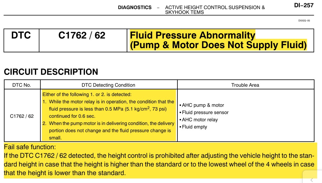

To put it simply:
Do you have only code 1762?
Yes: Then you have gas in the system. You need to purge the trapped gas.
No: Then chase after those other codes paying very close attention to any circuit that travels through the connectors at the rear driver side frame.
The fix for gas from other people I've dealt with has been to run the motor - using jumper wires if necessary - and bleeding out the lines. Active test is great if it actually runs, but it rarely does for me. Applying 12v directly to the motor (sometimes with alternating polarity to run the motor backwards) can help clear out debris, gel (from bad AHC fluid) or dislodge a stubborn gas bubble. When you bleed you should have absolutely perfect fluid only coming into your clear tube on the bleeder. Any tiny bubble is a sign you have more bleeding ahead of you. It can be very tedious.

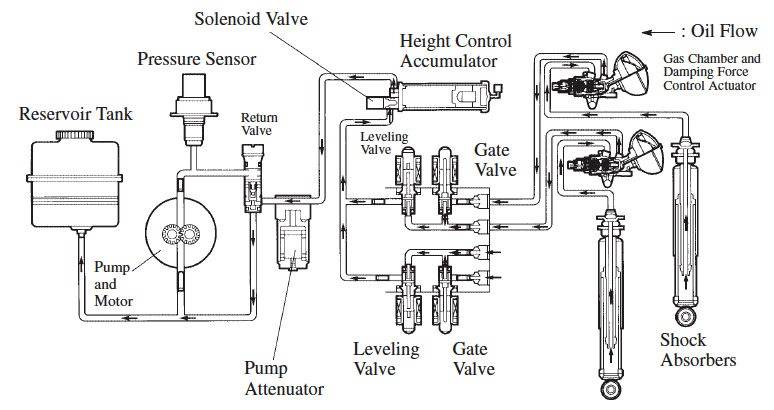

Some notes on so-called ‘over-riding’ of the “fail-safe functions”:
  • When the Height Control Operation Test (“Active Test”) does not work, it means a fault/DTC is preventing it from working and the fault and DTC must be cleared first before this test will work properly,
  • This test is designed into the system to facilitate adjustments -- it is not designed to override fault conditions nor the "Fail Safe Function",
  • When the Height Control Operation Test (“Active Test”) can work correctly, the ECU causes the AHC Pump to operate and also causes the Levelling Valves in the Control Valve Assembly to open as required to allow the vehicle to be raised or lowered,
  • The “Levelling Valves” (one Front, one Rear) are ‘normally closed’,
  • The vehicle cannot be raised or lowered unless the Levelling Valves are caused to open by the ECU – or unless the vehicle is lowered by dumping AHC Fluid from the bleeder screws,
  • Operating the AHC Pump without opening the Levelling Valves (such as by direct 12 volt connection to the AHC Pump Motor) cannot raise the vehicle because there is no signal from the ECU to the Levelling Valves to cause them to open,
  • The Solenoid Valve on the Height Control Accumulator is ‘normally closed’ -- the Solenoid Valve on a healthy AHC system only opens on a signal from the ECU to open (i) when the Height Control Accumulator is required to discharge at the start of a ‘raise’ to lift the vehicle, and (ii) when the Height Control Accumulator is being re-filled at the end of a ‘raise’ in readiness for the next raise,
  • The Height Control Accumulator has no other function in the operation of the AHC system,
  • The ECU will not signal to the Solenoid Valve to open at the Height Control Accumulator in the presence of a prohibitive fault/DTC which results in a “Fail Safe Function”,
  • When the AHC Pump is caused to operate using a direct 12-volt supply against closed Levelling Valves and a closed Solenoid Valve on the Height Control Accumulator, then the AHC Fluid from the AHC Pump has nowhere to go other than some fluid forcibly bypassing/shortcircuiting internally within the AHC Pump sub-assembly, and with the pump pressure hammering on seals and valves. All that will happen is noisy cavitation within the AHC Pump. Unlike industrial gear pumps, there is no pressure relief valve to protect the AHC Pump. Instead, the system relies on ECU-controlled protections such as C1718, C1C1736, C1741, C1743, C1762, and C1763 to quickly shut down the AHC Pump under FSM-specified conditions."

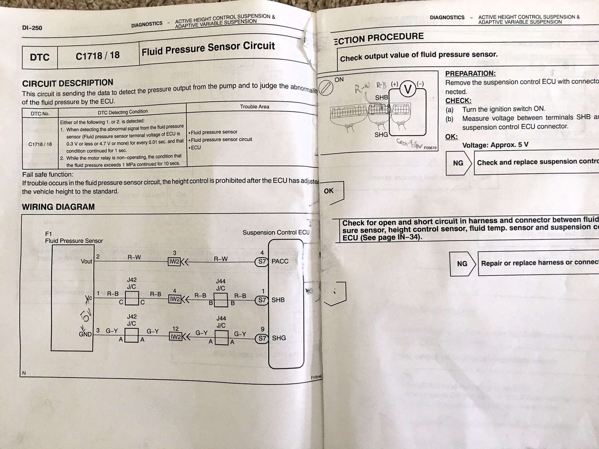

I have the same problem and after 60 hrs + of research, I will share my nightmare with you and everyone to help ease the pain and frustration. Suprarx7nut is correct on the Voltage specs for the pressure switch leads
Approx 5V at pin 1 of the pressure sensor to ground (pin 3).
1.48 to 1.85V signal from the pressure sensor (pins 2 and 3).
I get 5V at the ECU wire harness ( located by the driver's RH leg behind that metal plate under the steering wheel. I checked the V both at the pressure switch connected with a sharp probe (quite difficult to pierce the 18ga wire and not poke your finger holding it back but I did it! AND GOT 0.505 V!. This is NOT within the range of 1.48-1.85V when you depress the switch on the console,... so YOUR PRESSURE SWITCH IS SHOT AND YOU WILL NEED A NEW ONE! There is NO WAY to run the active test with this faulty pressure switch Voltage value at 0.5V !!
Here is the secret that has NOT been published in the TSM or by anyone on this forum before now, so you are the first one to get and hear this knowledge, please repost it to help every and anyone else with an AHC Lexus or LC that struggles with this issue.
<<<< If YOU RUN THE PUMP DRY WHILE FLUSHING OR CHANGING THE PUMP, REPLACING THE SHOCK BUSHING or REFILL THEM... anything that empties the reservoir while it's running,... IT WILL DAMAGE THE PRESSURE SWITCH! - AND YOU WILL HAVE TO BUY A NEW ONE. The cheapest I found it IMPEX out of Japan. They are USD 229 + shipping but that is a lot less than any US Lexus online parts shop. It takes a week or so to get but you will save $80-150 dollars on this one part ( Ask me how I know ..? :) )
I have gone through the REAR Hydraulic strut removal process and decided to cut access holes in the back cargo area to gain access to the 2 10mm bolts that are always rusted that hold the bracket over the top of the piston where the 2 gaskets are and it was THE best time-saving idea I had. I will be writing up a detailed, photo-supplied procedure that should help everyone who is too scared to tackle this job due to the other nightmare of accessing the top of those hydraulic "shocks " BTW >> ( they really are NOT shocks but actuators)
Feel free to contact me directly with any questions about this, or the Accumulator replacement, as I have done EVERYTHING now on my 2002 LX system and I want to help others!
I know all these things now after struggling for 3 months with trying to get the active test to work. It DID WORK after I bought a new pressure switch. but I didn't expect it to work and it drained a full tank of fluid. !!! I did NOT see it in time as I was in the vehicle ( big mistake! ) so I didn't know. I've checked the relays and fuses in the engine bay and the sidekick panel and all are working. The 4 step to check for code 1762 #4 is checking the pressure switch voltage and I get 0.5V when I press the UP-DOWN switch.
To bleed air from the Accumulator and globes, the PUMP MUST WORK first! I cannot manually get the pump to run due to the 1762 error! So how can I bleed if I cannot get fluid (and air) to travel to the accumulator and globes ....? This is my dilemma, so the only thing I know to do,it correct the only known problem ( out of spec V on the PS) and replace it again with a new one! If you know of ANYTHING else that could prevent an "ACTIVE TEST" from being performed, please offer any suggestions!
This is not the spec 1.48- 1.85V ... so by process of elimination, and by the TSM book ( not feelings or intuition...) that HAS to be the only reason it's still not working.! I have placed another order for a NEW PRESSURE switch from IMPEX of Japan and next week I will install it and, by God's GRACE and prayer..... it will work again. But I will be standing next to the reservoir and make sure IT DOES NOT EMPTY WHILE RUNNING! :)

My question is this,., Assuming that the pump gears may have air trapped in them... How do I remove any air IN the pump gears ... crack open the outlet fitting and let it drip for a few seconds ??
Next Question... Since I already know that the Pressure switch voltage is NOT IN SPEC (0.505) V, and the TSM says to REPLACE it if it is NOT in the range posted ... I need to start with this only parameter that is not per the TSM, so I just ordered ANOTHER PW and 1.5L can of Oil.
WHAT ELSE SHOULD I CHECK THAT IS PREVENTING THIS SYSTEM FROM DOING THE

Back to your C1762 @suprasvobodea:
With the added detail, you provided. I'm now thinking a short in wires, is not likely your issue(s). So let's table wire harness testing, for now.
One very big clue. Was running reservoir dry, after filling to with 1" of top/cap.
But can I get some more detail, before we getting into what I think is wrong and how to correct.

BEFORE I get the new PS and install it,.... After I clear the 1762 code on Techstream and try the ACTIVE TEST again, should I open the bleeder on the accumulator so the pump can pump fluid to the accumulator and open one or both of the front globes bleeder and see if fluid with exit them while pressing the up switch ...?? Would this purge any air (if there) in the struts? You said that you think there is air INSIDE the struts, but I filled them with oil and compressed them BEFORE I put the cap and 2 new o-rings on them.

2. You don't have code 1718, right? That code will flag if you've got a bad pressure sensor.

2. You don't have code 1718, right? right ! NO 1718 code ! That code will flag if you've got a bad pressure sensor.

Yes, 1762 is the ONLY code that I have from Techstream. I also think that a direct 12V to the pump to FORCE it to run is the solution, However, INDOCRUISE who is also a huge contributor summarized in very specific detail WHY running the pump directly with 12V, will NOT work to build pressure in the system ( The ECU won't allow the solenoid valves in the accumulator or globes open!!) read in post below;

On Pressure Sensor Test Voltages ….
I cannot contribute anything new on the dilemma of the consistently low reading of 0.505 volt reported by @suprasvobdea, equally when testing both the new and the old Pressure Sensor. I presume the tests were conducted exactly per FSM description, including with the engine running (not just with the ignition “ON”).
The fact that that the same erroneous low-voltage reading with two Pressure Sensors strongly suggests an open circuit somewhere -- meaning a broken wire.
This seems to be a likely cause of the "fail safe mode" which is preventing the vehicle being raised in the usual way to enable bleeding to proceed.
The hunt can be challenging. The discussion between @2001LC, @suprarx7nut and @Moridinbg provides a worthwhile review of their past experiences and gives some ideas on where to look -- starting at Post #249 through to Post #260 at this thread:

If I understand the reported sequence correctly:
  1. New Pressure Sensor installed,
  2. AHC Tank filled within 1” of the top,
  3. Started engine,
  4. Cleared existing DTC C1762,
  5. Started Active Test,
  6. Vehicle rose and green light for N indication appeared,
  7. Vehicle rose to standard height (means “N” height) or more -- unclear whether light was flashing or solid, unclear what height vehicle had reached – “N” height? More? Less?
  8. About ¾ of AHC Tank or about 1.2 litres was pumped into the system,
  9. “Heard” AHC Pump “run dry” (not sure what this means – as highlighted in the attachment below, the AHC Pump will stop in 0.6 seconds if it runs out of fluid and DTC C1762 will be indicated),
  10. Stopped engine,
  11. Refilled AHC Tank,
  12. Restarted engine -- but AHC Pump did not restart – or maybe ran for 0.6 seconds before DTC C1762 shut it down again???
  13. Vehicle returned to bump-stops (means “LO” height or lower),
  14. AHC Fluid returned from ‘shock absorbers’ to AHC Tank which had been refilled -- so an overflow was experienced
Firstly, just to be clear, and as fully described in an earlier post, the Gate Valves and Levelling Valves are different devices with different functions and operate in different ways -- please avoid confusion by NOT bracketing them together. “…. the solenoid/gate valves/leveling valves are supposed to be closed” is neither a correct nor helpful statement.
Secondly, the Levelling Valves ARE “normally closed” unless directed otherwise by the ECU – as described in the FSM extracts inserted in a previous post. [Whatever misgivings some may have experienced with the FSM, it is and remains the best documented guide available, aided and clarified by the reported experiences on IH8MUD and elsewhere].
You have experienced a repeat of DTC C1762, probably interrupted when the engine was turn OFF the first time, and repeated again when the engine was restarted.
This would certainly occur in the sequence described) and to go with this DTC you have experienced the “Fail Safe Function” prescribed in the FSM for this DTC and which is governed by the ECU -- see extract below -- specifically:
  • height control is prohibited -- so the AHC Pump stops as directed by the ECU, and,
  • the vehicle height is adjusted (by the ECU opening the Levelling Valves) to the standard height (meaning “N” height), OR,to the height of the lowest of the four wheels – and in this case the ECU has used inputs from the Height Control Sensors and determined that the relevant height is “LO” height and so the vehicle has been lowered accordingly, and,
  • the height selected by the ECU for the purposes of this “Fail safe function” will be determined by the voltage signals coming from the Height Control Sensors to the ECU -- these in turn will be affected by the condition of the Height Control Sensors AND any slope on which the vehicle is parked.
The reported experience including the return fluid and the overflow is exactly as would be expected from the given description -- all part of the learning experience which we all have been through ....

"Can pump run, gates closed and pump fluid out through height accumulator bleeder?"
I've not tried it. But based on below diagram, YES! Try it! Just remember: Never put your body or limbs in position of danger under vehicle.

I cleared the 1762 code and as soon as I turned on the car and did the active test by pushing the DOWN switch, it immediately got 1762.
Im again past frustrated and ready to sell this damn thing. The electrical wire issue I tried ( between the Accumulator and ECU was good. ) I can't access the large gray connector on top of the frame on the Drives side rear wheel ( per 2001LC -body-off-frame pictures in post
The ABCs of AHC - How to Measure, Flush, and Adjust all in one place - https://forum.ih8mud.com/threads/the-abcs-of-ahc-how-to-measure-flush-and-adjust-all-in-one-place.1211999/page-13#post-14465654
from 2001 LC is nice, but the truck's body is removed! :) Since my LX was working before I opened up the system and replaced everything, and I didn't touch anything electrical under the back rear vehicle ( just the midsection to remove the supply line from the accumulator to the pump attenuator by the PS frame- due to a rounded flare nut!!!! ).
If ANYONE reading this thread has any more specific ideas about specific connectors or impedance checks on specific wire harnesses per the TSM or your own experience, PLEASE let me know. I truly appreciate all the suggestions so far and have implemented them ( except for that large gray rear connector on top of the DS rear frame rail- as explained above)
All I can think of anymore ., is to wait till another new PS arrives, install it, fill the reservoir, start the LX with the ACTIVE TEST, and see if it will work again. I am truly at the end of my game here and don't know what to try to think to do anymore...... I wish one of you guys was close to Dallas TX. I would like to meet you first of all, and then tackle this problem, in the flesh until we beat it int submission.
