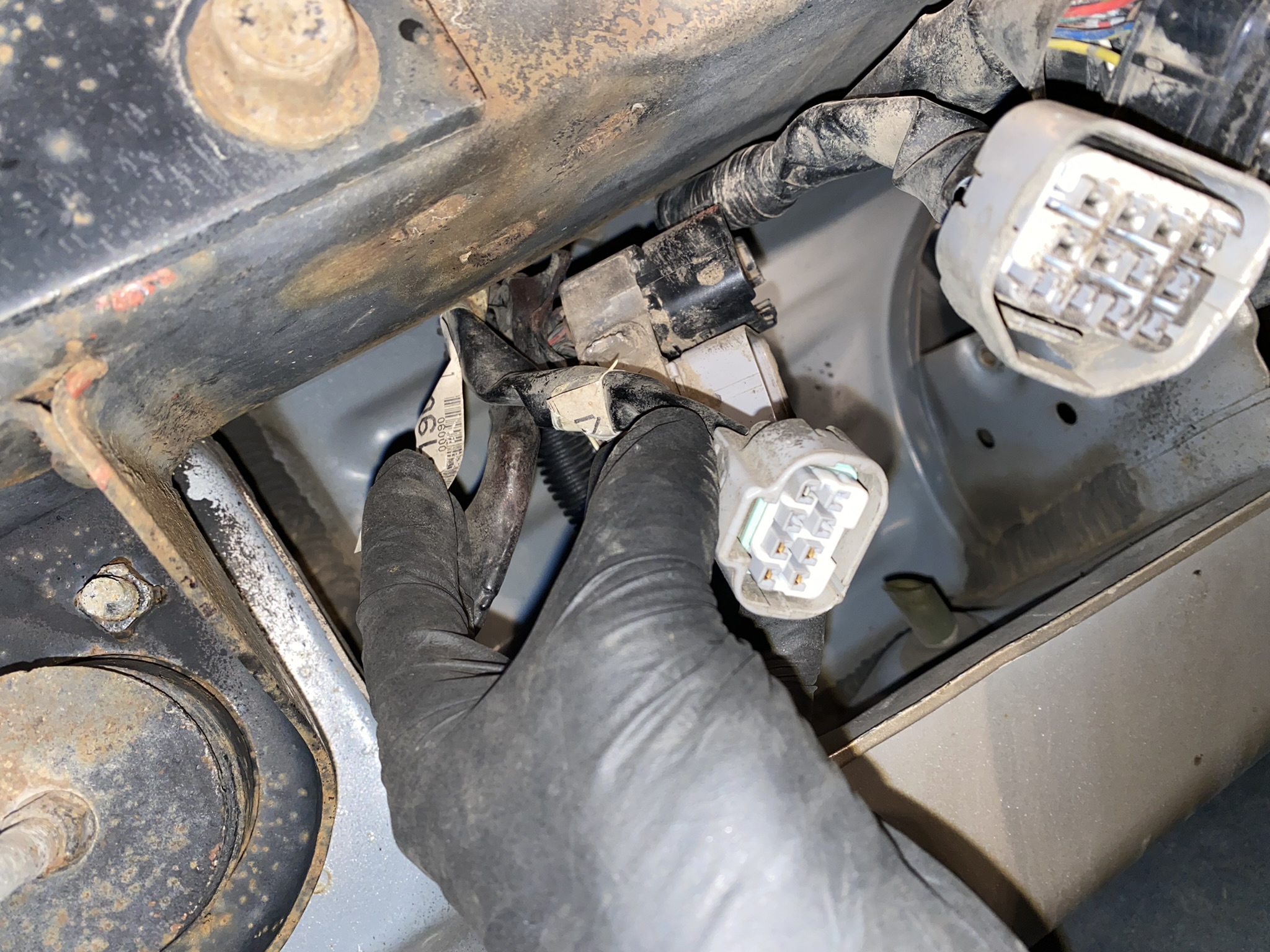

I think I found that gray connector in the DS rear axle on top of the frame, but it is even MORE inaccessible than the top of the strut that I cut a hole to access the top two 10 mm bolts and end cap! I too had to raise the rear with jack stands, as my LX is resting on the stops (and is as low as a Corvette now,). Please let me know if anyone can tell me HOW to access this large gray connector that rests on top of the frame rail on the driver's side I might try to disconnect it, but it may not be worth it. I don't think I need to go there, as the system DID WORK with a new PS after I installed it and I ran the reservoir to almost empty and heard that "noise " of an empty tank! and shut down the engine.
I cleared the 1762 code and as soon as I turned on the car and did the active test by pushing the DOWN switch, it immediately got 1762.
Im again past frustrated and ready to sell this damn thing. The electrical wire issue I tried ( between the Accumulator and ECU was good. ) I can't access the large gray connector on top of the frame on the Drives side rear wheel ( per 2001LC -body-off-frame pictures in post

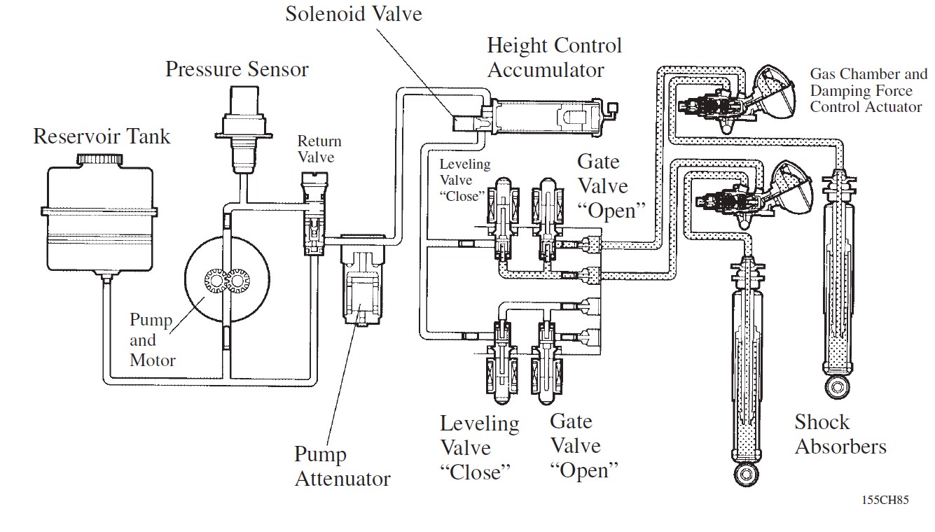

Given the previous descriptions, there is no room for doubt that there is air in the AHC system -- which makes this the first cause of DTC C1762 to pursue as held all along by @suprarx7nut
[but this is not the only possible cause, other examples exist such as
  • example by @BullElk (worn internal O-rings between the gear carriers and the top-plate of the pump sub-assembly),
  • example by @IndroCruise and others (fully or partially blocked Inlet Strainer just before the gears inside the pump with many previous posts and pictures given on this topic),
  • possible Pressure Sensor failure (extremely rare, not experienced by AHC professionals such as @suprarx7nut and @2001LC, not found by Search in IH8MUD100 series Forum,
  • DTC C1762 also has been reported in parallel with other DTC's and conditions which were the root cause.
@suprarx7nut recommends clearing air from system by direct connection of the AHC Pump Motor to a 12 volt battery and running the air out through one or more bleeders.
[The intention to start the attempt with the bleeder at the Height Control Accumulator certainly is a very good idea -- once air-infected fluid is in the Height Control Accumulator, it is sent throughout the system and infects everything when the Height Control Accumulator next participates in raising the vehicle. Eventually, the air-infected fluid returns to the AHC Tank (except for the portion trapped in various places in the system) – and in the AHC Tank it may dissipate to atmosphere, or, the air-infected fluid may be sent through the system again!]
@2001LC also suggests just try the direct 12 volt connection and see what happens.
@Moridinbg reported at Post #251 at The ABCs of AHC - How to Measure, Flush, and Adjust all in one place - https://forum.ih8mud.com/threads/the-abcs-of-ahc-how-to-measure-flush-and-adjust-all-in-one-place.1211999/page-13#post-14466838 that he had tried this and it did not work for him (as also noted in my previous post #34 in this this thread) -- with other experiences further described by @Moridinbg in his subsequent post #50, next below in this thread.
@IndroCruise (me) is sceptical for reasons given previously about whether direct 12 volt connection would work -- also sceptical that the solenoid valve on the Height Control Accumulator will open without the required signal from the ECU.
LATE EDITED NOTE 1: If there has been no bleed from a working bleeder at the Height Control Accumulator, then there is no fluid in the Height Control Accumulator -- or possibly (but unlikely) the Height Control Accumulator is faulty** -- meaning that it is much more likely that the AHC Pump HAS NOT re-charged the Height Control Accumulator.
**LATE EDITED NOTE 2: Note that Height Control Accumulators pre-November 2002 are the subject of the warning in Technical Services Bulletin Reference CP-3006 (attached) which specifically advises of breakdown of an O-ring within the Height Control Accumulator, leading to blockage of the Inlet Strainer inside the AHC Pump and which specifically nominates DTC C1762. However, the Height Control Accumulator was replaced with new OEM in 2023.
For all of that, I would be VERY happy -- in fact delighted -- to be proved wrong on all and any of the above issues.
It certainly would make clearing air and gas problems sooo much easier!!
If the Levelling Valves and/or the Height Control Accumulator Solenoid Valve (on Techstream: SLFL = SoLenoid Front Levelling; SLRL = SoLenoid Rear Levelling; (Left and Right are not distinguished on Techstream); and SLAC = SoLenoid ACcummulator) are preventing fluid discharge from the AHC Pump, then strange noises are entirely unsurprising from a churning positive displacement gear pump.
When the AHC Pump operates, as a Gear Pump it must force fluid to flow somewhere, or stop, or break -- like any other Gear Pump, large or small. Several DTC protections exist on the AHC Pump because, unlike industrial gear pumps, there is no pressure relief valve protecting the AHC Pump. Unlike some other kinds of pumps (such as a centrifugal pump) a Gear Pump requires actual movement of fluid and cannot simply churn in an incompressible liquid.
If the discharge is blocked or valves are closed downstream, the only fluid routes available to the AHC Pump are via the clearances around the gear cases and gear shafts inside the Pump, then through the Bypass Strainer and back to the Pump Inlet Strainer, probably with some cavitation along the way -- or maybe -- directly across the top and bottom planes of the gears and around the gear perimeter if there has been enough wear to provide sufficient clearances. Whatever, any of these are very high resistance paths, pump performance will be poor and also very noisy.

I keep looking at my pictures and the diagrams I have prepared over years and also I have disassembled and stared at an old AHC Pump I have in my shed.
At the moment I am trying to figure out what actually happens when the AHC Pump is run in reverse.
Would this mean that the Pump Discharge to the AHC system then becomes the Inlet for all practical purposes?
I have wondered whether this would imply that AHC Fluid then is drawn into the Pump from pipework? Or somehow fluid is drawn from distant parts in the AHC system -- such as the Height Control Accumulator, ‘globes’, ‘shock absorbers’ – and if so, the various solenoid valves -- SLRL, SLFL and SLAC – must somehow allow this to happen?
However, the above idea makes no sense at all and does not fit your observations.
Clearly you have observed discharges and pressure rises in the line, sufficient to raise the vehicle in the circumstances you have described.
So is it more likely that the following happens when the Pump is run in reverse??
  1. AHC Fluid floods into the AHC Pump, gravity-fed from the AHC Tank in the usual way,
  2. The fluid enters the Inlet Strainer in the usual direction and then enters the gear chamber – but then passes through the middle of the Pump between the two gears while the Pump is operating in reverse, instead of around the outer perimeter of the gears as happens when the pump is rotating correctly and efficiently,
  3. The exiting fluid departs through the Pump discharge in the usual way, then the fluid moves onwards into the AHC pipework in the usual way,
  4. There will be unusual noise and vibration because the fluid is forced between the teeth as the fluid passes between the gears, also causing side pressure on the gears (which may be pushed into the chamber walls causing wear marks, also slightly tilt the gears causing scribing on the base of the gear chamber), and with side pressures on the gear-shafts and gear-cases as well,
  5. Excessive pressure developed between the gear teeth would be relieved (with noise and vibration) by fluid passing via the “notch” where one gear-case joins the other, then the fluid passes through the clearances around the gear-shafts and gear-cases, then passes through the Bypass Strainer in the usual direction, then returns to the Inlet Strainer in the usual way -- in other words, more fluid recirculates than would be the case with the pump in reverse than occurs in correct rotation,
  6. There will be sub-optimal flow and pressure developed by this reverse operation of the AHC Pump – but there will be adequate flow and pressure to perform as observed and described above,
  7. The fluid flow does not and cannot flow backwards through the Strainers and does not provide any ‘back-washing’ effect,
So I am overthinking this -- or I am missing something basic here?
Can you please help me clear my mental fog??
When the AHC Pump operates, as a Gear Pump it must force fluid to flow somewhere, or stop, or break -- like any other Gear Pump, large or small. Several DTC protections exist on the AHC Pump because, unlike industrial gear pumps, there is no pressure relief valve protecting the AHC Pump. Unlike some other kinds of pumps (such as a centrifugal pump) a Gear Pump requires actual movement of fluid and cannot simply churn in a liquid.
If the discharge is blocked or valves are closed downstream, the only fluid routes available to the AHC Pump are via the clearances around the gear cases and gear shafts inside the Pump, then through the Bypass Strainer and back to the Pump Inlet Strainer, probably with some cavitation along the way -- or maybe -- directly across the top and bottom planes of the gears and around the gear perimeter if there has been enough wear to provide sufficient clearances. Whatever, any of these are very high resistance paths and will be very noisy.

Those farme off picture, that show some gray wire connector blocks, aren't easily accessible. If we happen to isolate a wire, that passes through those. We just run a jumper wire bypassing it/them.
Laying on the ground behind DS rear mud flap, near rear bumper looking up.
Between DS rear body 1/4 tip and frame. Is where wire harness from cabin penetrate body and undercarriage wire harness connect. I've found two of the wire hosung block contain wire to AHC accumulator and controller.These wire are also for rear height sensor, globes, ABS trail lights etc.
This is the harness connected to accumulator, control, etc. That connect to the gray wire blocks hidden by body on top of frame.
