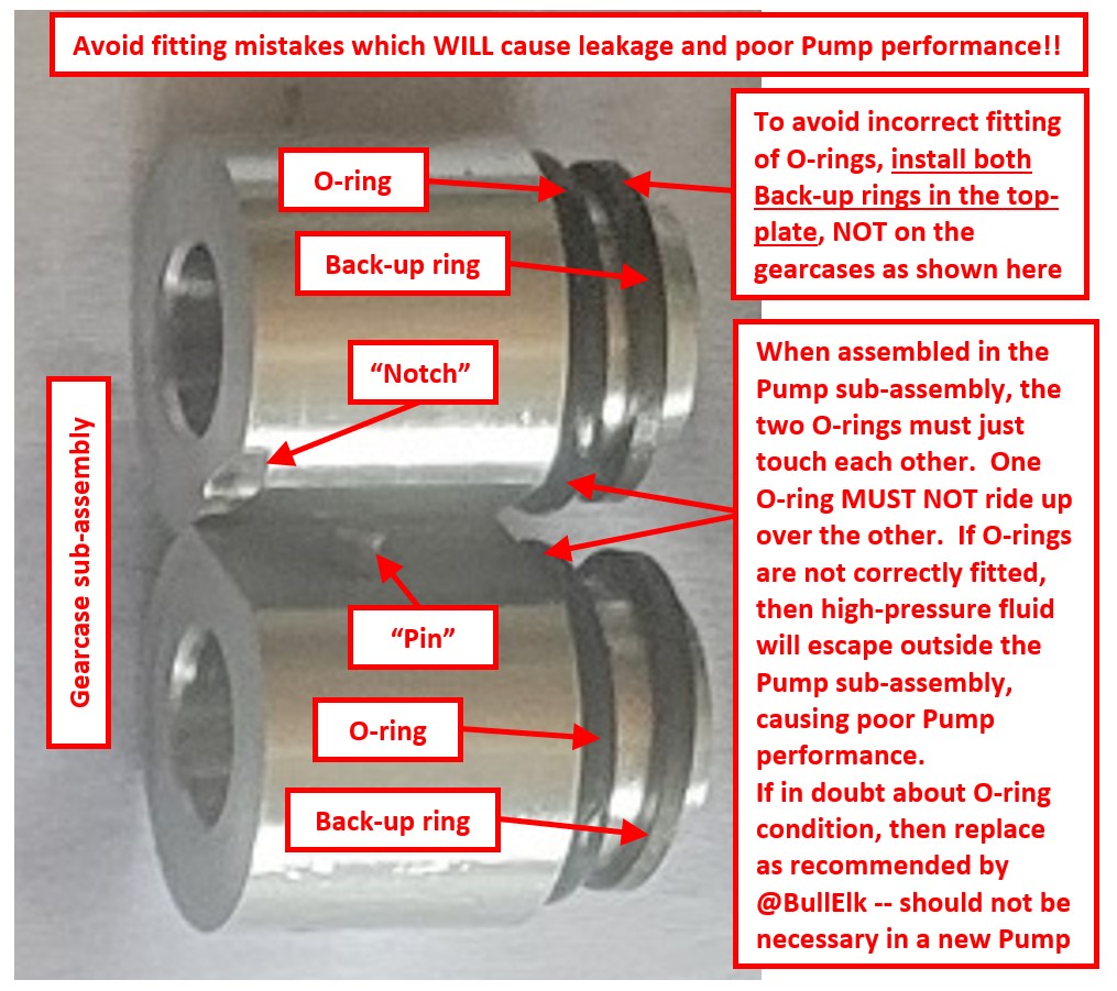

It is worth pursuing air inside the AHC Pump sub-assembly 48901-60010 -- but that is not the cause in my opinion.
My previous Post #98 (now edited for emphasis) means to say that "... the cause of lack of discharge from the AHC Pump in the subject vehicle is due to the dis-assembly and re-assembly of the AHC Pump sub-assembly with the top-plate insufficiently tightened – resulting in loss of Discharge pressure and flow due to internal FLUID leaks at the seals".
In other words, fluid is escaping past the seals and out of the AHC Pump sub-assembly 48901-60010 into the enclosure provided by the outer case.
It is most likely that the fluid is escaping past the O-rings at the gearcases OR possibly past the triangular O-ring OR possibly past the small O-ring at the Discharge.
Such leakage will not be visible because the Pump sub-assembly is enclosed in the overall assembly.
This is similar to the issue described previously by @BullElk.
Problems with seals are not uncommon with gear pumps (not restricted to AHC Pumps) and DO result in the situation described -- low flow or no flow and so poor or no pressure -- and of course a gear pump only develops pressure when there is resistance to flow.
In this case it MAY be possible to fix the problem simply by tightening the two bolts holding together the parts of the AHC Pump sub-assembly 48901-60010 and the two bolts attaching it to the main assembly.
Or it may be that the O-rings at the gearcases simply are not correctly seated.

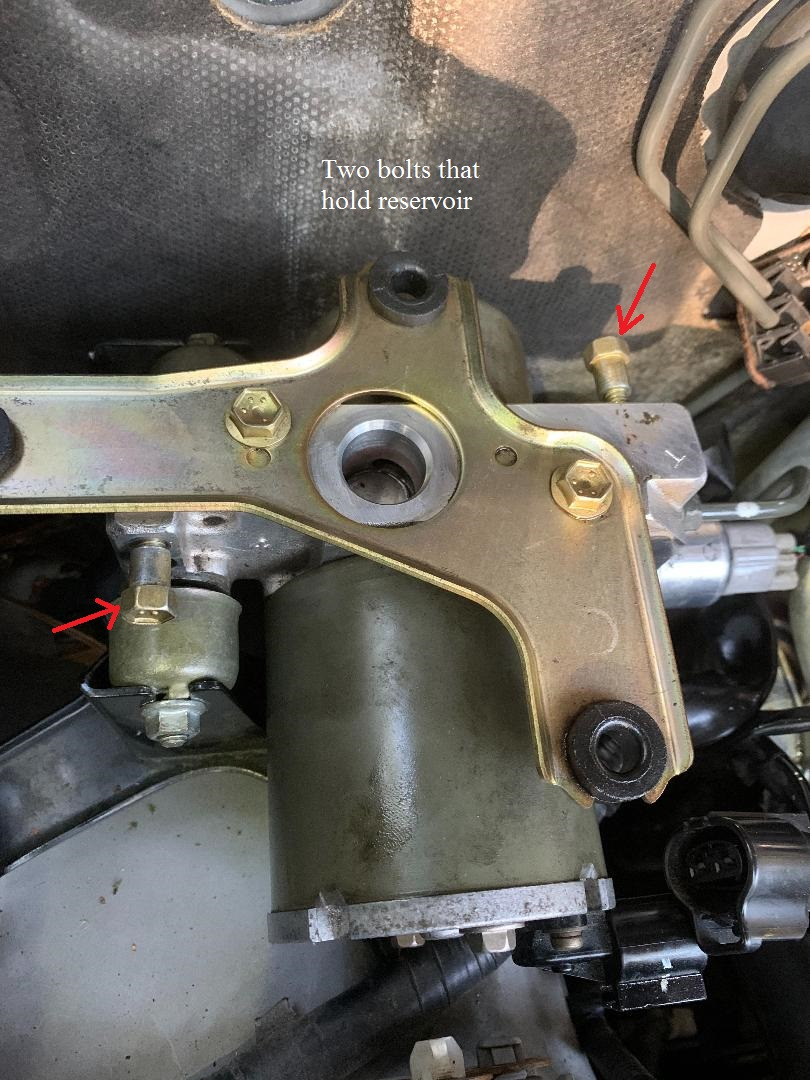

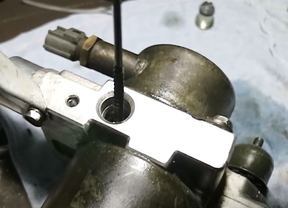

As SupraRx7 suggested I just filled the pump assy with oil, BEFORE attaching the reservoir so I could "burp" the pump housing by holding it at an angle where you can see that opening in the top of the AL. pump housing that the tank grommet fits into. ( BTW- I bought a NEW grommet for that interface between the reservoir and AL pump housing. ) I watched the bubbles rise as I filled the pump through the 1" wide opening. When the fluid was no longer going into the pump gear area and was filled to the top of that opening, I applied 12 V directly to the pump and no fluid stream emerged when I removed the rubber stopper from the outlet ( I ll attache pictures when I go back to the garage to take them in about an hour) THIS..... IS A PROBLEM .. all i can figure out is it means ... there is still air INSIDE the gear pump housing as it is NOT sealing inside it. There is no pressure resistance to since the outlet is open to the atmosphere, but it should still send out a stream of oil like it did before I removed it from the LX and disassembled it to check the inlet and outlet tiny screens!!! NOW,..... I wish i would have NEVER done that .....
Well , I topped off the opening where the reservoir attaches and applied 12 V to the motor and got NOTHING! No fluid movement from the little pool in that opening . S I wish we could attach a video, but the forum says I have to have a . PNG or. GIF file, not a . MOV file so I cannot! I do appreciate all Ya'll help with this, YOU, INDOCRUSIE, 2001LC, MORIDINLG, and everyone who has contributed to this post. This is a wonderful gift and tool to help all of us, on a personal level. THANK YOU! 👏🙏🤠
I just applied 12V to this and NOTHING changed in the fluid level!! What is wrong here ..?? Why won't the gears move the oil to the outlet? When I remove that rubber stopper, it just leaks out - when the pump IS RUNNING!

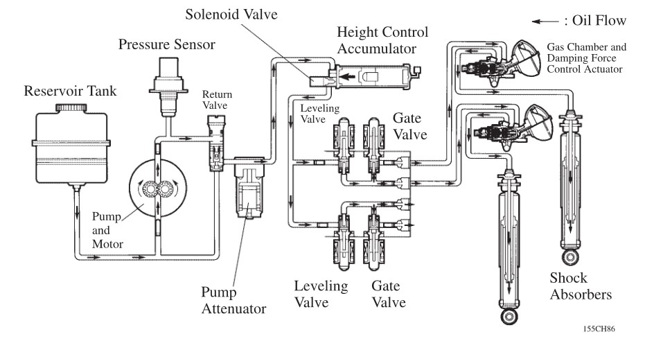

Air in the AHC system seems an extremely likely cause of DTC C1762 on this vehicle given the hydraulic circuit disruptions required for the component change-outs.
Along the way a fault with the AHC Pump has emerged. This is preventing the cause of DTC C1762 from being confirmed and preventing the vehicle from being raised and lowered as part of a normal bleeding process.
Even when connected directly to a 12 volt DC source, weak low pressure Discharge is observed from the overall AHC Pump assembly (the whole thing -- Part Number 48910-60012) on open circuit with Discharge pipe detached. This is described by @suprasvobodea as a dribble from the open Discharge which can be stopped with a finger, even while the AHC Motor and AHC Pump continue to run.
Clearly, AHC Pump does not develop pressure against resistance as it should (and indeed as any positive displacement external gear pump should).
It is the result of a fault in the AHC Pump assembly
There are only the following possibilities for this situation, some are more likely than others. For completeness, here they all are, starting from the motor and working towards the Pump sub-assembly:

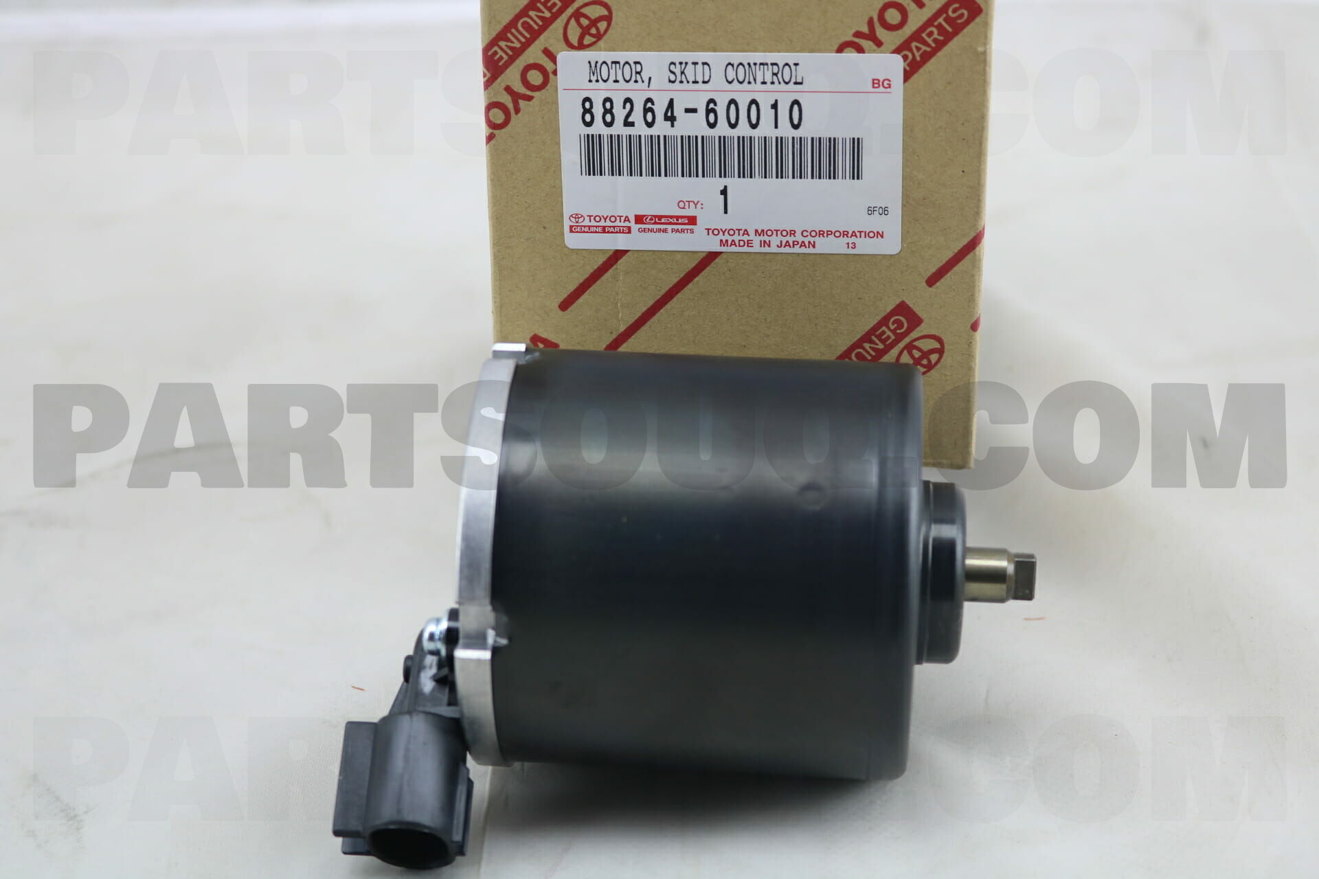

  • The AHC Electric Motor 88264-60010 is faulty -- this seems extremely unlikely, given that the motor works when connected to 12 volt DC supply, The pump is working . ITs a bit stiff, but it runs - in both directions.
  • The electric motor 88264-60010 is not engaging the Pump sub-assembly 48901-60010 properly – this seems highly unlikely -- but it is worth checking the small connector “shaft” 48977-60010 which passes through the milled aluminium housing 48905-60010 and through a seal 90311-10001. This tiny “shaft” connects the motor on one side of the housing and the driven gear in the Pump sub-assembly 48901-60010 on the other side – and it is worth being satisfied that all parts are engaging properly, I watched the opposite side of the pump , where the other side of the gear shaft it and i see that the ends of the shafts are spinning. - The tiny shaft is functioning!

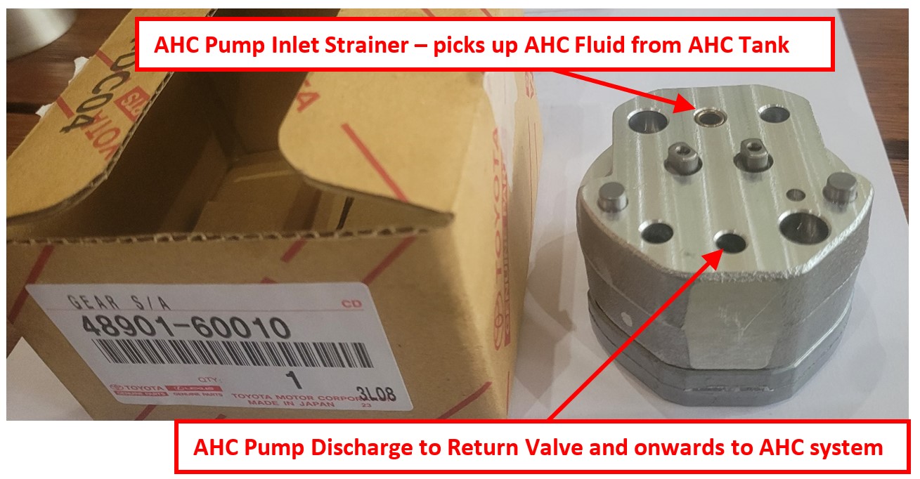

  • Air is being drawn into the AHC Pump sub-assembly 48901-60010 -- this is possible and certainly would cause DTC C1762– it is important to be satisfied that the following seals are working as intended, not wrongly fitted, loose, worn or damaged in some way which would allow air ingestion due to negative pressure (sucking) on Intake side of the AHC Pump sub-assembly 48901-60010 when it is operating:
    • seal 90385-08017 between AHC Tank and Housing 48905-60010, REPLACED with NEW

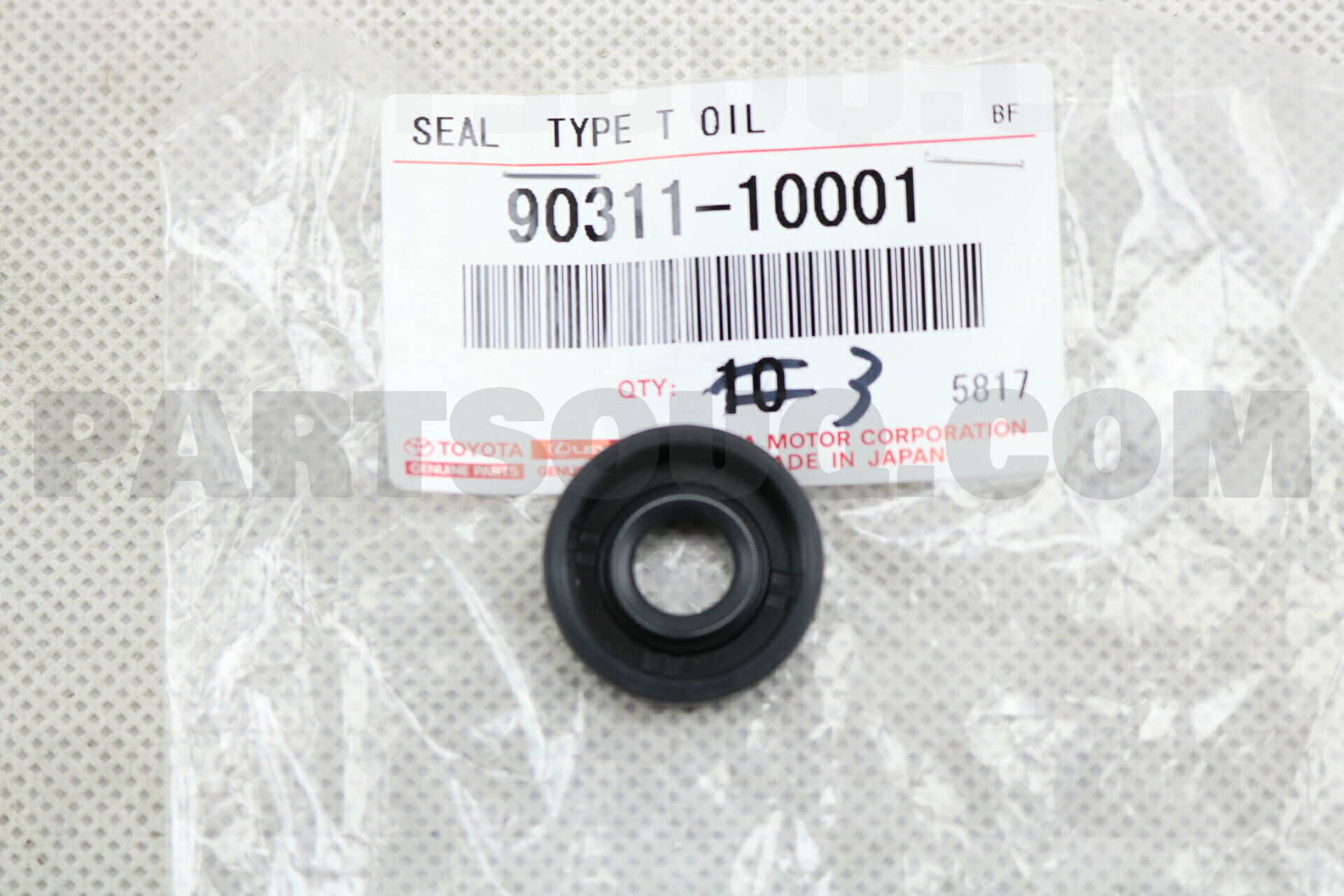

    • Seal 90311-10001 at small connector “shaft” between motor and AHC Pump sub-assembly 48901-60010, REPLACED with NEW
    • Large O-ring 90301-70003 between detachable outer cover 48913-60010 and Housing 48905-60010, REPLACED with NEW

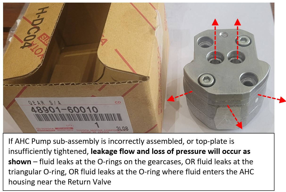

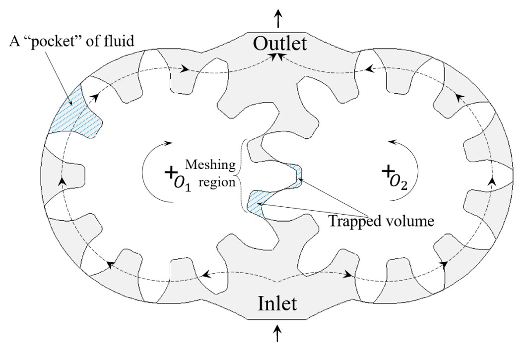

  • Any external gear pump (of which the AHC Pump sub-assembly is a micro example compared to industrial scale gear pumps) has a low pressure side (at the Intake) and a high pressure side (at the Discharge).

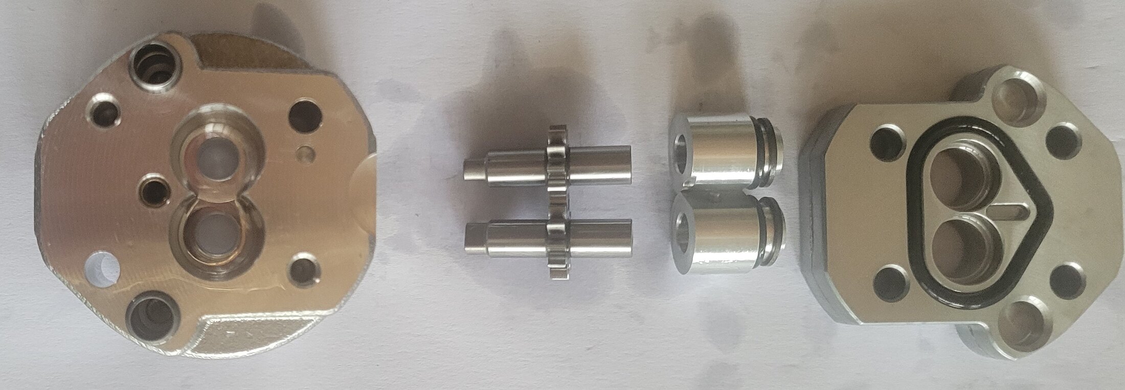

  • In any external gear pump (including the AHC gear pump), the high pressure side and the low pressure side are separated by seals -- the design and location of seals can vary but the principle is always the same,
  • In the AHC Pump sub-assembly, the relevant seals are:
    • the triangular-looking O-ring under the top-plate,
    • the O-rings on the gearcases,
    • the small O-ring 90301-06012 where the Discharge from AHC Pump sub-assembly joins the Housing 48905-60010 near the Return Valve, REPLACED with NEW
  • If ANY of these three seals weaken or fail, or if during dis-assembly and re-assembly of the AHC Pump sub-assembly the top-plate is insufficiently tightened, then AHC Fluid WILL leak from the AHC Pump sub-assembly into the region behind the outer cover and from there, back to the AHC Tank, WHAT ARE THE TORQUE SPECS FOR THE 2 ALLEN SCREWS THAT CLAMP THE PART HALVES, AND THE LONGER ONES THAT CONNECT THE PUMP TO THE FRAME? I dont have a torque wrench for allen screws , but i can figure out something
  • @BullElk highlighted this situation when he found that the O-rings on the gearcases required replacement and that rectified the no-flow condition in his AHC Pump -- @BullElk had stopped the leak and restored correct AHC Pump operation, WHat post # in this string is his description ? Or is this a totally different post ?

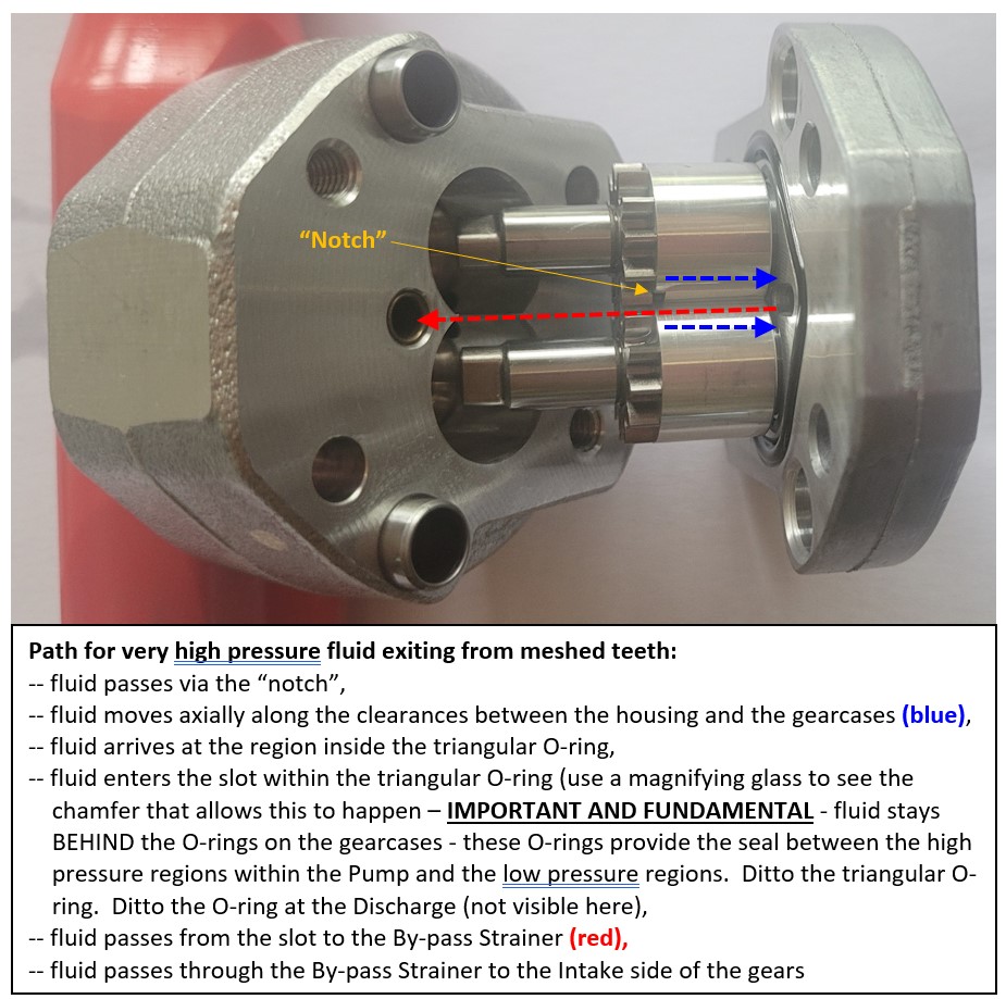

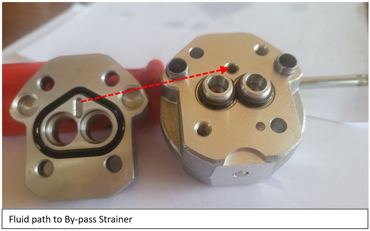

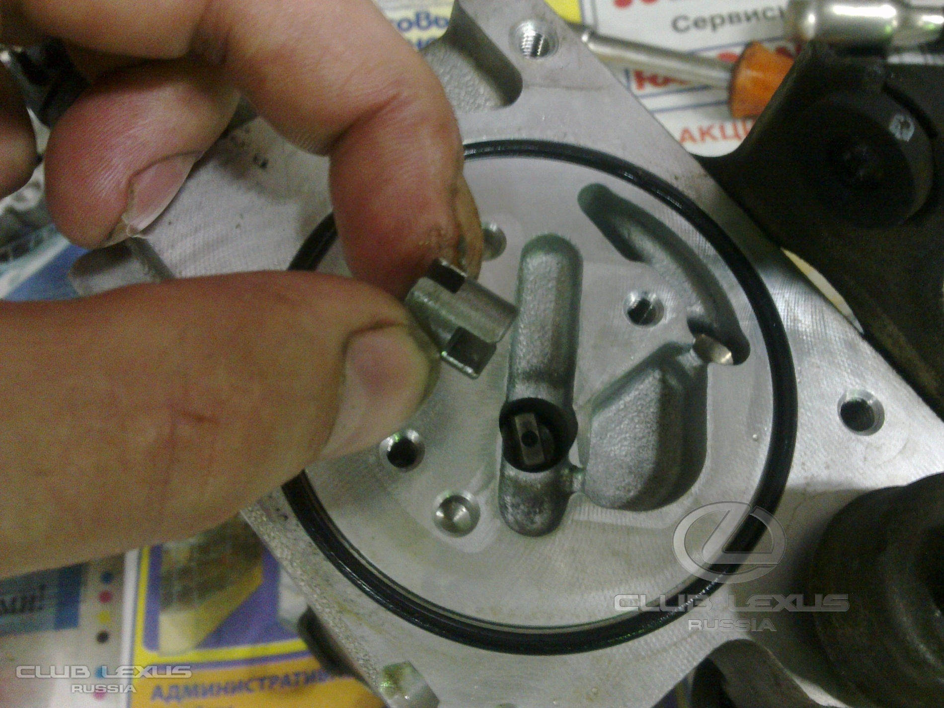

  • What it is “The Notch”? Where does it go? In recent Posts by @suprasvobodea, @Moridinbg, @IndroCruise, there have been photographs and stories from three Countries (USA, Bulgaria but travelling in South America, and Australia), where three different knowledgeable people each have opened a package containing a NEW OEM Toyota/Lexus AHC Pump sub-assembly 48901-60010 – this means three separate NEW TOYOTA/LEXUS AHC Pump sub-assemblies fresh out of the box from the factory via IMPEX or PARTSOUQ. There may be other examples from IH8MUD Members but please forgive me if I am unable to recall all of them. Then each of the above persons has taken the top-plate off the sub-assembly -- and lo and behold -- pictures all show the “notch” on the gear-case correctly located (when assembled) below the By-pass Strainer and on Intake side of the AHC Pump sub-assembly!! Probably @BullElk would agree? Similar reports can be found in the 200 series Forum for which the AHC Pump sub-assembly is very similar (although not exactly the same). In the previous Posts this thread, @suprarx7nut also has confirmed the same location and orientation in his own observations. All of that to say that unless someone, somewhere (anywhere!) has better evidence, then that is the end of the story on the correct, as-designed, as-manufactured, purposeful location of the “Notch”.
  • What is the purpose of the “Notch”? The “Notch” is an obvious and deliberate effort by the Pump designer/manufacturer to facilitate an exit pathway for the fluid trapped in between the meshing gear teeth as they emerge from the mesh. A different approach might have been to manufacture larger clearances between the components -- but that have may detracted from Pump performance. So the “Notch” is a compromise probably made to simplify manufacturing of a mass-produced item,
  • The high pressure fluid trapped in the gear mesh requires an exit path. This fluid cannot fight with the incoming fluid because then there would be no pressure difference to create a Discharge, just fluid going round and round inside the Pump. In gear pumps this exit path is via the fine clearances around the gearcases. In the AHC Pump, this path leads to the area in the top-plate surrounded by the triangular O-ring. Further exit is blocked by the O-rings on the gearcases in the AHC Pump sub-assembly -- provided that these O-rings are in good condition, I am working with a new pump that i opened, but the Origns and back up rings are brand new factory stock. I also installed the backup ring into the back half of the housing and made sure the O rings are just TOUCHING each other and not one is "stepped " on the other next to it.
  • The exiting fluid then moves from the area within the triangular O-ring and passes through the By-pass filter and then on to the Intake side of the AHC Pump sub-assembly,
  • In the AHC gear pump, the fluid in this exit path is at very high pressure -- this has the intended added benefit of increasing the pressure on the gearcases which in turn increase the force pressing the gears onto the floor of the housing, reducing clearances and reducing the fluid bypassing across the top and bottom surfaces of the gears, and enhancing Pump performance at the Discharge,
  • There is a balance here -- if the top-plate is insufficiently tightened, then that can easily be the cause of multiple kinds of leakage within and from the AHC Pump sub-assembly to the outer case and the AHC Tank and be the cause of low flow and low pressure at the AHC Pump sub-assembly Discharge. If the top-plate is over-tightened, then that may inhibit gear rotation and cause the tiny connector “shaft” between the Motor and the AHC Pump sub-assembly to disengage or be damaged, resulting in reduced flow and pressure at the discharge (or maybe no flow at all),

REPLY>>> Yes, i have done the same and posted pictures of this today . and the fluid does NOT lower when 12V is applied. It will slowly LEAK out when I remove the black stopper in the outlet, but that's all. I think I will tighten down the 4 fallen bolts even more now and retest. That is what INDOCRUISE suggested in his reply post #102 .
Well, I am bewildered. Aside from some significant mis-assembly, I don't know how that wouldn't pump.
Thank you for showing pictures, though. It's clear the issue is within that pump.
If that were me, I'd mess with the pump assembly more. Meticulously crawl through the assembly of your pumps and see if you can spot anything.

oK, I just disassembled the pump for the 6th time. I removed the new little O ring for the outlet, the triangular-shaped O ring, and the Large cover O-ring. ALll are new and were replaced when I bought this new pump 2 months ago. I tightened the 4 Allen screws down - tight so there is NO possibility of leakage, I then inserted the Back up ring into the back half of the pump and the O ring on the gear shafts, one at a time, and made sure they did not "ride up " one of them. I expected this damn thing to start pushing Oil thru the outlet when applied 12 V.................
IT DID NOT !!!!!!!!!!!!!!!!!!!!!!!!!!!!!!!!!!!!!!!!!
So, something is going on INSIDE this pump of mine. If I remember, there was another guy who had like 4 -5 pumps that he showed pictures of,, that were doing the same thing, NOT WORKING! Even the NEW pump he had, Did not work! The only one that did, was his old one!! but it was worn out and took a long time to go to H. I need to get this LX 470 running by this weekend so I can drive 1000 miles to Wisconsin to see my 90-year-old mother for her birthday. I have not driven my LX in 5 MONTHS! ITS TIME TO GET ER GOING! 🤠 :wrench:🚐🛻

Anyway, suggest think about what is happening when polarity at the Pump Motor is reversed.
  • Direction of rotation of gears is reversed,
  • The Pump Discharge is then asked to become the Intake,
  • The Pump Intake is then meant to become the Discharge.
Question: When reversed, how does the Pump draw fluid somehow from the AHC system instead of from the AHC Tank??
Answer: It is extremely difficult to understand how this can happen. To do so would require that the Pump draws fluid past the closed Return Valve (located in the housing between the AHC Pump and the AHC Pump Motor) and then draws fluid past the closed Levelling Valves (further back in the circuit within the Control Valve Assembly). It also means that it is extremely difficult for fluid to be released as gear teeth exit the mesh in the gear pump (because the "notch" is not at the "new Intake" when the Pump is reversed). In this condition, lock-up of the Pump (no flow) is unsurprising, especially on a new AHC Pump.
Question: How is that @Moridinbg (and others) have had successful experiences reversing polarity?
Answer: @Moridinbg is very experienced in the AHC/TEMS system and his reports are factual -- best to ask him this question. My guess is that his report is related to an old, worn AHC Pump, and that internal leakage within the Pump was occurring -- possible in such a case. It is more likely (and unsurprising) that a new Pump with fine tolerances (no wear) and new seals, will lock (do nothing) when polarity is reversed.
It certainly was worthwhile following up on the suggestion offered by @suprarx7nut concerning elimination of air in the Pump -- this helped to eliminate an important possibility.
For my part, with the exception of the misunderstanding noted above, no "questions have been begged". My opinion remains as expressed in in Posts #84 and #85 (both with pictures) and especially in the list of bullet points graded from least likely to most likely set out in Post #98 (also with pictures). Maybe the less likely causes listed in Post #98 need to be be reconsidered now.
In short, it is very difficult to escape the conclusion that there is an assembly problem with the subject AHC Pump -- whether at the factory or when opened before installation in the vehicle. Maybe it will require installation of a known working AHC Pump sub-assembly to help resolve this issue?
Meanwhile, here are some more pictures with labels and explanations which may be of assistance:

If the gears are turning inside the AHC Pump sub-assembly, then there are these possibilities:
1. AHC fluid IS entering the Pump and IS arriving at the gears.
If the gears are turning, then the fluid has to go somewhere -- either the fluid is discharged by the Pump (which is not happening in your tests), or, fluid is leaking from the sub-assembly as shown in the third picture at my Post #109. Such leakage cannot be seen while the outer cover is in place. This possibility seems less likely given all the work you have done and parts replaced but it is too early to abandon this idea without testing,
OR
2. AHC Fluid IS NOT entering the Pump and IS NOT arriving at the gears.
Then there is no pumping action (or not much pumping action) and either there is no discharge or there is just a dribble. If AHC Fluid IS NOT entering the Pump and is not arriving at the gears, then suspect a blockage in the housing 48905-60010 between the fill point and the point at which the Pump sub-assembly picks up the fluid. This should be easy to explore.
OR
3. AHC fluid IS entering the Pump and IS arriving at the gears AND there is no discharge.
If the gears are turning, and the AHC Pump sub-assembly seems healthy (no internal leaks across O-rings and seals) but there is no discharge, then a blockage might be suspected in the housing after the sub-assembly Discharge but before the Discharge from the overall assembly where the AHC pipe attaches (where the rubber bung is in place in your pictures at your Post #103). This may involve a malfunction of the Return Valve which is inside the housing 48905-60010. The Return Valve is spring-loaded and is meant to open under pressure when the Pump is operating. A malfunction or a blockage within or before the Return Valve is VERY unusual but it is possible. There is another small fluid Strainer in front of the Return Valve which may be a possible blockage point. This Strainer can be removed in a similar way to the Strainers inside the AHC Pump sub-assembly (see picture below). Removing the Return Valve mechanism is more complicated.

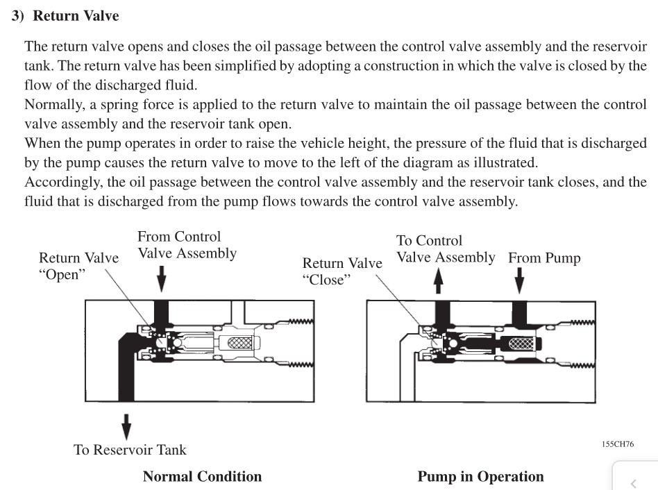

One last thought to assist @suprasvobodea and others in the series of pictures posted earlier in this thread ....
If the AHC Pump sub-assembly is to be changed, it may be worthwhile to change out the seal 90311-10001 on the Housing 48905-60010 between the AHC Pump sub-assembly 48905-60010 on one side and the Pump Motor 88264-60010 on the other side. This seal serves two purposes: (1) prevents AHC Fluid leaking out, and (2) reduces the ability of air to leak in, with potential for DTC C1762.
As can be seen from the pictures below, this seal is located on the Motor Side of the housing. Separation of the Housing and the Motor is necessary to replace the seal.
Unless it is damaged, it should not be necessary to replace the small connector shaft 48977-60010
between the Motor and the Pump -- see fourth picture below ....

Ok. It’s the simple stuff that sometimes gets missed, especially after months of trying everything. I’ll check it out this morning and report back
UPDATE >>> 6-14 9:30 AM
I removed the cover and poured oil into the area shown with an arrow( I don't have a text option when editing with this photo app) . I held it at an angle to maintain a small "pool " of oil in that cavity. When I applied 12V , IT DID NOT GO LOWER WHICH MEANS it's NOT PUMPING ANYTHING!. I removed the black rubber bung, and nothing came out (except leakage drips) .
I looked at the end of the gear shafts and they WERE SPINNING! So it is engaging, .. it's just not acting like a pump!!! The 4 Allen screws are torqued down very tightly, and there was NO seepage around the perimeter of the pump halves. so the new pump is NOT leaking (visibly) . Oh, I also removed the return access( Large Allen screw) that allows access to the 3rd screen and removed it with a screw -just like in the 3rd picture in #115 from INDOCRUISE, and it was clean as new. - so there is no blockage there either.
So, I have a new pump assy, that has spinning gears, but not moving any fluid thru it. It has all new o-rings except for the one that forms a triangle.! I will order that O-ring as well, but I don't know the part number. If anyone has this, please let me know.
Otherwise, I don know what else to do, except wait for another new pump assy to arrive from IMPEX,.... sometime in the future -( they have the absolute LOWEST prices on these kinds of parts ( the equivalent price in the states online is $419-489 dollars!)
The frightening thing is, All I did was open the thing up to check the little screens after I installed it and removed it when I was still getting the damn 1762 error code.
