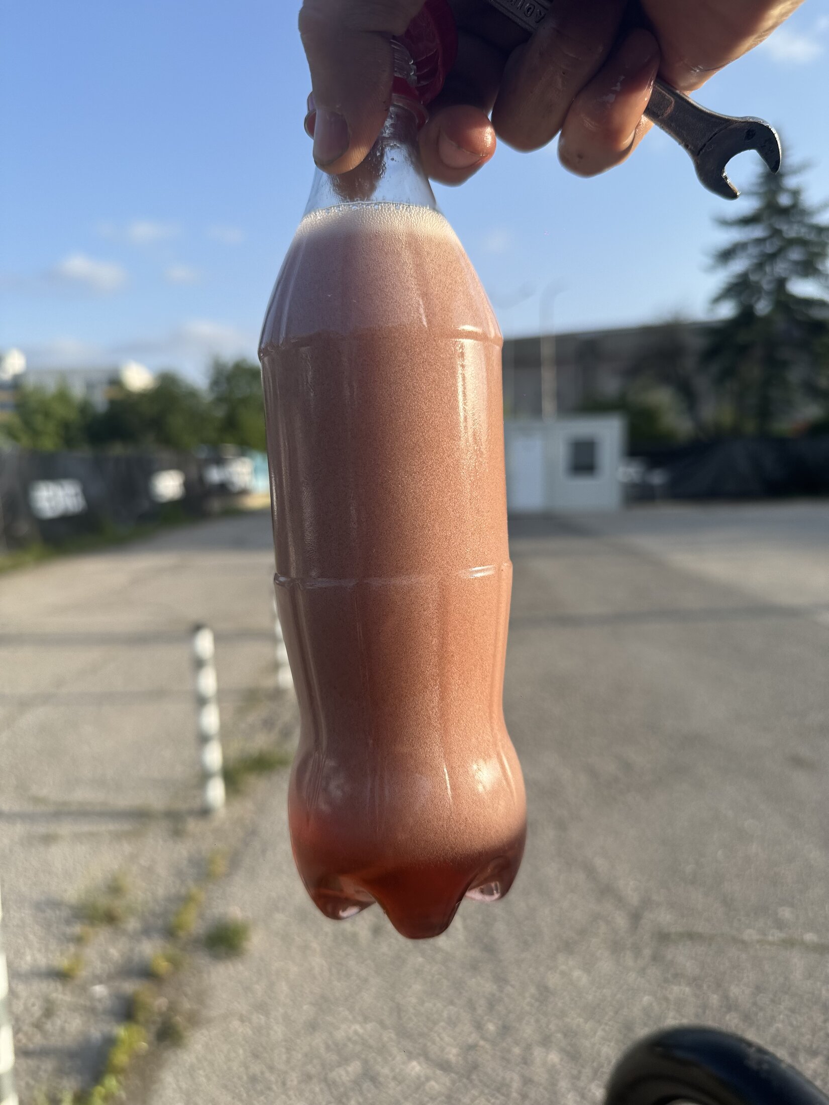

Thank you for responding tonight. I'm feeling like a mechanical failure & very down right now.................!!! I've never had my ass kicked so badly with ANY electro-Mechancial issue like this in 40 years!!!!!!!!!
I repeated this 2 more times on the front wheels after my first success with the bubbles /air. I applied 12V to both the accumulator solenoid and pump. HOWEVER,... No more bubbles or air was exiting the accumulator when I opened up the bleeder on the accumulator. I did the front LH globe as well since it was right there by the accumulator. All that came out of the accumulator was clear, bubble-free fluid. I did not check the rear shocks again after the previous removal, do I have to remove the top fitting after lifting the rear on jack stands again and compress each side shock like the front LCA?? Does anyone know HOW MUCH AIR in the shocks /Accumulator /lines causes the fail-safe error code.....?

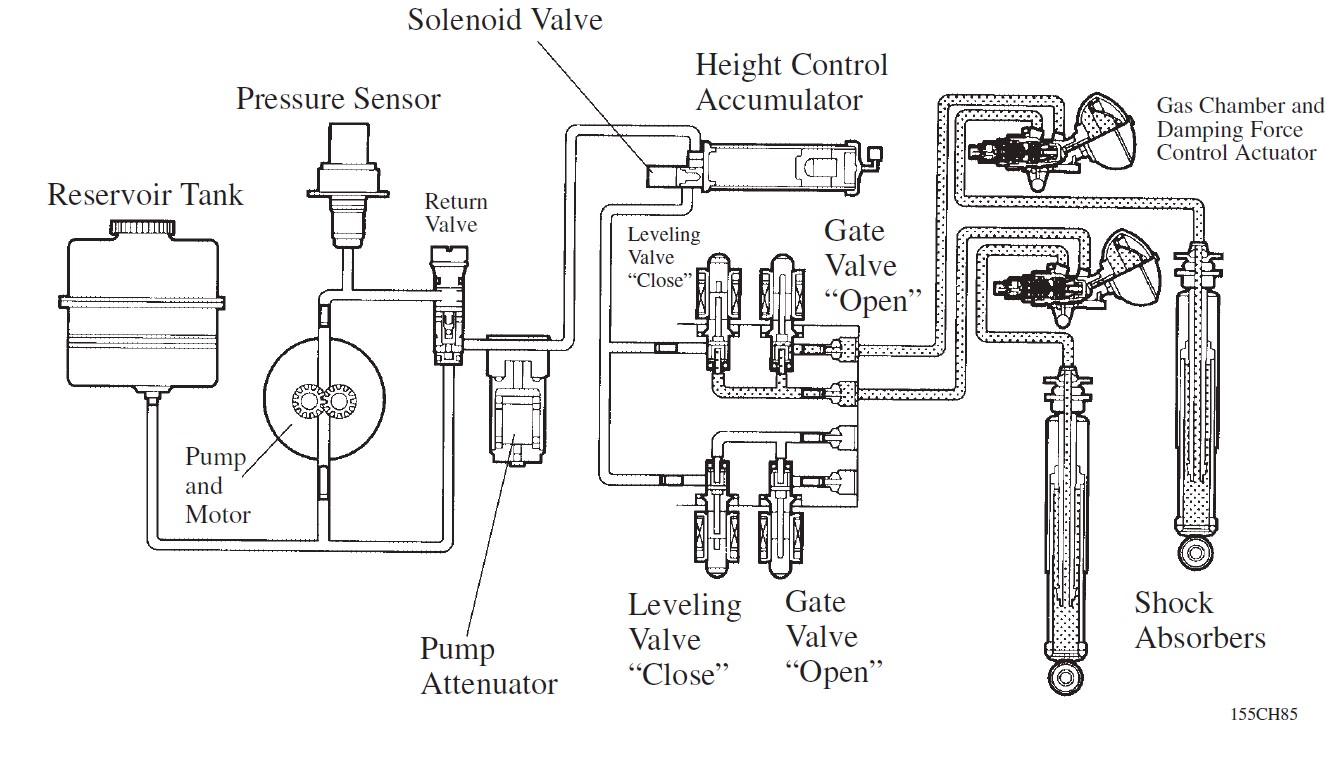

  • Look at the attached schematic and visualise all the places where air or bubbly fluid may be parked – long pipes, ‘globes’, ‘shock absorbers’, various pipe junctions/joiners etc, etc -- you have seen air, you KNOW it is in there somewhere and possibly in multiple places,

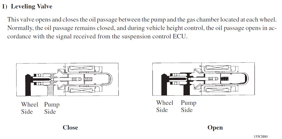

  • The next step is to try and get fluid past the “normally closed” Levelling Valves in the Control Valve Assembly and onwards and out through the bleeder valves at the ‘globes’,

  • The next step is to try and get fluid past the “normally closed” Levelling Valves in the Control Valve Assembly and onwards and out through the bleeder valves at the ‘globes’, I believe that these solenoids must be energized too ( just like the accumulaotr) for them to opem and allow oil to them. Doing this had NO EFFECT when i pressed UP buttom :mad:

My reservoir was stained dark brown ( like ALL of them!) and I wanted to try to remove all that staining by soaking it with SIMPLE GREEN concentrate, parts cleaner, royal purple degreaser... even gasoline (It's a great cleaning agent of grease you know!) to get it as clear as possible so i can see the Oil level. So the res was super clean! But I will be disassembling the pump and looking at everything, per INDOCRUISE or your suggestions and pictures if you have any! I will take pictures of my pump once it is removed from the LX and show you what I am seeing as well. I know this helps EVERYONE!
Please, Let me know with any pictures of the pump disassembly process so i don't miss anything or put something back together incorrectly ( like the notch gears!) Thank you for your help and time with this!
