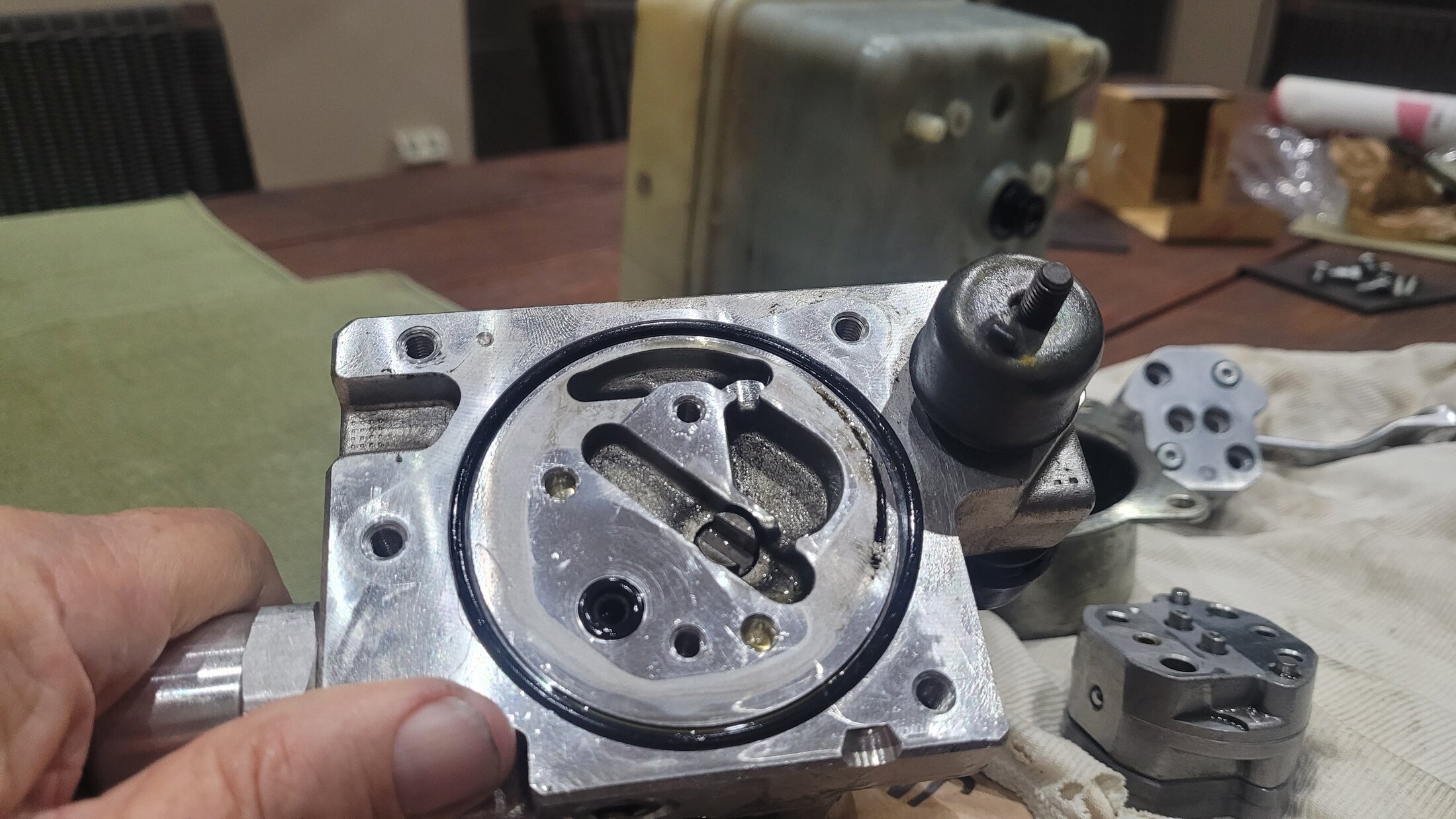

Well, to refresh my memory, I dis-assembled some of my old spares on the kitchen table -- that was around dinner-time in Brisbane, Australia, so this did not receive a vote of approval from Mrs IndroCruise!!
Firstly, to correct the record -- I found a mistake in the labels on my previous picture in my Post #116 -- which I have edited in that Post. The correct path for AHC Fluid from the Tank to through the Housing to the fluid pick-up point for the AHC Pump sub-assembly is shown in the new labelled picture below. A blockage might be possible here but seems very unlikely at such a large opening -- it is shown in the picture with an Allen key poking through it.

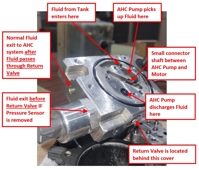

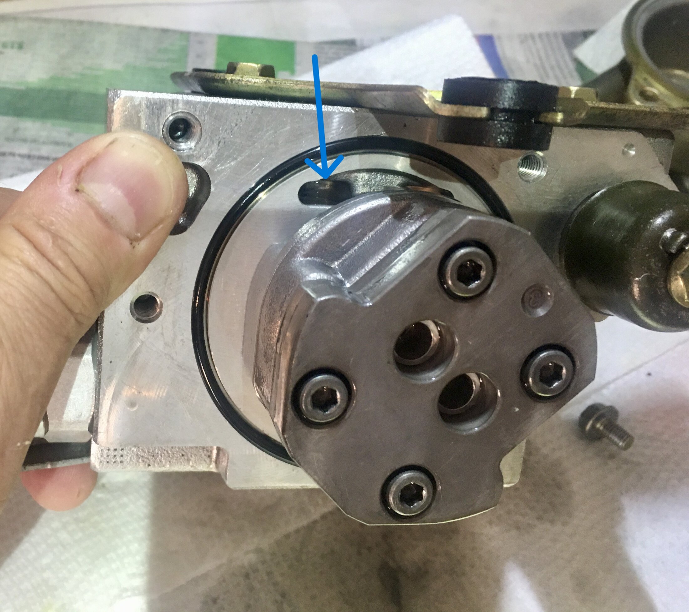

Ok. It’s the simple stuff that sometimes gets missed, especially after months of trying everything. I’ll check it out this morning and report back
UPDATE >>> 6-14 9:30 AM
I removed the cover and poured oil into the area shown with an arrow( I don't have a text option when editing with this photo app) . I held it at an angle to maintain a small "pool " of oil in that cavity. When I applied 12V , IT DID NOT GO LOWER WHICH MEANS it's NOT PUMPING ANYTHING!. I removed the black rubber bung, and nothing came out (except leakage drips) .
I looked at the end of the gear shafts and they WERE SPINNING! So it is engaging, .. it's just not acting like a pump!!! The 4 Allen screws are torqued down very tightly, and there was NO seepage around the perimeter of the pump halves. so the new pump is NOT leaking (visibly) . Oh, I also removed the return access( Large Allen screw) that allows access to the 3rd screen and removed it with a screw -just like in the 3rd picture in #115 from INDOCRUISE, and it was clean as new. - so there is no blockage there either.
So, I have a new pump assy, that has spinning gears, but not moving any fluid thru it. It has all new o-rings except for the one that forms a triangle.! I will order that O-ring as well, but I don't know the part number. If anyone has this, please let me know.
Otherwise, I don know what else to do, except wait for another new pump assy to arrive from IMPEX,.... sometime in the future -( they have the absolute LOWEST prices on these kinds of parts ( the equivalent price in the states online is $419-489 dollars!)
The frightening thing is, All I did was open the thing up to check the little screens after I installed it and removed it when I was still getting the damn 1762 error code.

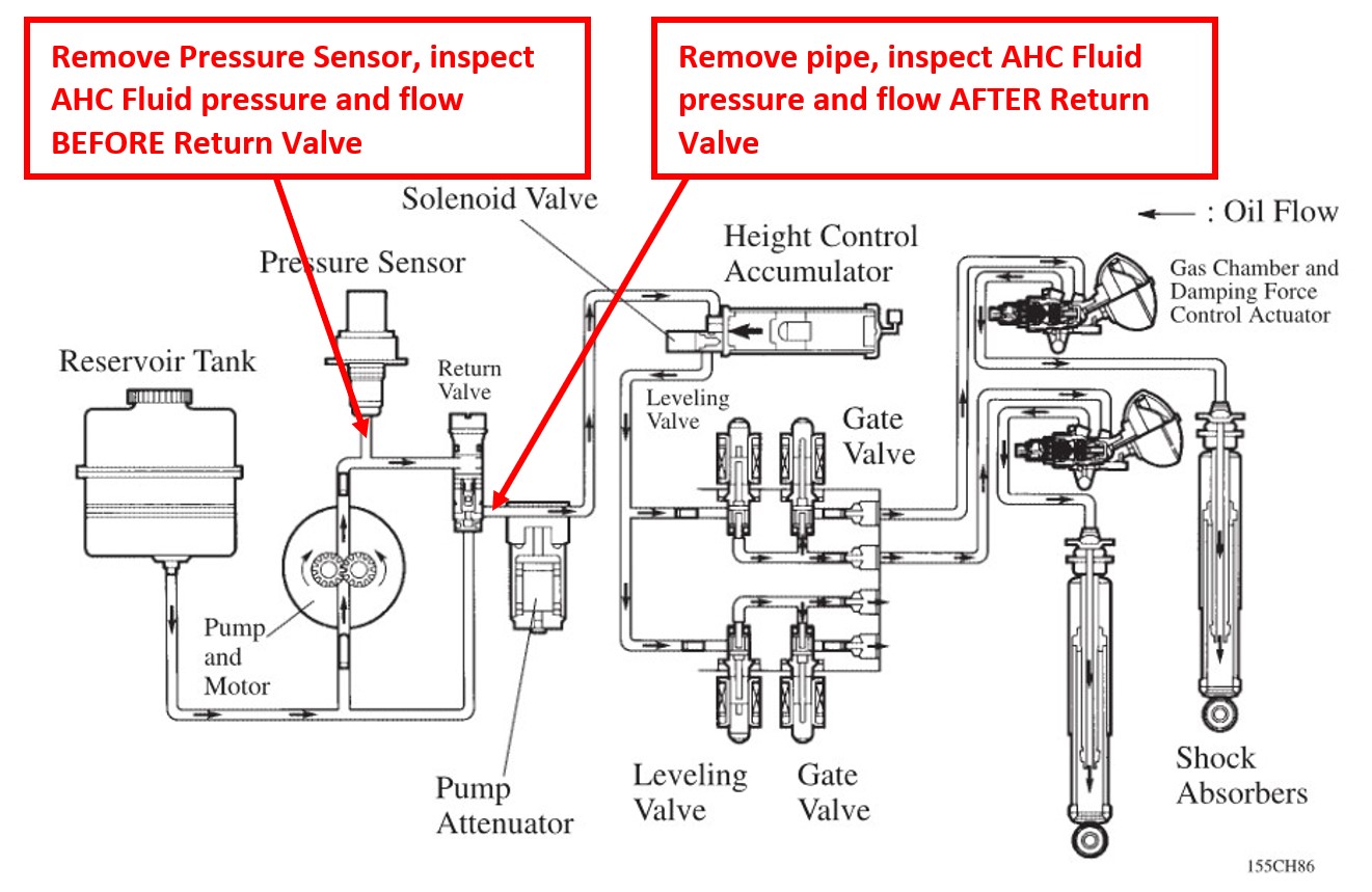

Please describe what happened when you operated the AHC Pump with the Pressure Sensor removed.
Was the flow at the Pressure Sensor position with the Pressure Sensor removed stronger than at the normal discharge point which you could stop with finger pressure?
Did you try stopping the flow at the outlet with Pressure Sensor removed with your finger or thumb?
This detail is important. The point of the suggestion is to make sure that the AHC Pump is delivering normally and that there is no obstruction at the Return Valve, extremely unusual as this may be. Yes, you have advised previously that you have checked the strainer at the Return Valve but that does NOT confirm the operation of the Return Valve.
If the flow from the AHC Pump can be stopped with a finger, then something is wrong, either mechanically or in the fitting procedures.

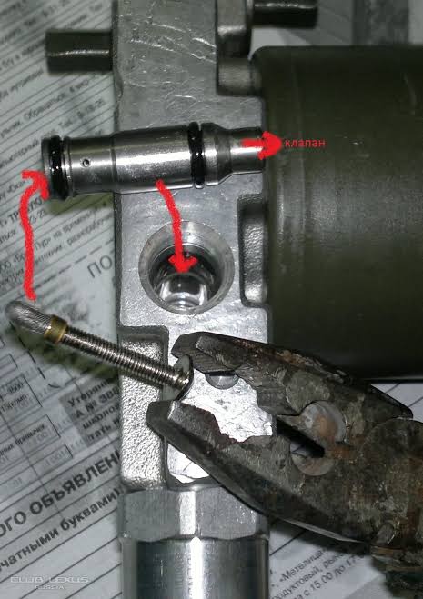

First, it is important to discover why neither the old AHC Pump nor the new AHC Pump are delivering the expected pressure and flow. If some data would help, attaching a pressure gauge could be considered (such as the LSPV gauge used for brakes and also used on the AHC system when Techstream is not available). The gauge would be attached in place of the pipe at the delivery point on the housing next to the AHC Pump. In this way, the actual AHC Pump pressure developed when dead-heading could be measured -- although it has to be said that the 'finger test' should be good enough.
Here are a few more pictures - now with Late Edits to correct labels - some are mine and some are borrowed from Club Lexus in Russia, showing details of the Return Valve:

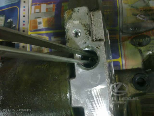

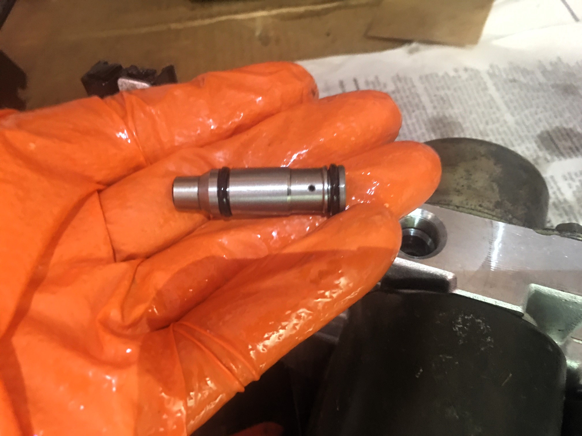

Extracting the Return Valve:
View of Return Valve after extraction -- also showing strainer at the Return Valve:

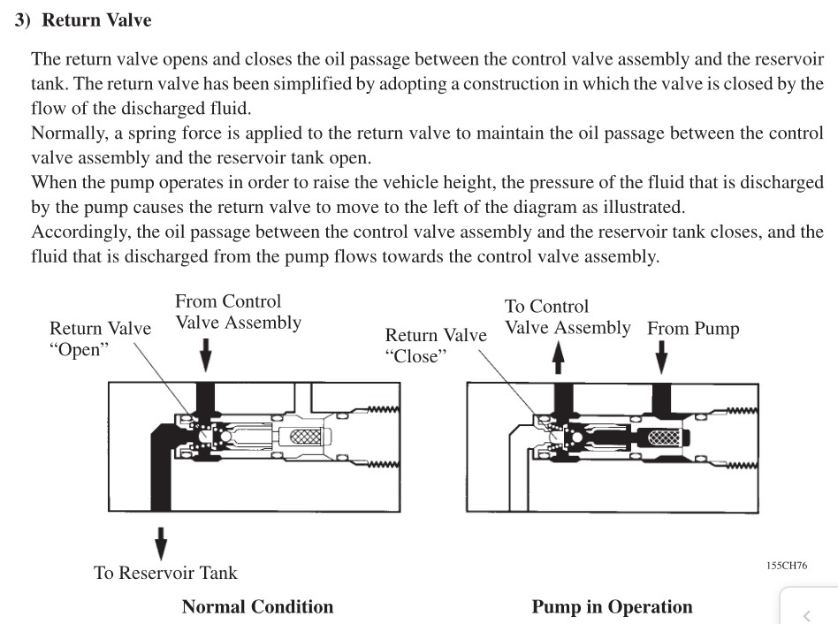

FSM explanation of the operation of the Return Valve:
AHC Return Valve Check -- with direct 12 volt connection to Pump Motor:

"I then removed the new PS (Pressure Sensor) on the unit, applied 12V and it pumped out alot of oil!"
This was suggested back at post #121 and post #123 this thread without needing to wait for the new AHC Pump.
It is difficult to imagine how the pressure of a normally operating healthy AHC pump sub-assembly could be stopped by the pressure of a finger. In a healthy vehicle the AHC Pump participates continuously in automatic self-levelling, working against the AHC system pressure of +/- 6Mpa. The AHC Pump also recharges the Height Control Accumulator to around 10.5MPa after a raise from LO to N or a raise from N to HI. If the Height Control Accumulator is empty, then the AHC Pump raises the vehicle directly, but slowly.
As has been stated many times, installing a new AHC Pump sub-assembly will NOT by itself overcome a DTC C1762 condition. There IS air in the system in this vehicle because it has been opened for various changes and replacements. Repetitive bleeding attempts over and over and over again will be required.
When you think that the AHC Pump is capable of developing pressure, then you will need to ....

First, it is important to discover why neither the old AHC Pump nor the new AHC Pump are delivering the expected pressure and flow. If some data would help, attaching a pressure gauge could be considered (such as the LSPV gauge used for brakes and also used on the AHC system when Techstream is not available). The gauge would be attached in place of the pipe at the delivery point on the housing next to the AHC Pump. In this way, the actual AHC Pump pressure reached when dead-heading could be measured -- although it has to be said that the 'finger test' should be good enough.
AHC Return Valve Check:
^^^^^ Late Edits and pictures added in previous Post

I removed the new PS and applied 12V to the pump and it pushed out a lot of oil. Then I coved the outlet with a gloved thumb and I COULD NOT STOP THE FLOW .. IT SPRAYED ALL OVER THE passenger side engine block! :) (like I would expect it to) When I reinstalled the PS and removed the outlet line from the pump, & applied 12V to the pump directly, I could prevent OIL FROM ESCAPING FROM THE PUMP UNIT simply by covering the outlet with my finger! I think I need to know and diagnose this FIRST, before trying 97+ to bleed the system, open the driver-side rear globe, clearing the 1762 code, 100 times.
How is it possible for high-pressure oil to exist from the PS location when removed, but it's just a stream from the outlet, that I can block by simply covering the hole with my finger .....?
Answer >>> Per the diagrams from INDOCRUISE, it has got to be something in line with the return valve. It's the next thing in the fluid path before the exit from the pump!!!!! 🤠:wrench: Should I remove the assy from the LX again, and disassemble it and try to remove the return valve? I did remove the screen fir the return valve and it was clear. All I can think of is the valve itself is not functioning or blocked.

You have been taken to the Return Valve in multiple Posts with diagnostic ideas and with diagrams and pictures on how to proceed over a period of almost 4 weeks – see my posts: June 13, 2024 at Post #115; June 15, 2024 in Post #121; July 4, 2024 in Post #131; July 6, 2024 in Post #132 – INCLUDING sufficient pictures on how to remove and examine the Return Valve.
On July 8, 2024 in your Post #136, you have provided a clear answer that the recommended test had been performed and which confirms high pressure and flow from the AHC Pump sub-assembly 48901-60010, proven when the Pressure Sensor was removed.
Good news!! The Pump is good and the previous Pump also may have proven to be good -- if the test had been done earlier.
Bad news!! In my opinion, there is a malfunction in the Return Valve (noting that the strainer in the Return Valve already has been cleaned).

Some further steps which you may wish to consider:
1. Look again and more closely at the previously provided pictures and the diagram showing the cross-section of the Return Valve -- visualise what could be happening to impede flow, such as debris or sludge entering the Return Valve as AHC Fluid returns to the AHC Tank, such as during auto self-levelling, or when the vehicle is dropped N > LO or HI > N,
2. With the whole AHC Pump assembly still in place, suggest devise a method to push and pull fluid flow through the Return Valve after removing the steel pipe from the outlet in housing 48905-60010-- with the aim of shuffling the Return Valve internal mechanism backwards and forwards to dislodge any sludge or debris which may be causing interference to valve operation,
3. For example, maybe use a bicycle pump filled with AHC Fluid with suitable fittings added, or some similar arrangement, or, maybe use a compressed air nozzle, or, whatever else you can devise,
4. Question: How is it possible for debris to arrive in the Return Valve in the first place? Answer: It is possible when AHC Fluid is flowing back to the AHC Tank, carrying sludge or debris from elsewhere in the system, especially after major repairs such as those which have occurred on this vehicle,
5. Question: Maybe the strainer in the Return Valve would catch returning fluid flow and protect against sludge and debris in the return direction? Answer: No. The purpose of the Return Valve is to cause returning fluid to be diverted directly through the drillings in the housing 48905-60010 to the AHC Tank -- returning fluid DOES NOT flow backwards through the Return Valve strainer, NOR does returning fluid flow backward through the gears in AHC Pump sub-assembly,
6. For the reasons given in my Post #132, I do not consider that the pressures and flow you have described at the delivery point at housing 48905-60010 are adequate to operate the AHC functions,
7. The situation of a Return Valve fault is rare -- there is no FSM information to help, and I do not recall seeing any helpful information on this Forum,
8. I have not personally disassembled a Return Valve because the need has never arisen. If this were my vehicle, and if I were faced with the symptoms you have described, I would look for alternatives to replacing the housing 48905-60010 for USD800. [Maybe I would consider a second-hand whole Pump assembly 48910-60012 if that would yield a spare housing 48905-60010],
9. Again, if this were my vehicle, I would now try to shuffle the Return Valve internals as mentioned in para (2) above – and if that did not work, I would remove the Return Valve for careful examination, using long-nose pliers or forceps as shown in the picture at Post #132, or, first remove the strainer then in a similar way engage the Return Valve with a slightly larger wood screw, and withdraw the Return Valve from the housing 48905-60010,

IndoCruise -update 7/9/24
Thank you , once again for your detailed description and explanations.... they are my lifeline after 5 months of this frustration.! 🤠 :wrench: !
I removed the return valve based on the pictures from Russia last night and attached photos of what it looks like. I too, think something is messed up , and blocking this little valve from functioning. I think the screen in it would prevent such damage since fluid returning to the tank WILL pick up contaminants from a disturbed, open system...like mine. Now that I see how the Russians disassembled the end of it, by prying the end off with a screwdriver as a wedge, I will attempt that today. I cannot understand Russian, but I sure can follow the pictures and his hand gestures as to what to do. IF THIS DOES NOT WORK AND UPON REASSEMBLY, IT CAN NOT PRODUCE PRESSURE, THEN I WILL BE LOOKING FOR A USED PUMP FULL ASSY, & use the part 48905-60010 ($800 ) from a used full assy hole Pump assembly 48910-60012! Indocruise, I am willing to purchase one of your old pump assy, or just the return valve from a working pump, if you are willing to sell it. This is going to be a rare find unless someone from this group is reading this.
