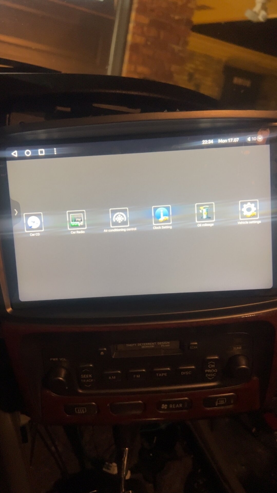

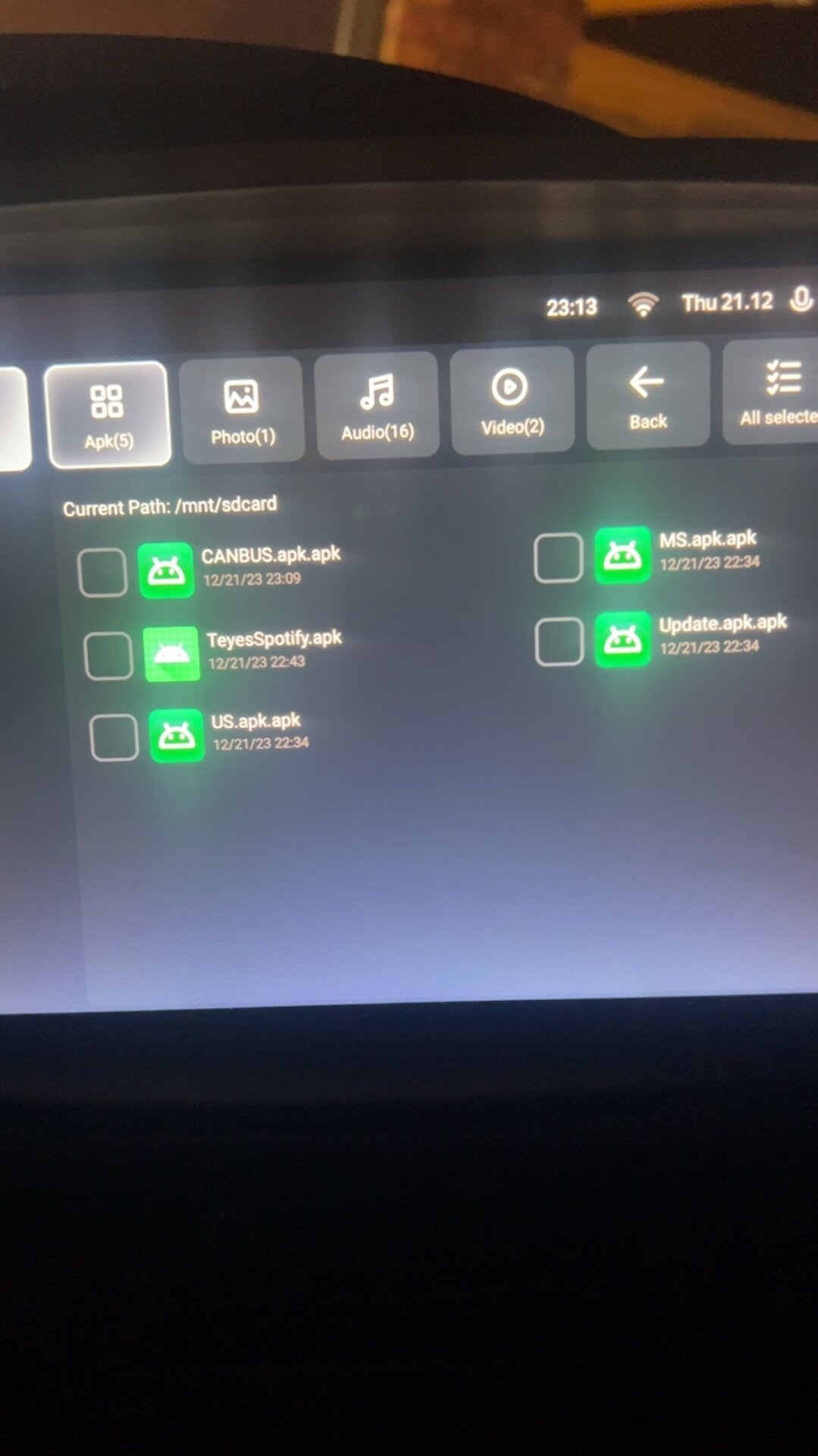

So I installed my Teyes and everything works except the AC icon not appearing. I have tried the factory reset, updated canbus, setting the canbus protocol lc>null, reboot etc. Nothing works except going into my file manager and reinstalling canbus to get to the menu. Any ideas on how to get the icon to appear?
Scratch that. Went to touch assisstant and found the icon 🤪
