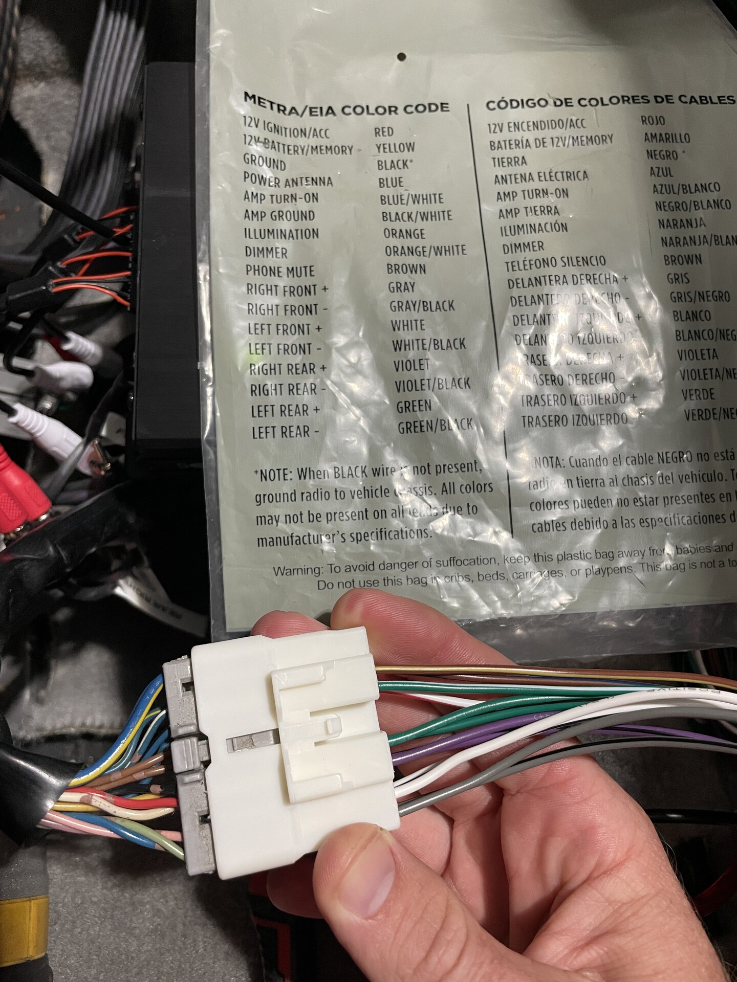

Yeah. So I’ve got 4 channels on the amp working fine, all except the sub. I’ve only got audio coming out of the right rear and right front speakers, but I can take the grey wires on the metra harness and connect them to all 4 channel outputs on the amp to verify all channels are working properly.
In the picture showing the amp outputs, I know I’ve got signal on all four (tested my moving wires around between outputs), but I’m not getting audio from the white and white/black wires or green and green/black. It’s like they just don’t go to the left speakers. I’m left wondering if the wires on the connector to the factory harness are in the wrong sockets?

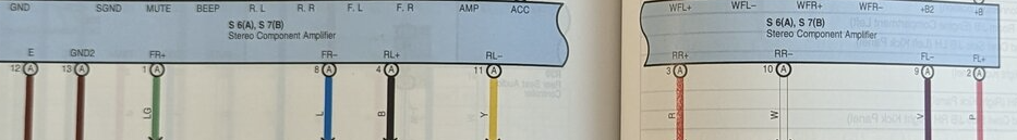

Kind of hard to tell from the picture, but it looks correct. On the factory harness:
Green/Blue are FR +-
Pink/Violet are FL+-
Red/White are RR +-
Black/Yellow are RL +-
You can see those in the amp diagram below.
I suspect that you're not getting signal from the Teyes to the factory harness on the left channel.
If you back up to the Teyes, can you explain/show how you're connecting the Teyes to the factory harness? Are you using the Teyes "G" connector for that?
Red/White are RR +-
