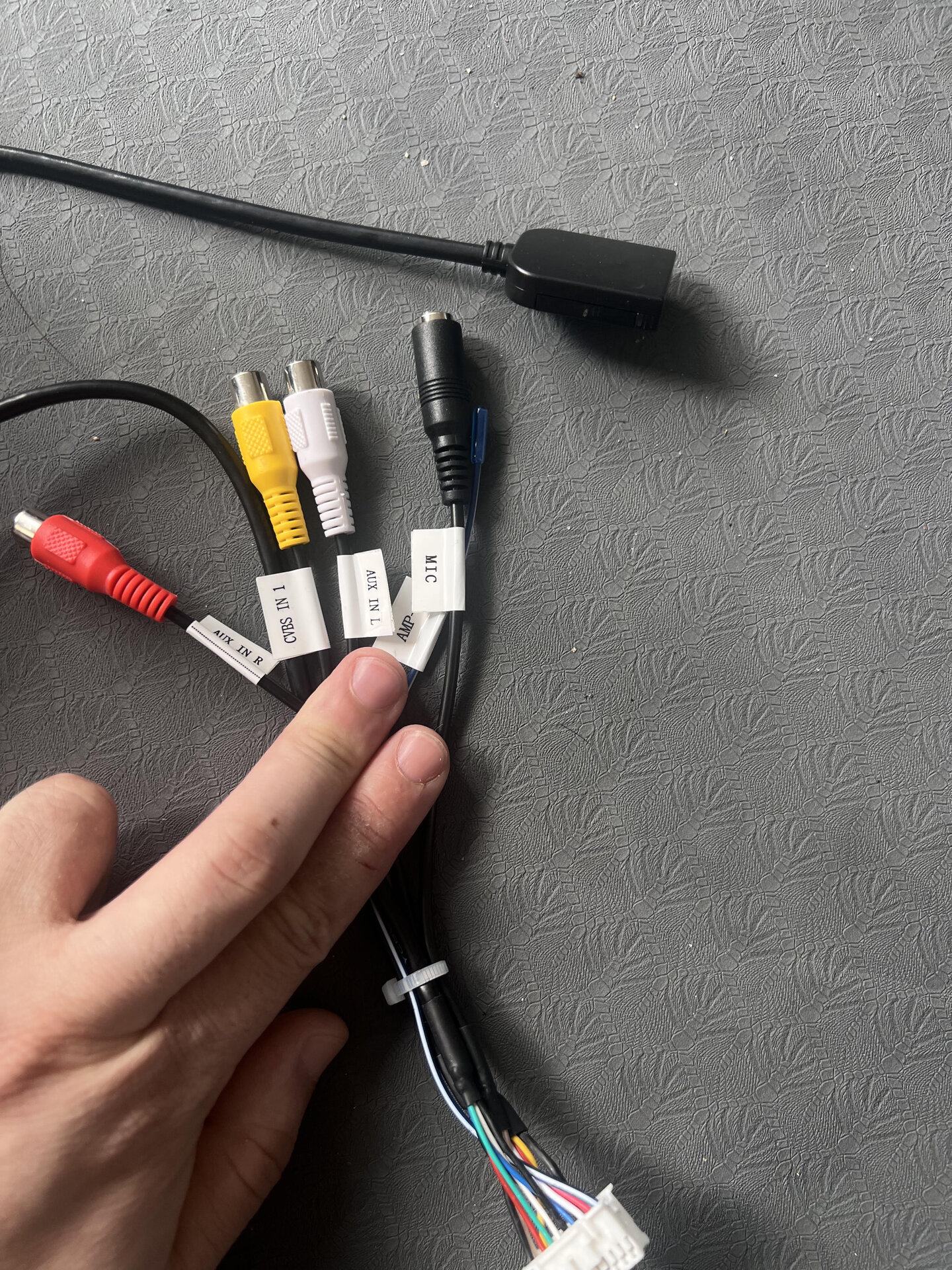

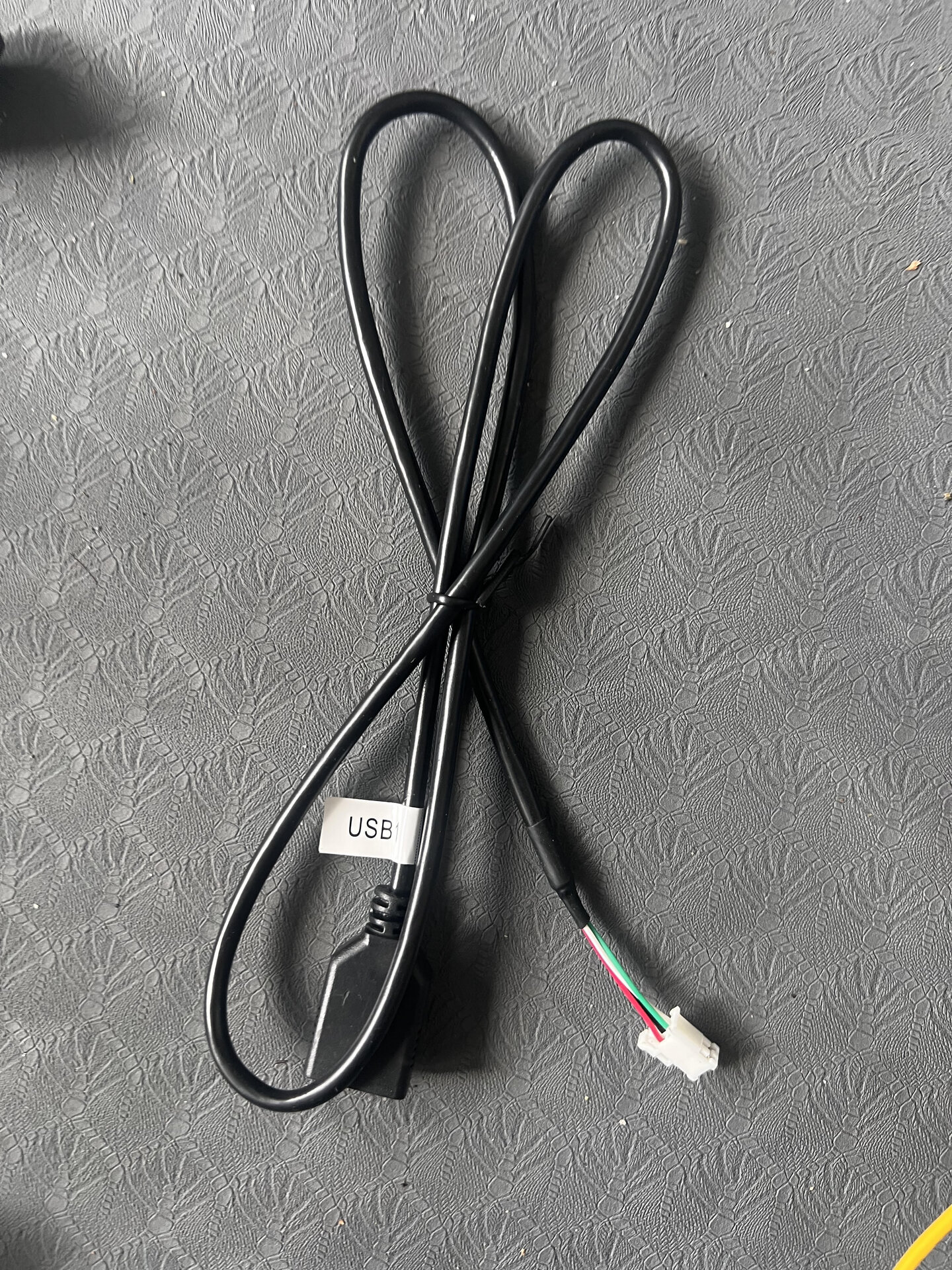

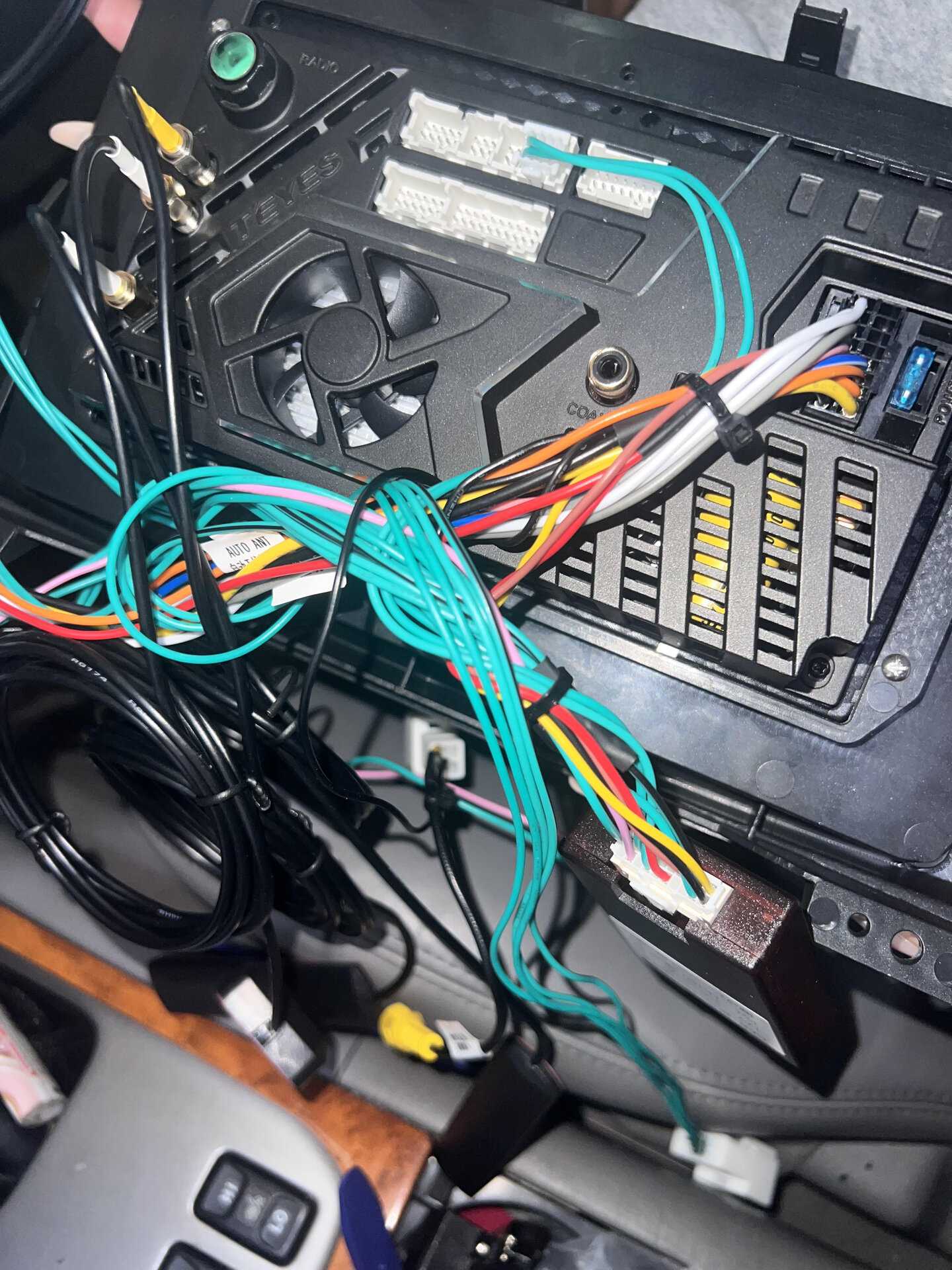

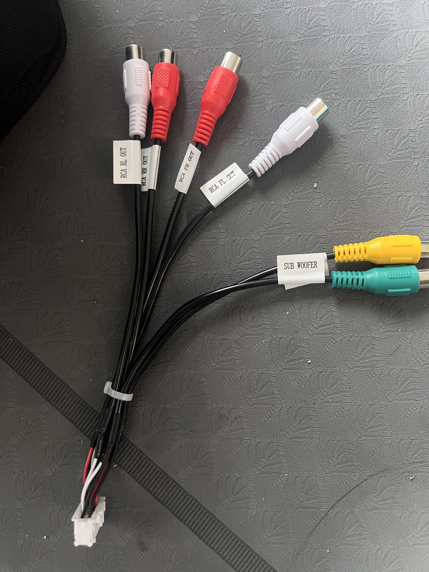

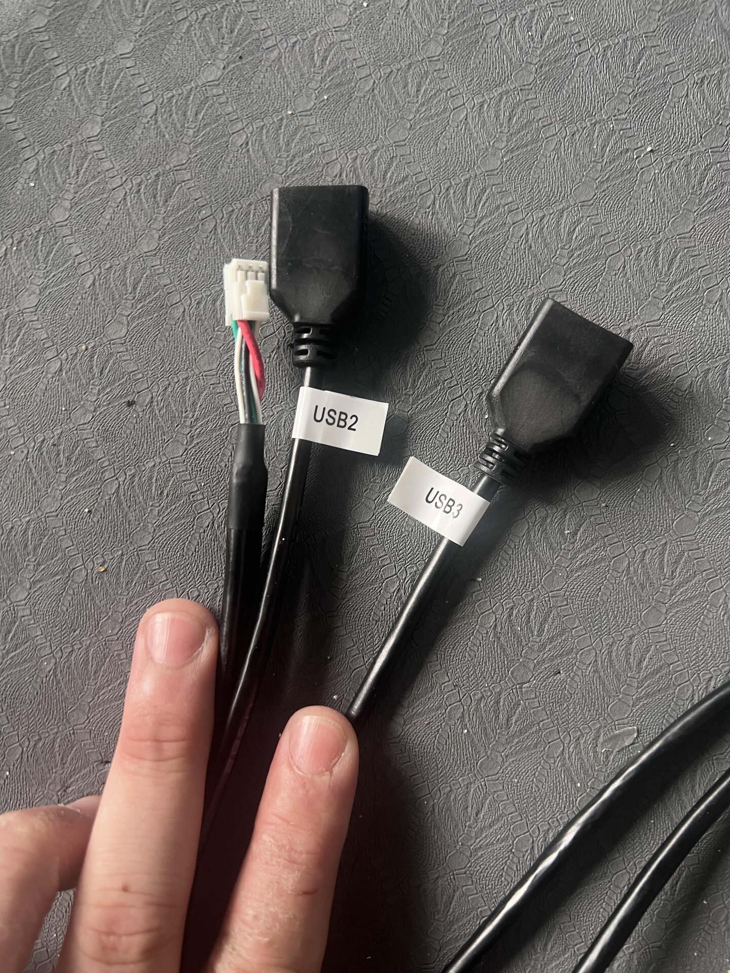

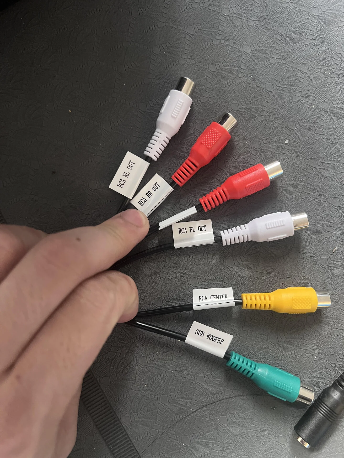

I was able to do the first test!
Good: climate controls, steering wheel controls, factory volume nob, bluetooth, music, and wifi work. no hissing.
Bad: No radio. No data (gps), cannot get a signal.
I hooked up wires based on this post: LX470 2004 | Need help with Android Screen - https://forum.ih8mud.com/threads/lx470-2004-need-help-with-android-screen.1277592/post-14671024
These are the wires I have left that I have not plugged in:
1st cable harness:
2nd cable harness:
3rd:
Name on wire: USB-1
1st cable harness:
2nd cable harness:
3rd:
Name on wire: USB-1
I never hooked up the radio on mine. I just stream all my music, so I'm not sure which harness. But I do recall seeing an ANT labeled harness with a coax port, but it's been awhile since I've installed mine.
