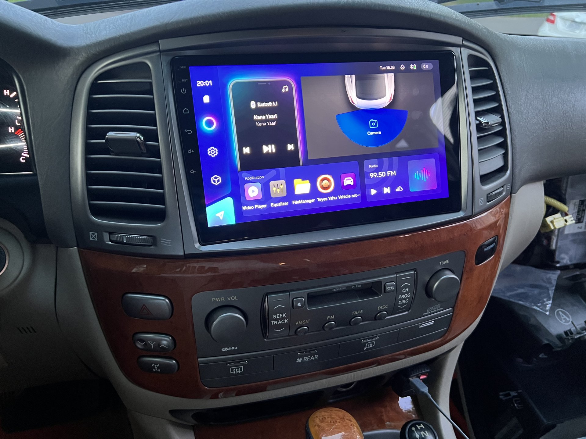

My Teyes unit shipped today (Hooray!). Just a quick sanity check to make sure I'm thinking about this correctly:
I'd like to remove my navigation drive and the factory amplifier in my 2005 LC. Outside of jumping the FL audio on the NAV harness, I shouldn't need to do anything else right? My intent is to use the Metro harness for my new amplifier.
I made a couple of quick videos showing the amplifier and RCA wiring in case those are helpful. This is on my '04. The Teyes wiring itself was just plug-and-play, matching up all of the connectors that could possibly fit together. Shoving that mess of wires in behind the unit turned out to be way worse than even the Grom Vline VL2 harness!
Amplifier wiring and settings:
Amplifier mounting under passenger seat:
