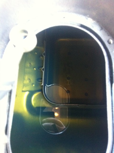

Since I had the I/C and water tank out, I figured I would update things encase people wanted to do a similar setup. All of the powder coating has held up great but the EMS ceramic coating has failed on all of the parts that see high direct heat. (turbo, j-pipe, downpipe, etc) the heat shield is still ok. It was free at the time but hindsight being what it is would have sent those parts out to well known ceramic coaters like Swain tech. With everything out of the way I guess now is the perfect time to get those "fancy shocks" on like Christo likes to call them! I am really looking forward to that! I checked all the filters in the meth injection setup and they were all completely clear which was a slight concern when I installed the system since I am asking so much of that tank, but everything seems to be working well.

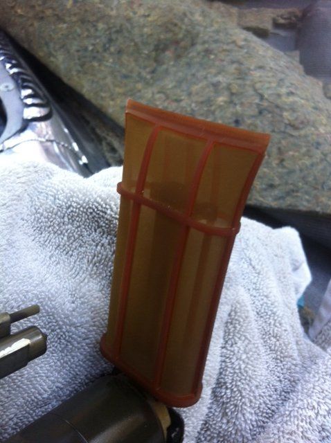

Well if you want to get technical its actually called a "suction low pressure filter" but it's been called a sock on mud long enough for it to be common nomenclature.
No that was the original "strainer". It's not called a sock.

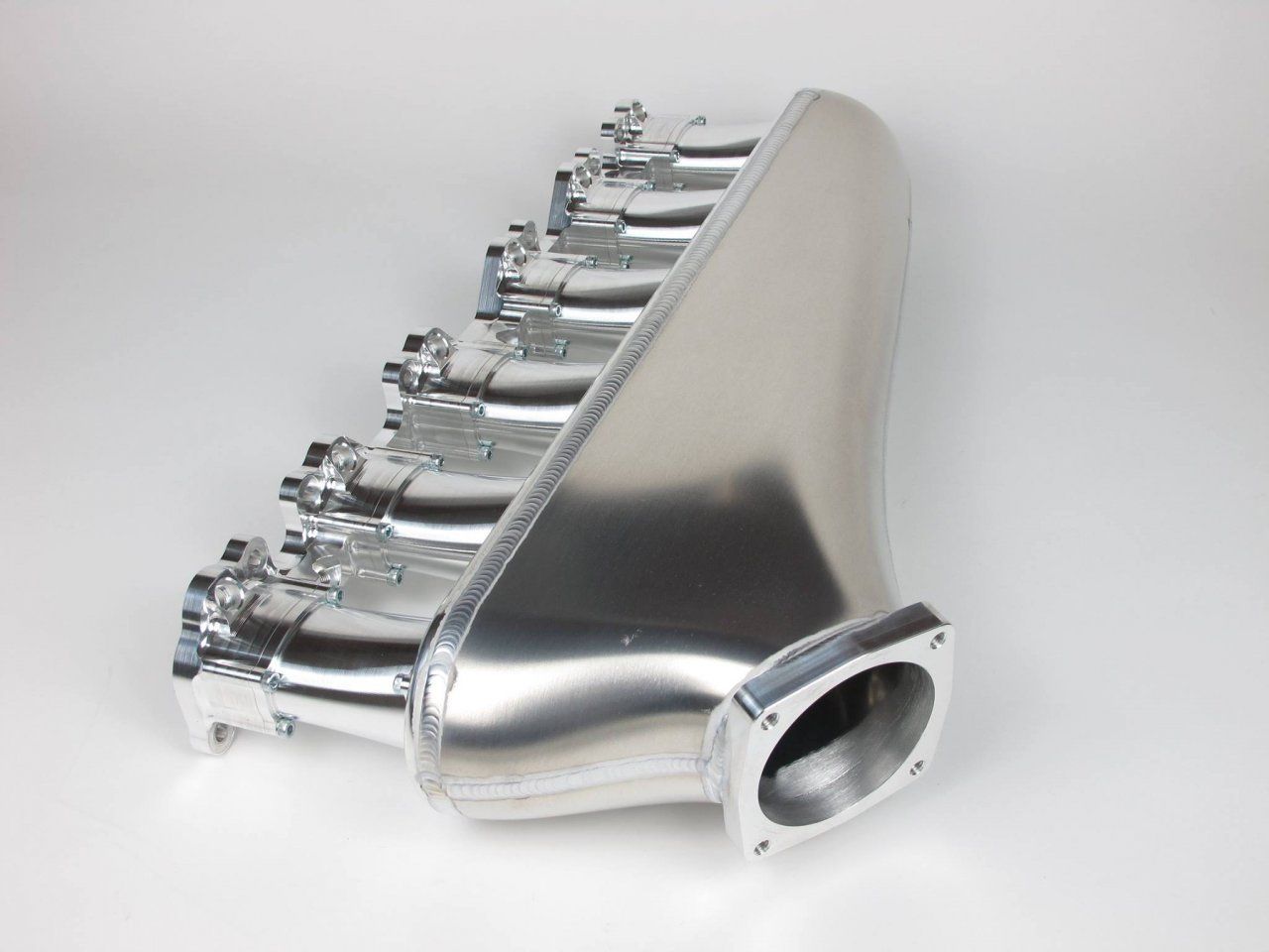

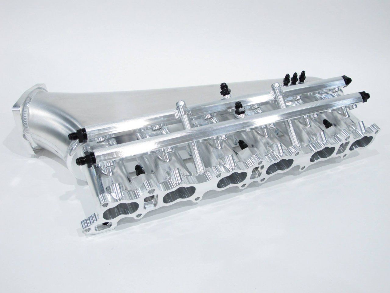

Just talked to Pete at Hypertune in Australia, about doing a 1FZ intake. They make some incredible 2JZ and RB26 intake manifolds. He said give him a month or two as they had already had it in mind. It would be a pretty cool setup and make it a lot easier for people that wanted to run A/A intercoolers.
Just talked to Pete at Hypertune in Australia, about doing a 1FZ intake. They make some incredible 2UZ and RB26 intake manifolds. He said give him a month or two as they had already had it in mind. It would be a pretty cool setup and make it a lot easier for people that wanted to run A/A intercoolers.
