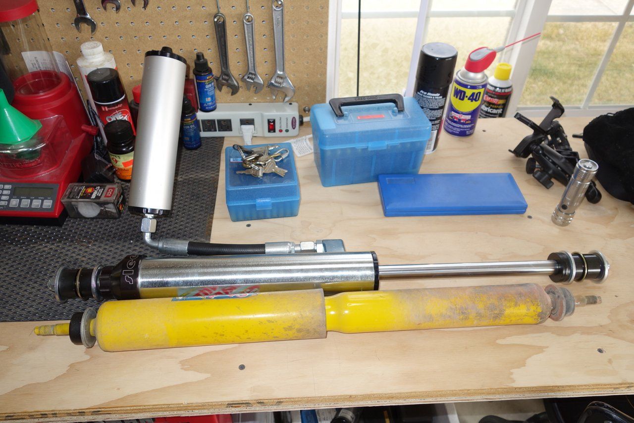

Started the Slee reservoir shock install today before the sun went away and laying on the ground in 30 degree temps was not appealing. Love these things. Just the ridiculousness of the overbuild quality, curious to see if I can tell a difference but it will be several days until I get the water pump back and reinstalled.View attachment 1019729
I am looking forward to your shock review. Do you know w if it is ADS who is manufacturing Slee's shocks?
Yes it is ADS their name is laser engraved on the nitrogen valve cap. I had to let the nitrogen out because I wasn't man enough to compress the shocks enough to get them in so I will have to run out and get them charged again. Great setup so far Slee hit the packaging spot on. Reservoirs fit perfectly on top of the spring tower.
ADS makes some quality stuff. That is some stiff ass compression they are set up for. Wonder how the rebound will be. Guess it has got to be stiff to control the sway of the heavy beast. Always good idea to check the gas pressure after installing anyway, so no big deal to have to let some out.
Yes they were very stiff it was all I could do to compress them with all my weight. I talked to Slee he said to start at 100psi for comfort and 150psi if you like a stiffer ride. I will have the shop put in 125psi and see how it feels.
Are they designed around the progressive heavy springs he carries? That is the spring i'm running and absolutely love it.
Well with the nitrogen you can set them up to match really what ever you like. The nitrogen range it 100-200psi so you could go really soft or really hard just depending on your preference. I am going to start at 125psi and hopefully it's close. :) I think at 200psi they would act like airbags providing considerable lift to tired springs.

I have a very serious problem with Slee's shocks.
The problem is they make the front end feel 5 times better than the OME's in the rear and I want rears but I am broke. Lol
The front end now feels very controlled. Going over expansion joints the front end now doesn't feel like a sharp jolt and a stutter, it is a thump and roll. The rear still has the jolt. I am at the stock valving Slee sends out and 125psi of nitrogen. Front end is OME heavies, Slee short bus, Warn 9500 with synthetic line, 6 gallons of water and turbo stuff. With a range of 100-200psi I am sure the lightweight and heavyweight trucks could be accommodated.
