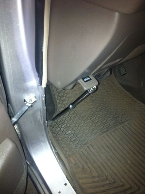

The other thing that I learned is that the hood latch on my particular truck is incredibly touchy. I actually locked myself out of the engine bay for a bit. After a little panic, reading on mud, crawling on the ground under the front of the truck etc, I learned that there is no real way to let yourself in from the outside. A few of the guys with the earlier trucks were able to jimmy the latch.... I am not sure if it is the later model year or a Lexus thing but they have a protective plastic shield around the latch mechanism.
So I beat on the hood a little thinking maybe it wasn't engaging far enough etc. I eventually rigged up a way to "pull" on the latch while being able to yank on the hood. This finally worked. Lots of crouching and watching the hood drop. I finally got it close enough that it will open. It doesn't have that authoritative pop that I like, but it opens.
Here is my rigged way of holding the latch inside the truck while I yank on the hood.
If you are doing the headlight harness upgrade, maybe trace around the latching mechanism with a pencil so you can get it back in the exact same spot. My truck may have been in an accident or something but there didn't seem to be much room for error.
Ryan
If you adjust the bumpers on the sides of the hood up, you can put spring in the hood. Just make sure hood is flush with fenders.
I had to loosen my hood latch bolts and move latch all the way up. Pops like a champion now. 3 Minute Job
