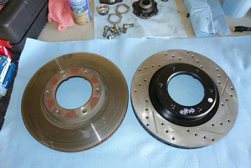

Hopefully this is a better picture. Old rotor vs new rotor. Yes I am prepared to kill the bus load of nuns and children with the slotted and drilled rotor. Lol

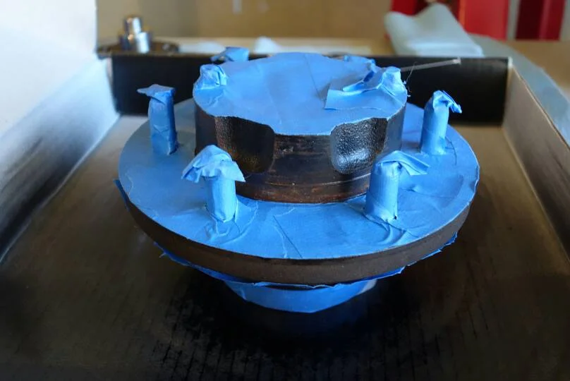

Also taped up and painted the hub, kind of a waste since there are so many mating surface. Hub to disc, hub to spacer, hub to drive flange, so really you are just painting the body, which on my truck with the 1.5" Spidertrax spacers can't really be seen. Lol. Oh well.
Can't even see the hub. haha. But I felt like Delancy and NLXTACY while I was doing it. :flipoff2: ;)
