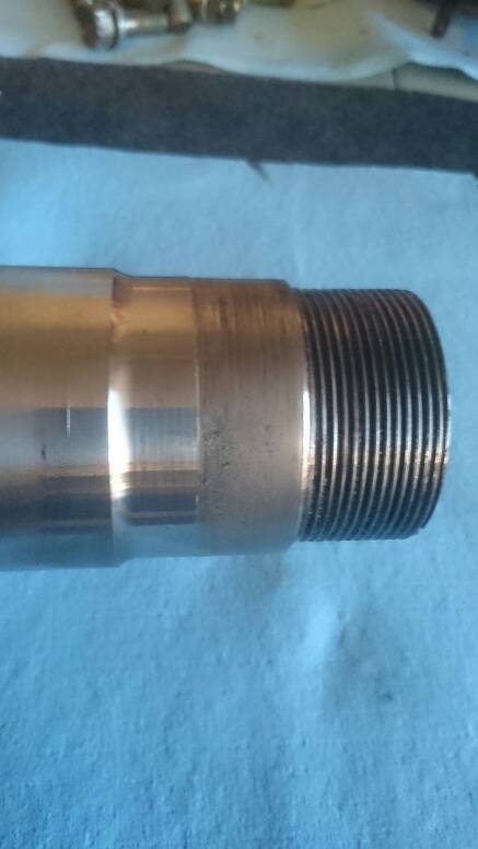

Doing the front end, some interesting observations.
I knew I had some bearings that were bad, I haven't been into the front end since I have owned the truck. But everything was looking too good. The rotor looked new the pads looked new, but I soon learned they only half assed the job. :-/
The pads looked almost new and measured - 0.500 - 0.520
0.500 - 0.550
The rotor was 1.270 inches so 32.258mm which is way above spec.
The next thing I noticed which is probably total coincidence is that the outer bearing and race were trashed. Outer was a Timken bearing while the Inner was a Koyo.
Hmm some surface rust and pitting on the back of the knuckle. Not too bad, it will still clean up and be Ok. Can't believe those damn spindles are $200ea! That has me a little bummed. Lol
