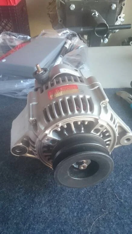

I do have them sitting on a shelf they seem great at no speeds lol. I am hoping to get them on not next weekend but the weekend after with the front end rebuild. Next weekend is alternator replacement, fusible links and wiring clean up. weekend after the front end is new brake master cylinder and new ujoints. So much fun! <sarcastic font> lol.

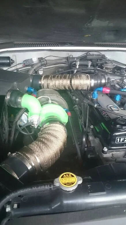

I wrapped my intake and charge pipe today, people said it probably wouldn't matter but the outside of both pipes would get hot enough it was uncomfortable to leave your hand on them. The charge pipe especially. I bought this new wrap that is supposedly lava rocks and titanium, lol, I had to buy 100' of it but I double wrapped the intake and single wrapped the charge pipe and still have 30+' left over. It's a lot easier to work with than the old fiberglass wrap that you had to get wet and that left glass fibers stuck in your hands, but this stuff is sensitive to snags and runs like pantyhose lol. Anyways I have 30+' of it and can't think of a use for it. If anyone wants it, it's yours for the ride.

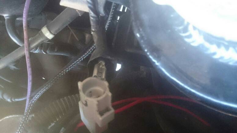

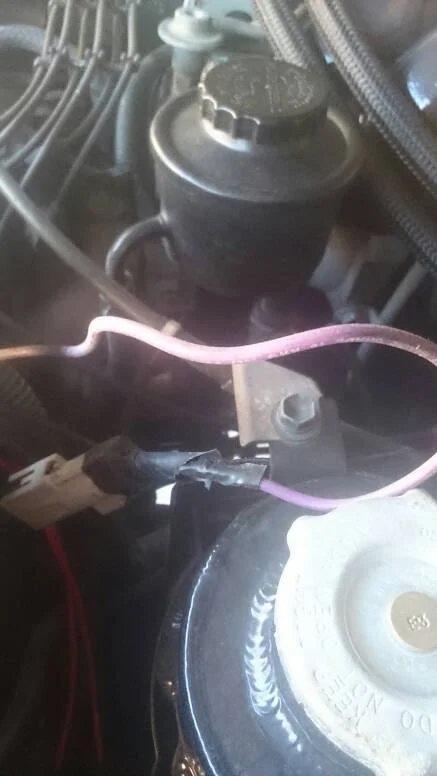

If there is one thing I hate more than anything when dealing with cars it is wiring. I would gladly pay for people that actually did a good job. But you seem to get more half assed wiring jobs than any other aspect of automotive work. Take this sweet fusible link setup for example.

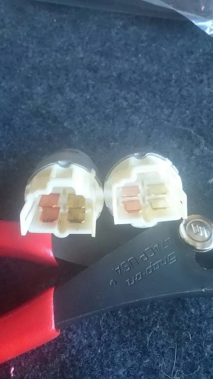

Swapped out the EFI relay even though the old one looked brand new. It will be a spare for the tool bag. Funny when you buy parts from Beno and then forget what you bought and where they are. Lol

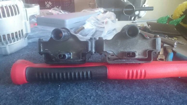

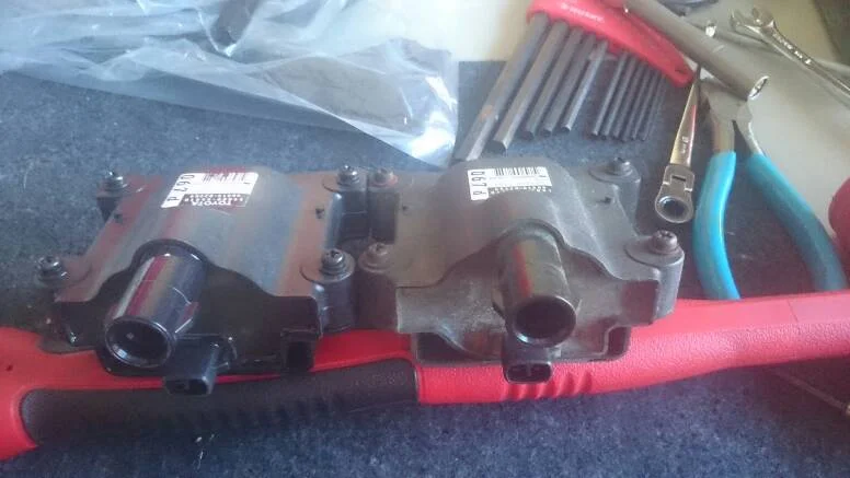

Either someone beat me to this, which I doubt given the fact they didn't even change the coolant or these parts are in outstanding condition for almost 18-19 years old. Coil assembly looks great and will be another spare.
