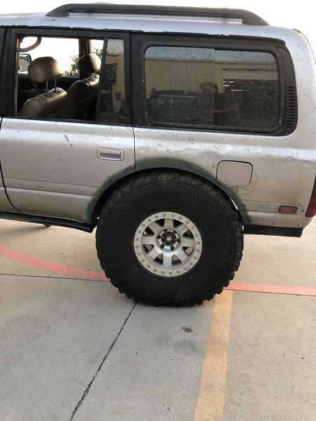

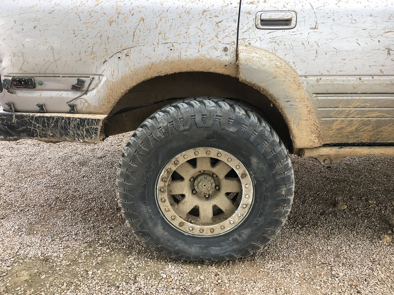

Wheels and tires installed, heading out to Gilmer/Barnwell this weekend.

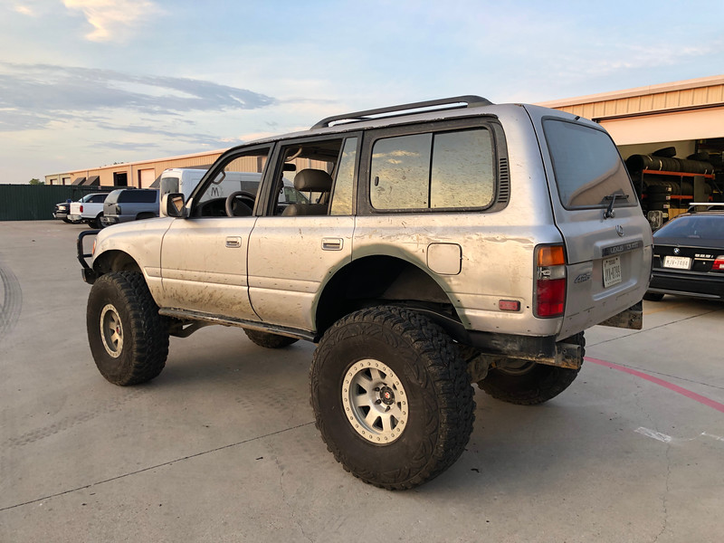

I've decided it's time for 40's, so I'm starting to order parts. I was concerned with the strength of the 5.29 pinion gear so I decided to do 4.88's which theoretically have a stronger pinion gear and more contact patch, but with the transfer case 10% high range under drive kit and the low range 25% gear reduction(really 33.3% reduction when coupled with the 10% high UD). Versus the 5.29's this should give me effectively a 5.35 in high and a 5.195 in low(I might need some help on that math), plus the 25% reduction in low. I will probably also have the diff gears cryo'ed.

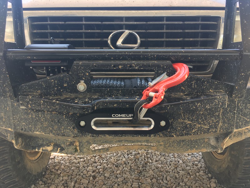

Comeup 12.5RS winch(already installed, smittybuilt is gone)

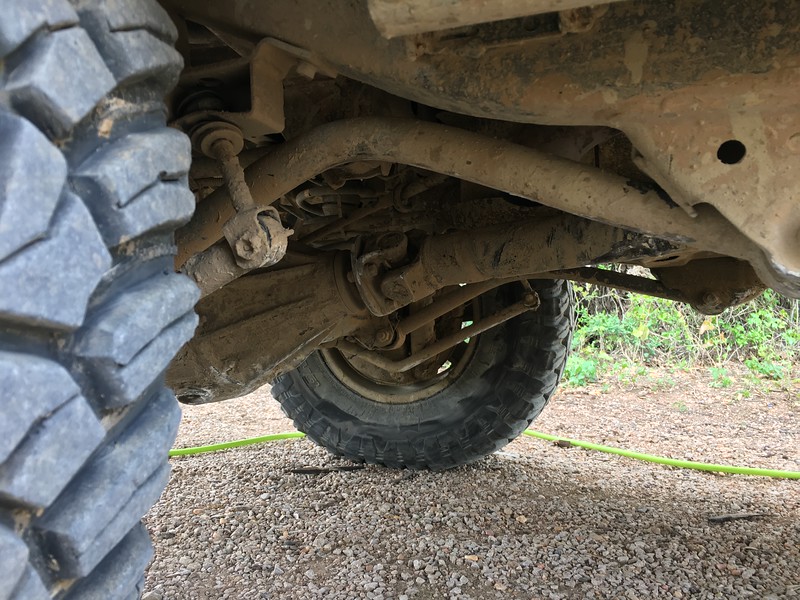

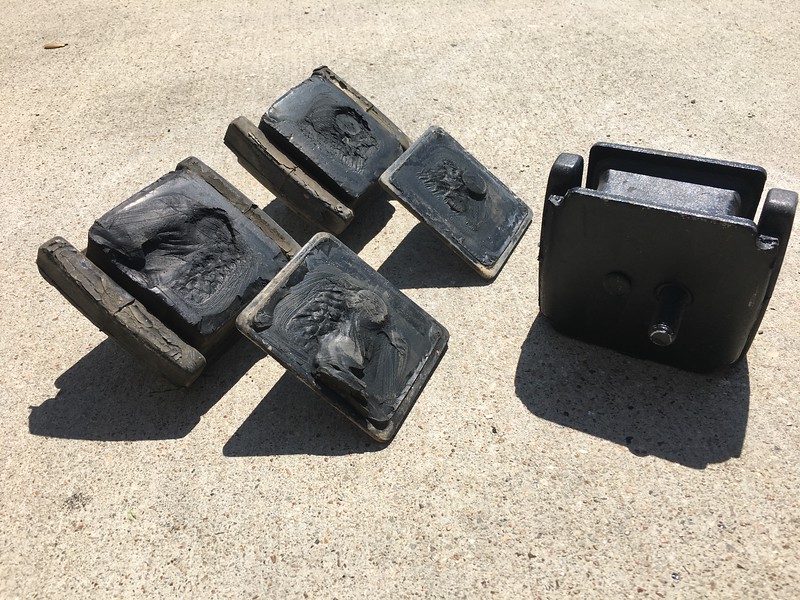

I also ordered and installed the toyota center diff lock switch and installed it and did the pin 7 mod. I have had a few issues with the truck, one trip out wheeling it would pop an EFI fuse instantly, there ended up being water in the front O2 sensor connector. I later had an issue where it would pop an EFI fuse intermittently under high load, I later determined it only did it in reverse. It ended up being the pre cat O2 hitting the body under high load in 4L in reverse and grounding out, which ended up being caused by both motor mounts being completely separated so I replaced both of those. I also tightened up my AC belt which had been intermittently squealing, that took me long enough! I had to cut my last wheeling trip short as the rear lower control arms buckled so far that the body was shaving chunks off the tire under compression

Mine took a hard hit when landing on the front tyres, later confirmed both motor mount rubbers had started to part company with the metal, might be worth a look given their age, prepare for a wallet shock if going OE.

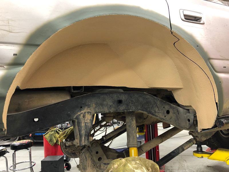

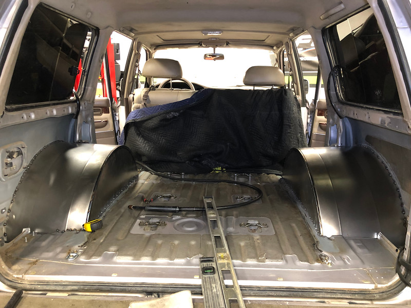

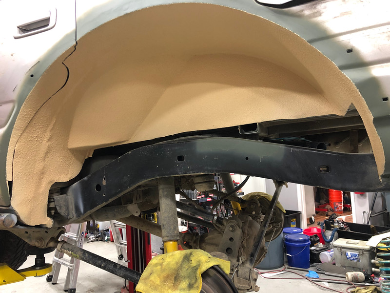

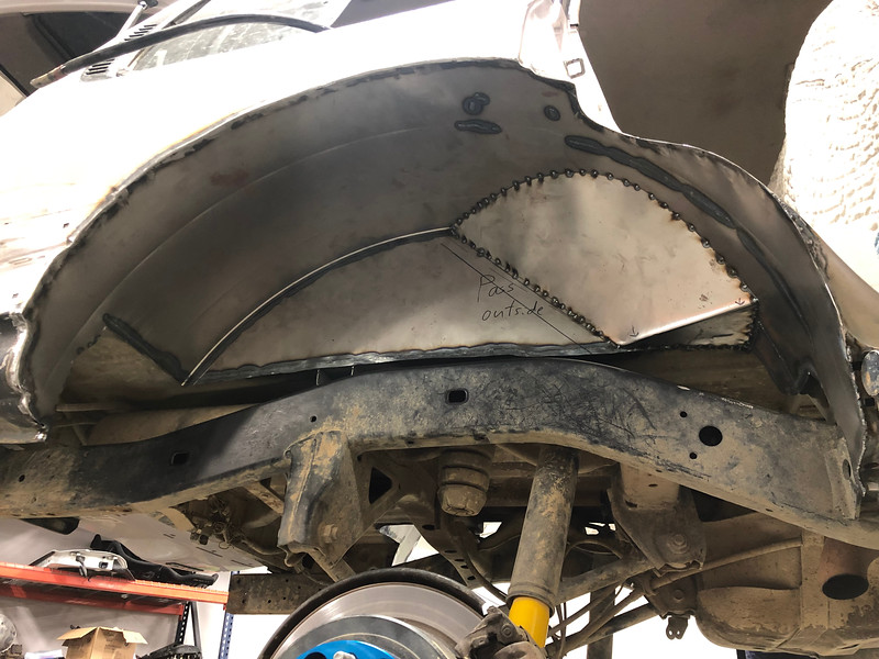

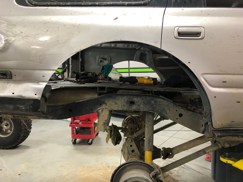

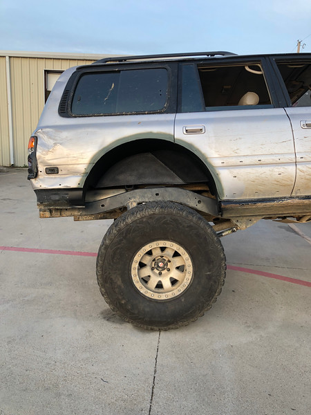

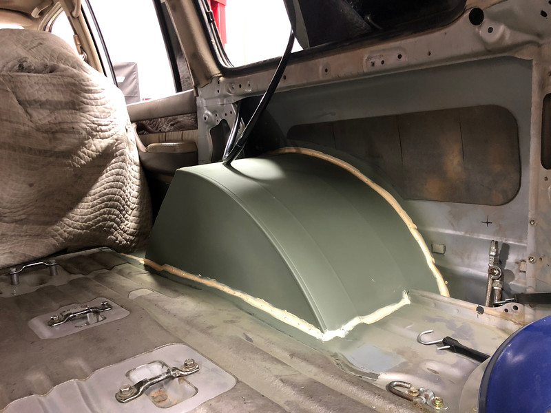

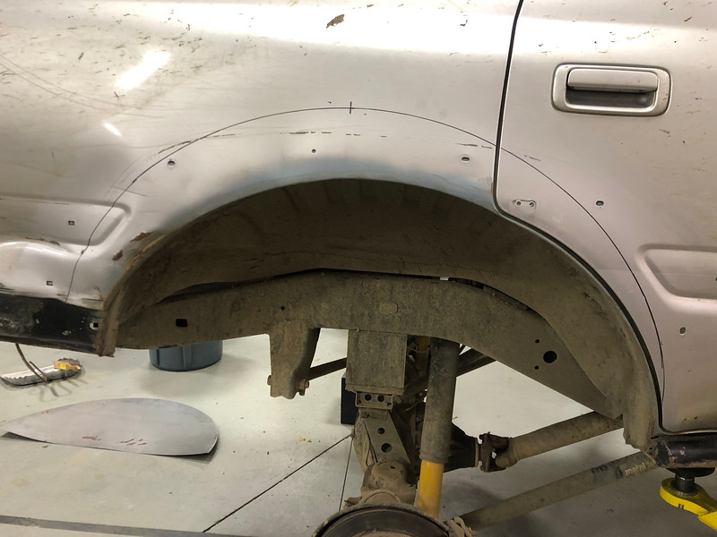

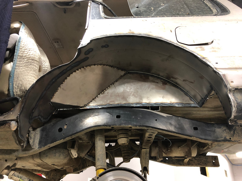

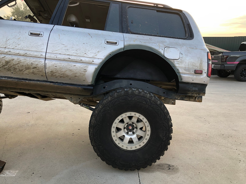

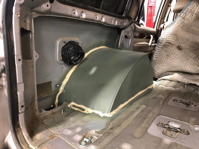

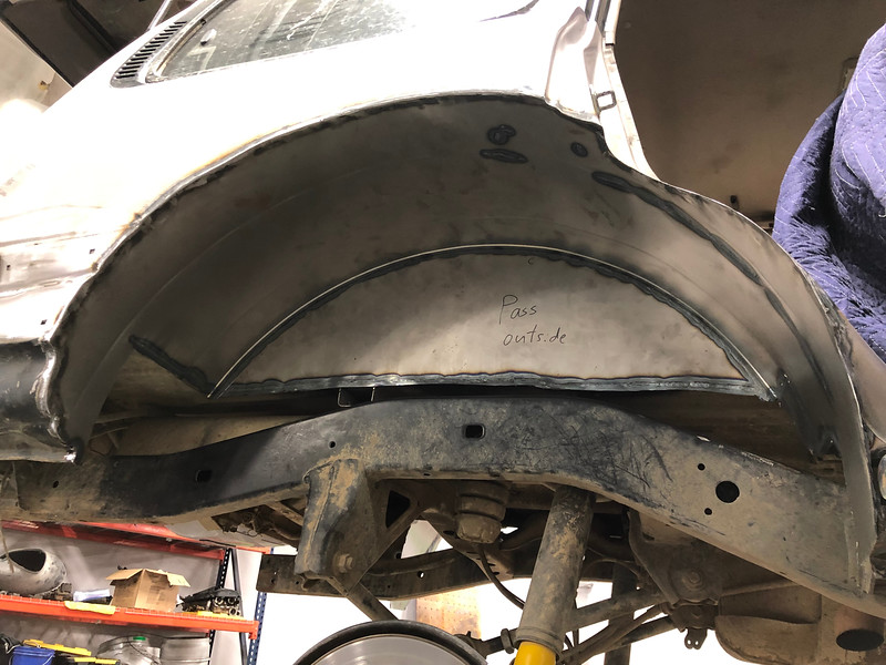

I'm not very good at keeping this thread updated, best way is instagram( Greg Smith (@gregs86) • Instagram photos and videos ). What I've been working on recently, i got tired of the 1.5" of uptravel befoe hitting the bump stops when loaded down on the road, cutting the fenders out and going to 43" tubs moved up about 4"(which i had previously moved up a couple inches when I went to 40's).
I follow your build on IG! Love it! New fender wells are great! Awesome, awesome build man!

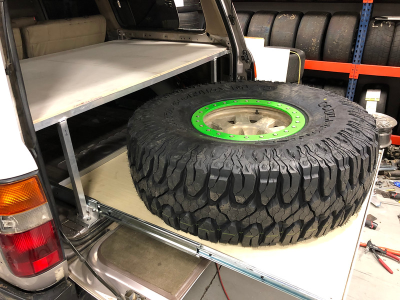

Best place for the spare, SWEET REG, Dig you fab work/skills those tubs are sick Dude I want a set.
