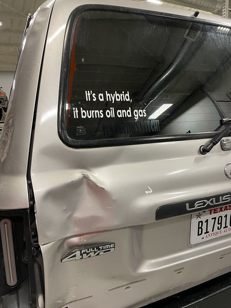

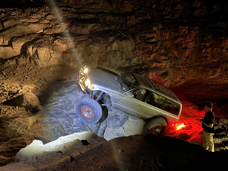

The reflection on the back window in the last pic reminds me of a mural you'd see on the side of a 70's van

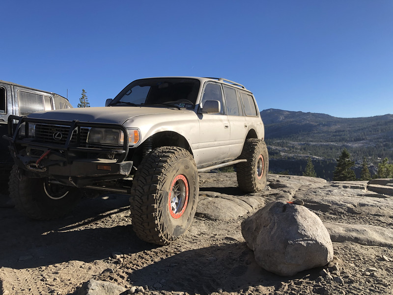

Defiantly not a trailer queen.
Awesome to see the transformation of non traditional means.

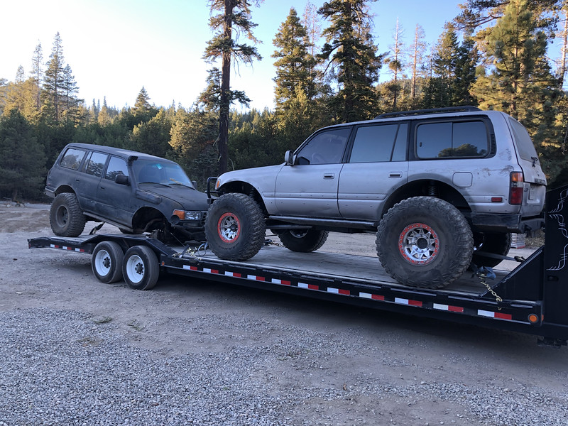

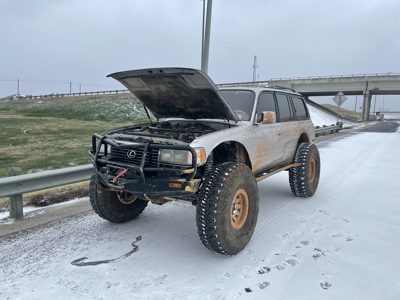

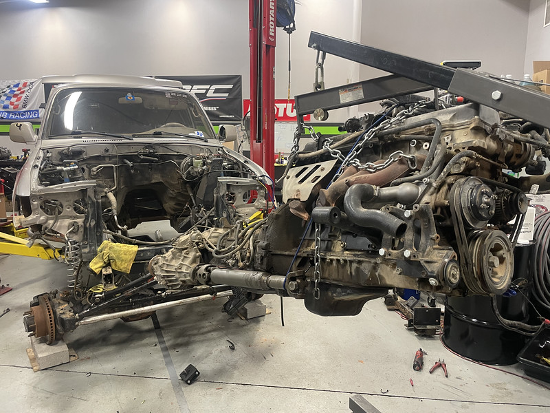

What motor did you put back in?
Stock motor threw a rod, I replaced it with a ~240k mile 1FZ which I was told blew a HG. I replaced the HG, lapped the valves, replaced the rod bearings, and resealed the whole motor. Didn’t do anything to the pistons/rings/bores as I had to do everything within a week.
