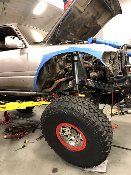

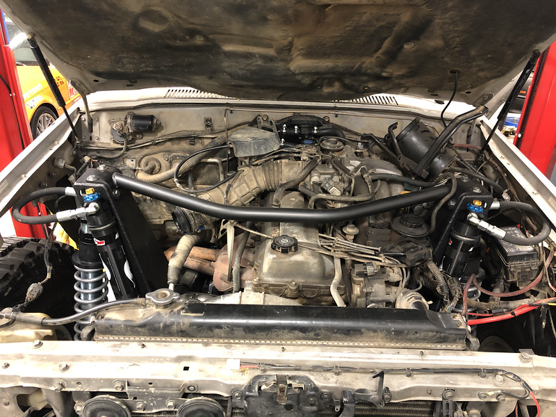

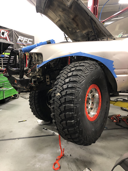

Looks good, Im very curious on how the front fenders will look like when your done making room for the uptravel of 42s.

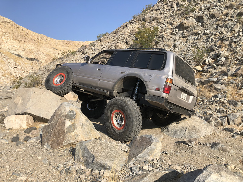

Absolutely incredible work you are doing here. This rig is begging for a V8 and an Atlas now.
