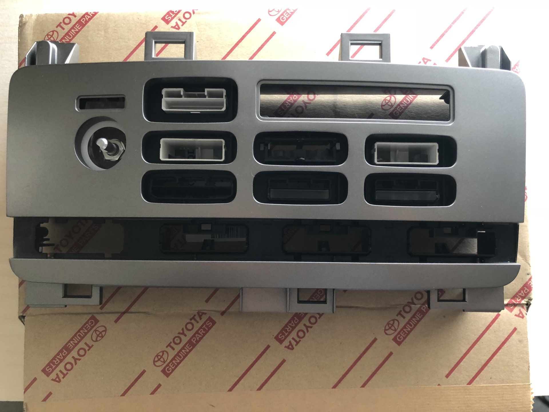

All the parts you a trying to source are used on LX's outside of the US.. so finding used parts is almost impossible..two of the key components needed to keep your LX looking stock is the LX lower sub panel and the ac amplifier. It's easy to find pricing on US sites and they even appear to have the parts available. 90 % of the time you will be informed the part is no longer available.. after placing the order. If you are lucky enough to find the panel below along with the AC amplifier you might be able to complete the swap and keep stock LX look....otherwise the Land Cruiser panel along with the matching AC amp for the LC panel would be the way to go. If you go back a few pages I discuss this and the fact that i was lucky to find one on Mega-Zip..
I work for a Lexus dealership and have my parts guys inputting these part numbers every few days hopping one will show in the country but to date we've had no luck. If i do find one or the other I'll buy it and post them in the thread for sale at my cost.
The knob kit you listed is needed... the only buttons that carry over are the Rear A/C, Defrost and heated Mirror
Sub Panel 55905-60130

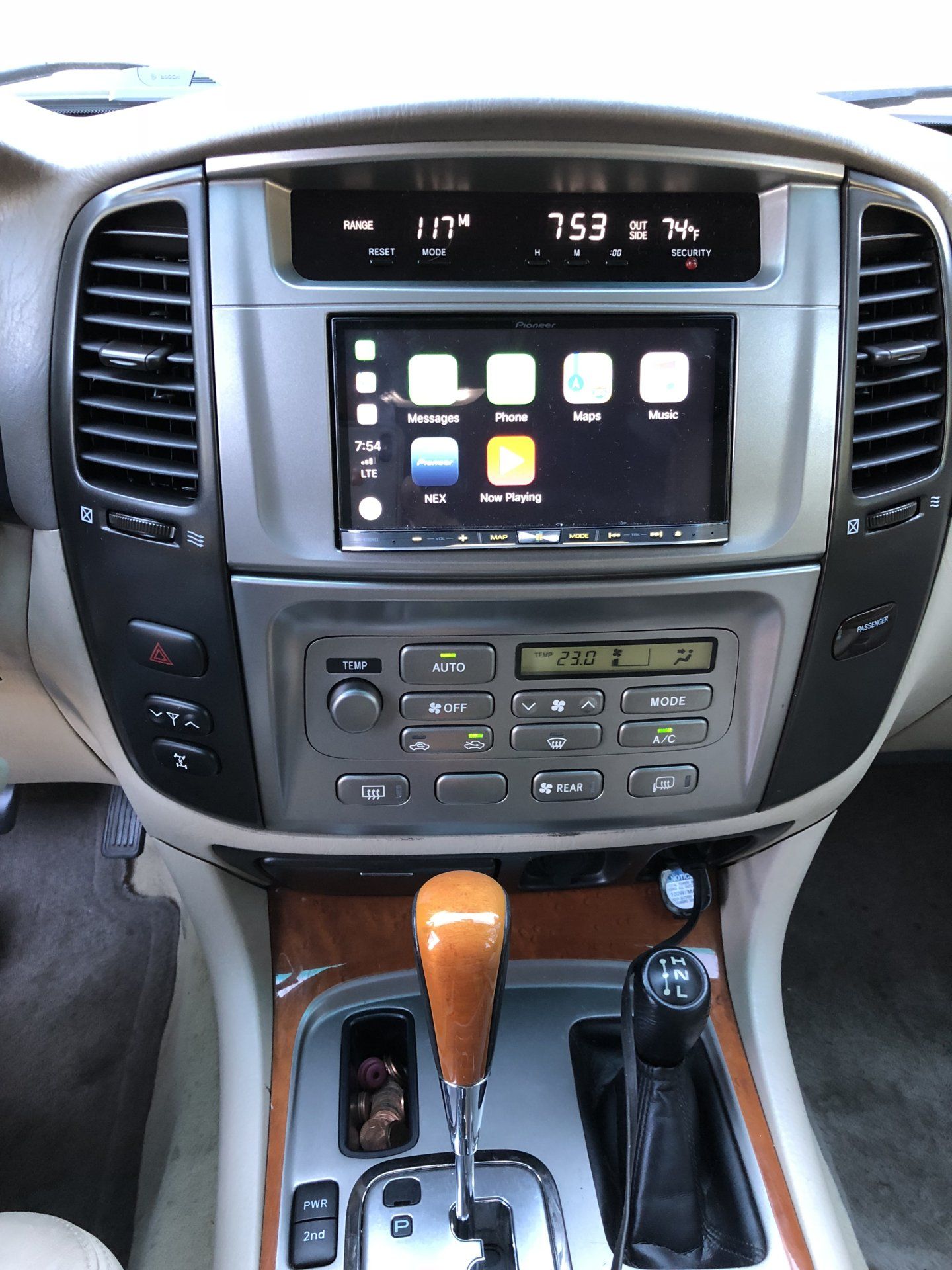

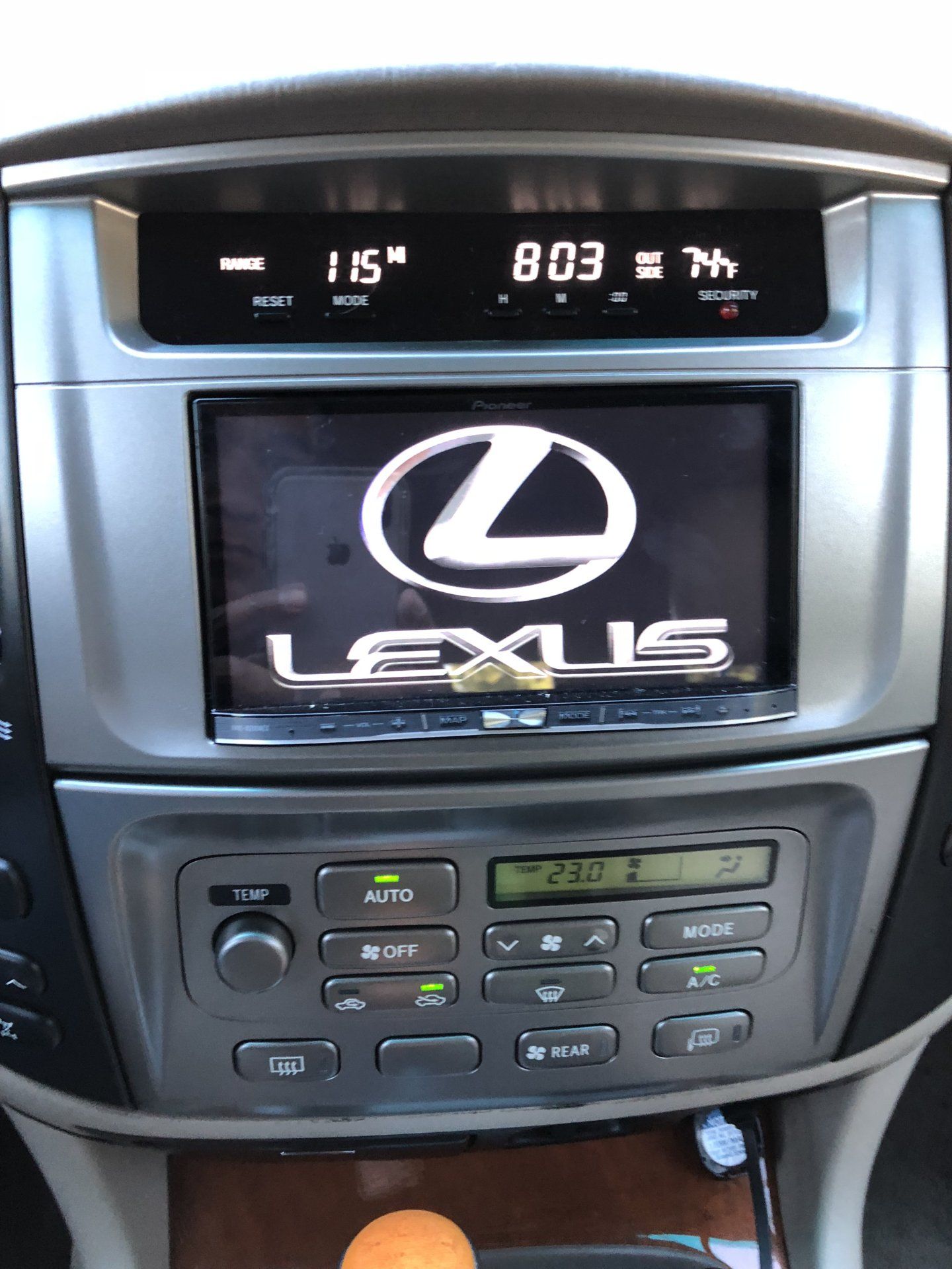

I just finished the conversion last Sunday. As of today, my center console now looks like a Landcruiser. Everything went pretty smooth. I took my time as I soldered and heat shrink every connection or open end wires and triple checked every wire I moved and cut. Jerry's instructions were pretty accurate. Bracket part number 86207-60020 and 86208-60020 worked without any mods.
Thanks Again Jerry for all your efforts.......
Bummer as of today.... My AC is blowing hot air. I'm sure its not related to the conversion....
