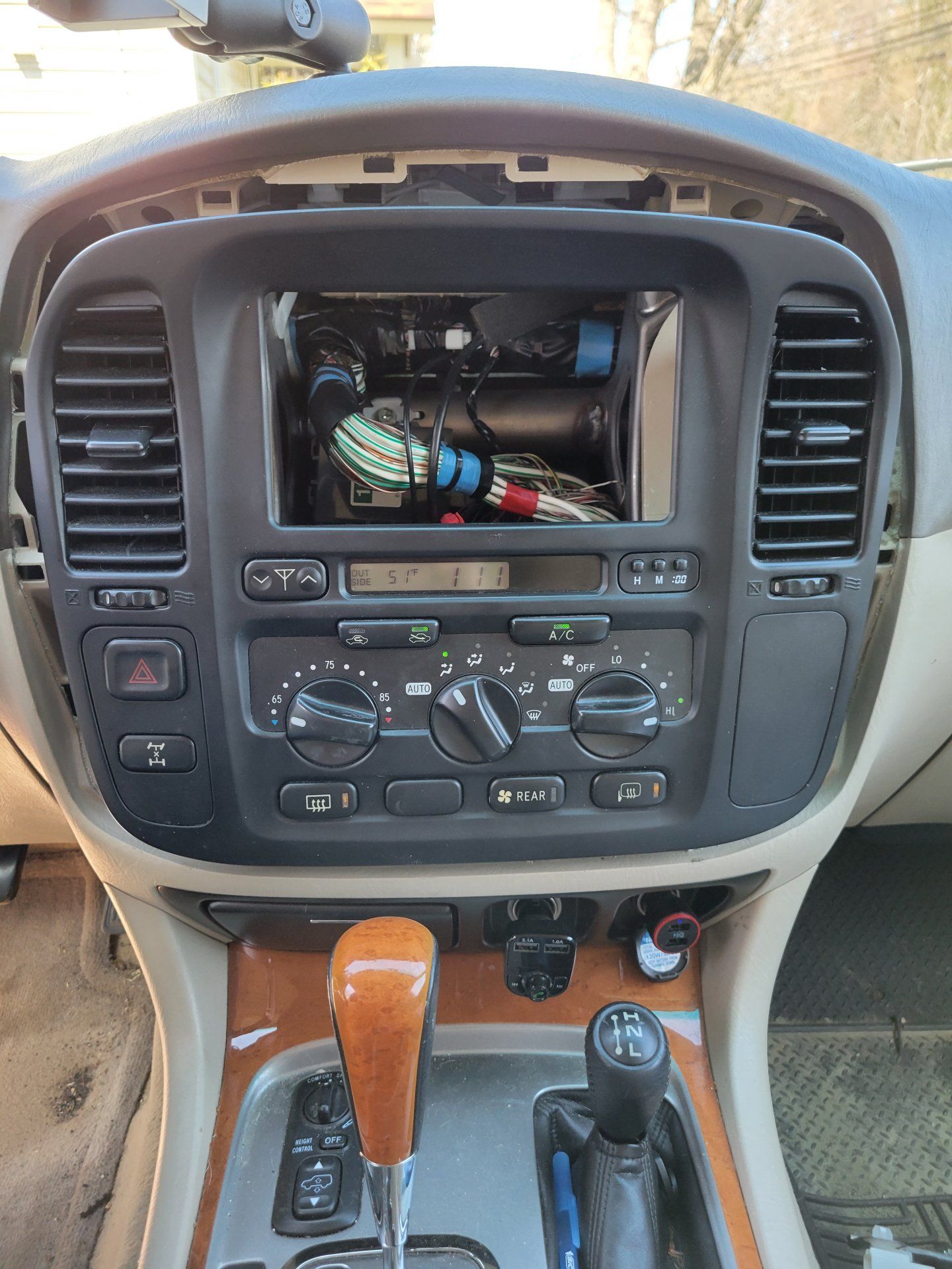

Ok, so the good news is that the LC 3 knob climate control does work in an 05 LX. Bad news, it doesn't fit.....I knew that going in and have some ideas on making this work. I'm just relieved that the electrical stuff works. First time I powered it on nothing worked and then I realized that the wire taps I used for testing this thing are complete s***. They don't actually pierce the wire so I had open everyone up and push the wire down with a screwdriver to make good contact. The only thing that still does not work is the rear climate button so I'll have to investigate that. But yeah, here it is. A working 3 knob in a 2005 LX View attachment 2634353
Very interested to see how this turns out. Any pictures of the backside of that assembly? I feel like the easiest way to get it to fit will be to trim it to fit between the two 2005 air vents pieces. Then make some metal brackets to hold the trimmed assembly at the right depth and securely. Then use bondo to try and smooth the transitions and match the contours. Nonetheless, well done!
I do plan on putting the dremel to work on this thing but I'm waiting on some stereo bezels to come in first. I do want to keep the vents and and as much of the lower dash panels as possible. More to come and of course I'll document every step

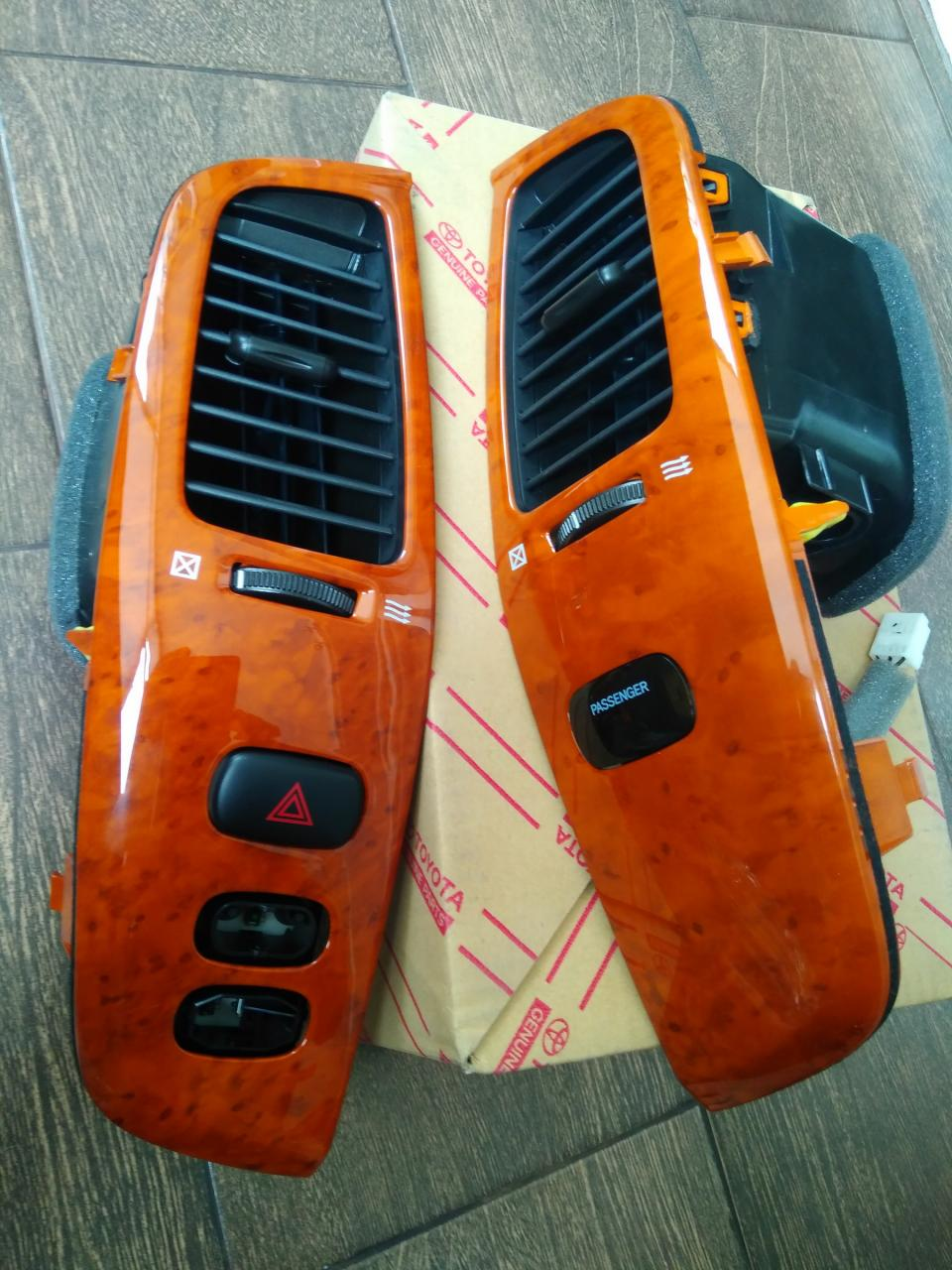

Hi all, I realize the lx470 parts are no longer available, but the lc ones are. Im thinking of doing the lc swap but wondered if the genuine sahara woodgrain vents matched the lx470. If so I was thinking of trying to obtain them.
someone has posted pictures of the different wood
start reading from page six or post #112
I posted the picture on page #4 Sandalwood , It's not a match
So I might be able to get the full sandalwood trim set including doors and shifter, vents, heater control unit, radio surround and clock (basically the whole centre section including brackets minus the doubledin radio) out of a sahara for 1000aud or 670usd, is this good value? Im thinking this is the next best option now the original parts are unavailable. I have tried to find the lexus parts secondhand but to no avail.
So I might be able to get the full sandalwood trim set, vents, heater control unit, radio surround and clock (basically the whole centre section including brackets minus the doubledin radio) out of a sahara for 1000aud or 670usd, is this good value? Im thinking this is the next best option now the original parts are unavailable. I have tried to find the lexus parts secondhand but to no avail.
