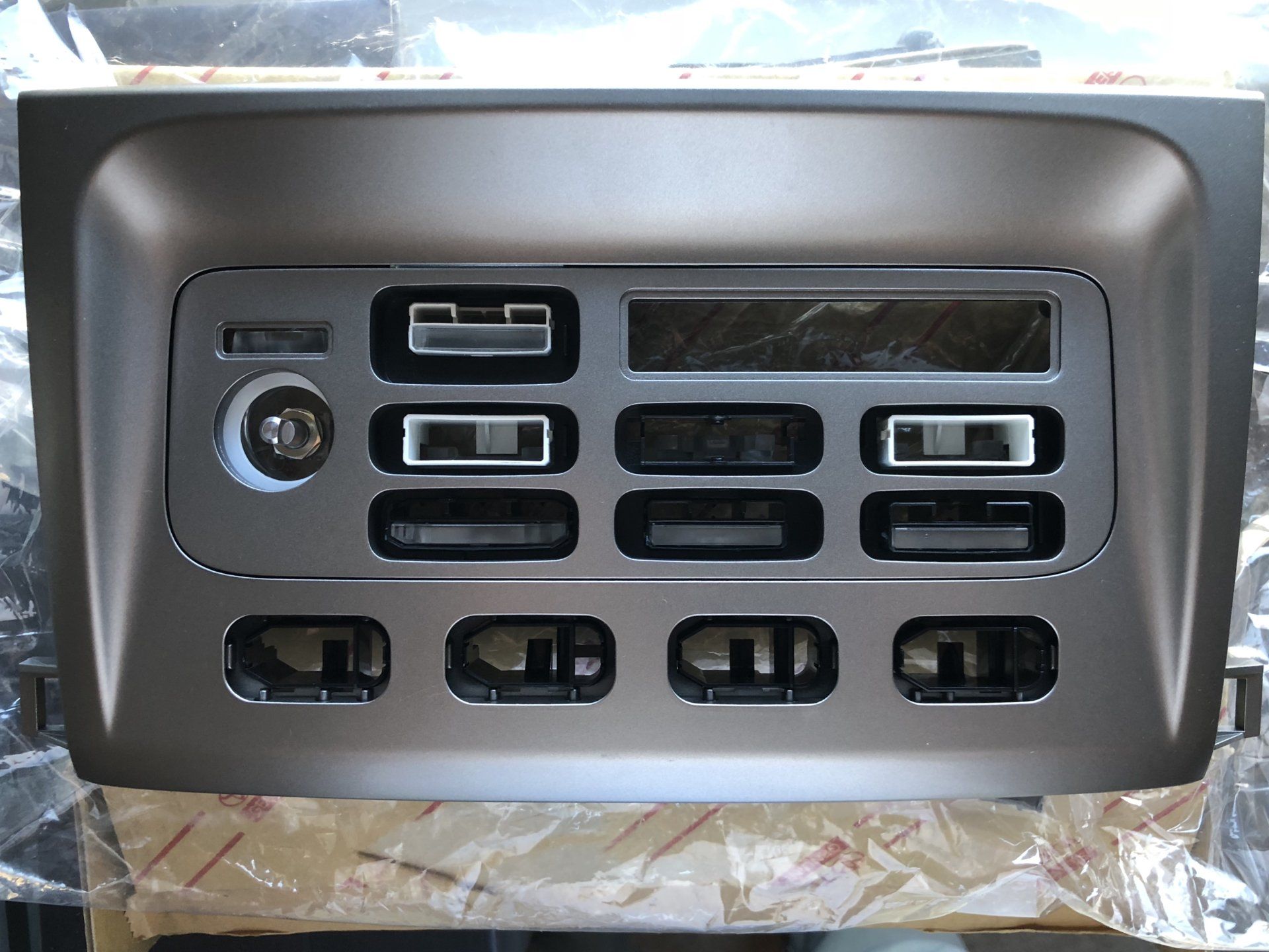

Jerry, you can buy the vents I ordered as LX Panel just arrived.. I also have the LC panel if anyone else is interested
I just checked Megazip just before posting this and they show another LX
Panel available 55902-60130
You guys think the Lancruiser board would work with this part. I want to swap mine since Luke said there is a Lexus part available.
I can't answer that question but if you're going this route make sure you can still get the LX board 84014-60210. I can check with my parts dept Monday
the upper board would but the lower skinny board wouldn't. Find someone to buy the LC board(s)
In fact sell the whole lower assembly if you want to go that way, after you get the new set.
bump the LC non nav thread. Someone will buy it.
I returned mine at logo Lexus when I couldn’t find the panel. So I’m wondering if I could use my existing one and save me the trouble.
Jerry, you can buy the vents I ordered as the holy grail LX Panel just arrived.. I also have the LC panel if anyone else is interested
Went to buy it this morning..... Gone already :( :(
The parts do get sent back but I just checked with my parts dept and there are 3 in the country...If you didn't order it you should
Luke are you talking about 55902-60130? Do you mean I could get one from Logo Lexus as you stated there are 3 in the country?
I thought you where talking about the LX board not the Panel 55902-60130.. I would keep checking

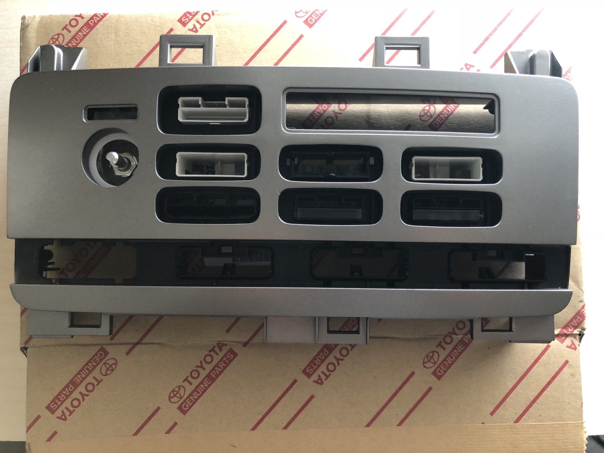

I have new in the box 55902-60110
Panel Sub-Assy, Air.. i’m doing this swap on my LX...at the time I could not locate the right panel for the LX so I purchased the LC panel and then I found the right panel...so this is available if any of you guys need it shoot me a PM $215.00
Free shipping in the US
