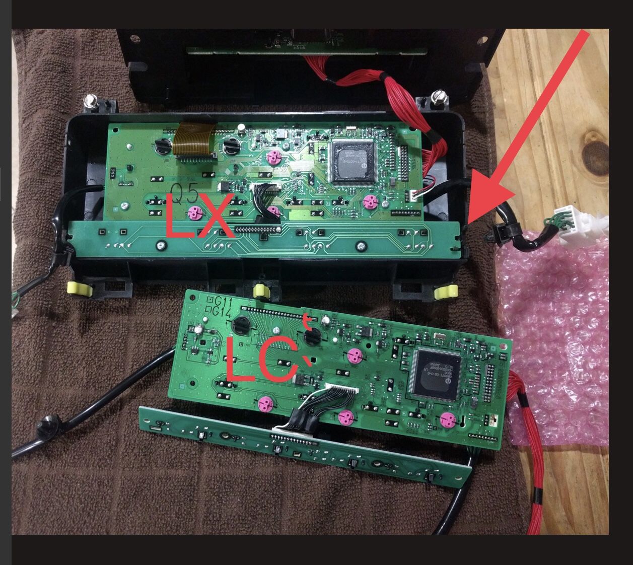

go back to the first posts in this thread and the post 2003 non nav thread and compare, im afraid the answer is yes. BUT that doesn't mean that circuit board will not fit the plastic cover. they are mostly identical , LCD screen, lower led lights, the lower skinny circuit board for LC is shorter. I compared the two lower boards in this thread on page 4.

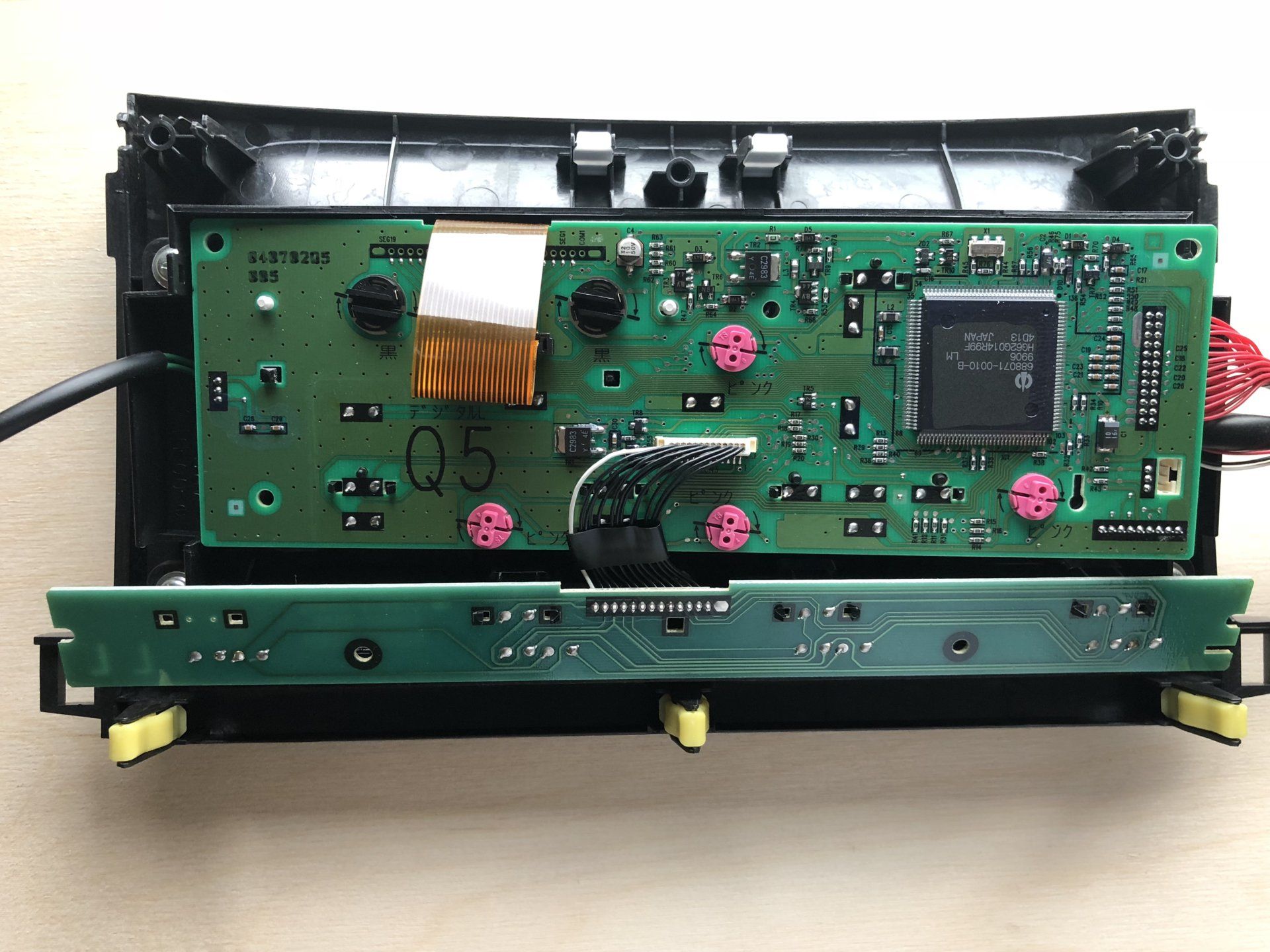

So I think I understand..,the board we ordered 84014-60210 will not fit the LC
Panel 55902-60110.. the top section fits but the lower section of the LX board is to wide and will not fit the LC panel.
So the fact that the LX Panel 55902-60130 is no longer available and we have to use the LC Panel we have to order this board 84014-60190 but if your production date is 01/2006 and later you have to order this board 84014-60350

Looking below you can see the LX board will not fit in the lower section of the LC panel and in the other picture the LC board both top and bottom section are the same width and fit.

Not sure what your question is. For those who own the LX470 and want to do the Nav Delete which moves your A/C and heater controls into the cassette deck space the panel below is no longer available so we have to use the LC panel and purchase the LC side vents. I pretty much explained the reason why you must swap boards above.
What I was saying was could you swap the to long LX circuit board with the shorter LC circuit board and make that unit work and fit?
The boards are not the problem.. This panel which has the buttons in the photo below which came in LX470's outside of the USA is no longer available (discontinued) so we have to use the Land Cruiser Panel. I purchased the LX board before ordering the panel.. If you look closely at the two panels they are different.

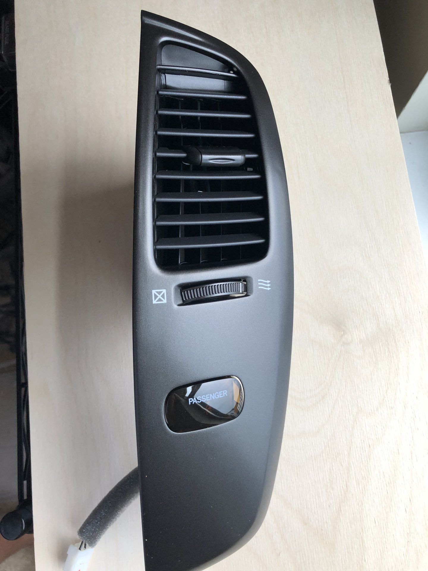

Placed what should be my final order from PartSoug today. I also returned the LX board and knobs and ordered the correct board for the LC panel from my parts dept ( I've worked for a Lexus dealership for 29 years) I decided to just order the gray LC side vents instead of the Sandalwood plastic.

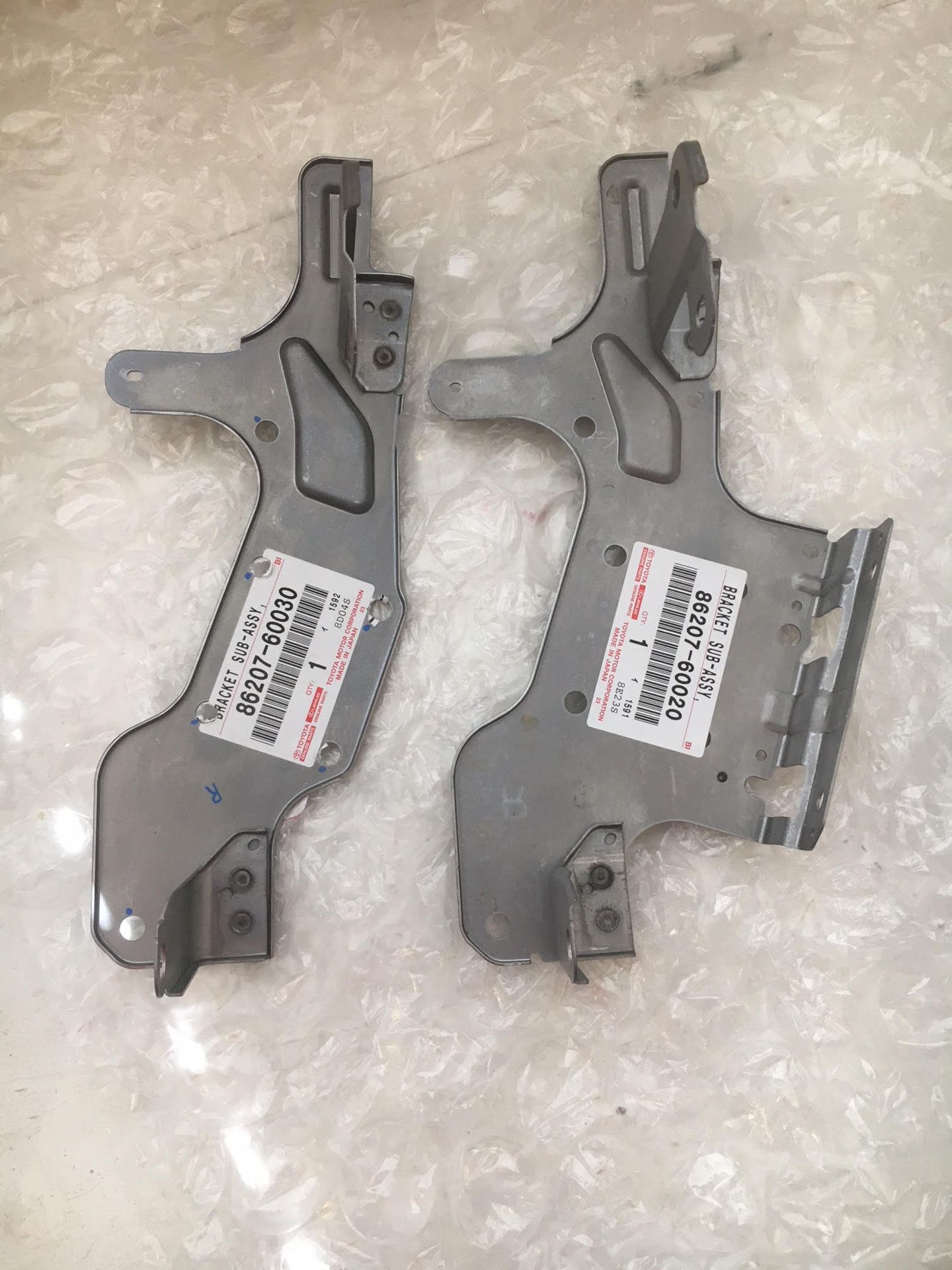

Just to add this in here. Jason found other brackets that will work. He posted them in the LC nav delete thread if anyone doesnt follow that one. Get them before those run out as well.
Ordered 86207-60020, 86208-60020 from Amayama today, just in case 86208-60030, 86207-60030, 55912-60140 doesn't show up from ssg.asia. By the way 55912-60140 is also hard to find. Just hopping ssg.asia comes thru. Its been 2 weeks and no ship date.
jason got stuff from there. Long lead time. That 60140 part has an equivilent LC part that works the same. There's only minor differences, either one will work for both LC and LX.
Just look at my parts list I'm thinking LC's 55912-60150 is equivalent to LX's 55912-60140? Which I already have coming worse case scenario if ssg.asia comes thru then I will have some extra parts.
