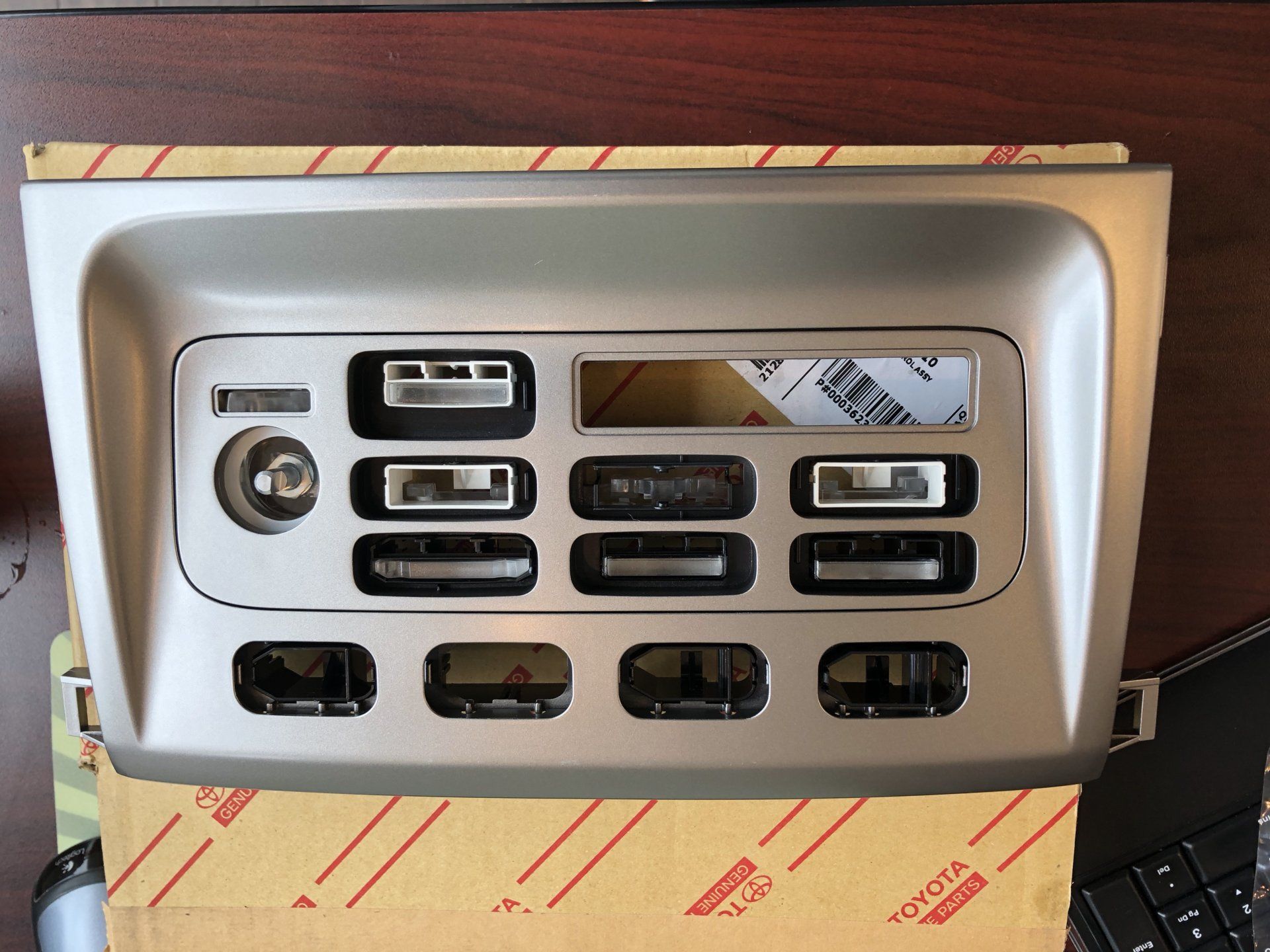

ok, so I was fortunate enough to get the toyota latest heater circuit board with the airbag controller. it's 525$ it has the top board output for the yellow airbag light in the side panel next to the passenger seatbelt reminder red light and fits perfect in the lexus housing.
the correct lexus board is discontinued.
So i had the lexus housing, and the lexus boards and the toyota boards. seen in the pic.
I connected the top board (toyota) to the lower board (lexus) and installed it in the lexus(2007) panel, it works fine, the top boards are the same, minus one LED.
It's the the middle light in the recir/auto/fresh button. Which is the redundant light in case you can't see the BIG auto light in the big AUTO button , lol. maybe that's why it costs $100 more. So you can save $80 or so using the toyota knobs.
Another option is using the lower toyota board and just making the rear defrost button work and disregard the rest.
The hole spacing is off, the locator pin is off, but you could make it where one button would work I'm pretty sure, and save 640???
I want to thank the person that bought all those parts and let me work on them. There's no way we would have found out this info without them.
in the pic you'll see the yellow LX and LC I wrote on the boards in the corner.
The one goal for the late LX and LC is have the 5 wire output on the passenger side connector instead of the 3 wire.

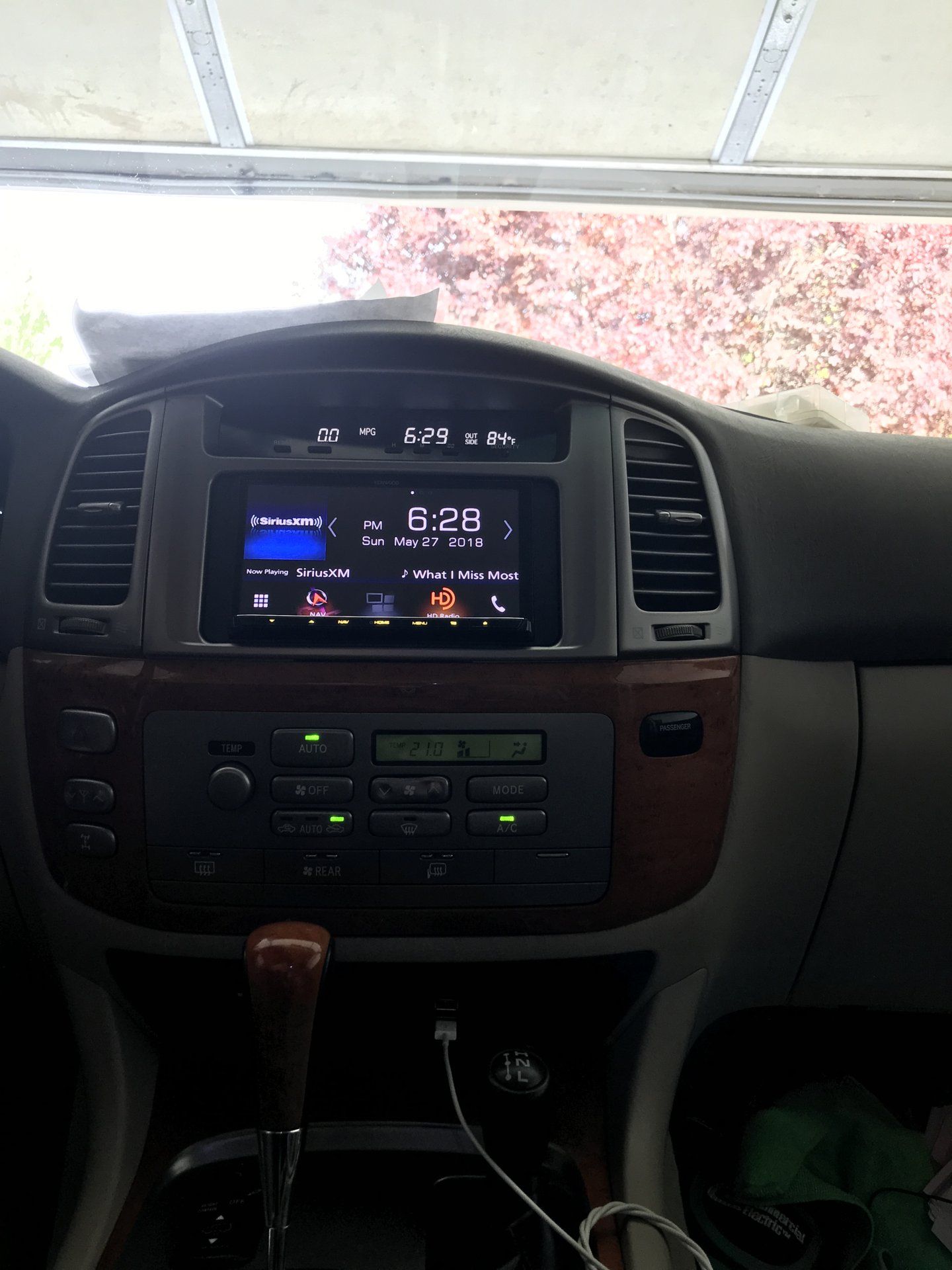

Well it is finally complete!!! Thanks to Jerry I have successfully replaced my Nav/HVAC and using the Non Nav HVAC controls I have an awesome sound system that is updated with Kenwood DNX994S with Garmin Nav. If you go this route you have to be prepared to replace the Mark Levinson amp also. It no worries with the Levinson System. I am also using the factory Rear camera. . I do not have use of the rear factory audio controls in the back seat, but I am OK with that. The only issue I am having now is there is no data going to my OBDII port under the dash. I swear this worked before I started the radio install so maybe it is tied into the NAV Ecu. I am hoping Jerry will be able to help me figure this out. Over $4,500 to get to this point....worth it? I think if I had known it was this much going in I would have probably spent the $$$ on bumpers, but it’s done so I will just have to save for the bumpers.
dup
Beautiful job with the conversion.
I need my OBDII data for my scangauge, so this is a no go for me.
The OBDII port works now. It was just a loose connection behind the dash. It works great now and provides all the data.
