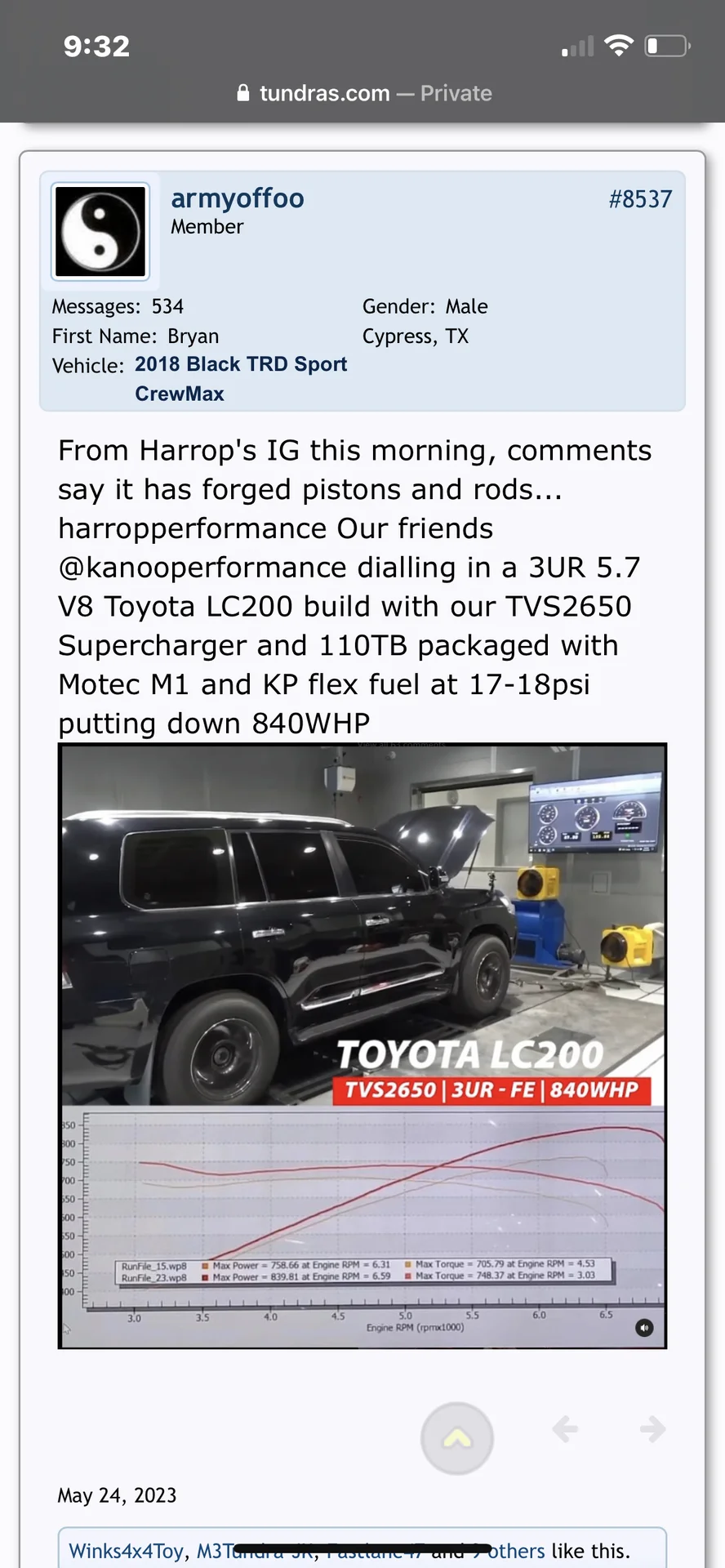

Any updates on this beast? Seems like it could be making ~700 pound-feet at the crank when you factor in AWD drivetrain loss. Harrop had 120HP loss on a hub dyno at stock so I'd imagine measuring at the tire would increase loss similar to a dyno run with larger tires would. Just a guess.

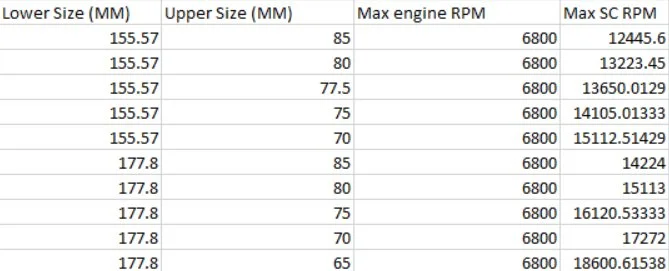

Adding that Harrop now has a 77.5mm pulley available that a few Tundra guys have gotten in the last few days, myself included. If you're feeling froggy! I am going in for a tune and injectors next week starting with my 85mm pulley. I have the 80mm and new 77.5mm pulley, although going in small stages by suggestion of an experienced tuner. This is from Harrop:
"As long as blower speed stays under 18k there is no issues. Unless you are running a larger lower and a 65 upper or revving the engine more than 6800 you won't get outside the warranty rpm."

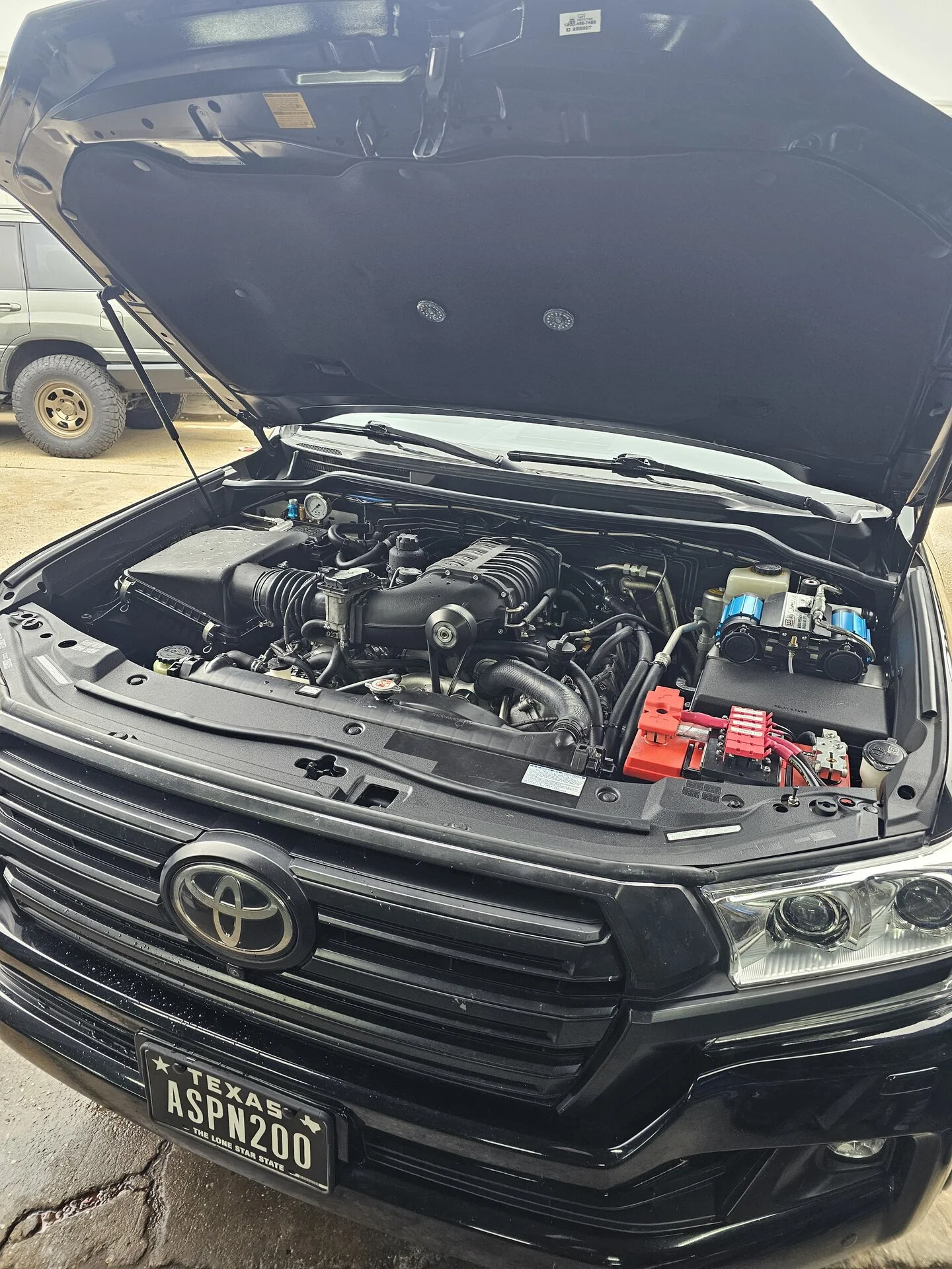

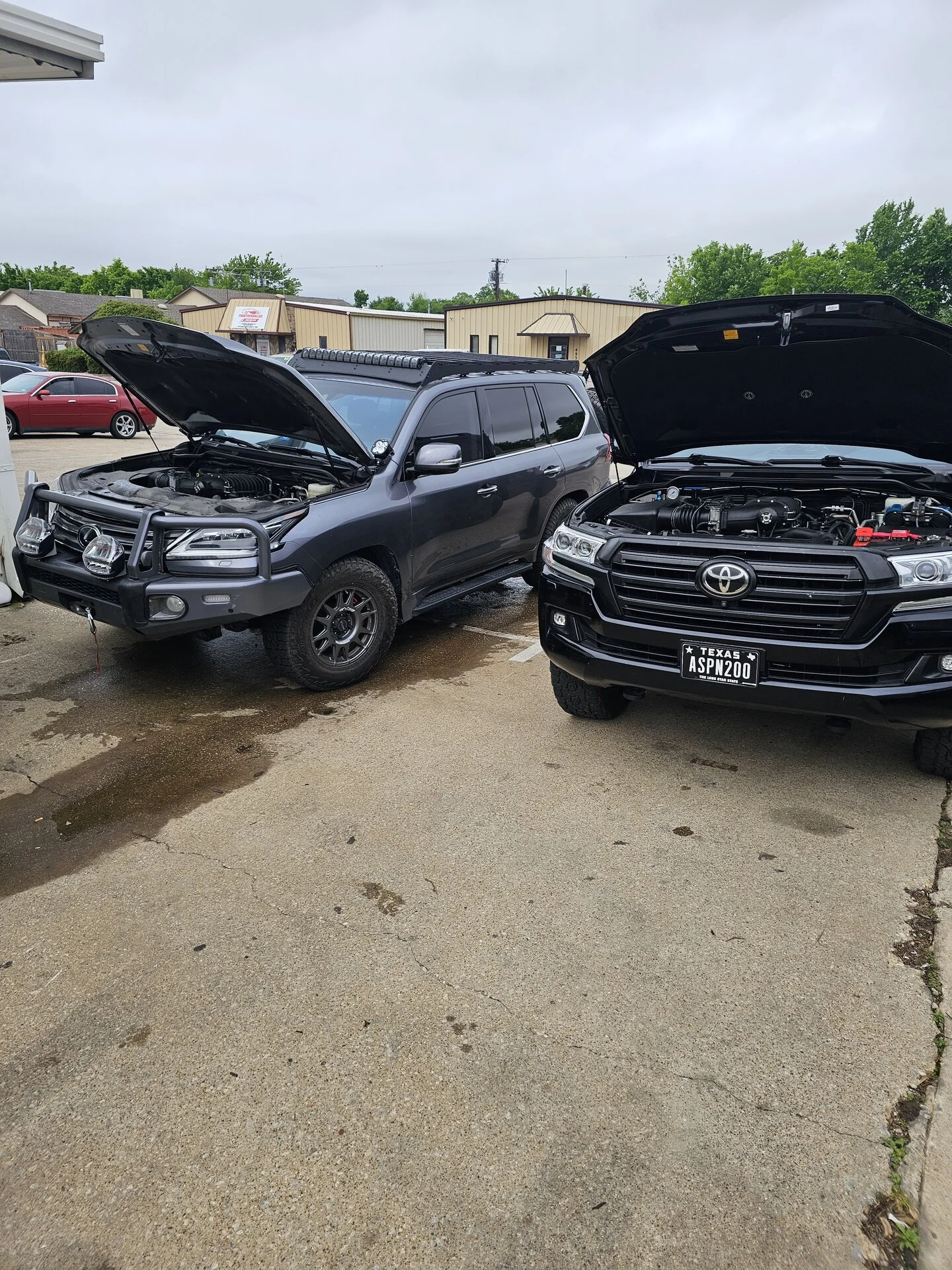

Following up on my post from March 18th. I am in Dallas so going to Prospeed in Houston presented some logistical challenges. I ended up at Goode’s Offroad locally and am beyond impressed! I’m the black one. He had also finished up this LX. There are no identifiers on the LX but if it’s yours and you want me to remove it please let me know. Also if it’s yours, very nice LX!!!
