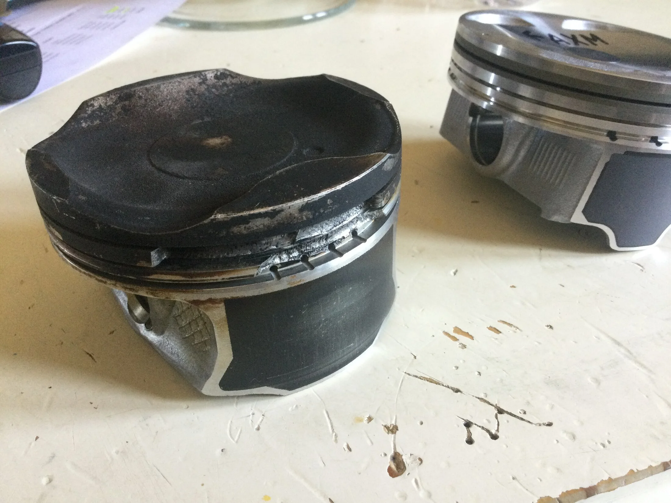

That was a TRD/Magnuson TVS 1900 w/ stock pulley and a bad tune (Bully Dog). 99k on the engine, spotless inside.
Wait so was this an off-the-shelf NA tune or does BullyDog make a supercharger tune?
I know a guy who was the gasoline engine tuner for SCT/Bullydog and he is a very good tuner. He’s independent now but is heavily involved in Ford tuning and is one of the few that really knows what he is doing.
I’m not entirely clear on what BullyDog system it had (Add on? Flash?), but it was supposed to contain a tune specifically for the TRD Supercharger. Which tune and who wrote are also unknown, but I can ask the owner.
