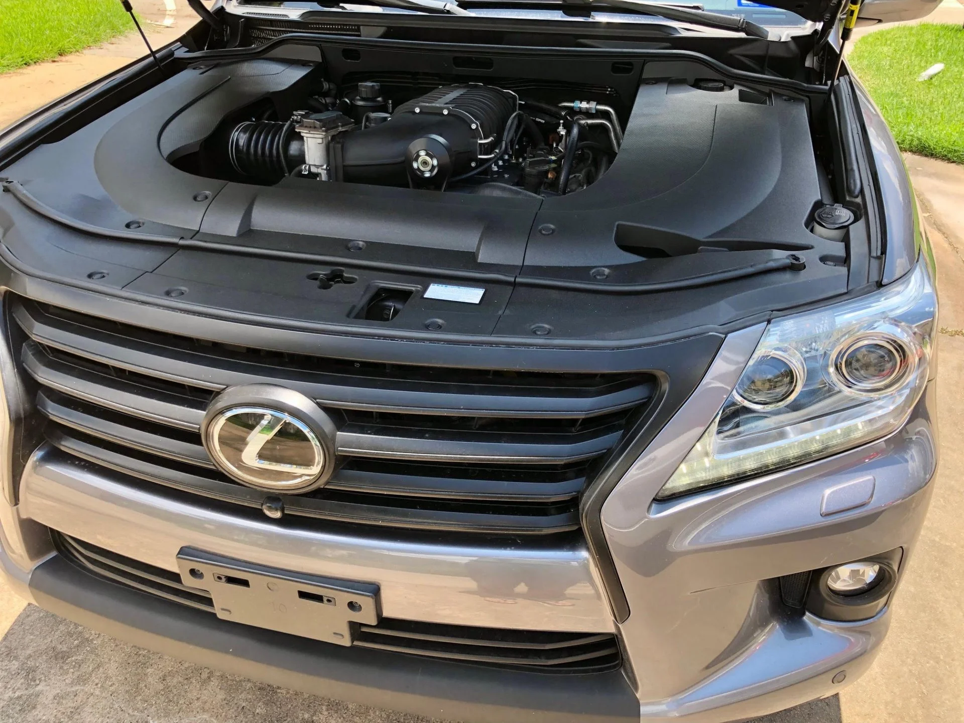

Stage 1 impressions below,
Stage 2 impressions on page 4

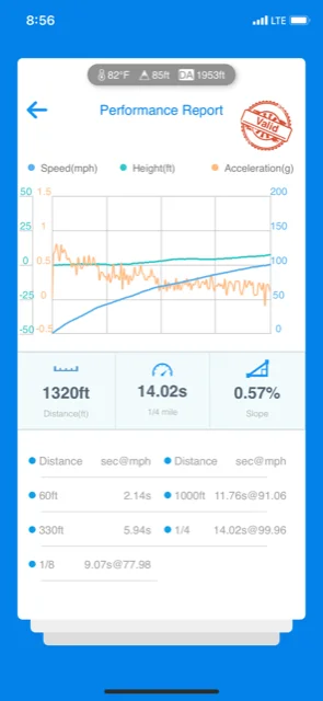

Finally took my Dragy unit along for a ride to measure 0-60mph.
2015 LX 570
Mods: Harrop TVS2650 Supercharger (Stage 1 )
Tires: Yokohama Geolander HT, decent amount of tread, but 5 year old rubber
Traction: off
Drive mode: Automatic D mode, did not manually shift.
Tune: Stock tune.
Gas: 93 Octane, full tank
Curb Weight: 6000lbs
Results:
0-60 5.75 seconds
1/4 mile time in 14.02 seconds.
Recorded video of slightly slower runs but very consistent. Apologies for the blurry cam. For those that don't know, Dragy is known to be pretty reliable in the automotive world for 60ft, 0-60, 1/8th mile and 1/4 mile stats.
Final thoughts: This mod was worth every penny to me. This trucks moves now and I am definitely enjoying the power!
God I want this so badly haha. I could listen to that whine all day. Great work.

No, it's not dangerous at all. Rather, it feels very OEM, as if this were an optional performance package.
