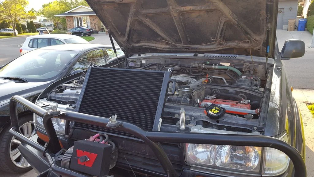

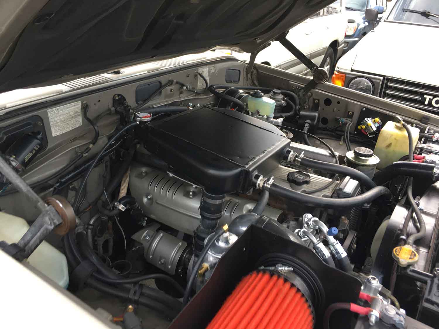

6. Tor informed me that Torfab offers a water to air intercooler setup. It's priced at about $1500 and is supposed to work really well. Has anyone seen or heard of this setup?
I just found this picture online... Has run Torfab's water to air intercooler?

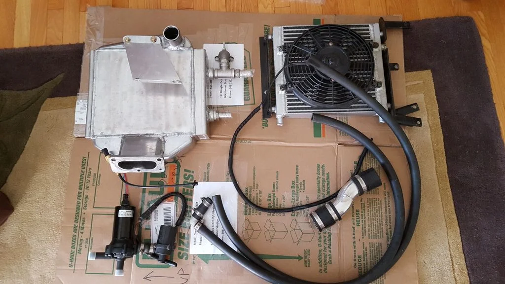

I have that intercooler sitting in my garage. Maybe I'll install it someday.
Don't think it's Torfab's though, they can be found on Ebay.
Wow, I didn't know you could get something like that on ebay. Do you have any more information on what you have? (Is it a full kit with intercooler, radiator, pump and wiring?) Thanks for the heads up!

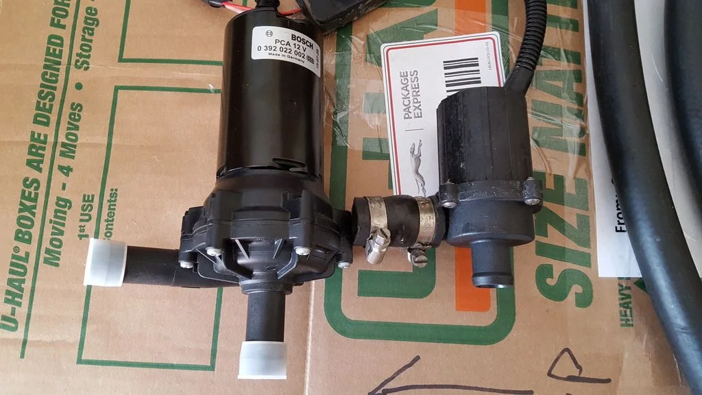

The kit comes with a radiator and pump, though I've sourced different ones as well as upgraded hose and fittings. Bought a rad from a friend of mine who upgraded the one in his mustang and replaced the pump with a Bosch cobra.
Wow, @Douglas S
I googled and found some kits on ebay for about $850 but I was concerned about quality. Would you mind sharing information on which kit you have and what parts you upgraded? (Looks like pump for sure but I'm curious about your hose and fittings upgrades). Also, if you don't mind sharing, what did you pay for everything? Feel free to PM, if you prefer.
