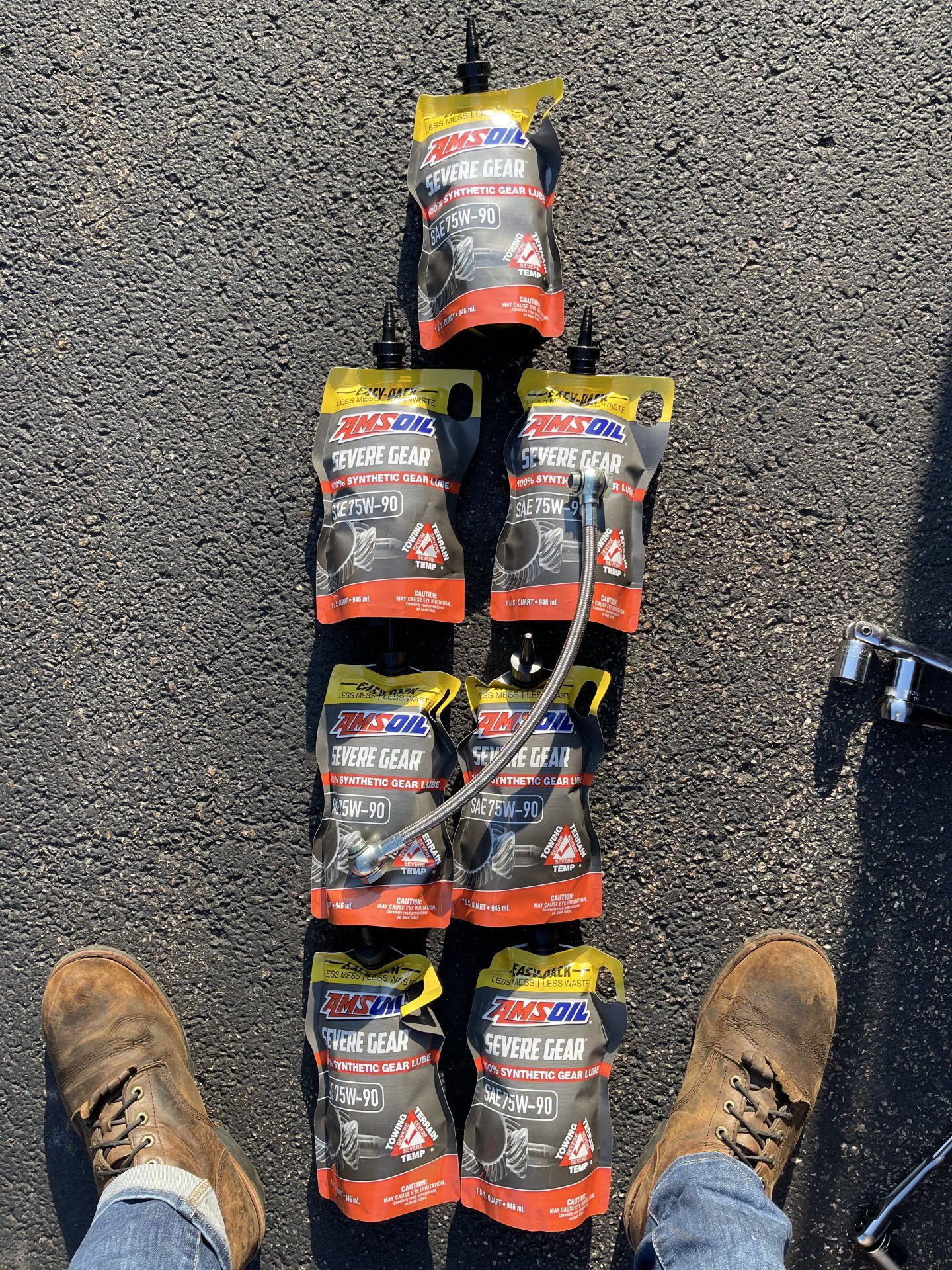

While I was down there I attached @shipmag ’s braided T-case bypass line and flushed the oil. Thankfully there wasn’t much metal on the magnet so small miracles do exist.
Very pleased with the bypass line. For those that don’t know, when the inner seal from the trans to the T case starts to go, oil leaks down into the T case. The bypass sends that oil back into the trans as it runs fill plug to fill plug. This is CHEAP INSURANCE and is very easy to install.
Shout out to Amsoil for making the best oil container I’ve ever used. They’re like giant juice boxes you can squeeze into any tight place. No more stupid bottles or pumps. Highly recommend

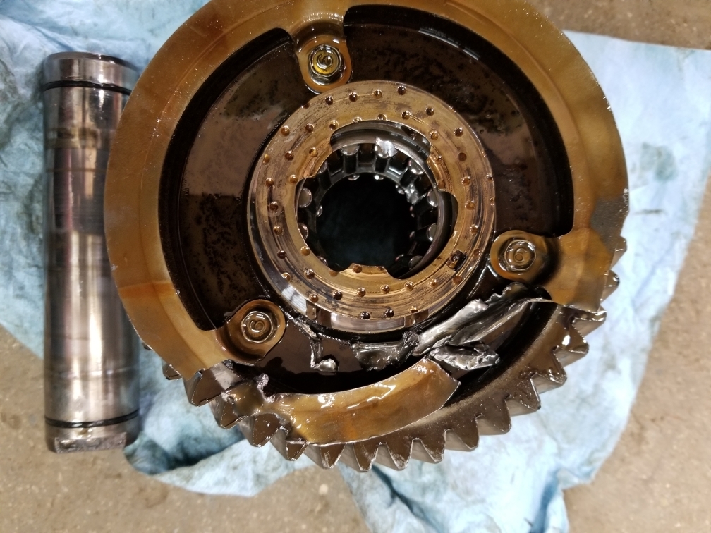

What started with a dyno tune turned into a full blown transfer case rebuild shortly afterwards..everything has since been replaced. Basically was a victim of worn bearings in the case, which caused a gear to kiss my oiler and kaboom 💥

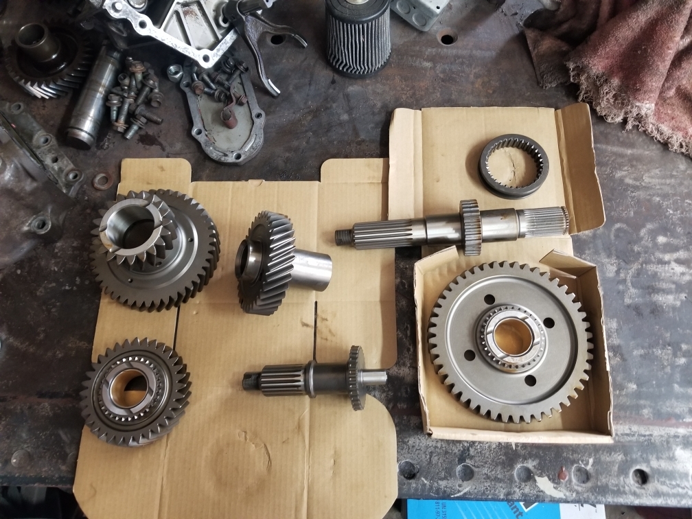

- Completely new transfer case gear set, half shafts bearings etc…the head, the tail, the whole damn fish
- Sumo 3:1 Low Range gears courtesy of Cruiser Outfitters
- Extended Input Gear courtesy of Cruiser Brothers
End result is zero drive line slop and hopefully it’s good for years to come.
the H55/V8 combo with the 3:1’s is gnarlyyyy and very much worth the effort. When replacing all my gears it cost me $75.00 more to make the jump over the standard gears. For those of you on the edge, just do it
one thing I will note is that my OEM Allen drain plug will NOT fit in the transfer case with the bigger gears, it goes too far into the case and kisses the gear. So I’m using the stock plugs instead

Your oil slinger looks chundered.

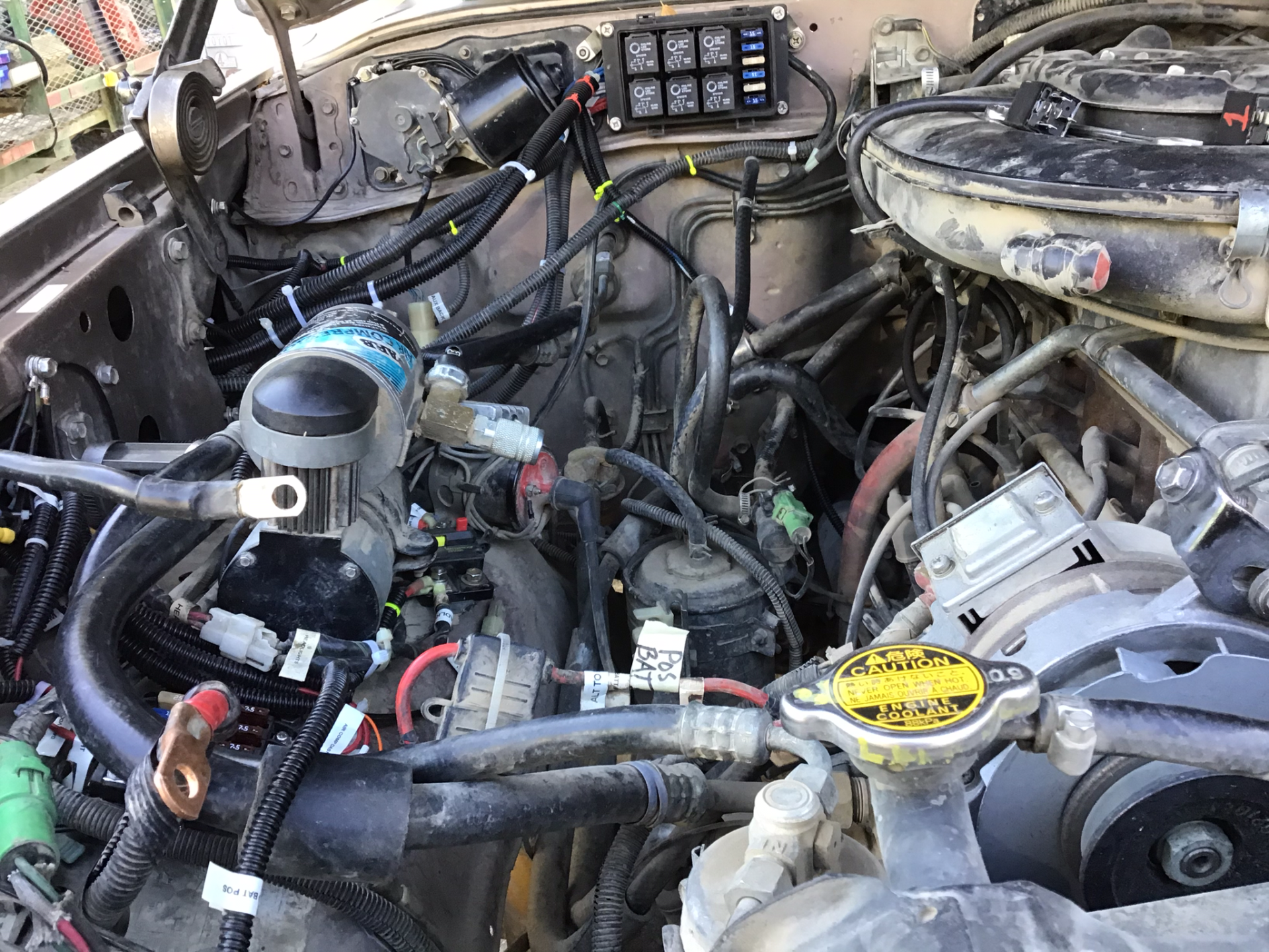

Looking for a way to consolidate my relays, I have maybe 8 of them in the engine bay into a weather sealed box, and curious to see what everyone else is using to keep relays nice and tidy?
@EasternYeti James here is what I did on my 60. Installed a 80 amp aux circuit breaker for my low intensity aux items, and a aux fuse box…and to your point a 6 relay box to house my relays. Installed the box on the firewall next to the wiper motor. Did this almost 4 years ago & so far it has been flawless. Have since added a rear locker & upgraded to a larger ARB compressor. Also installed this same unit on my 40.
I bought a 6 relay box…only currently using 4 relays. As I remember they also have a 8 & 10 relay box. It was a pain to wire up…but actually pretty straightforward. All the involved dash switches go directly to the relay box with the relays wired directly to the battery.
My 4 relays power the following: 1) A switch that powers my Ham, CB & ARB Fridge. 2) My Hella 4K bumper lights. 3) My ARB Compressor & Rear Locker. 4) This goes directly to my OEM Starter Solenoid.
Let me know if you have any questions.
