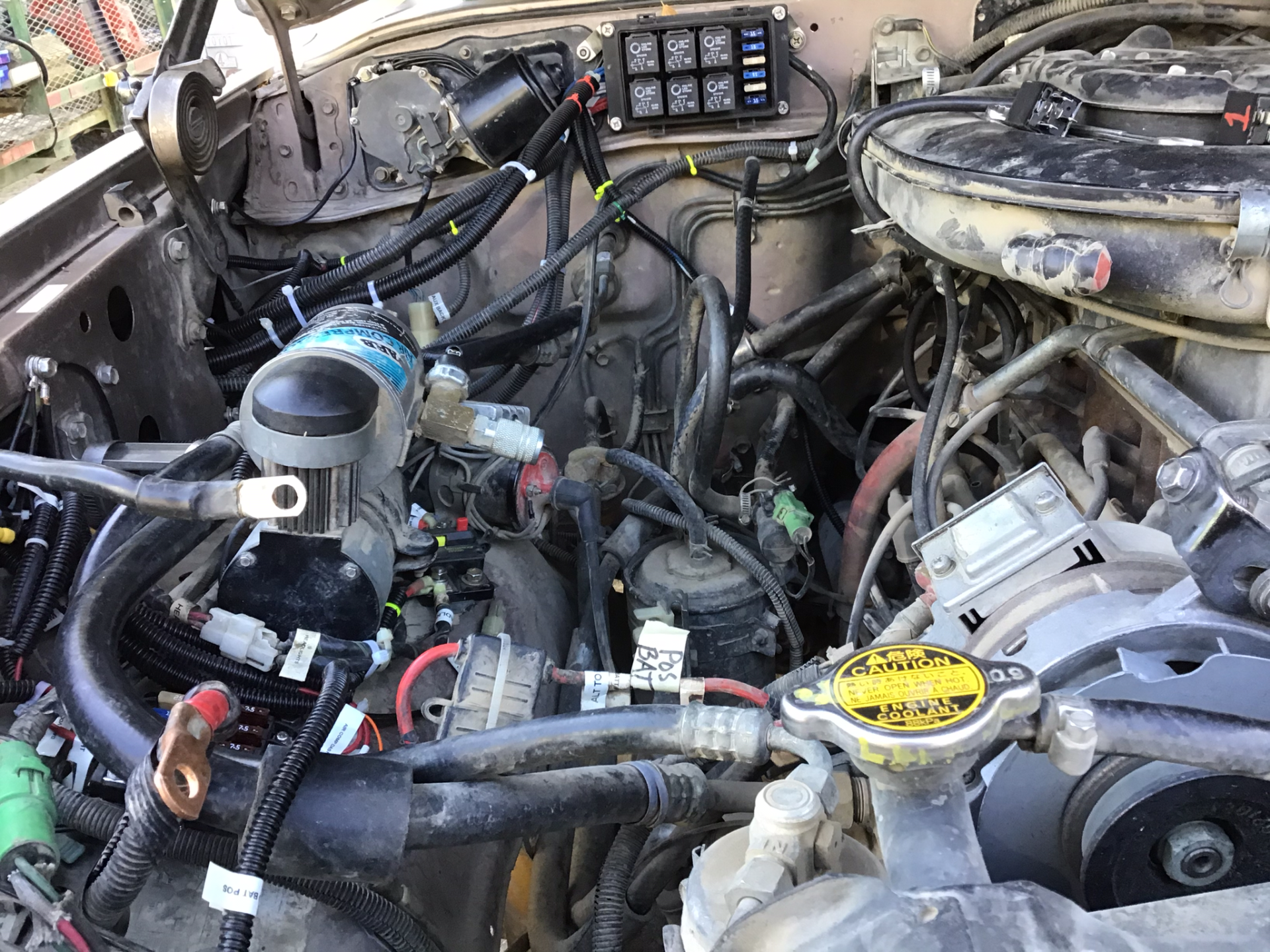

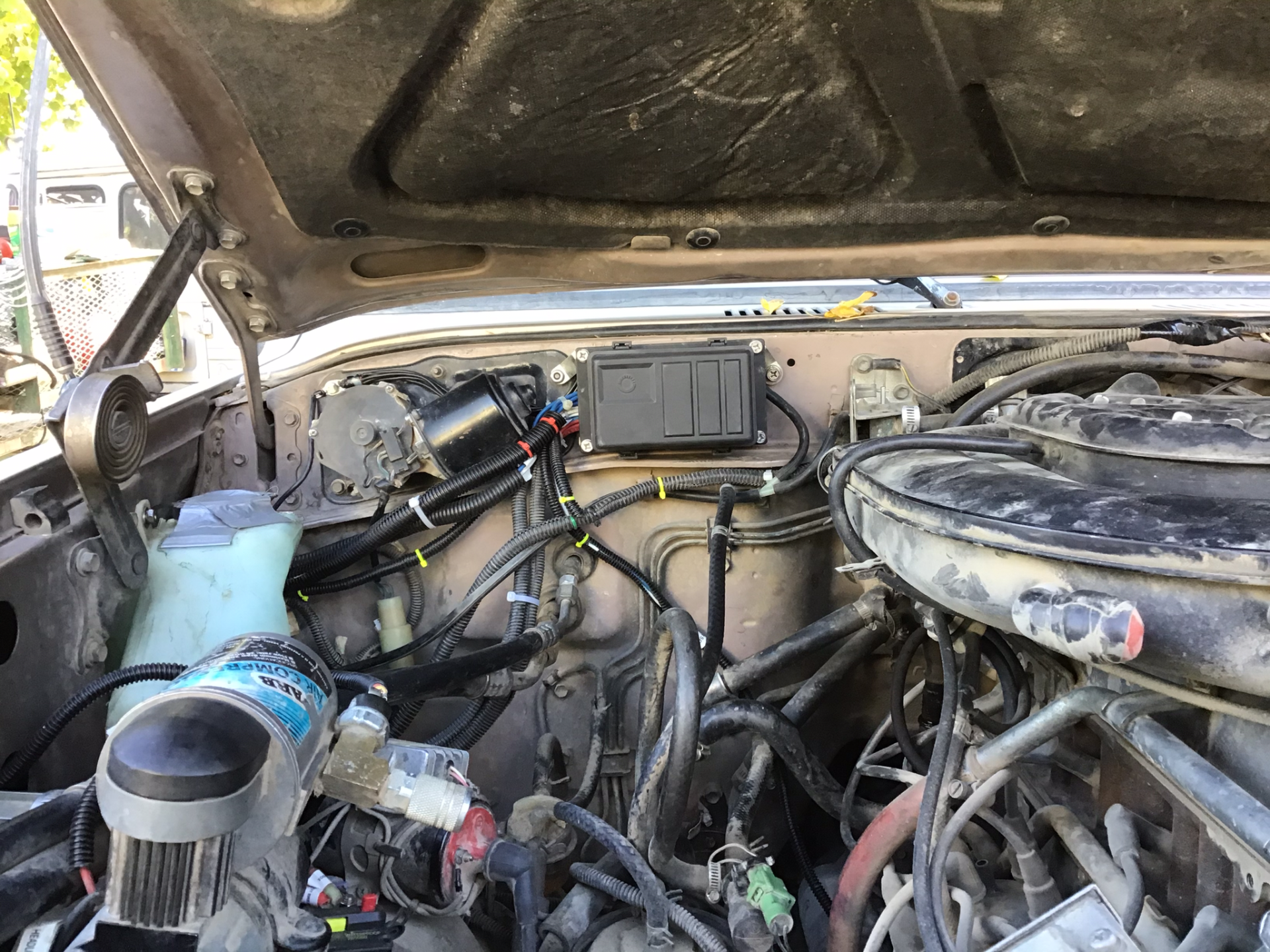

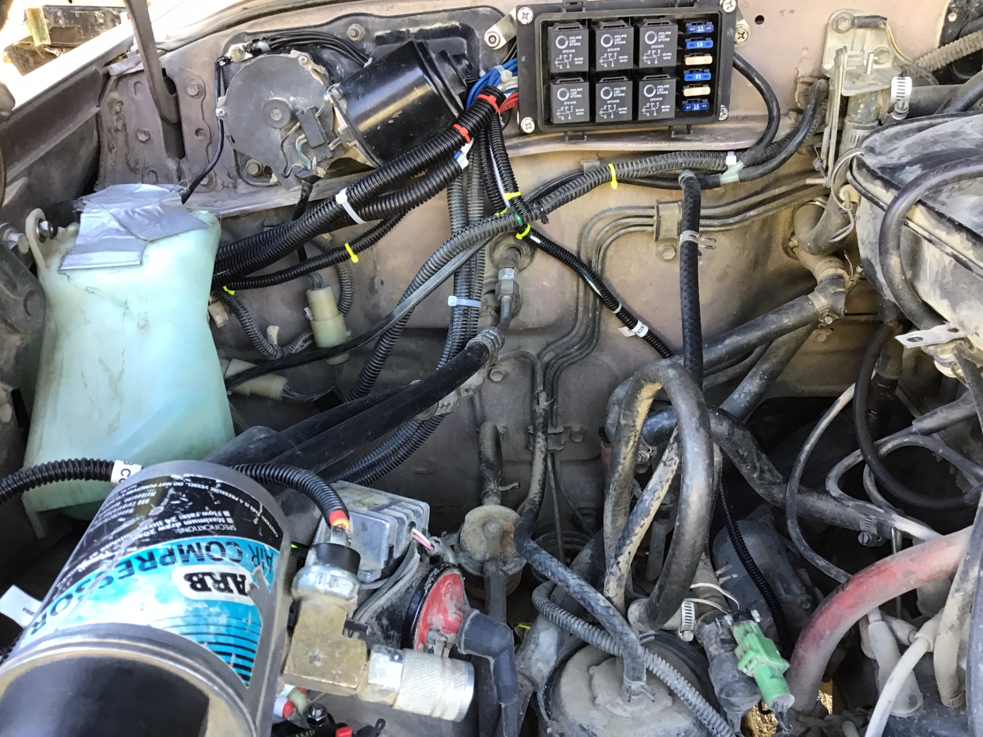

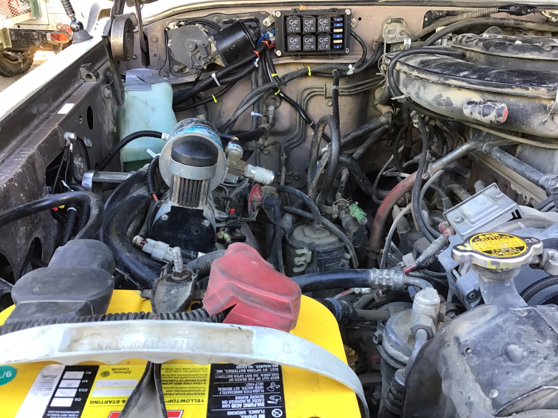

@EasternYeti James here is what I did on my 60. Installed a 80 amp aux circuit breaker for my low intensity aux items, and a aux fuse box…and to your point a 6 relay box to house my relays. Installed the box on the firewall next to the wiper motor. Did this almost 4 years ago & so far it has been flawless. Have since added a rear locker & upgraded to a larger ARB compressor. Also installed this same unit on my 40.

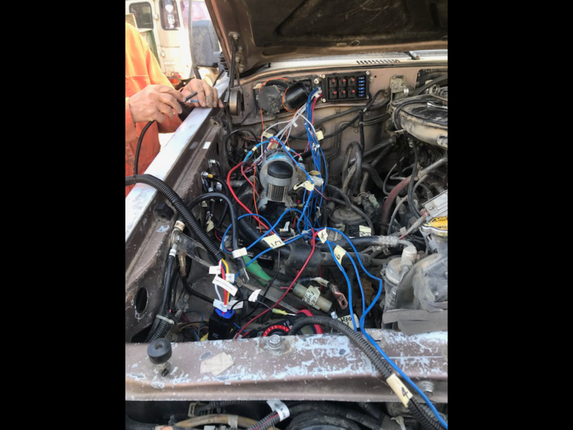

I bought a 6 relay box…only currently using 4 relays. As I remember they also have a 8 & 10 relay box. It was a pain to wire up…but actually pretty straightforward. All the involved dash switches go directly to the relay box with the relays wired directly to the battery.
My 4 relays power the following: 1) A switch that powers my Ham, CB & ARB Fridge. 2) My Hella 4K bumper lights. 3) My ARB Compressor & Rear Locker. 4) This goes directly to my OEM Starter Solenoid.
Let me know if you have any questions.

Running the wires, rerouting what I already had and trying to make it as clean as possible took some time but for me at least, this project was well worth it. Here is another close up shot.
