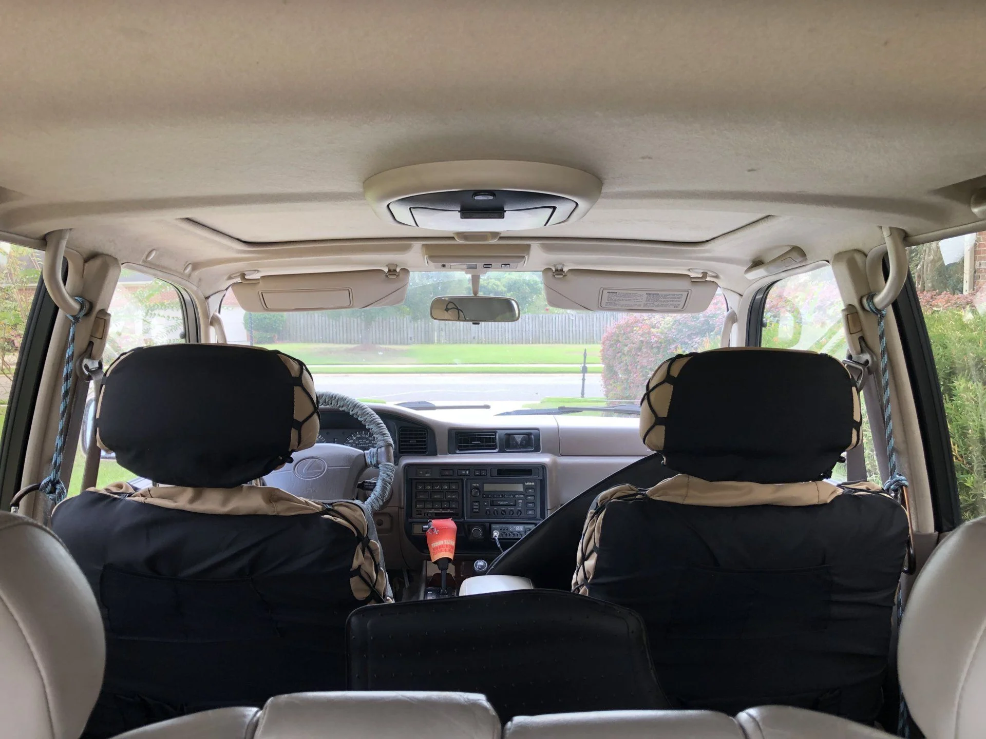

I found these out of a 2003 LS430 at the local junk yard. Bolted up without any mods. I might wire up the mirror light later. The lighter color is not as noticeable in person.

Completed LS400 visors install yesterday. Should have done this years ago. Local U pull had a couple extras.(about to throw them up on classifieds)

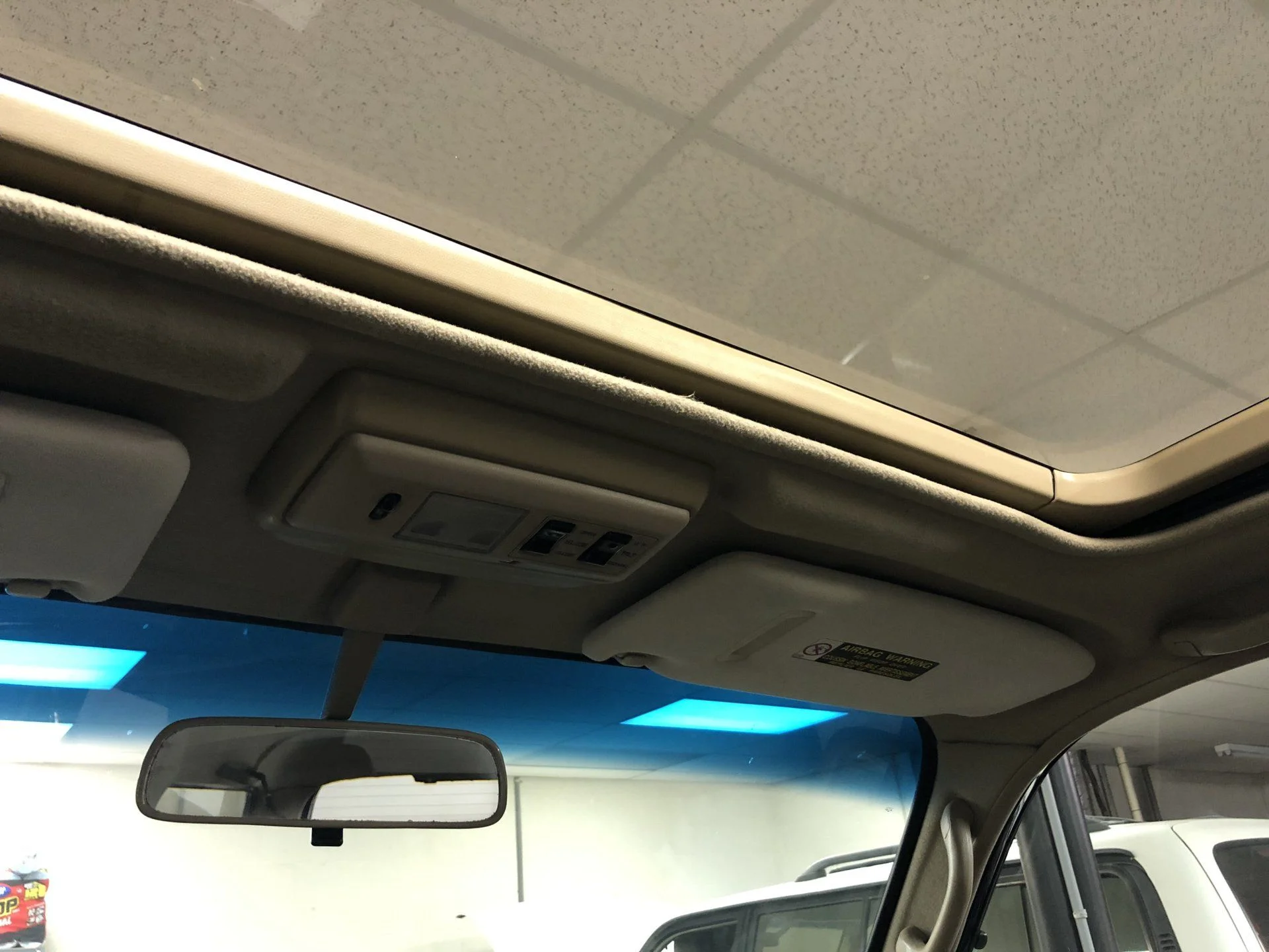

Still need to try and make a 3-D printed new base where the visors attach to. As you may know, the visors will not swing to the side without rubbing.

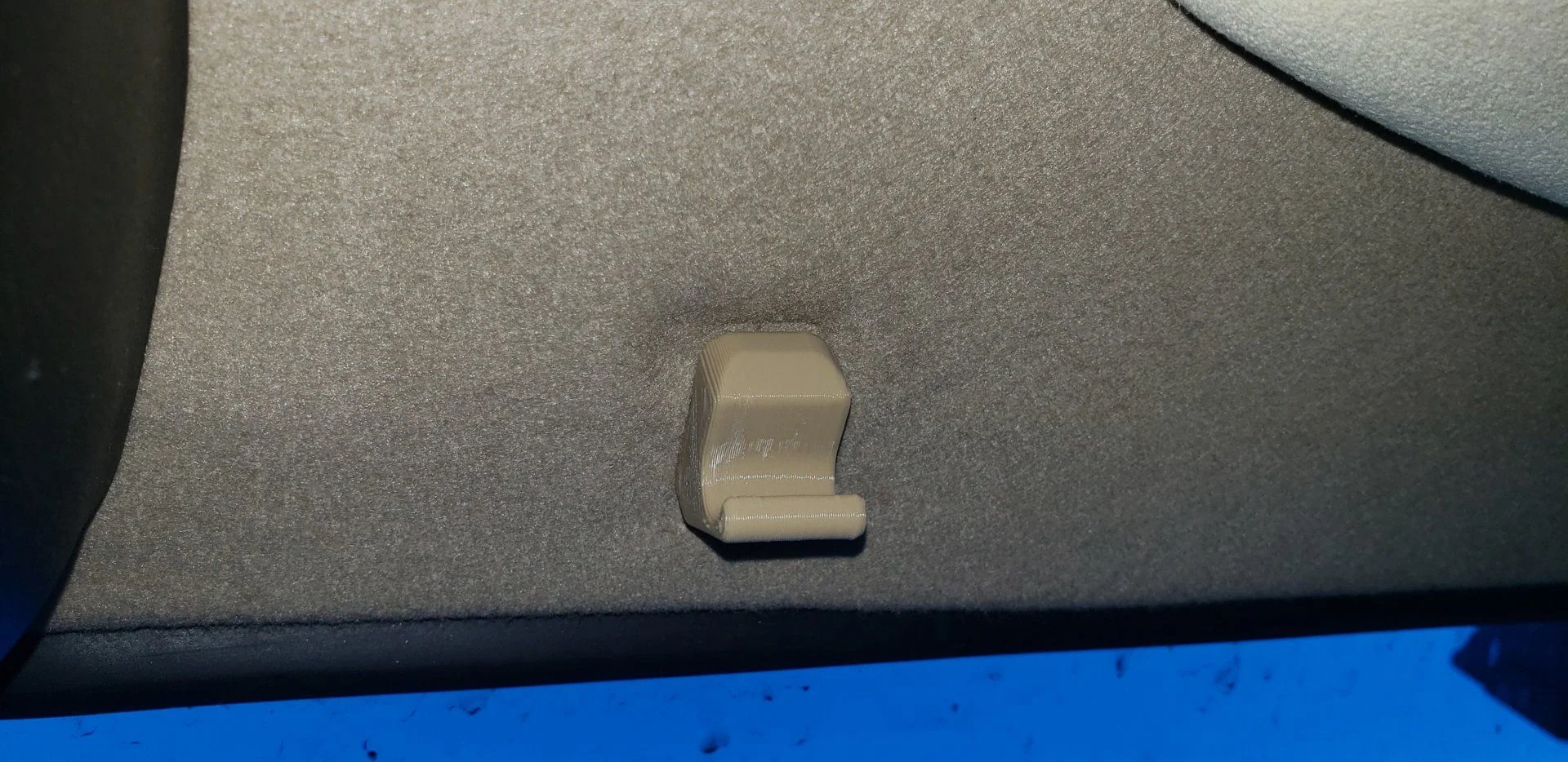

I 3d printed hook brackets, since mine didn't come with them
What did you do in order to have the visors swing to the side without rubbing?
Just one tip for you guys... swap out the mounting bracket from your land cruiser sunvisor onto the LS sunvisor. You have to widen the opening a little bit using a 13/22 and 27/64 drill bit (it needs to be a tapered opening). BE CAREFUL NOT TO DRILL ALL THE WAY AND DAMAGE THE TABS THAT HOLD THE BRACKET ONTO THE SUNVISOR.

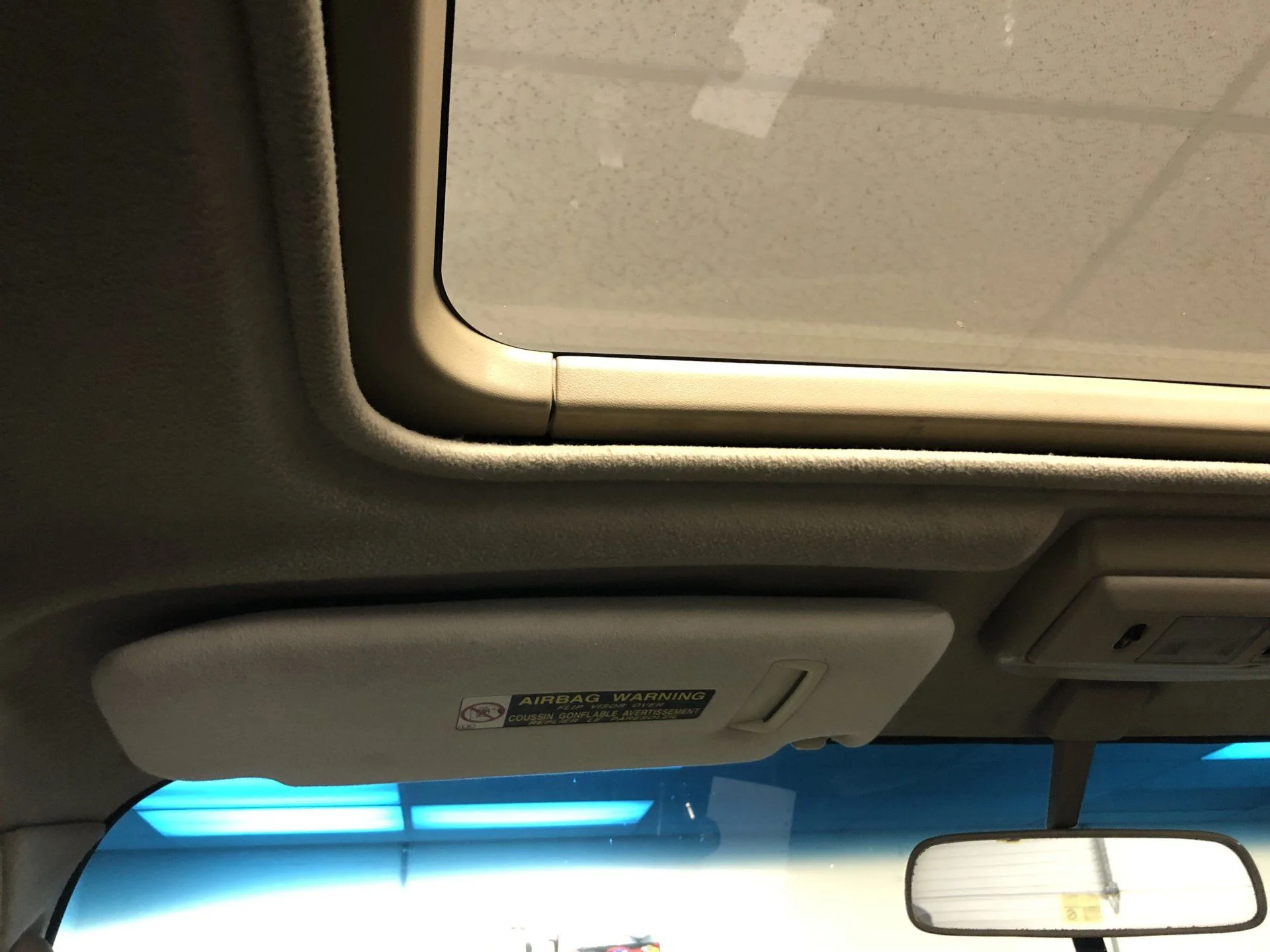

Just did this install. Ordered parts as described above from eBay.
On the LS400 part that holds the visor up, I had to cut a round insert and a square(ish) screw tan off flush. Wasn’t quite sure if this was the correct route but after looking at it for a few minutes, this was the only way it was going to install using the screw from the LX450.
I used 95-00 LS400 visors for this mod on a 97 LX450. I did not connect the wires for the mirror light. This took all of 10 minutes to install and has absolutely cured my saggy visors.

You did the right thing by cutting that one piece off. It's the only way it will work.
I made the spacers that re-angle the visor mounts so they swing out without rubbing and swing closed to the clip properly. Find a place to get them printed and enjoy. They work really well. can i upload .stl's here?
