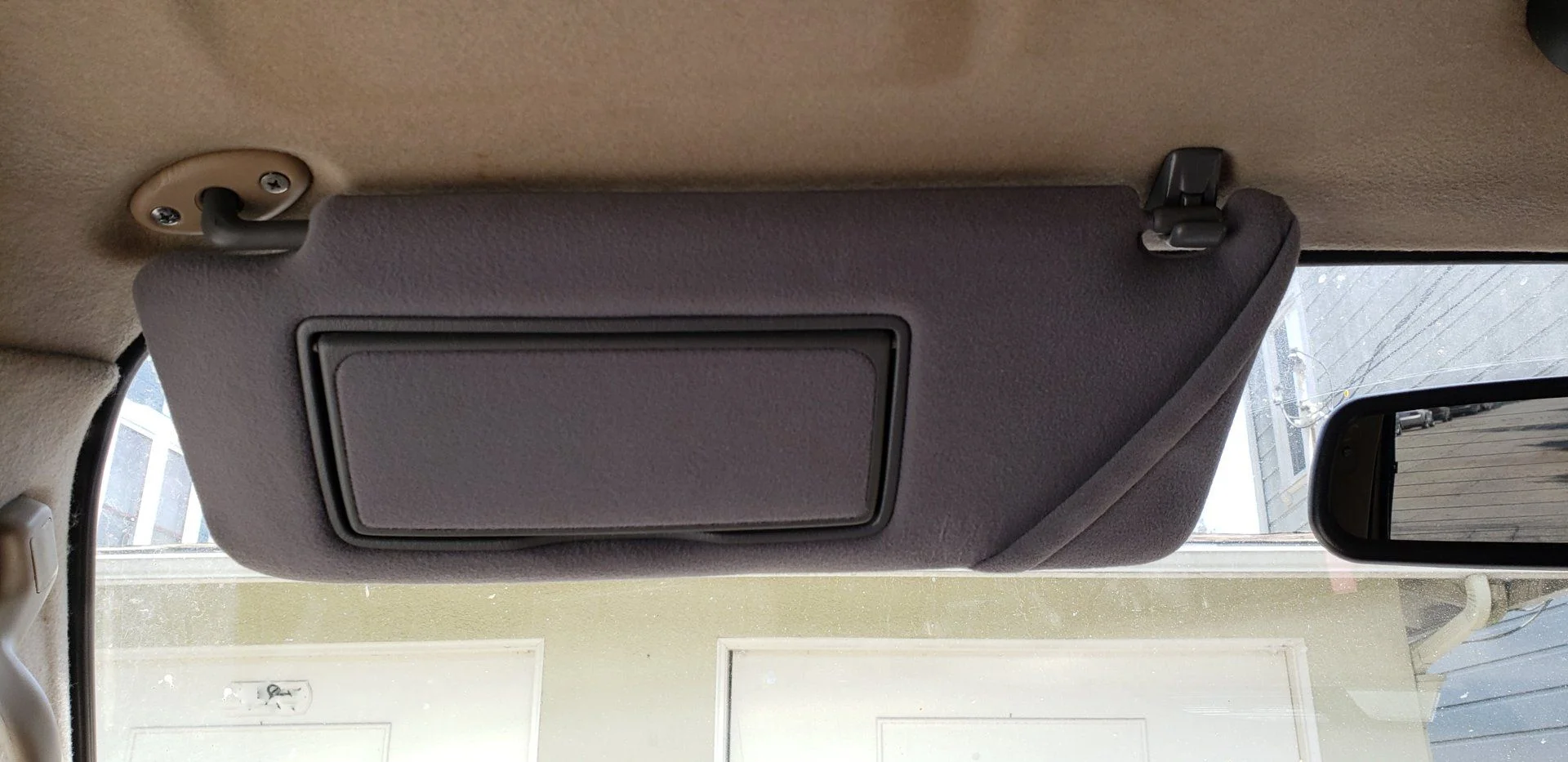

LS400 ---> LX450 Sunvisor mod ! FZJ80 MUST HAVE !
Ha! I threw a 60 visor on our 450 years ago, second time old 60 parts in the garage have been used on the Lexus...maybe I should spend more time in the 80 section...

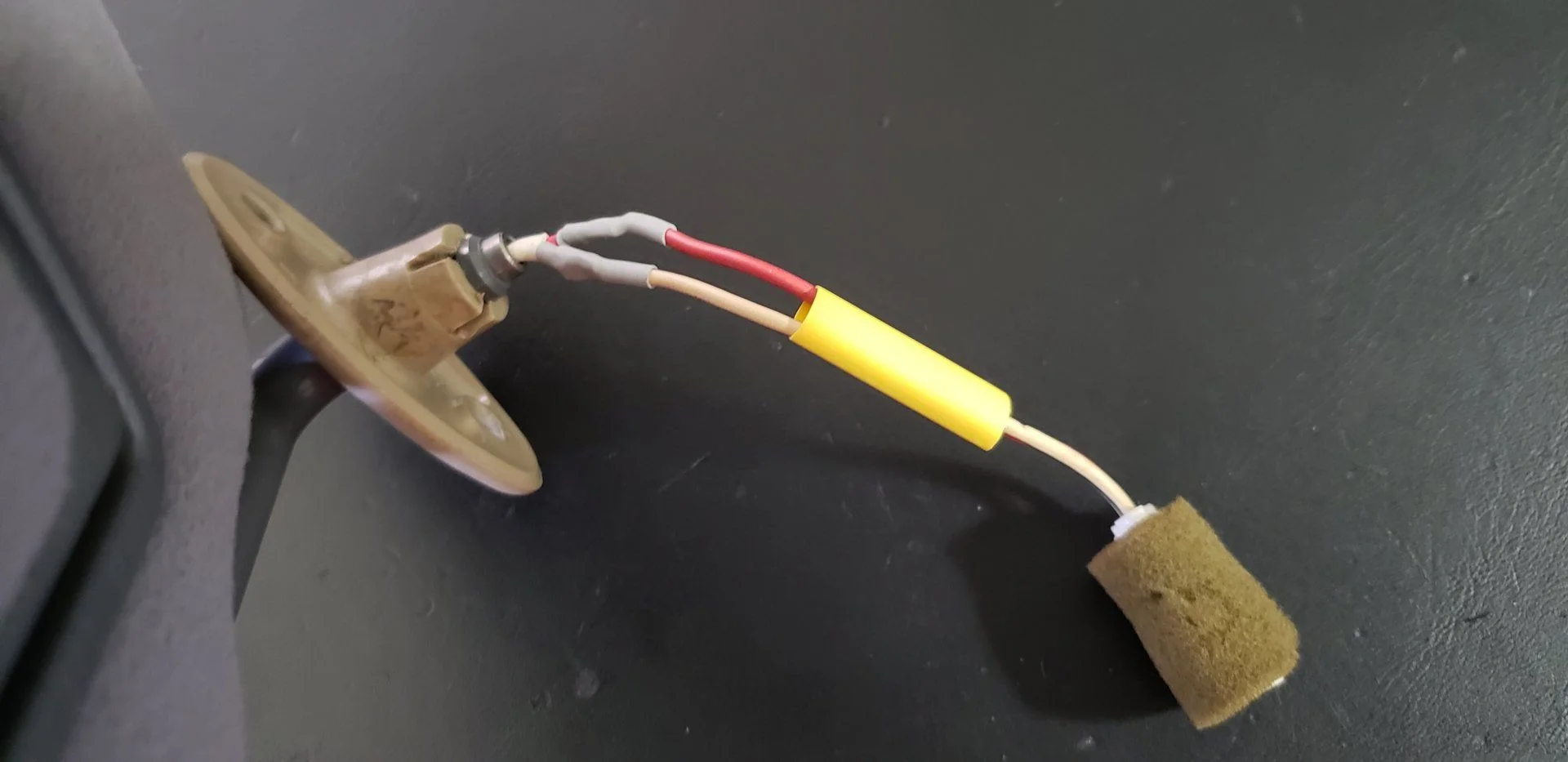

There vinyl an had Toyota part number can't find it there off 80 or 70 fit just right an don't droop. I wouldn't pay 450 lol haha. They source from overseas good luck they don't come wit visor light has a mirror.
Lexus Clip holder Part Number (the one that keeps the sun visor on to the headliner)
74348-50020-A1
(Tan Color)
Same mounting points as the OEM from the 80 is.
Thank you for this mod @40thSagePearl !

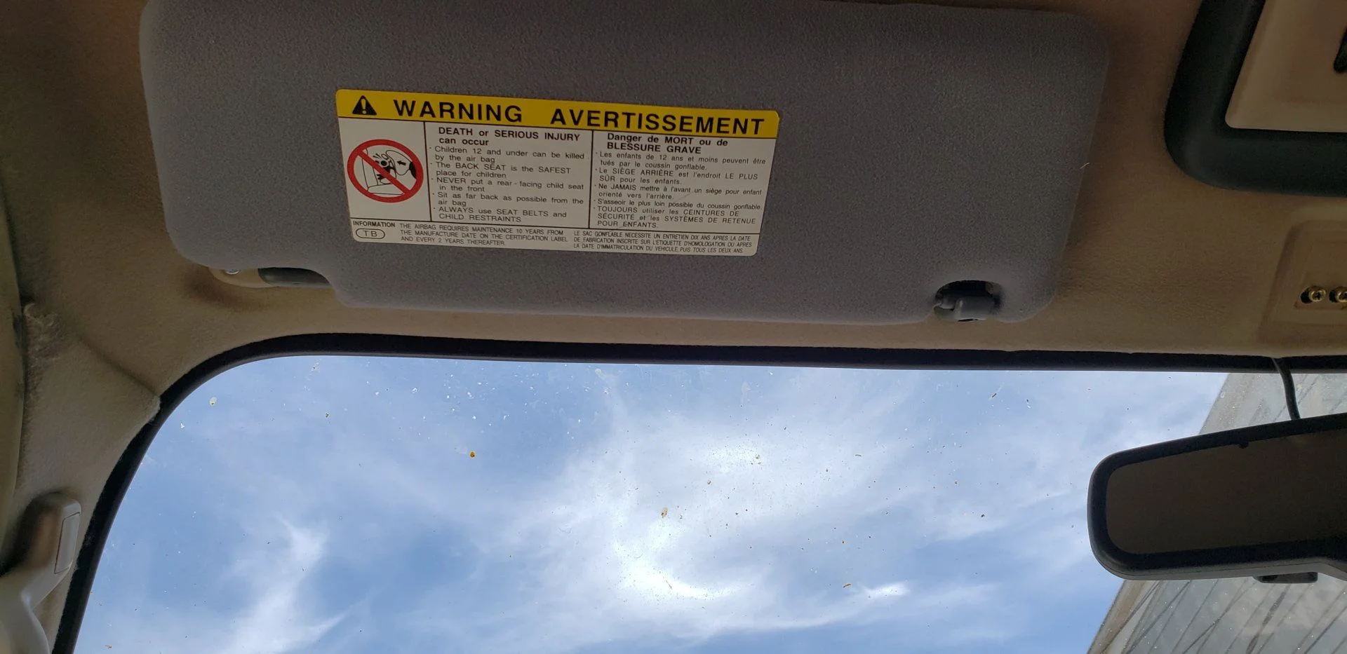

I finally got some LS400 visors from a '97 at a pick and pull yard. They fit great! Although they don't really fold out to the side glass all that great as previously reported in this thread.
Note the the mounting tab screw cover on the left. It just snaps on and dresses up the mount.
FYI - the LS400 clips are the same as the ES300 clips. They both work if you cut off the mounting tabs and reuse your 80's clip screw.
BTW this clears the OEM overhead console and Gentex mirror. (Pics added above)

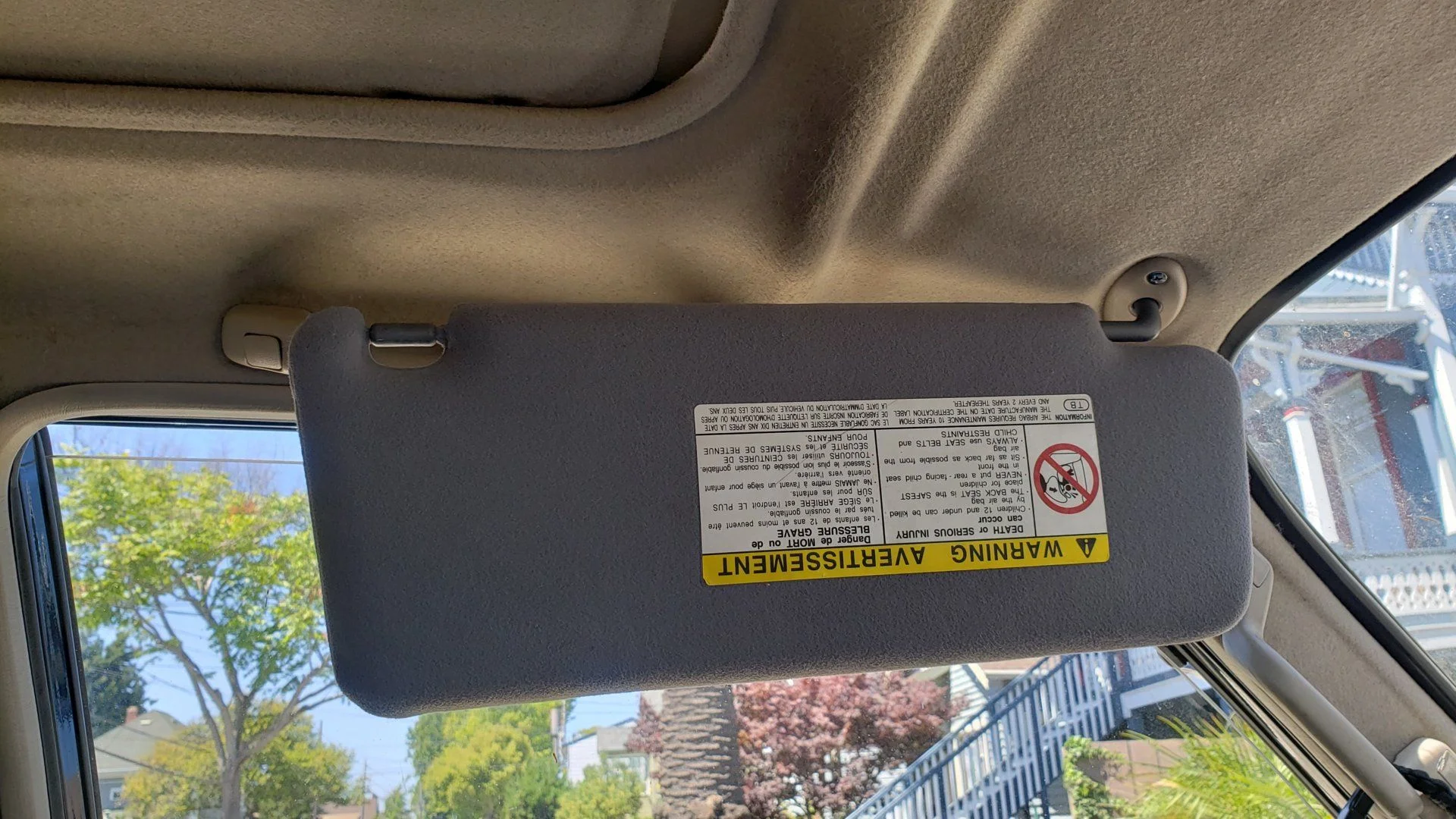

Just one tip for you guys... swap out the mounting bracket from your land cruiser sunvisor onto the LS sunvisor. You have to widen the opening a little bit using a 13/22 and 27/64 drill bit (it needs to be a tapered opening). BE CAREFUL NOT TO DRILL ALL THE WAY AND DAMAGE THE TABS THAT HOLD THE BRACKET ONTO THE SUNVISOR.
Can you elaborate on this and tell if It allows the visor to swing to the side window w/o interference?
Hopefully this answers you question. I just did this last week. I know its gray.. but oh well.

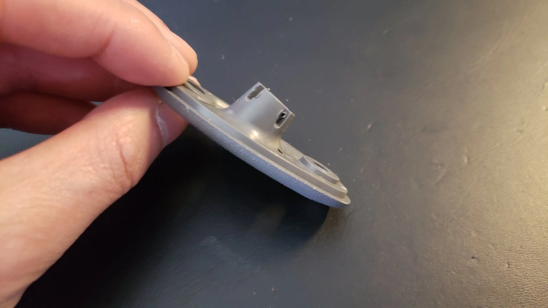

Looking at the Land cruiser holder and the LS400 holder the Land cruiser one has a angle that allows it to swing out without hitting anything.
Here is the LS400 holder/mounting bracket
Can you elaborate on one what needs to be tapered? What part of the "opening" is tapered?
I wonder if someone could 3-D print a base to the LS400 mounting bracket that would give it a little more thickness enough to clear the point where it hits. Think of it as a wheel spacer. Someone like @NLXTACY or @bhicks
