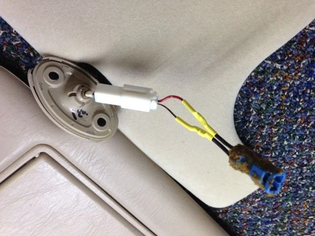

I believe you are reading your meter incorrectly, notice the - sign in the left corner of the meter. This would indicate that the polarity is the reverse of what you wrote.
no the sign is that the meter is powered on haha I reversed poles at first when it showed a negative reading. hard to take a picture with one hand while the others holding a multimeter and trying to touch both pins with enough contact lol .. thus we have a weird angled multimeter haha
Well done! I need this fix, no more bungee cord holding my visor up! You probably thought about his but why can't you just swap the plug from the original visor to the new one and plug it in to the factory harness?
yeah about that ... haha dont ask me how I went through a pair of ls400 visors already trying to do that .. there is next to NO wiring coming out of the ls400 visors.. so that being said, on my first pair I stripped the wires took off the metal pins from the 80 visors swapped em all it was great and even worked ! one of them.. , but boy was it the worst wiring I had ever seen in my life.. copper all exposed and was such a pain in the A$$ !!! .. ended up falling off and i was cursing like a sailor .. lol thats why this time I thought it would be best to just use the metal to metal but i guess it needs a stronger connector than that.

Just did the install and wired it up, lights work! One catch though, visor has to be slid all the way in on the rod for the light to work. Unfortunately, the clip is just a little too far away and the visor has to be slid out a little to clip it. Thus, if you want to use the light, you have to unclip and slide the visor toward the hinge. A little annoying but preferable to saggy visors...to be honest I don't know that I can ever say I have used the light since buying her about a year ago.
This had me scratching my head until I figured it out. Lights work fine on the bench... Install them in the truck, they don't work! WTH! :bang:
I took the easy way out and just used the factory plug off the old visor and attached it to the LS visor. Thanks again to the OP for sourcing this swap!
WTF ! Why didnt i think of this!? Lucky your LS visors seem to have came with the roof mounting plugs from the LS also... im jealous lol leme ask you this though, if we ditch plugs all together and simply attach wire to wire, think it'd work ?
Electrically, wire to wire will work fine. Functionally, it is nice to have a plug in the circuit so if you want to pull the visor out for some reason in the future you are not cutting wires. I wanted to have the truck side stay stock so I could go back to the stock visor if these didn't pan out for some reason.
Additionally, in this application (an incandescent bulb) the polarity is not critical on the visor side. An simple incandescent bulb could care less which side is ground. If you switch to an LED bulb then it is important to wire it up with the polarities correct.
I agree 100%.. will have to see how i can work with mine not having that roof plug pigtail from the LS aswell..
