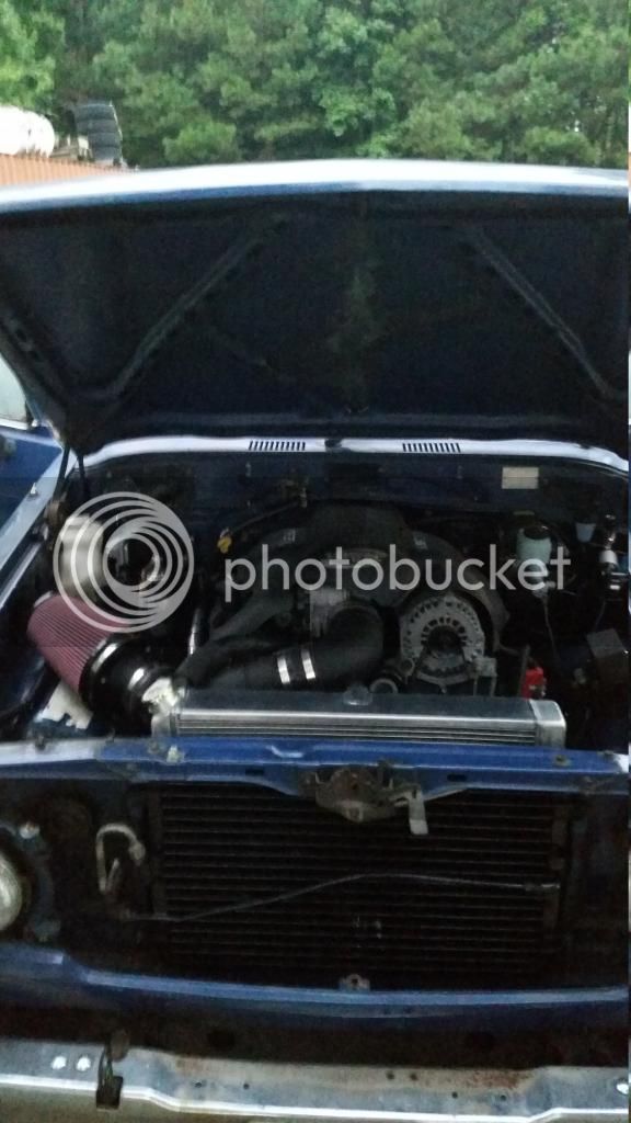

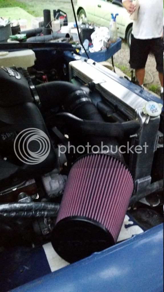

Been making progress....ran into a problem....the engine doesn't fit....can't close the hood with the valance on top of the intake...removed it and the hood closes fine....Here's the pix.....Let her rip!!!!!
First look at the new ride height.......
Did some massaging to the heater core hoses and valve....
Coming back together....
Let her rip.........

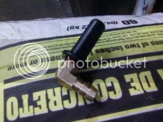

No idea on the roof rails, they were on it when I got it and I thought they were stock, been making some progress....mounted the oil cooler, got the vaccuum adapter fitted and installed and fabbed radiator mounts....still need to make the mounts for the electric fan but it is progressing again.....now for the pics....
Vacuum Adapter
