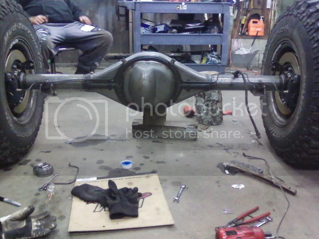

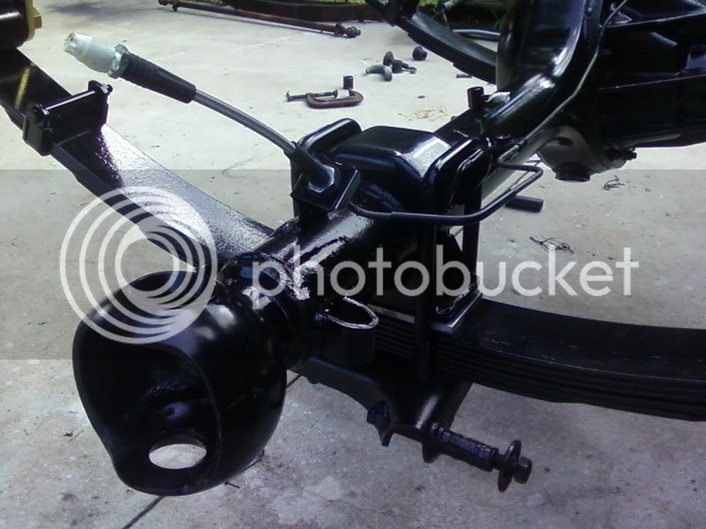

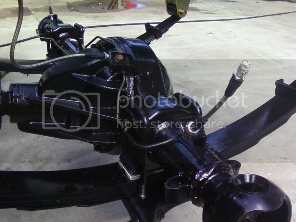

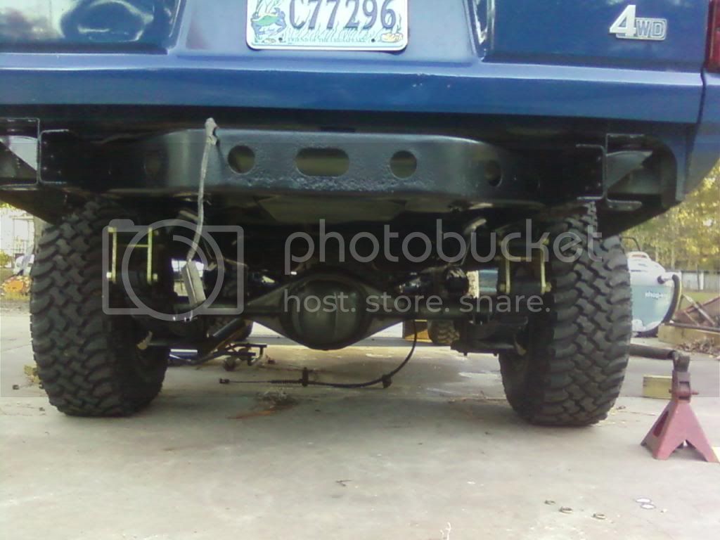

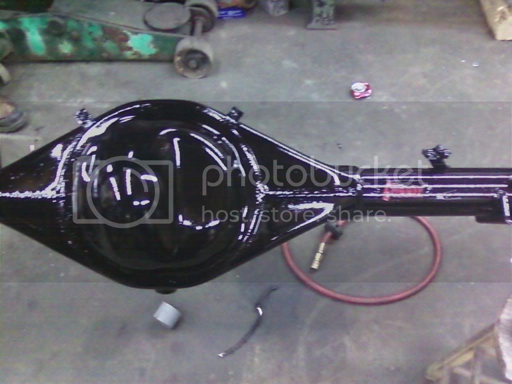

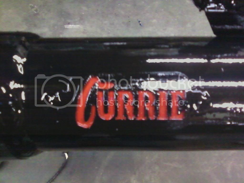

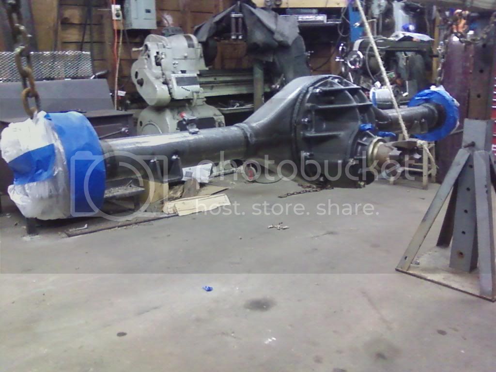

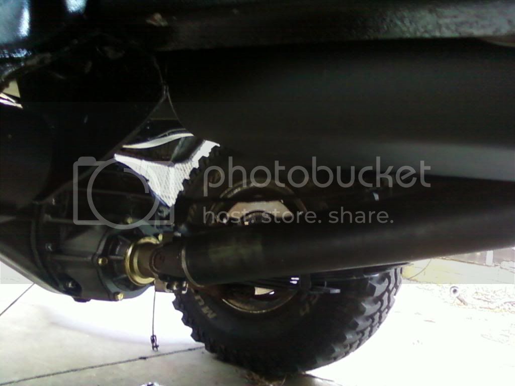

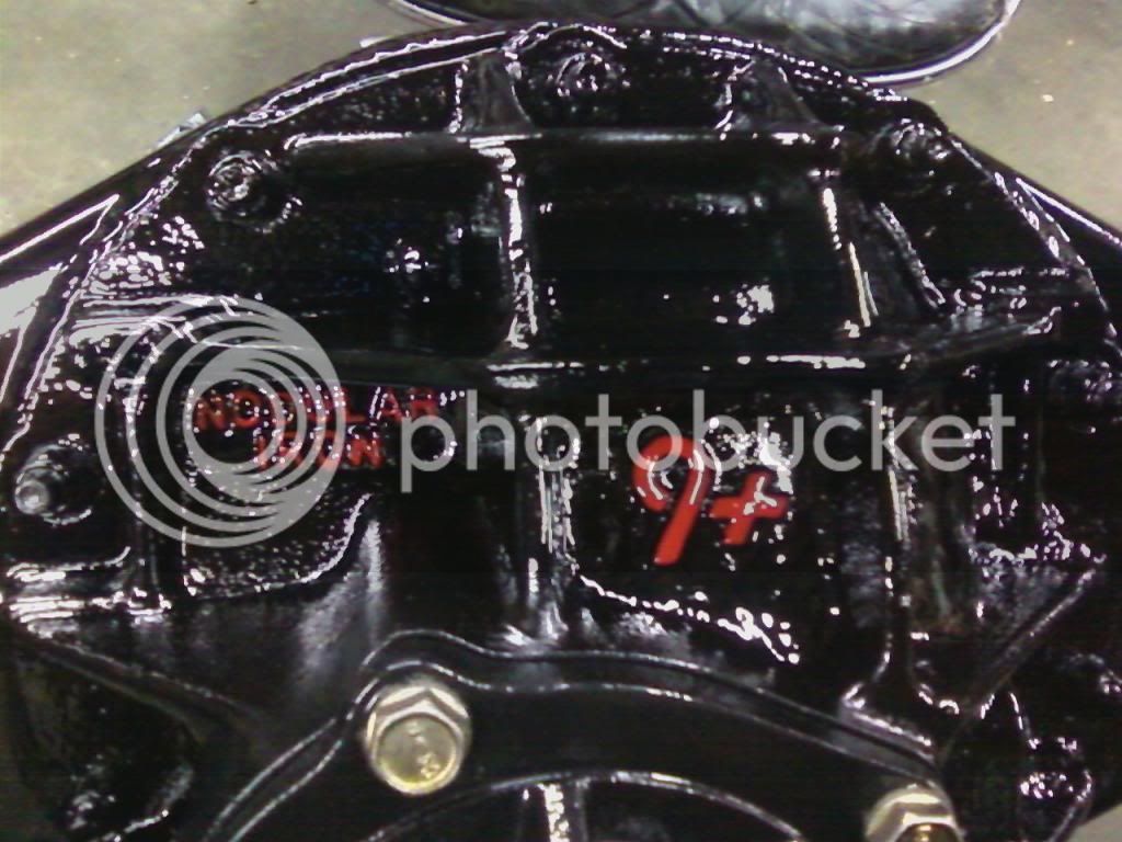

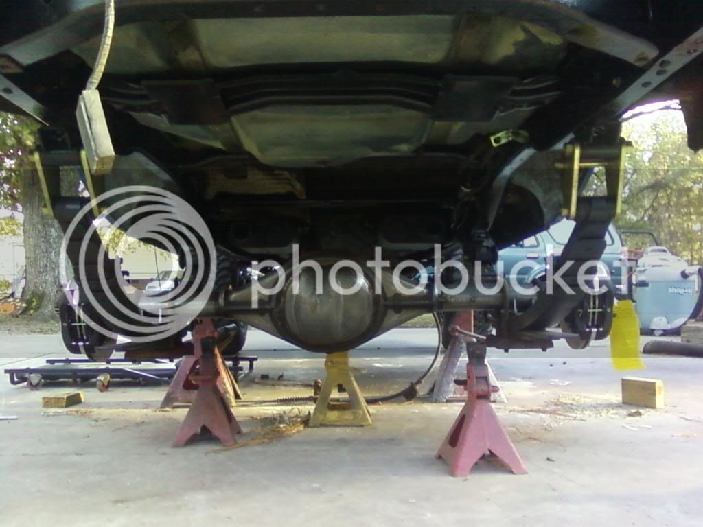

Ok so here is some ketchup pictures, since the forum has been refreshed I figured the least I could do would be to update this thread...been taking care of the little details that will bring it all together, should get the front clip back on shortly and then you know what happens....here's some pix
Rear end fitting....
Running Hard Lines....
Prepped for paint....

Pinion Angle.....

Currie...
Painted....
ok...don't just show us pics of a currie 9inch ford setup.... you gotta expand on that in "words"...details...:)
Solid choice on the rear axle.
Currie 9" heavy duty housing, arb air locker, 35 spline axles, disc brakes, 1350 U-joint, 6 lug axles...
on the currie setup.. is that a bolt in solution from them? same configuration as the FJ60 rear in regard to axles..spring mounts..etc? Liiking the rear disks and air locker what you going to do for the parking brake?
