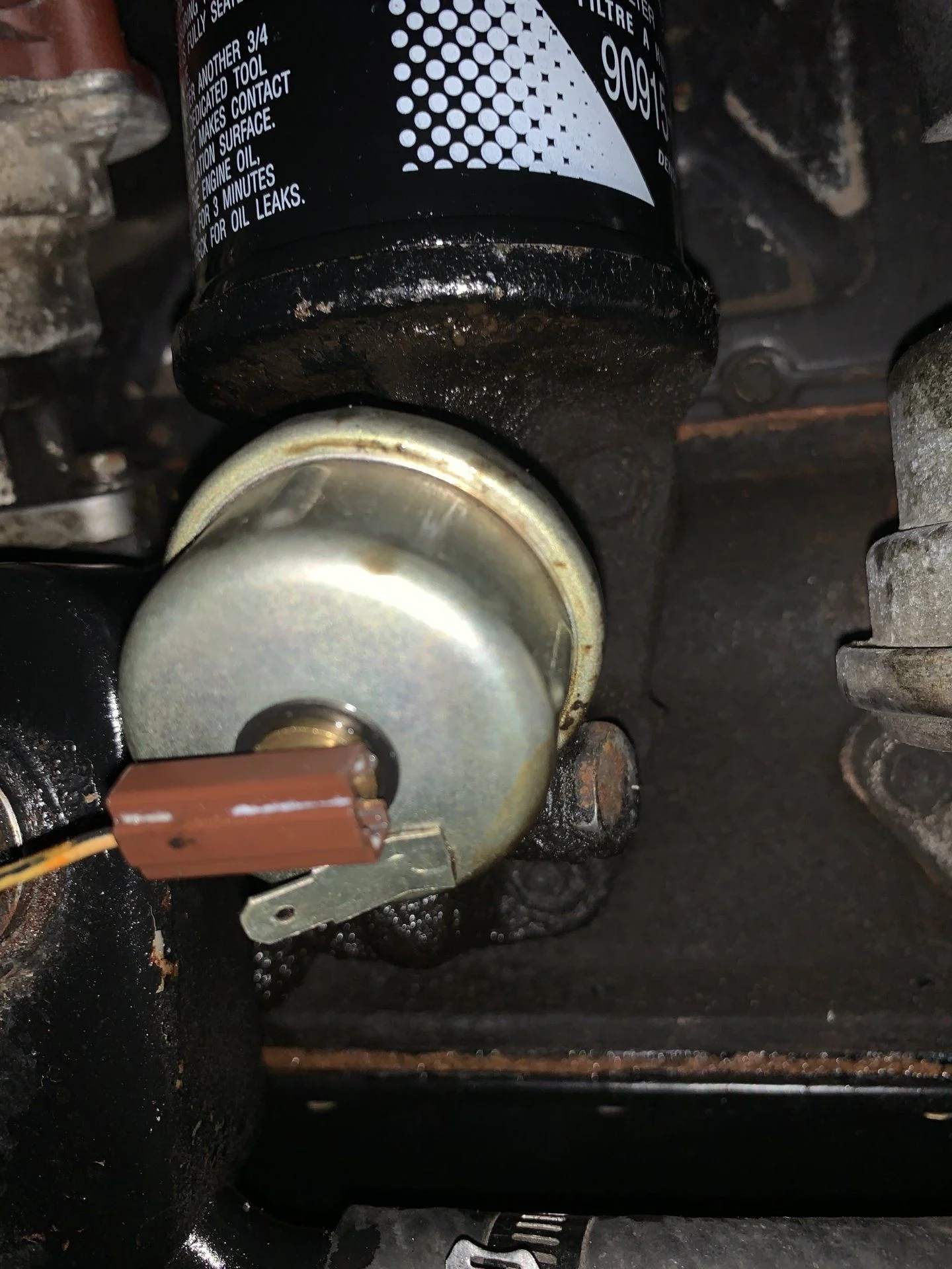

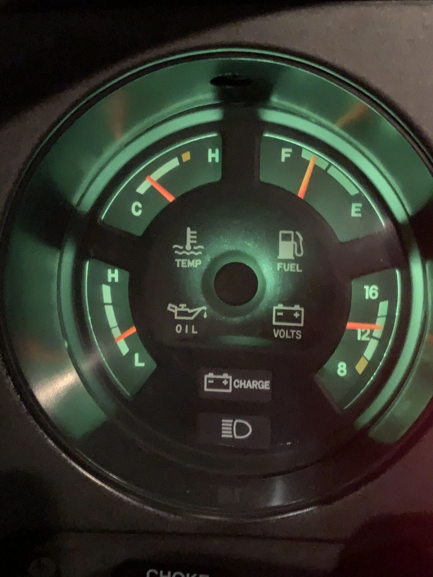

Thought I’d try the Mobil 1 15w50 Synthetic from a couple threads here, oil pressure gauge reads low after ten minutes of idling. Any ideas? I cleaned out the connector on the sending unit, took the new yzdd3 oil filter off to verify it has oil...the gauge usually hangs out at the 2/3 mark with 15w40 and 10w30 regular dino oil that I’ve run previously.

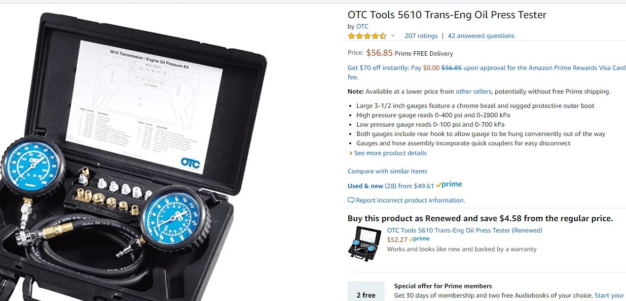

edit: consider picking up an oil pressure gage and reading the pressure at the engine....this way you can rule out the factory gage and get some real readings. I got an OTC pressure kit off of amazon that works well enough.

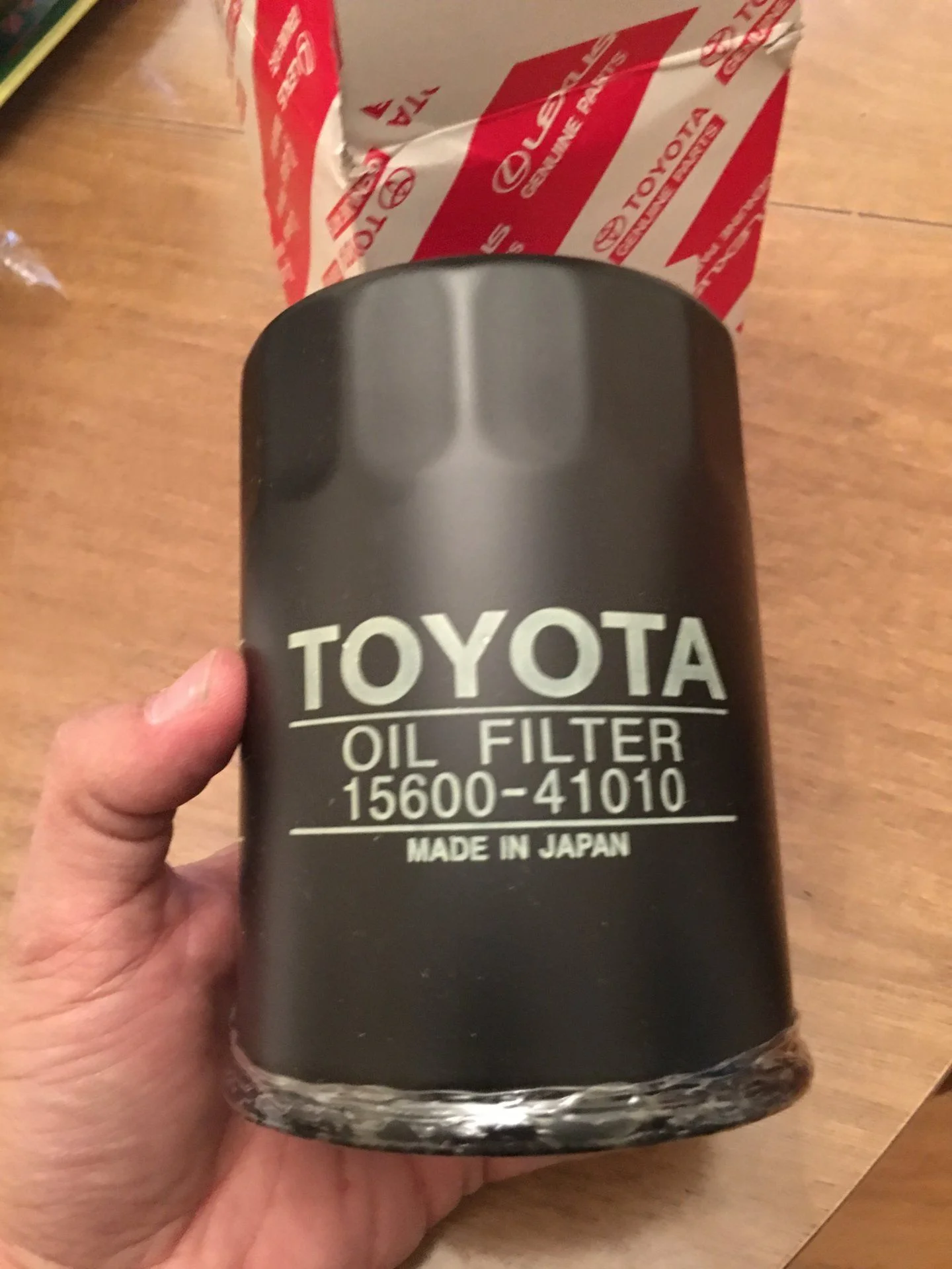

Thanks for the replies everyone. I swapped on my old Toyota filter and same result, pressure is still low. I’ll grab some Rotella which I normally run and swap it out this afternoon.
Just to verify, the connector clips on the middle of the sender, right?
