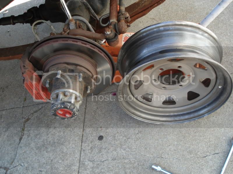

Ever since I added rear disks, I have never felt comfortable with amt of exposed threads...
searched around for replacements, and read about fj60 studs.
I found these replacement studs a while ago, and finally got them installed :)
morosso 46220 1/2"-20 wheel studs are 3" long...here you can get an idea of how they compare to stock 40 studs.
shoulder length is longer, but the knurl is the same as stock.
since I'm running rear disk brakes, taller shoulder is not an issue.
here they are installed
morroso studs are SAE, so make sure to pickup some new lug-nuts :)

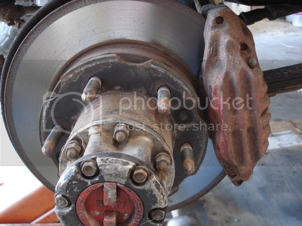

those taller stockers are fine...just wished they were another 1/4" taller.
take a look at my current front studs, I believe they are the longest 12mm stockers available:

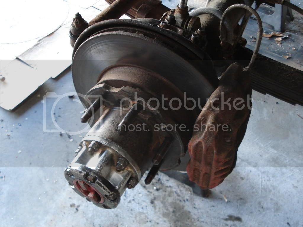

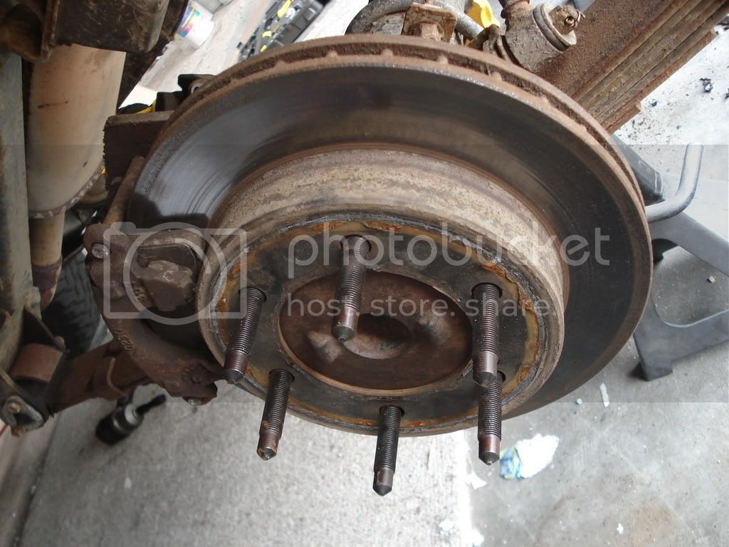

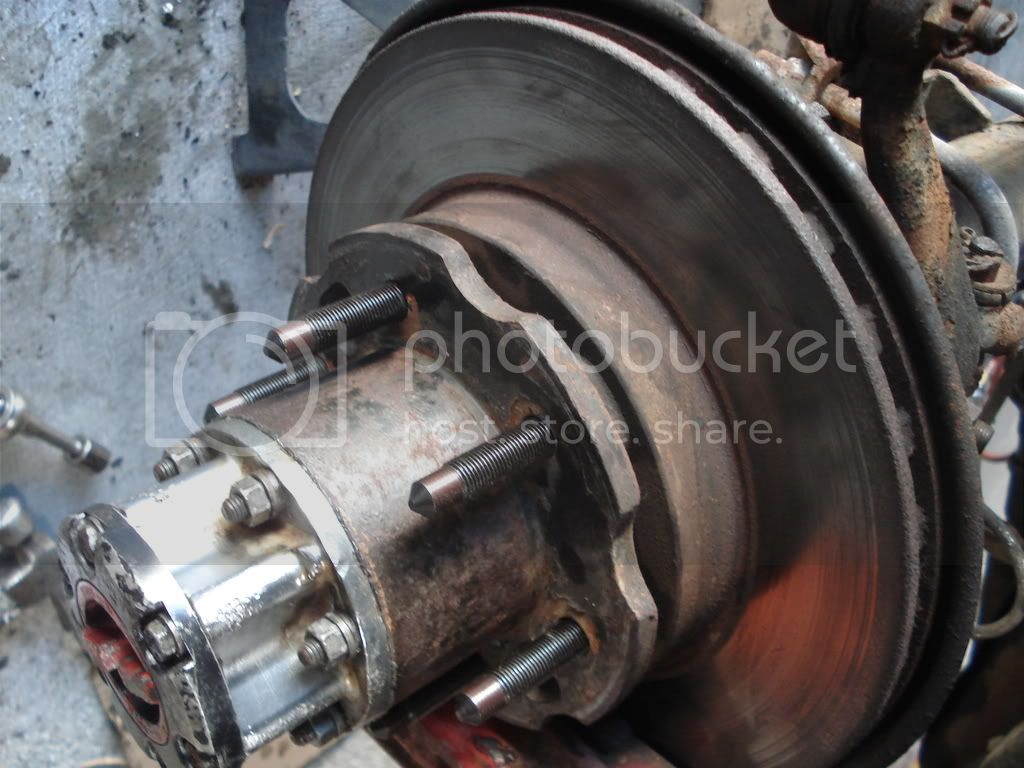

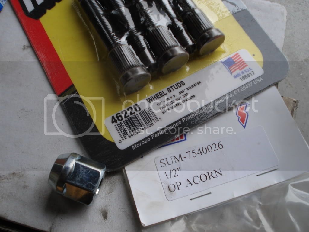

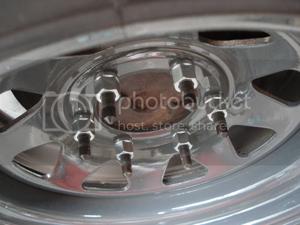

Manny those ARE huge. I have the exact same problem you have, I'm not comfy with the length front or rear! Question is how much benefit are the Toyota length when you can go all the way with those Morosos. Toys look barely a bit longer I just don't want to pull everything apart to do the install......sheesh! I just got the damn wheels on fer chrissakes!

There not as expensive as some of you may think:
14.95/5
$2.99 each
Moroso 46220 - Moroso Wheel Studs - summitracing.com
I may be wrong, but I believe these studs are higher quality then what you may find at your local parts store.
