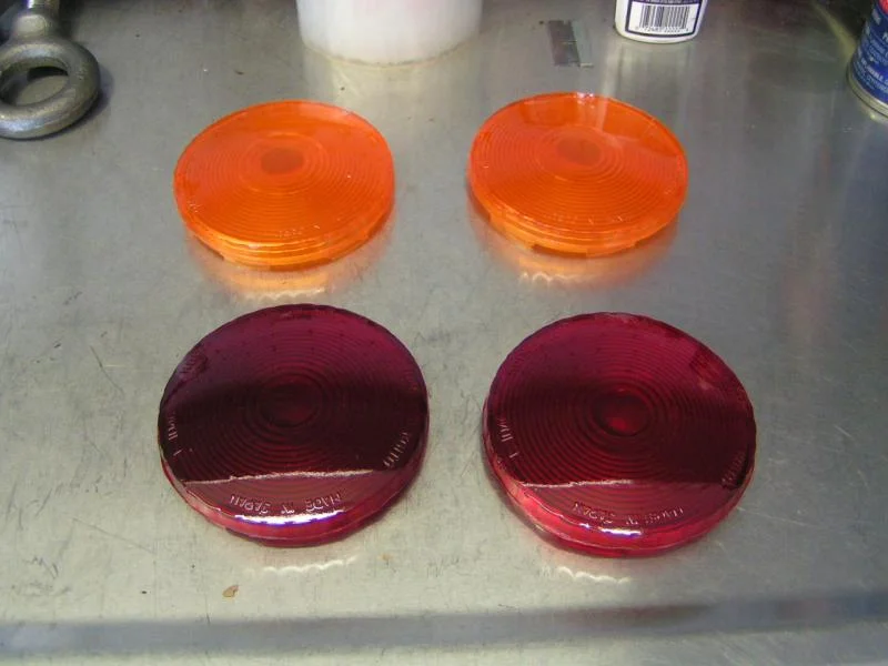

New early turn signal lenses
looks awesome man!

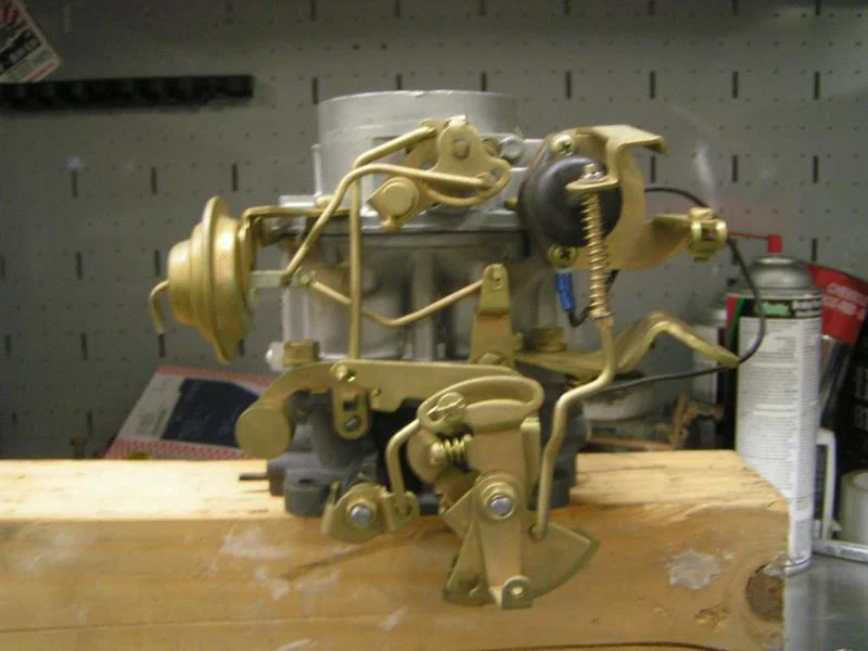

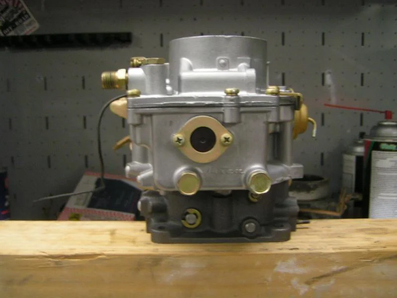

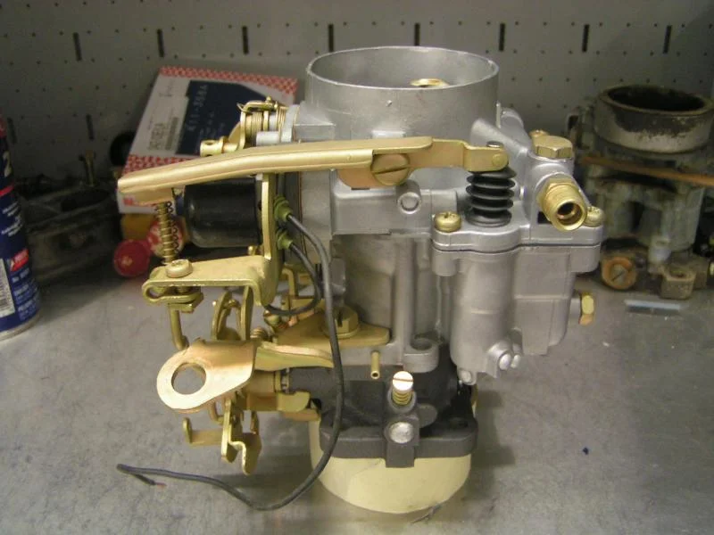

Wow Tom...that looks super clean!

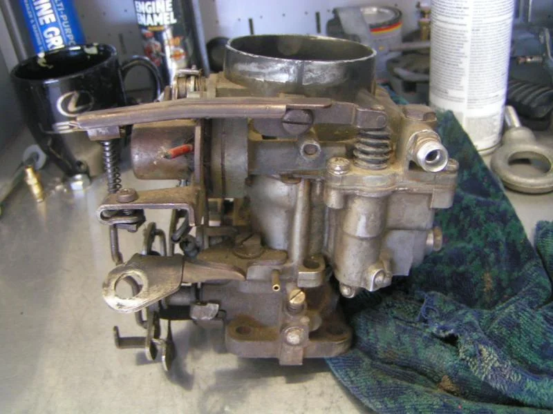

Do you also have the original big window carb for cruiser?
I don't have the big window carb
Being in CA, I'm sure you'll find a nice one soon enough :beer:
Ill keep looking
Few things about the large window carb. You will need to get another intake manifold for the one barrel carb. The air cleaner was also different. On a 62 most came to the US with a oil bath air cleaner. These were shorter on the top piece until the 64s. Instead of the mount bolting to the far forward bolts on the head it was moved one bolt back. Can't tell from the pictures which air cleaner you have. Sean I believe has a rare large window two barrel carb which would probably work with your set up if you could find one of those.

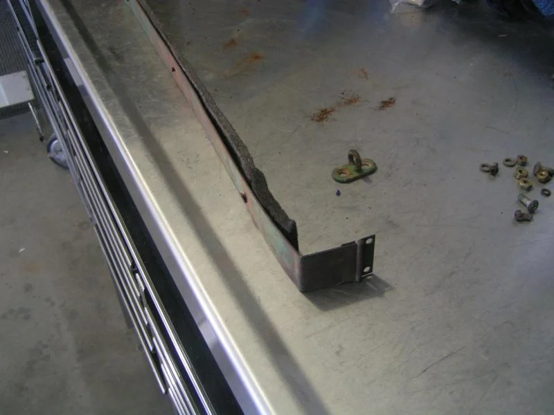

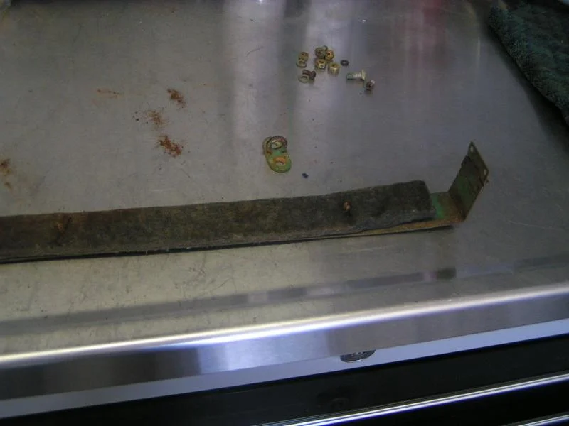

tool box band
Tool box band arrived I'm going to copy and manufacture them if anybody wants one I'm only going to make 20 of them.
Cool Tom! I'll take one :cheers:
