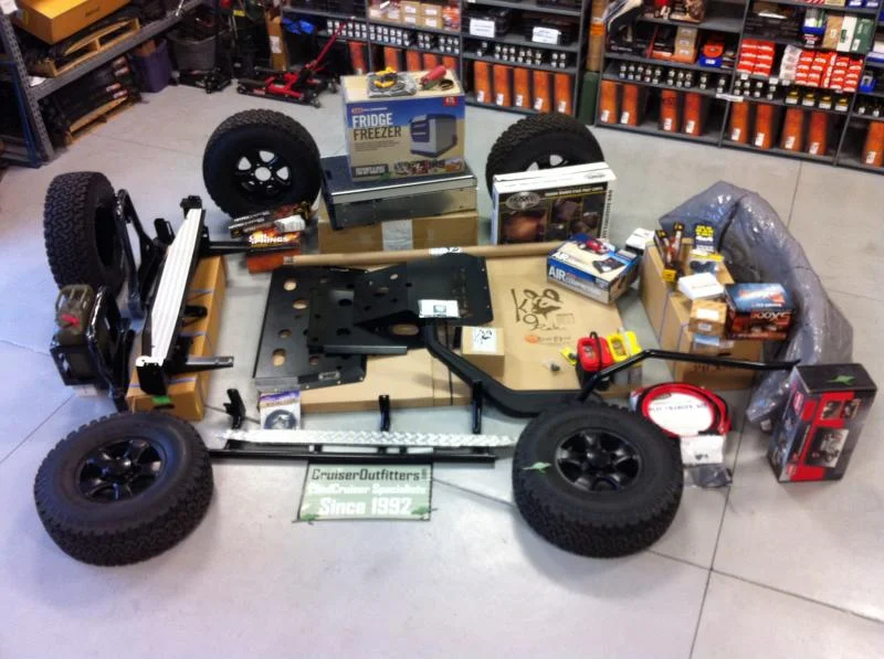

We are making headway, rear suspension is complete. ARB front and rear bars are in the works.
Cool! Do you have a list of the mods?

Following the build this weekend we will have a comprehensive build thread with details of all aspects.

What rear bumper is that? And yes this is totally awesome.
