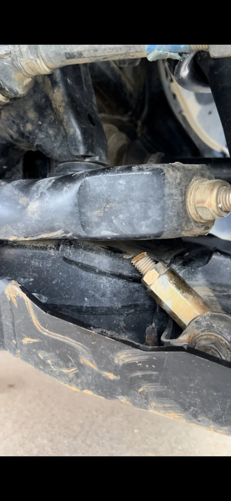

That’s the opposite of my and others observations though. And also your link snapping…
Are you sure? When i undid my front end, removing link drooped another inch or two. Did you perform your testing with your control arms unbound?
The shock seems to extend well past CV bind point and sway bar tension.
My turn.
Currently stuck waiting for the UCA bolt to un-seize itself out of the spindle, i dont want to hammer on my nice new arm.
I have the lower cam bolts loose, and the sway lower link bolt out, and its loose in its cradle out of tension.
Seems like the upper ball joint is bound now, and that could be what i experienced during that install.
Once its out, i will see if the shock wants to give any more and remeasure.
