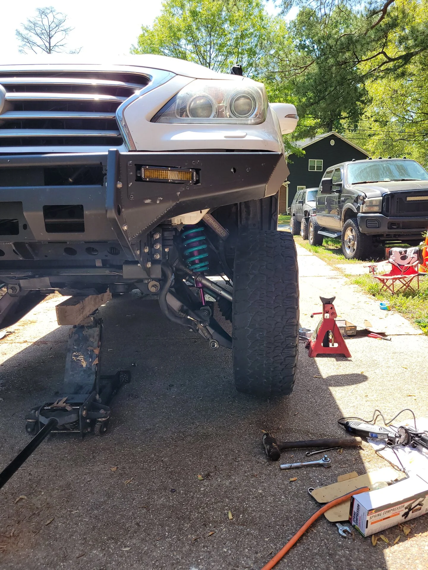

I'll have the truck in the garage tomorrow for a front spacer swap and more cutting. I'll snap some photos for you.

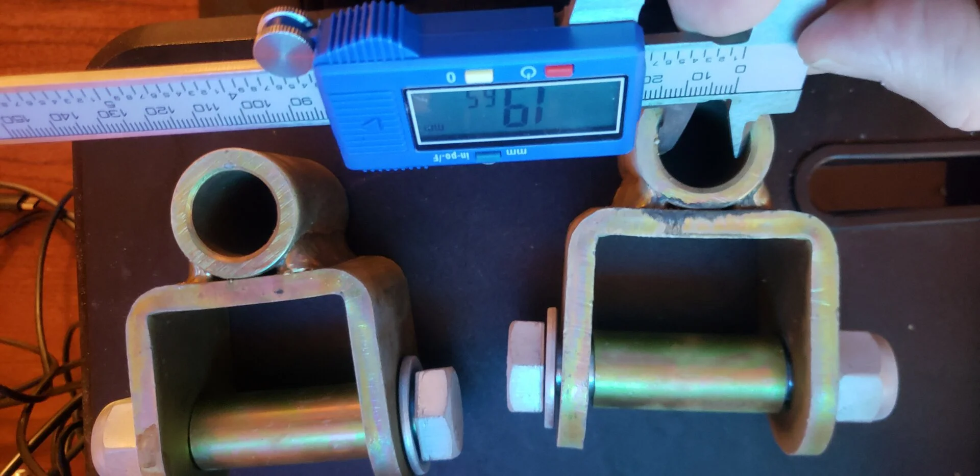

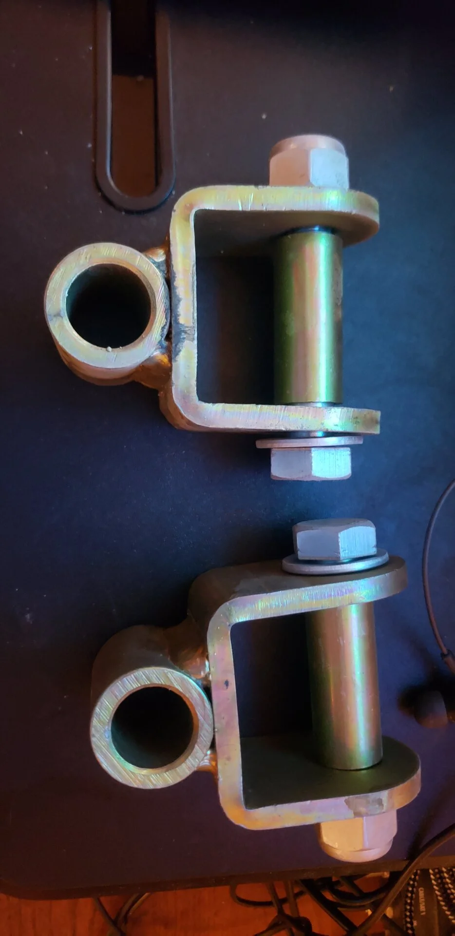

A bit late to the game, but I thought I'd bring up the Japan 4x4 spacers that were used on the rear of the 100 series. It will net 2.2" on the rear axle, allowing you to increase (max out) the lift on the rear AHC sensors. Not sure it qualifies as "long travel", but it will save you from having to weld a plate and drill.
It's -20C out today, so I haven't measured the LX 200 series lower shock mount diameter... is it 19mm? If so these should fit by rotating the AHC ram 90 degrees.
Keep in mind that these particular extensions were designed for the lighter 100 series, but a similar beefy setup might make the rear a 1 banana job.

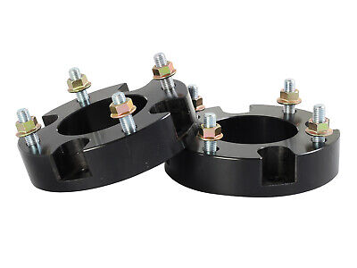

I’m just being a nuisance at this point but would this spacer work for the front?

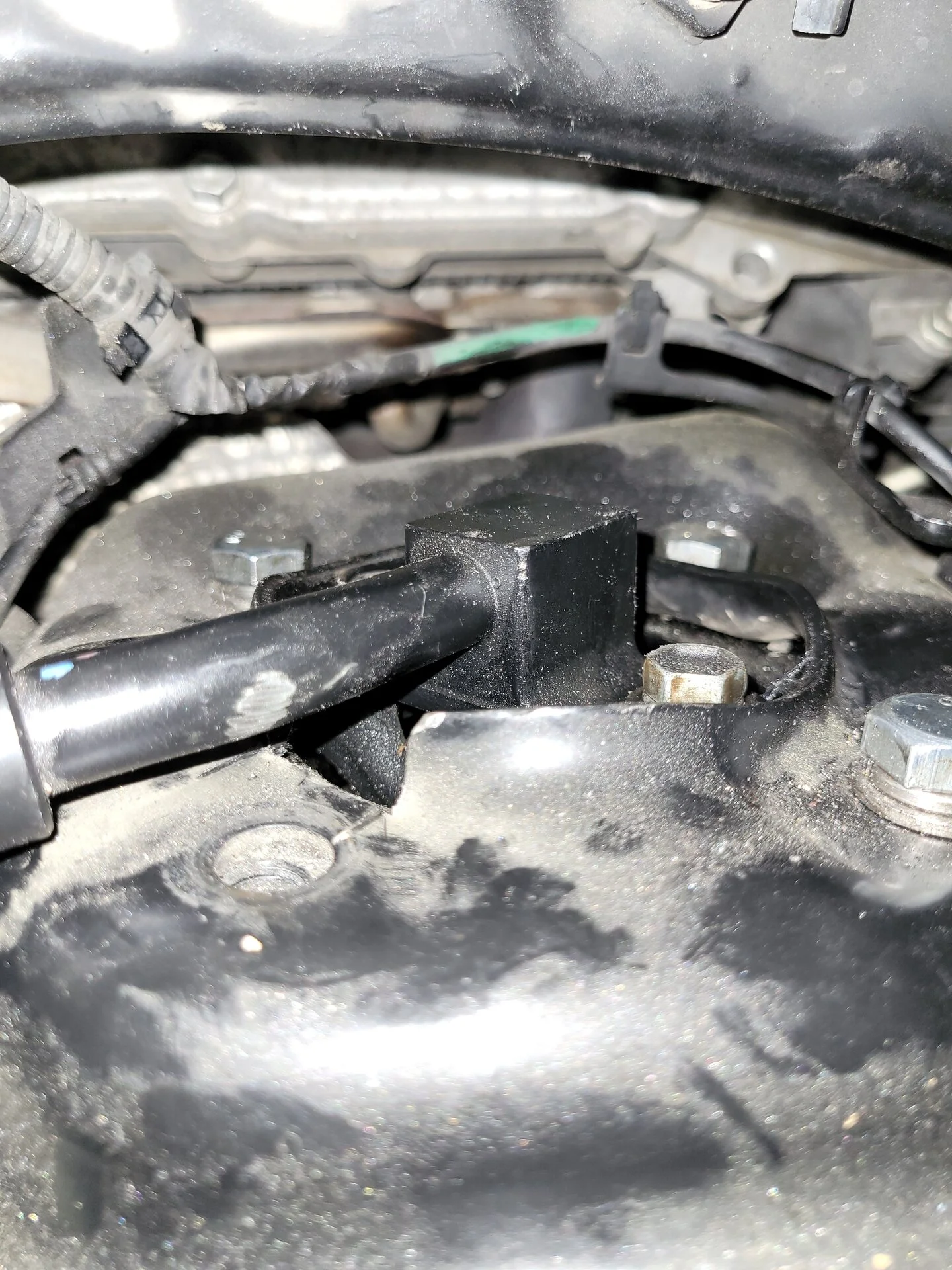

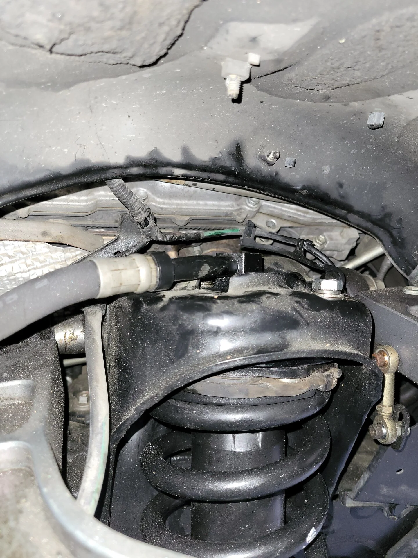

While it may be possible to install that on a LC, I think the AHC hose that goes into the top of the shock at a 90 degree angle on an LX would then interfere with the shock bucket. I think the beginning of this thread has the maximum recommended size of spacer and it requires a little grinding for the AHC hose still.
And if someone installed this on a LC, then the CV angles that people are concerned about might likely come into play at full droop.
Plus you’d still need to address your bumpstops around the same amount.
Essentially, this isn’t the best solution for real off-road use.
Edit: above response based on assumption that the spacer was 1.5”, which it is not. It’s only 24mm netting 1.5” lift on a Tundra, so this isn’t actually beyond what at least one person has used successfully with RCV axles, and one person without?
Can confirm the LX570 shock uses a 19mm bolt hole as well. x 45mm long.

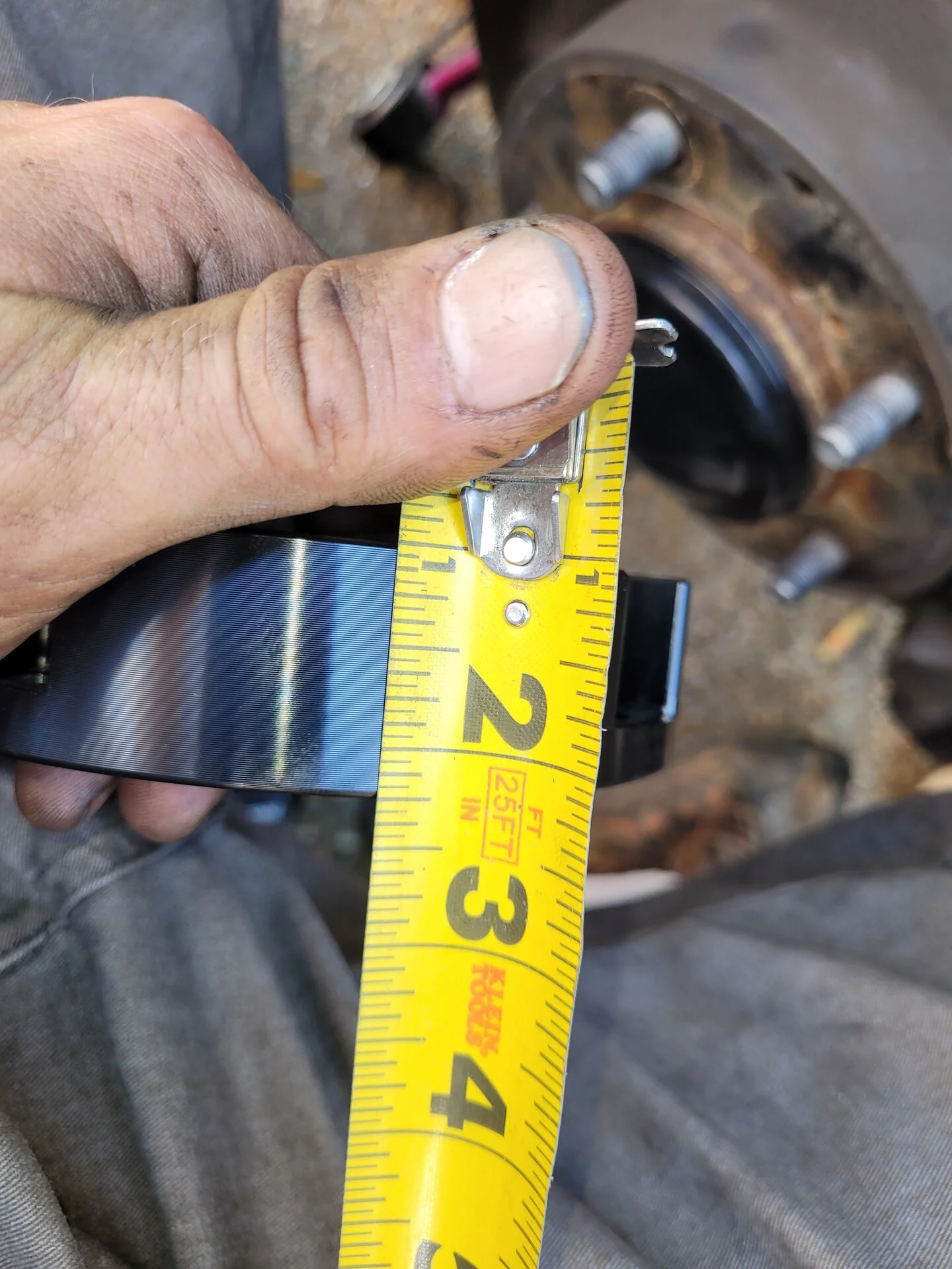

See that’s where I’m confused. @Killacaviar said on page 3 he used a tundra spacer of 30 mm (which the one I linked is obviously more than that). I’m just curious what he used to not have to disassemble the coil over.
This is the exact one I have siting in my garage. It’s 24mm total. I have a 30mm on now and was able to modify the ahc line to slide into the bucket. No problem there if your will to make the changes.
As for too much droop with that spacer, stock arms and a sway bar connected with factory links…no way it’s going to be a much of a problem as others have suggested. The oem sway bar is the droop limiter, not the cv. I have ran a 30mm with oem everything and beat the front end more the most (primarily crawling and going extremely fast over rocks) and no issues.
With a tundra swap may be a different story, @RHIN0 front end isn’t comparable, his long arms and lower shock mount mods raise his ratio’s.
I’ll have that space in (it will be a reduction from where I am) tonight and I’ll let you know how it goes. The only concern is UCA interference with the coil spring.

Installing probably today and will take some pics.
This is kind of perfect actually. Got a link?
I believe they are indeed 19mils back there. And rotating the tube is no biggy.
These don't look like they'd be hard to modify shorter . . .

So we're not talking past each other, the advertised lift of spacers is not the same dimension of the spacer thickness because of the suspension motion ratio.
Too bad most advertisement don't list the real spacer thickness. At least we can confirm the 1.5" lift is a 24mm spacer. So motion ratio for a Tundra is about 2:3.
